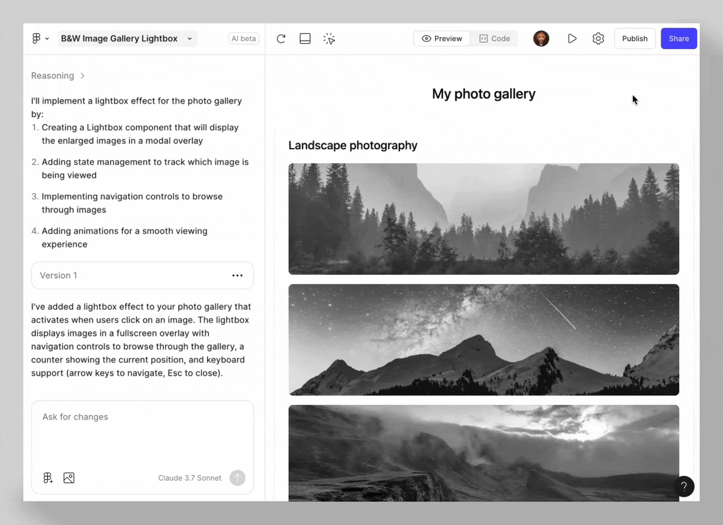

To publish your functional prototype or web app:
- Open the Figma Make file that you want to publish.
- In the upper-right corner, click Publish.
- In the Publish modal, set a title.
- Optionally, in the upper-right corner of the Figma Make interface, click Make settings, then select General to change additional settings for your site.
- Click Publish.

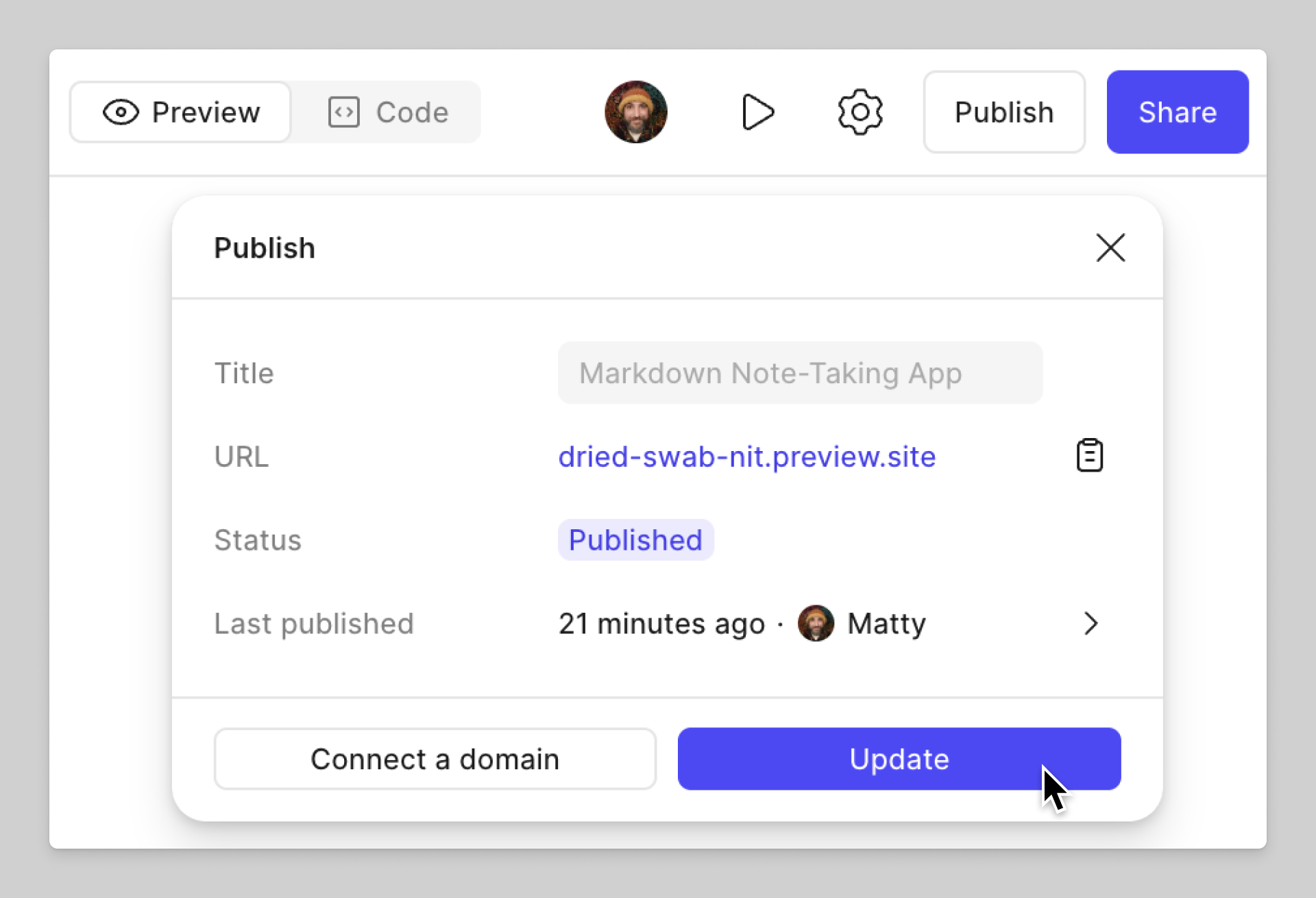

Once you publish your functional prototype or web app, the publishing window displays the following:
- The web app's URL, which is autogenerated by Figma. Click the URL to visit your published functional prototype or web app. You can now switch to using a custom domain if you prefer.
- The status is Published.
- A new field that shows the last published date.

To publish changes, follow the same instructions in Publish a functional prototype or web app. Then, in the Publish modal, click Update.

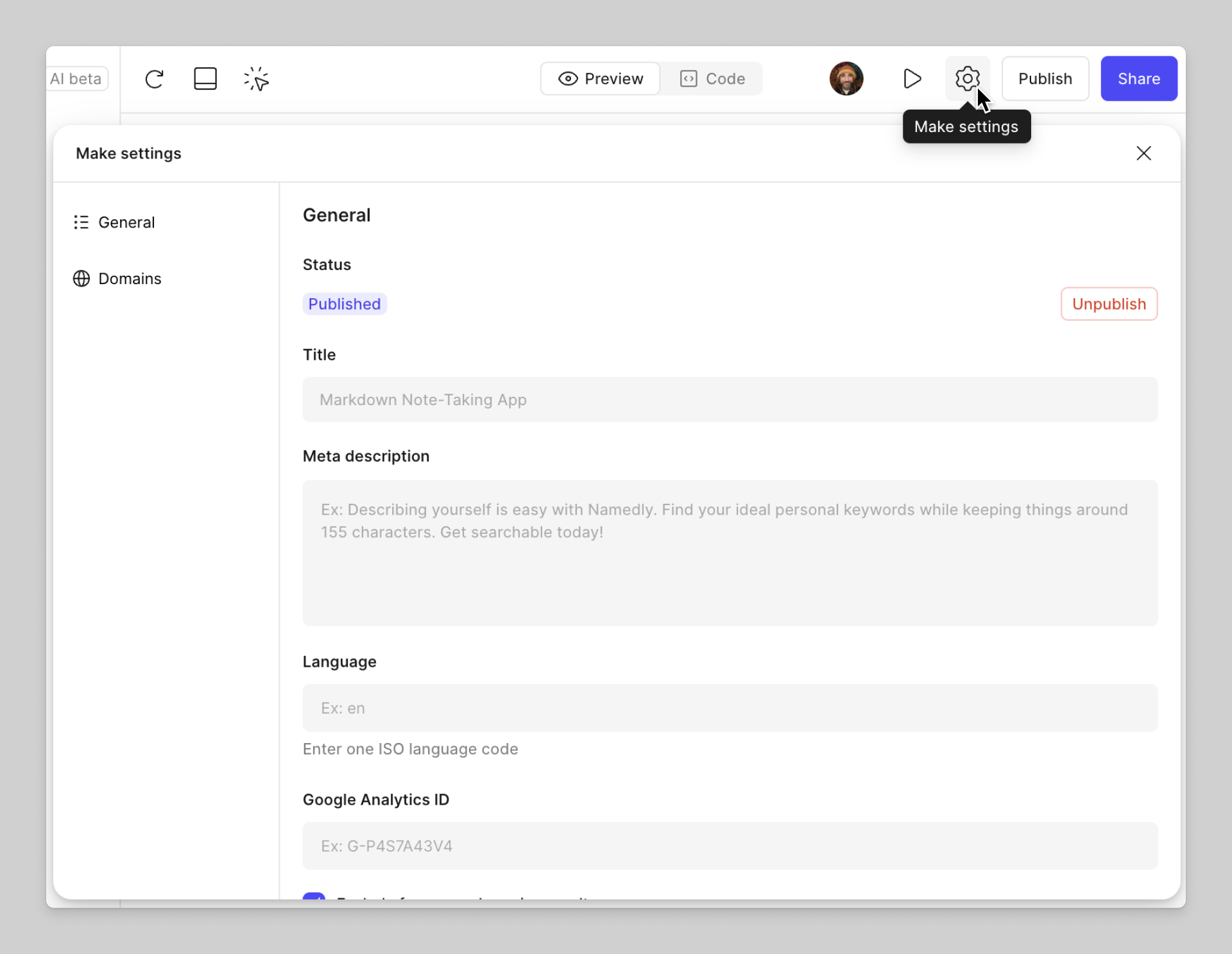

Make settings

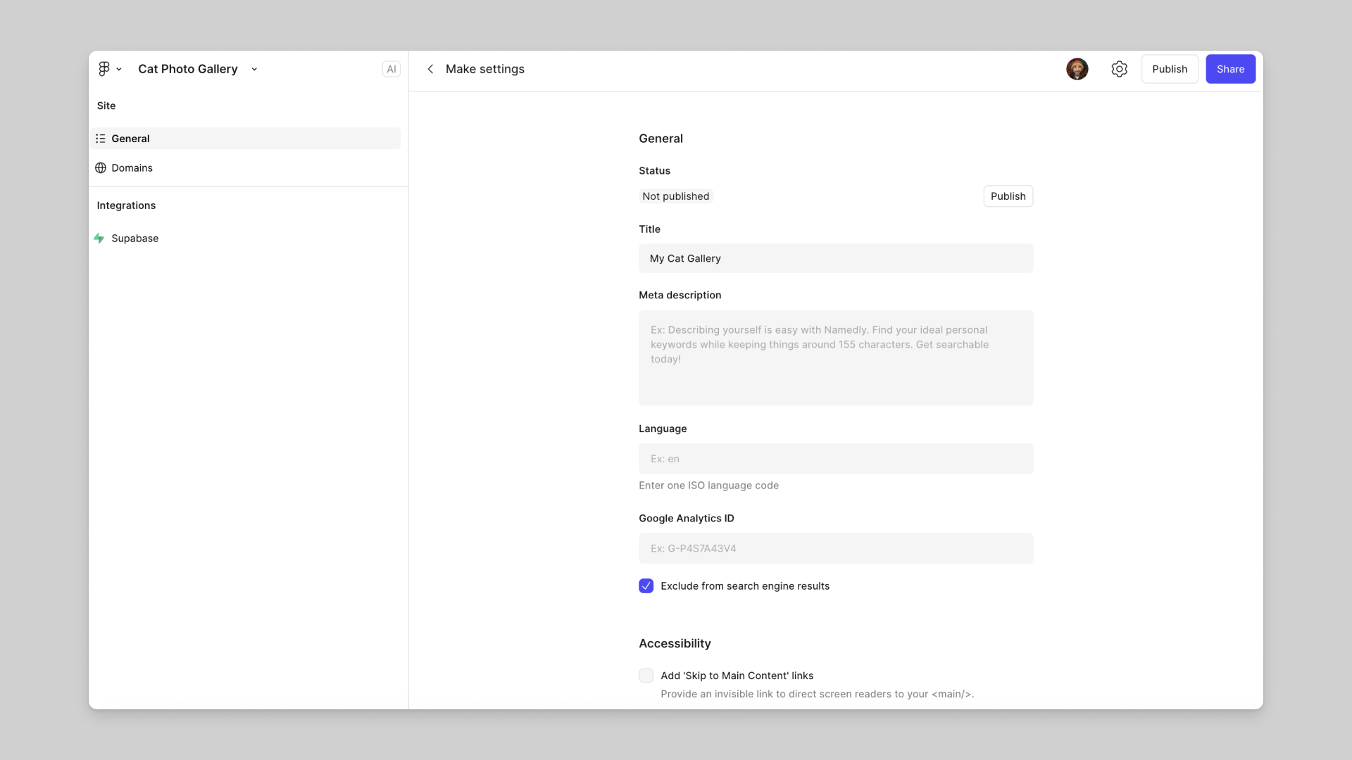

There are a number of optional, advanced settings you can set before or after you publish your functional prototype or web app. To view the settings for your file, click Make settings in the upper-right corner, then select General.
Here, you can see your app’s publishing status and set its metadata, discoverability, access, and other options:
- Title
- Meta description
- Language
- Google Analytics ID
- Exclude from search engine results
- Favicon
- Manage access to the published app
- Social sharing image
- Custom code for the site head and body
Tip: From Make settings you can also enable web search, configure a custom domain, and upload custom web fonts.

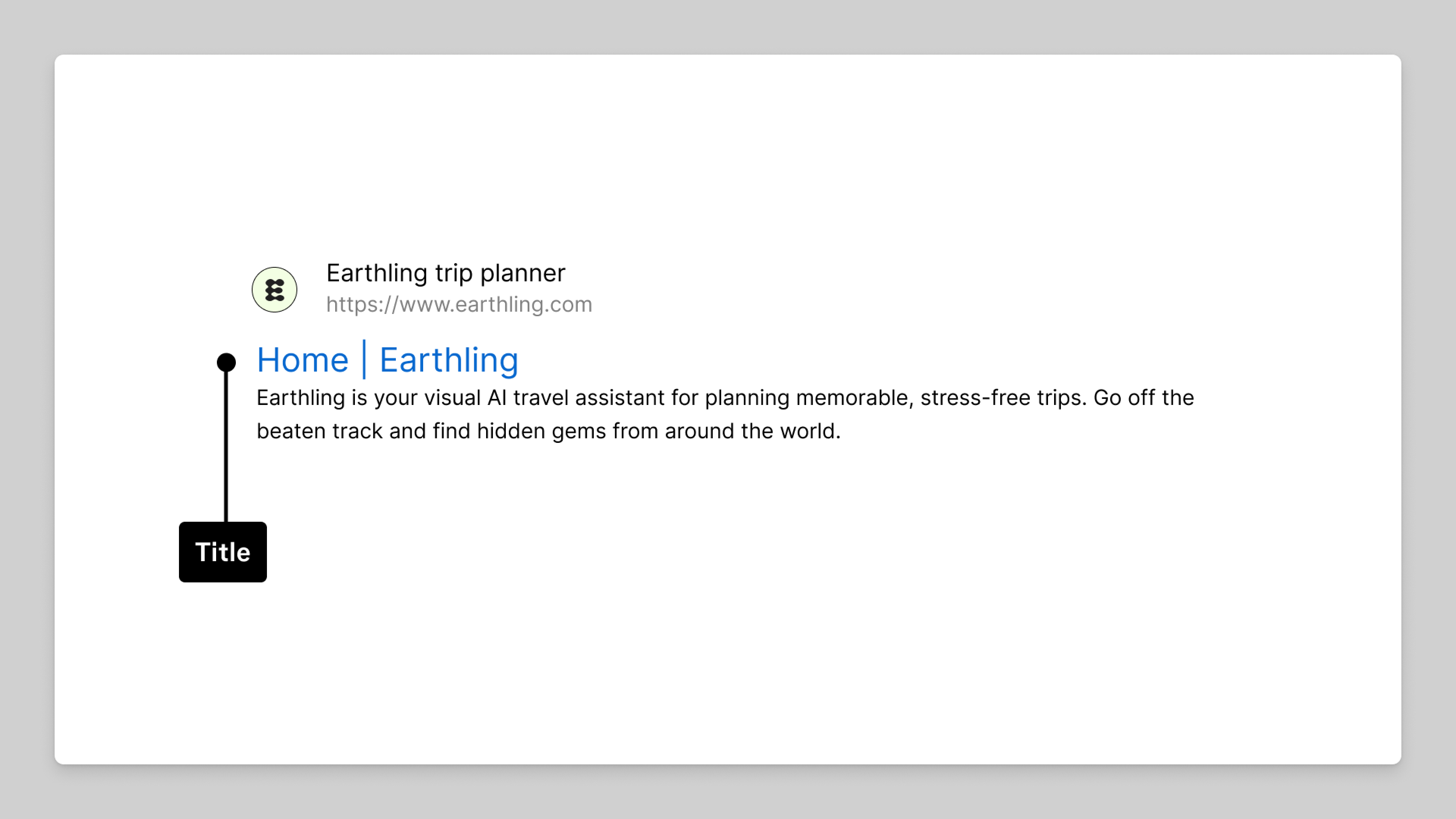

Title
Use the Title setting to specify a title for your published functional prototype or web app. The title appears in browser tabs, search engine results, and social media. Adding a title helps people understand what page they are on in their browser, aids SEO, and improves accessibility.
If no title is provided, Figma will generate one for you.

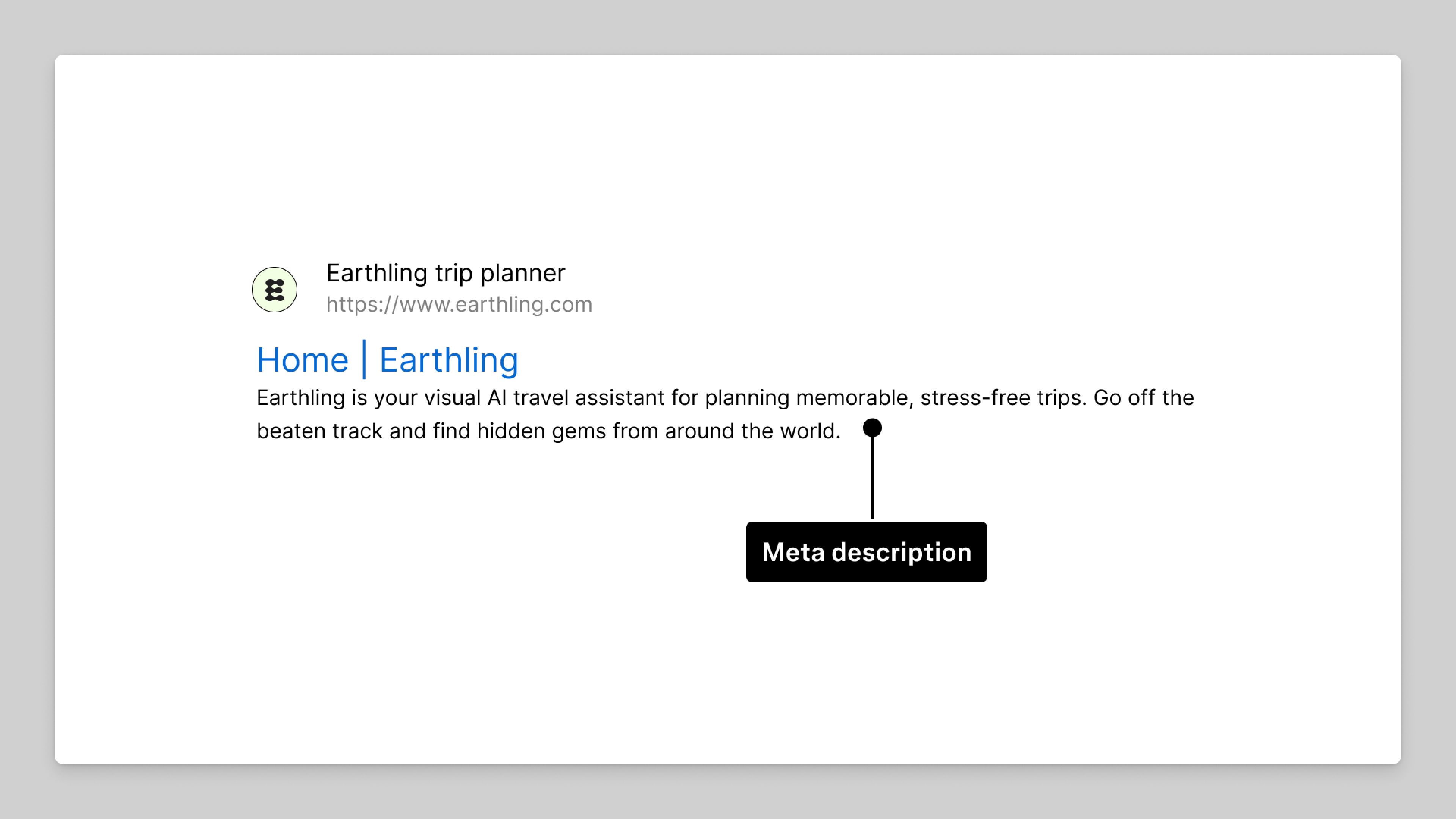

Meta description
Use the Meta description setting to provide a description of your published functional prototype or web app. A meta description is a short summary of your website’s or page’s content and is designed to attract users and improve click-through rates from search engine results pages (SERPs).
If no description is provided, Figma will generate one for you.

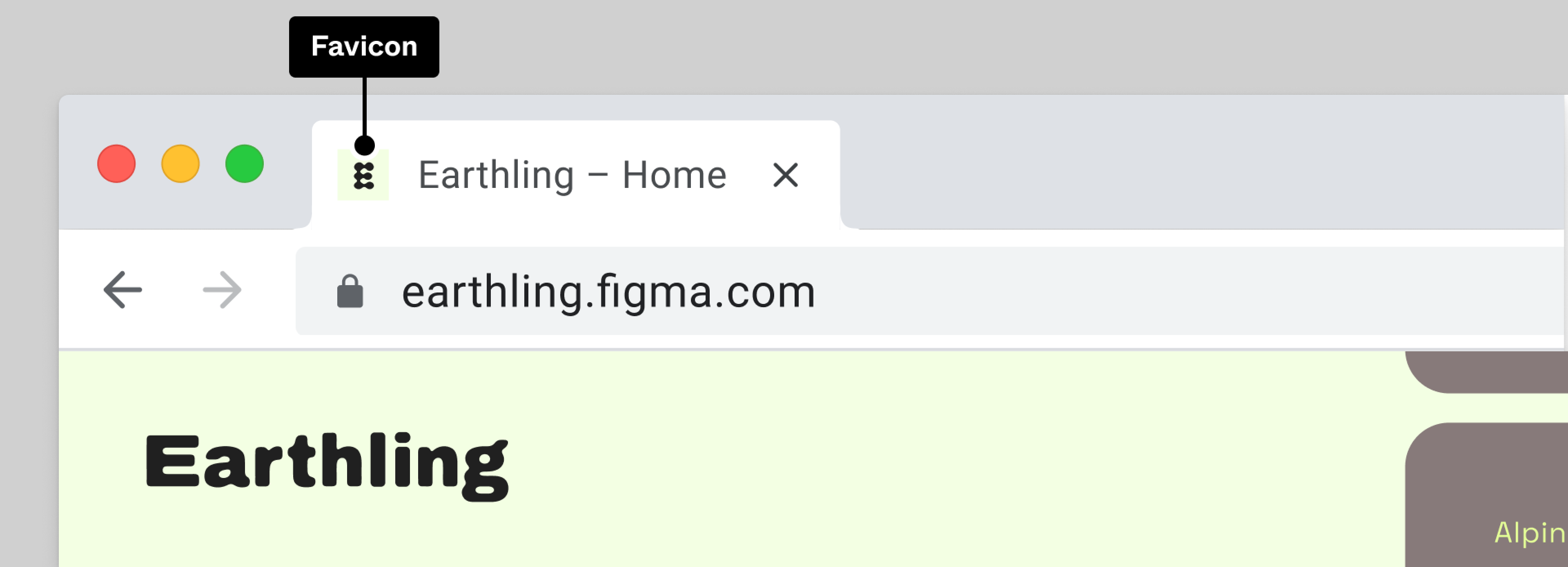

Favicon
Use the Favicon setting to upload an image to use as a favicon. A favicon provides a small visual representation of your published functional prototype or web app in browser tabs, search results, and bookmarks. We recommend using a 48px x 48px image.

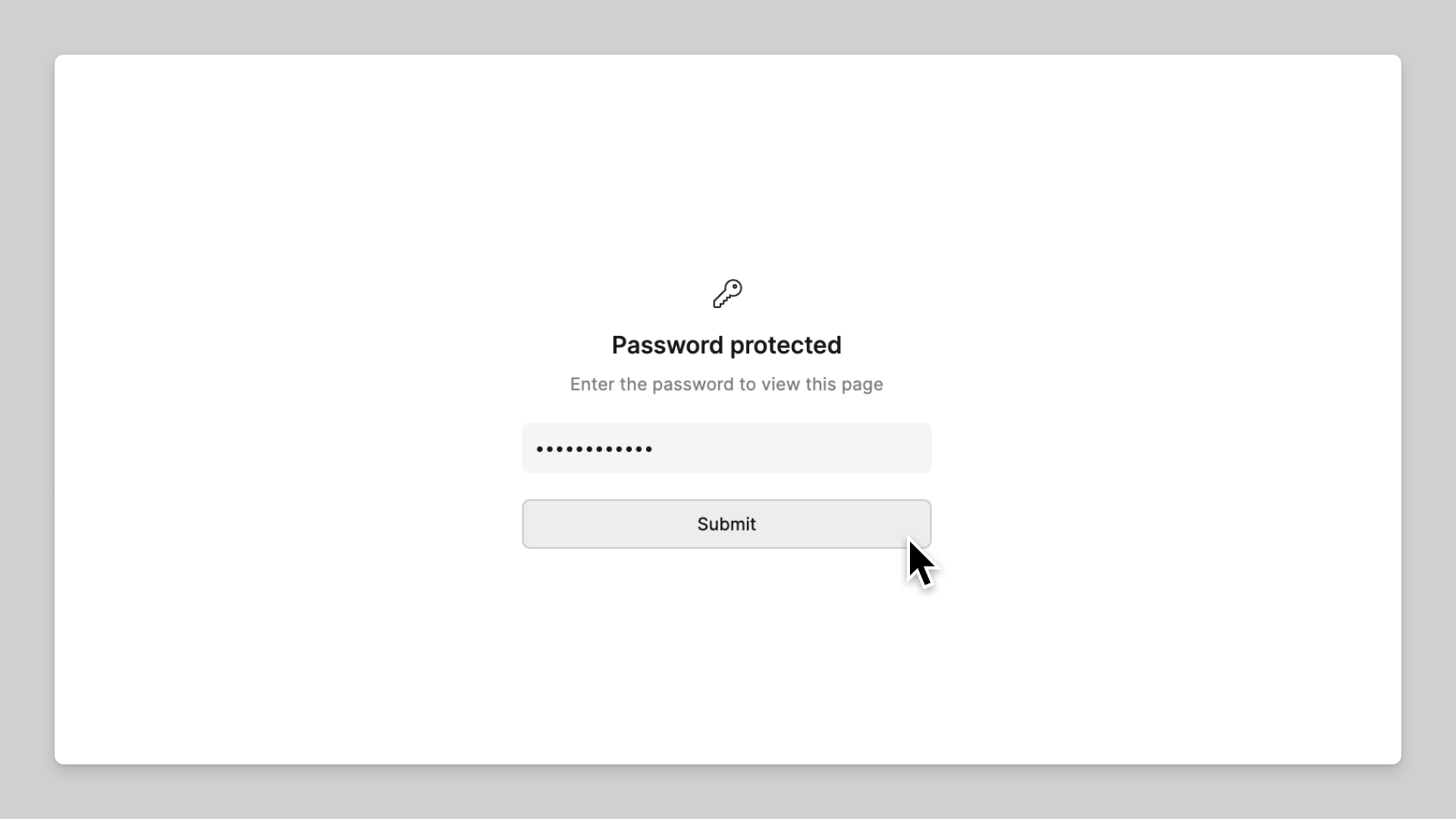

Add password protection
When password protection is enabled, visitors need to enter a password to see your published web app's content—including metadata like the title or description.
Note: Password protection applies only to the published version of your web app at its *.figma.site domain. The preview version—which displays with a Figma header at the top—is not password protected and follows standard file sharing permissions.
You can either create your own password or use one automatically generated by Figma:
- Passwords you create must use a minimum of 4 characters and may contain any character type
- Figma-generated passwords combine four random words, making them strong and unique
The password will automatically apply to your published web app as soon as you save it. You don’t need to republish, although the changes may take a minute or two to take effect.
Note: If you add a password to a published web app which has not been excluded from search engine results, some metadata may continue to appear in search listings. Once password protection is enabled, search engines will no longer be able to index the content of your web app, and it will typically disappear from results over time. If you want to speed up the process, you can request removal through Google Search Central.
Once set, you can’t view a password again. If you forget to copy it, you’ll need to create a new one. When you change the password, anyone with prior access will need to enter the new password the next time they refresh the web app.

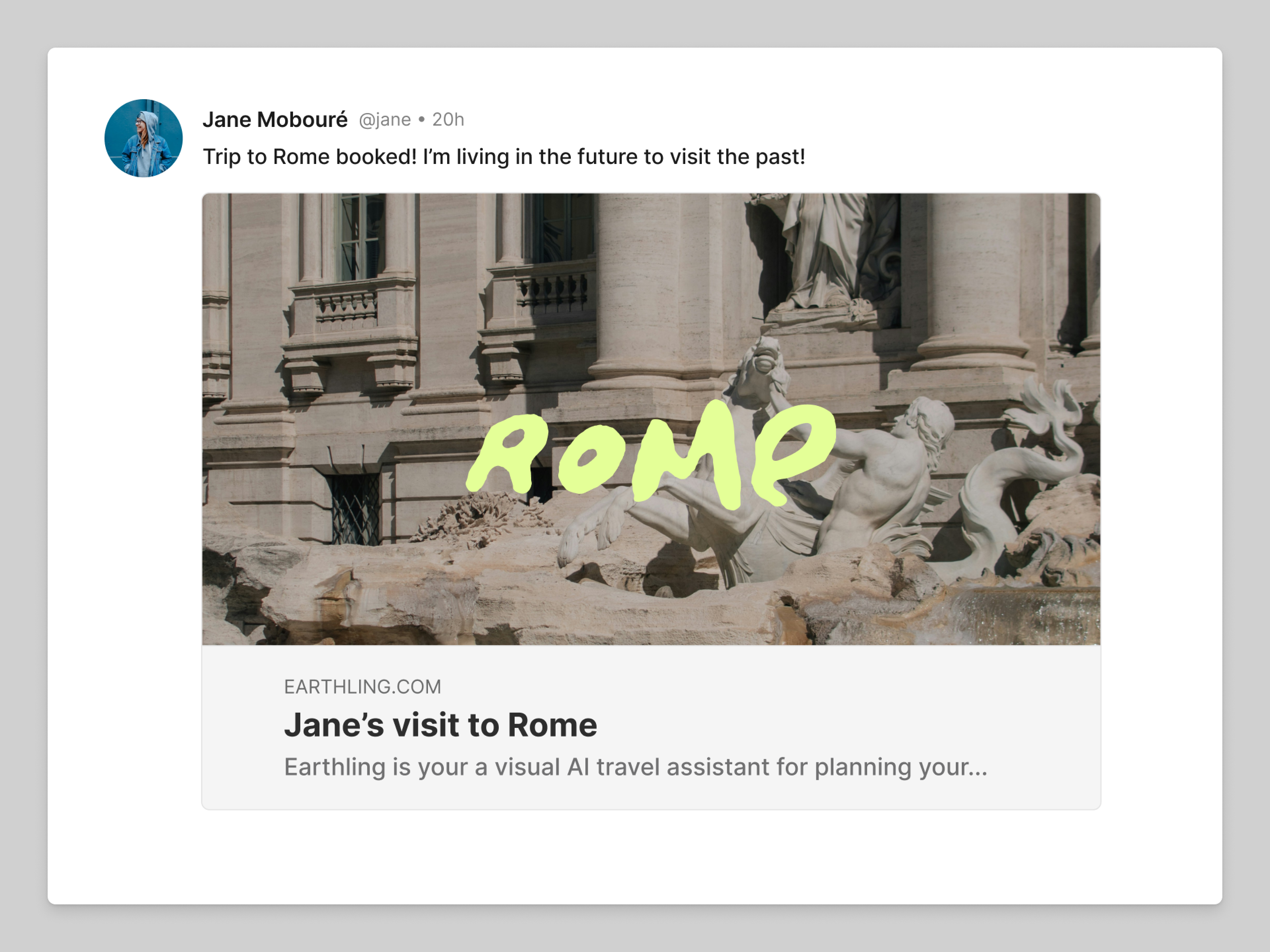

Use the Social sharing image setting to upload an image that appears when your published functional prototype or web app is shared on social media. We recommend using an image that is 1200px wide by 630px tall. If a social sharing image isn't provided, Figma will use an image snapshot of your app instead.

Sharing a link to my app shows outdated or incorrect metadata. How can I fix it?
First, make sure you’ve published the latest version of your app with any updated metadata. If everything is published but other platforms still show old information, it’s likely due to caching.
Most social platforms cache link metadata—such as titles, descriptions, and preview images—the first time a URL is shared. Even after you update your page, these platforms may continue displaying the older data. To refresh the preview, you can “bust the cache” by running your URL through the platform’s debugging or preview tool, which forces it to re-scrape the latest metadata.
Tools to refresh metadata:
- Facebook:Sharing Debugger
- LinkedIn:Post Inspector
- X (Twitter):Card Validator
Slack: Previews refresh automatically over time, or you can force a new unfurl by sharing a slightly modified link (e.g., adding
