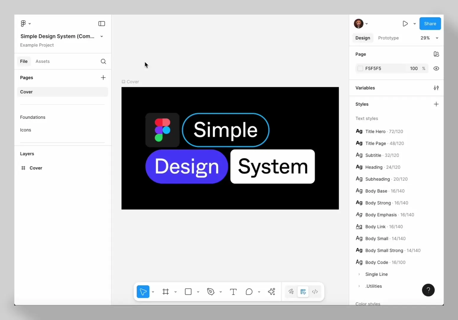

In Figma Design, select a library to use as the style context for your Figma Make files. Only people with can edit
access to the library can export it to Figma Make. This step only needs to be done once before you and others can start using it in Figma Make.
- In the Figma Design file that contains the library you want to export for Figma Make, select the Assets tab in the left sidebar.
- Click Libraries.
- From the This file section, find your current file and click Publish to open the library publishing modal.

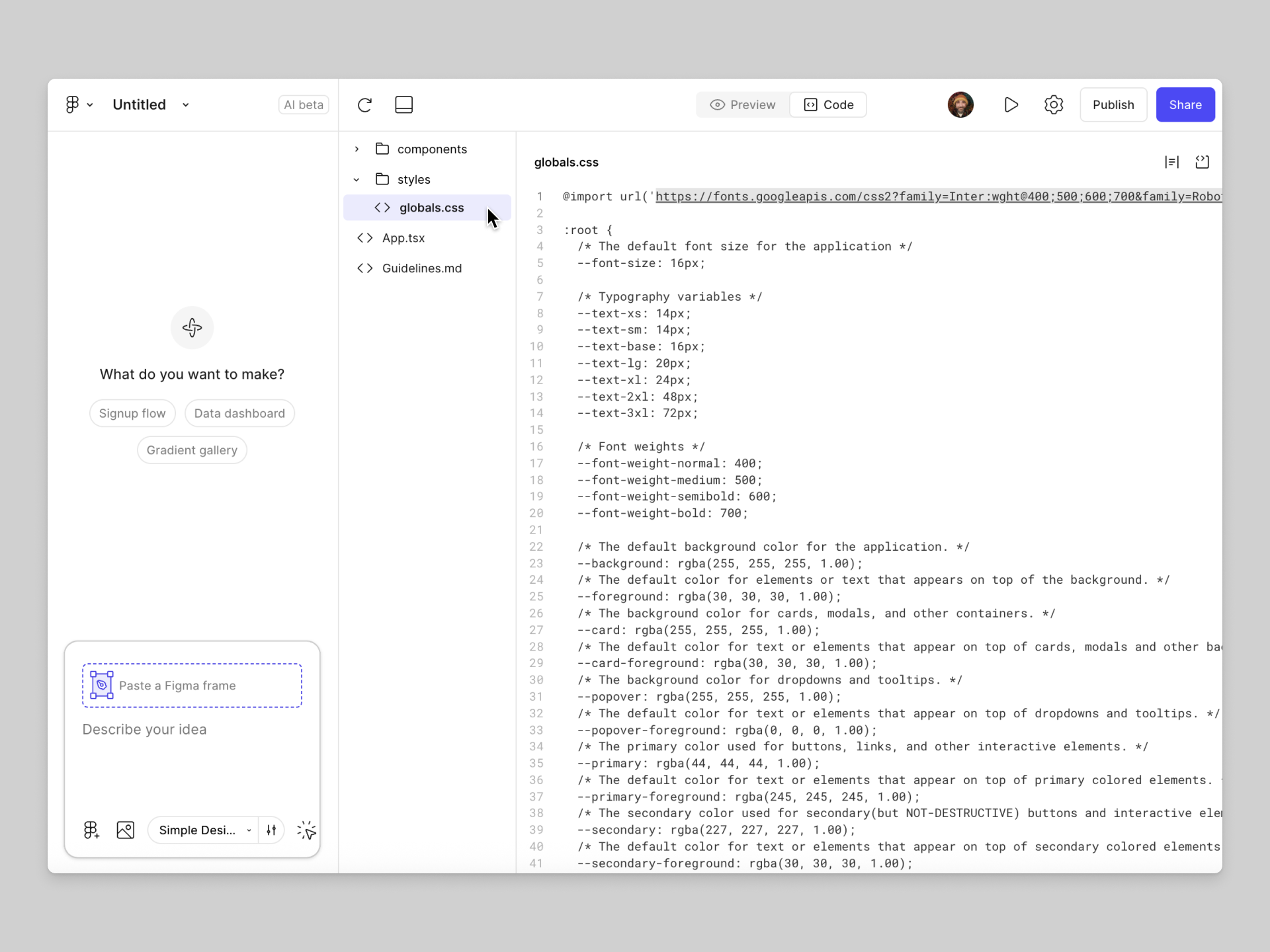

After you extract your library and select it in your Figma Make file, head to the code view. From there, open the styles
folder and click into globals.css
to explore the generated styles. You’ll typically see styles grouped into four categories:Â

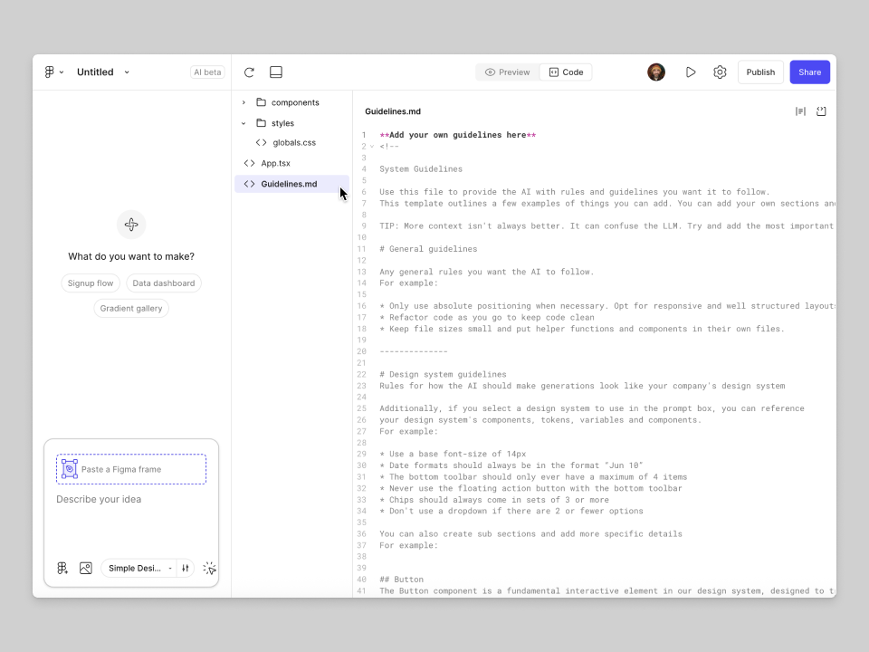

Keep in mind, the extracted CSS is a simplified version of your full library. It won’t capture every design detail. To ensure consistency and clarity, we recommend adding more context and rules in your guidelines.md
file.

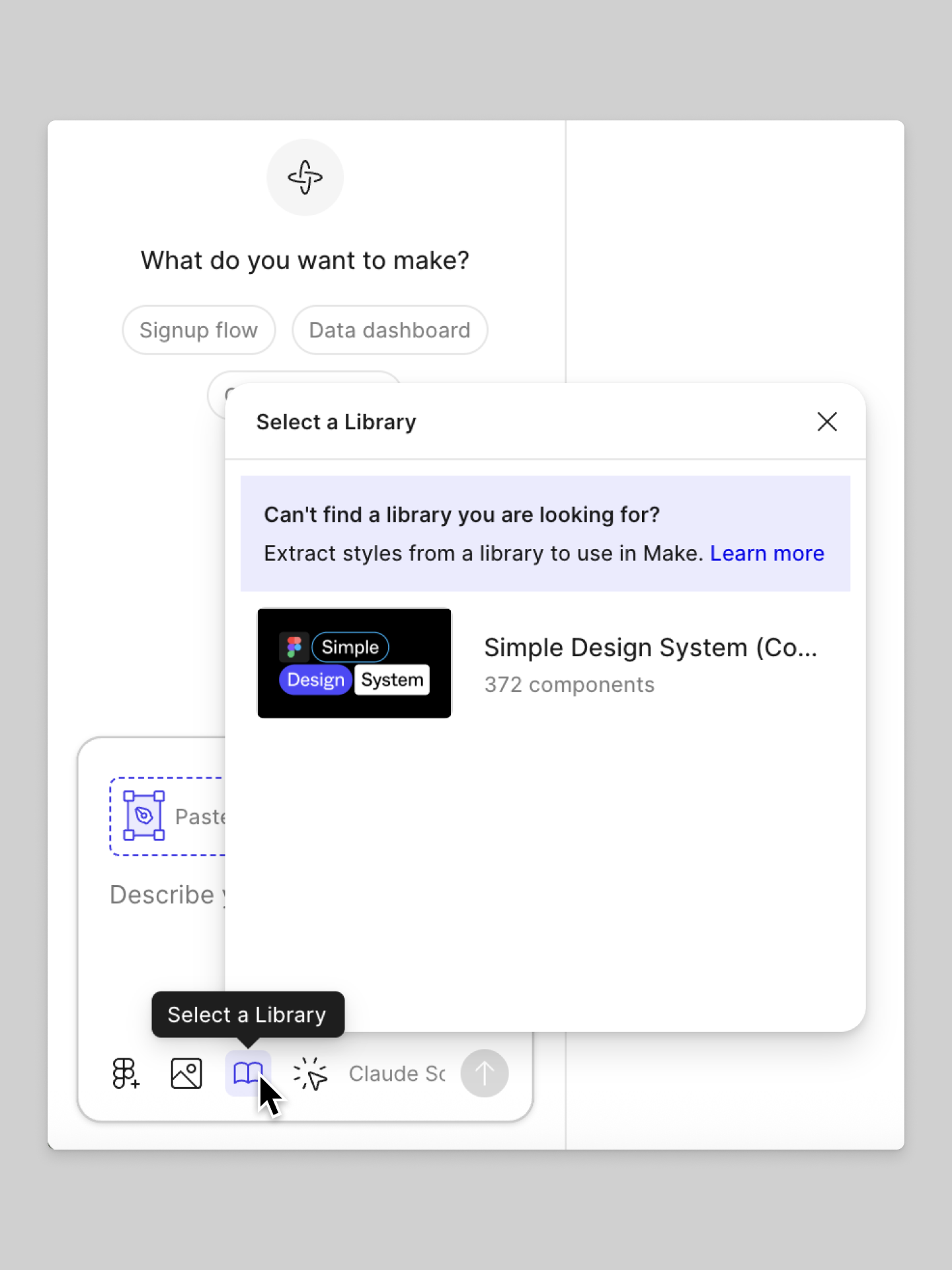

- In a Figma Make file, click Select a Library.
- Choose which library you’d like to use.
Start prompting immediately, or customize how Figma Make uses your library’s styles further by editing the library’s styles or adding guidelines. Once you select a library and start prompting, all generated content in this file will reference those styles.

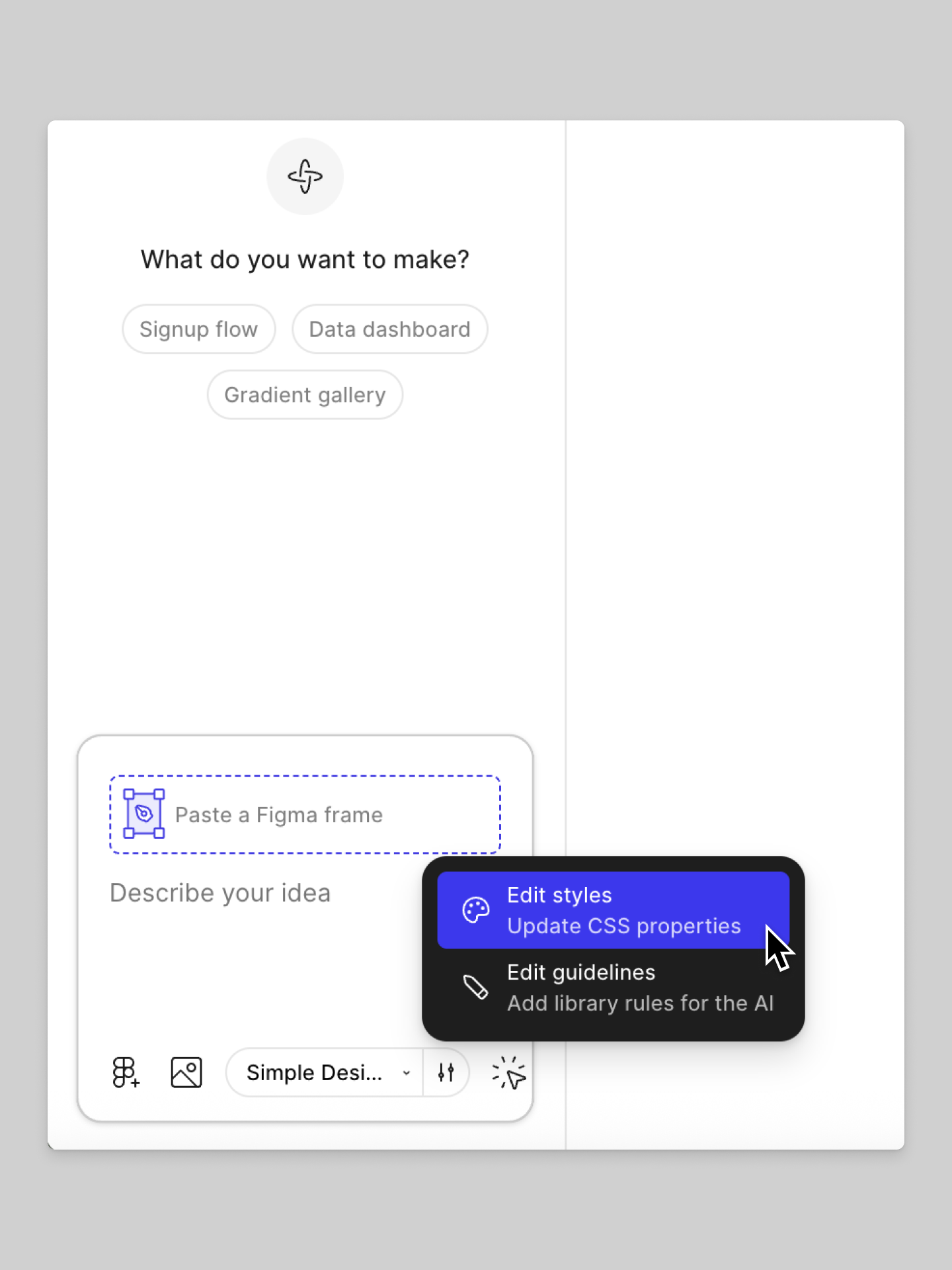

Edit a library's styles
When a Figma Design library is exported to Figma Make, a CSS file of the library’s properties is automatically created. You can customize the CSS to shape your Figma Make as needed. Changes to the CSS only affect this Figma Make file.
- Click .
- Choose Edit styles to update the CSS properties of this library.

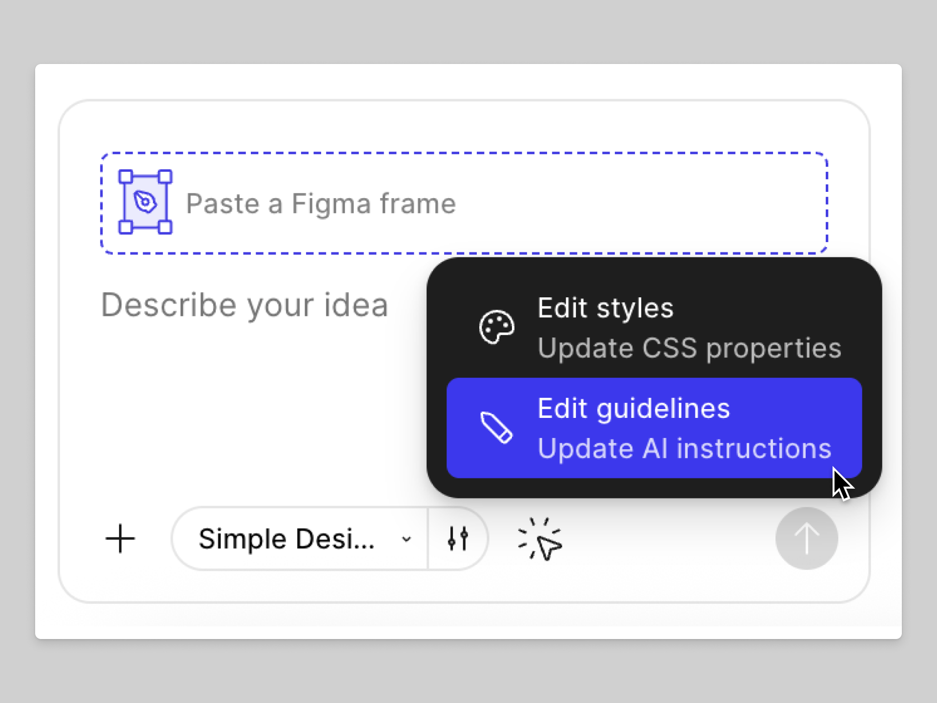

Add guidelines for generating
Guidelines allow you to give Figma Make rules or instructions for how the style context is used. Guidelines only apply to things you make in this file and do not impact any other files that might be referencing this library or the library itself.
- Click .
- Choose Edit guidelines to add guidelines for this Figma Make file.
The guidelines.md
file is a free-form text file, so you can add any specific guidelines you want Figma Make to follow.
Tip: The guidelines.md
file is available to use with or without a library selected, so you can shape any Figma Make files as needed.
