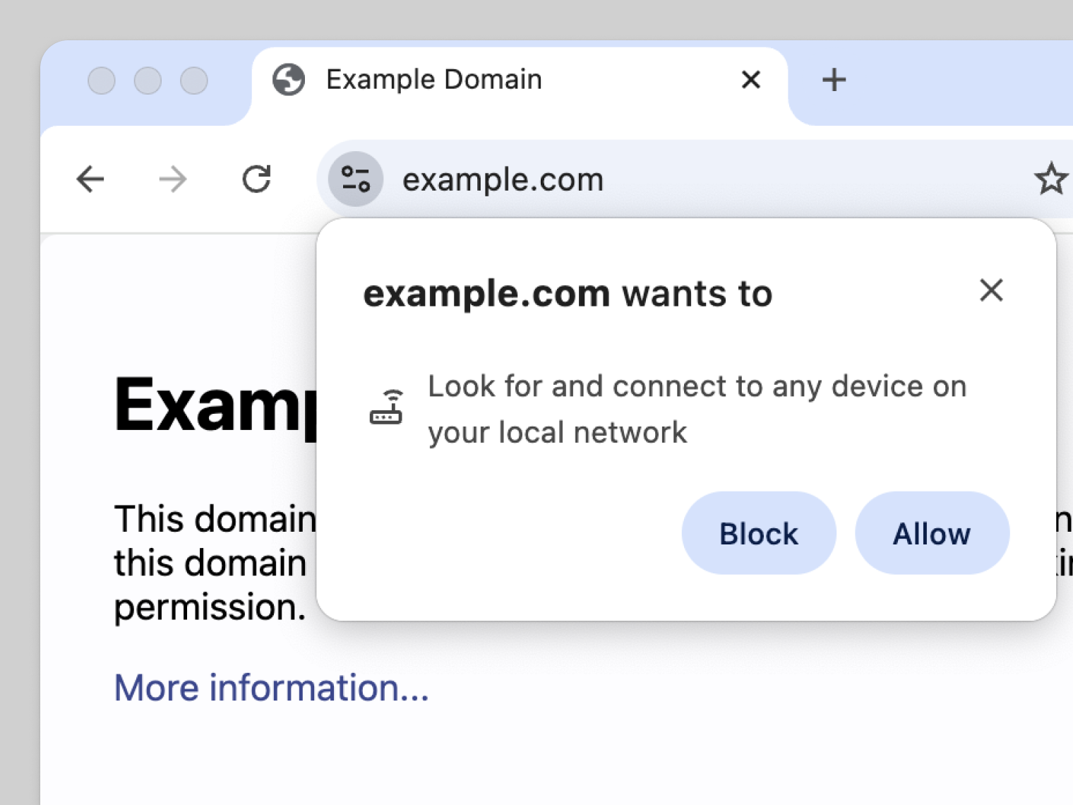

New versions of some internet browsers implement Local Network Access, a security feature designed to protect you from attacks that target devices or services on your home or work network, like printers, routers, or apps running on your computer.

Granting this permission only allows figma.com to talk to Figma apps on your own computer. If you rely on local fonts, spell check, or quick file opening in Desktop, choose Allow when prompted for Local Network Access for figma.com. This is an expected and safe part of Chrome’s new security model.
As more browsers add support, Figma may prompt you to connect to the font installer on your computer. At this point, your browser will ask you to allow local network access.

Allow Local network access in Chrome
Chrome changed the name of this permission in version 145. Depending on your Chrome version, you may see a different label in the browser, but the effect in Figma is the same.
In Chrome 142-144
- Open
figma.comin Chrome. - Click the settings icon in the address bar.
- Select Site settings.
- Find Local network access.
- Set it to Allow.
- Refresh the page.
