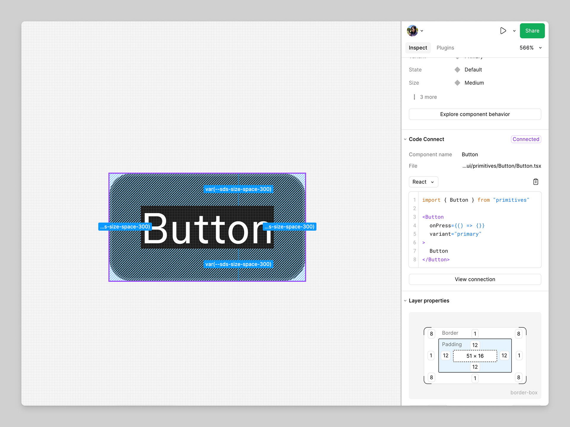

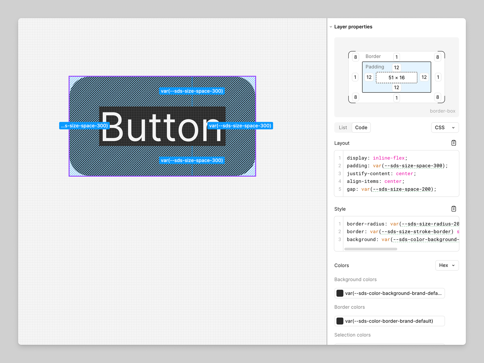

When you inspect an element in Dev Mode, Figma will display some generalized code in the right sidebar. You can choose different languages from the menu, like CSS, or iOS Swift code.
This code could be helpful for developers when they first started building a design system library in the codebase. However, if you already have one, the code snippet here doesn’t reflect how your code looks like in your codebase.
That’s where Code Connect comes in. If your developers maintain a source of truth for your components in a codebase—with your own naming conventions and syntax—you can use Code Connect to link components in your codebase directly to components in your design files.
And if you’re using the Figma MCP server to build apps using agentic tools like Claude code, Cursor, and VS code, Code Connect can enhance the server’s ability by giving the AI agents direct references to your code for improved results.

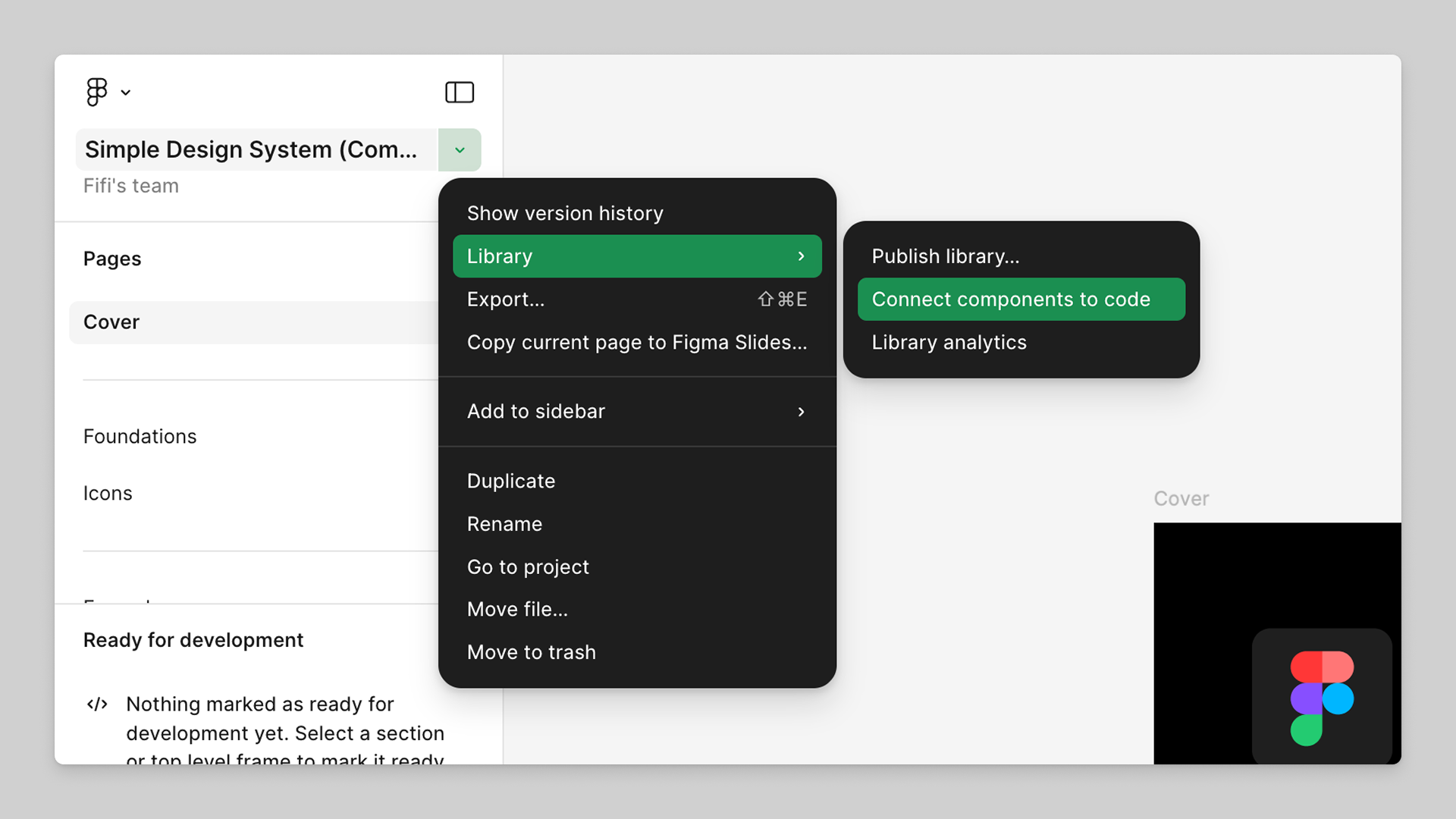

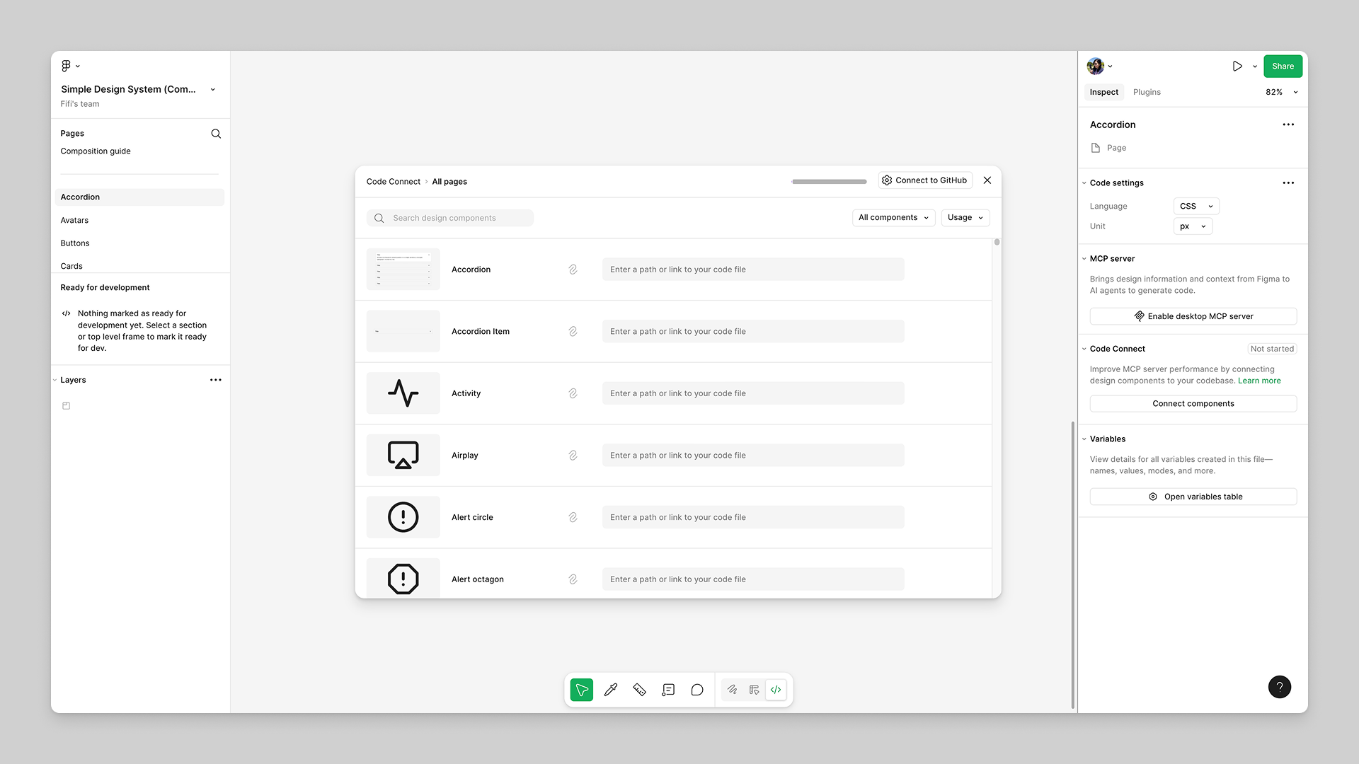

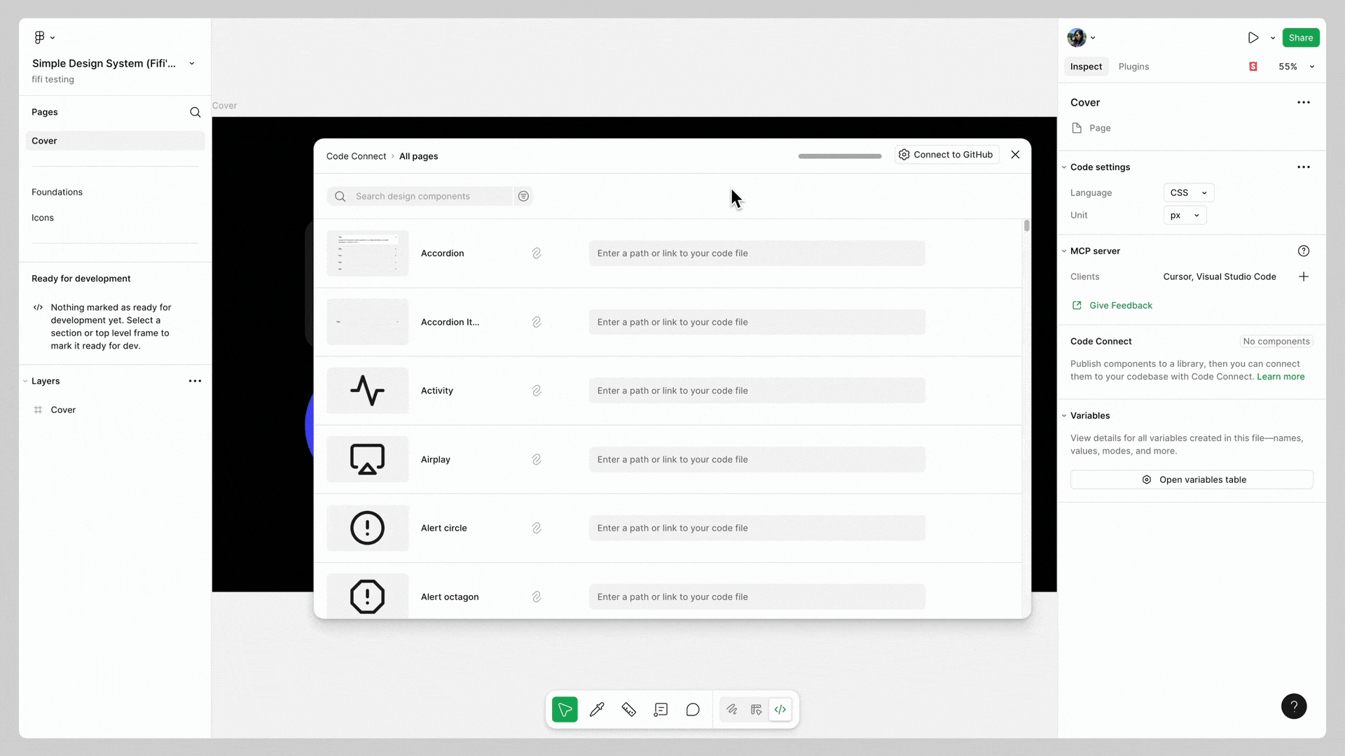

Once the library is published, we can open Code Connect UI.
- From the toolbar, switch to Dev Mode.
- From the dropdown menu next to the file name, choose Library → Connect components to code.

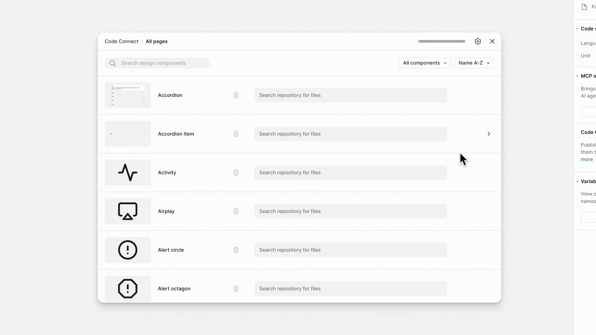

Here, Figma will display all of the components in the file. If you have many components in your library, you can search for specific components using the search bar, or filter or sort them using the dropdown menus on the right.
You can also go into each individual page and select “Connect components” from the right sidebar to view the components available in that specific page.

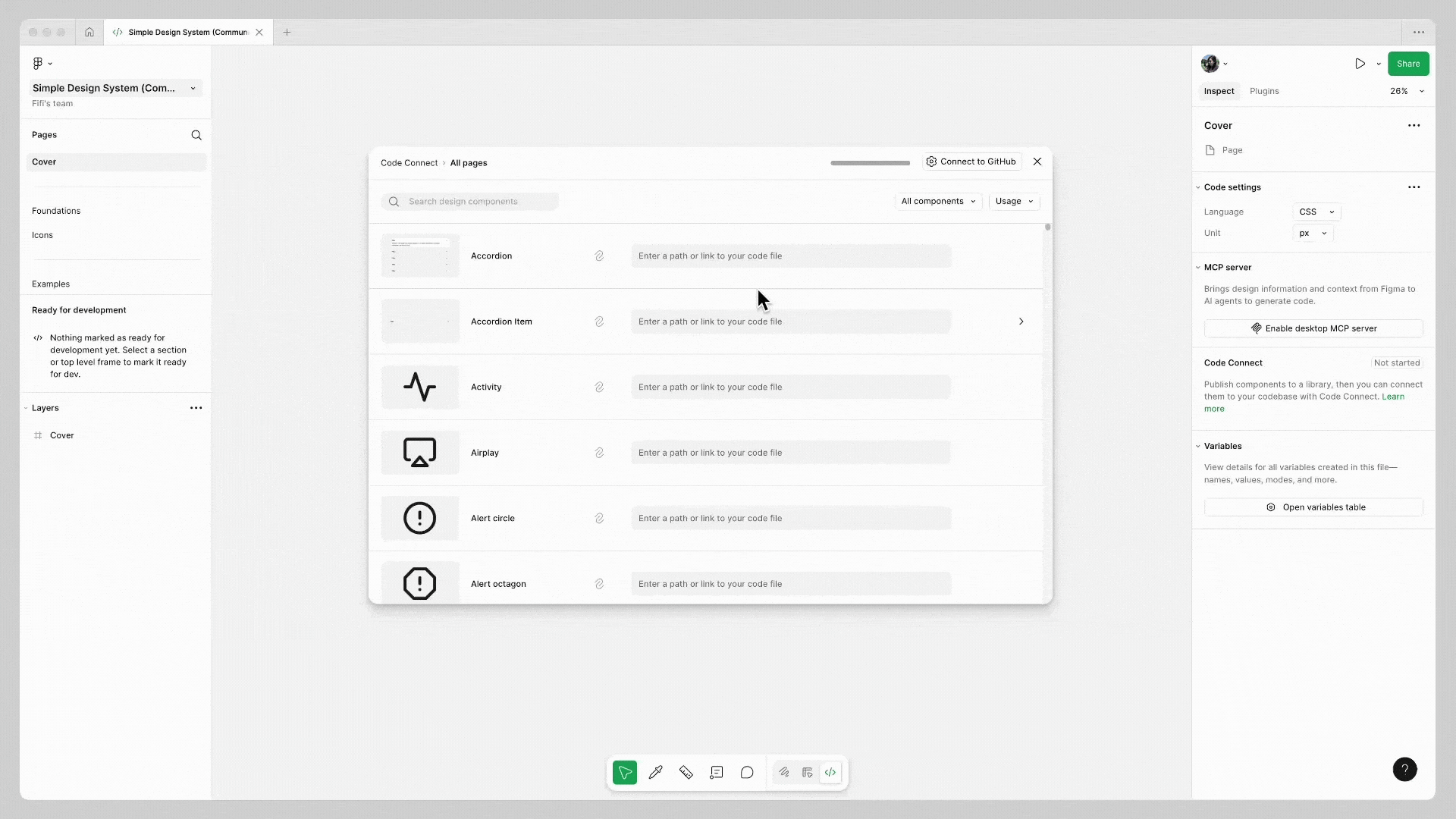

- Select the Settings icon in the Code Connect UI menu.
- Click Connect to Github. Since this is the first time we connect the GitHub account, you’ll need to go through the authentication process in Github.

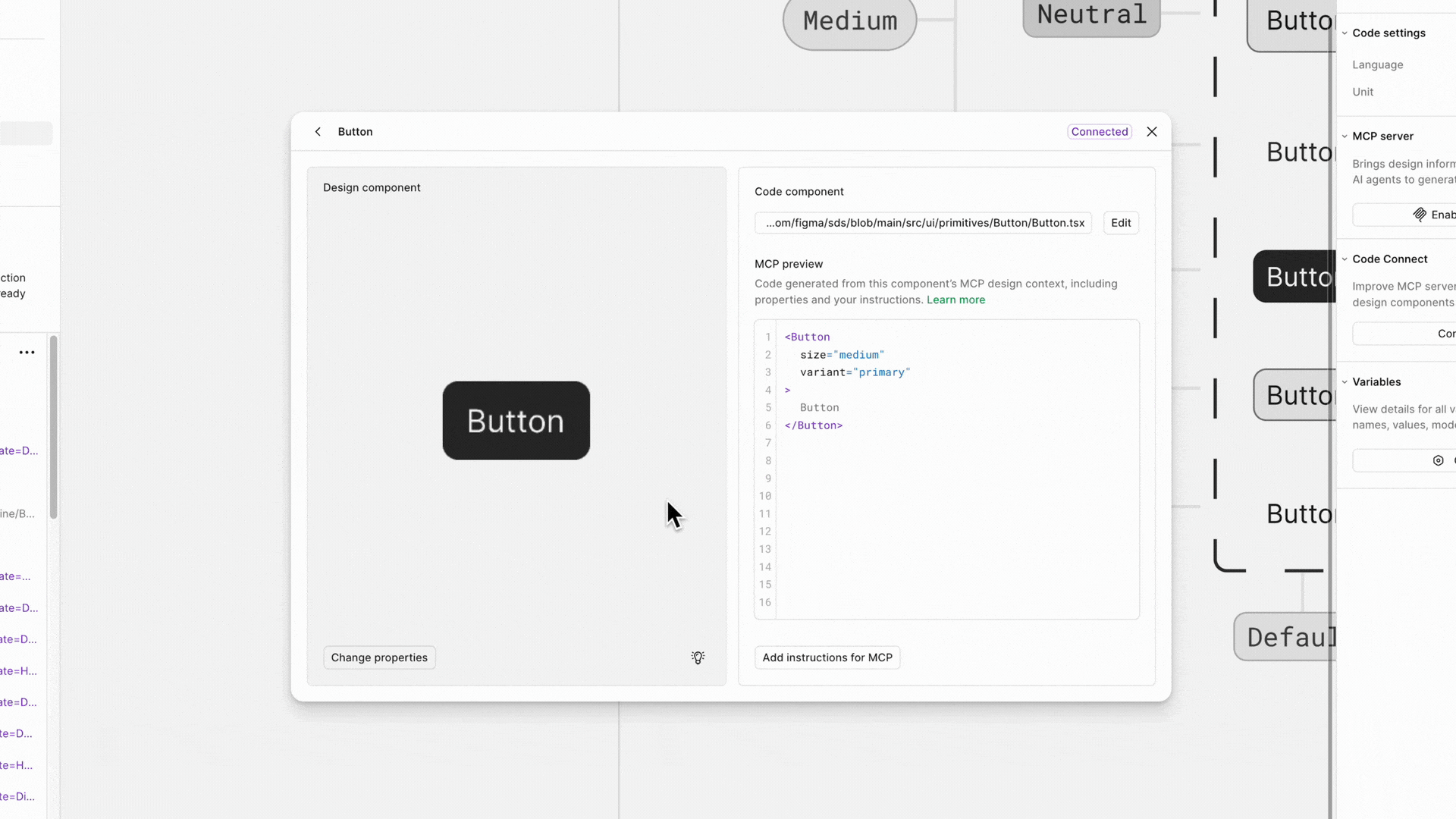

With the Github repository connected, you can now map your design component with your code component directly inside the Code Connect UI menu. Let’s try to connect this button component in the Simple Design System file to our codebase using Code Connect UI.
- In the Code Connect UI menu, search for “Button” in the search field.
- Select the Search repository for files input field of the Button component.
- From the dropdown menu, scroll through the list to select the correct code component path for the button component, or search for the keyword.
Click Connect.

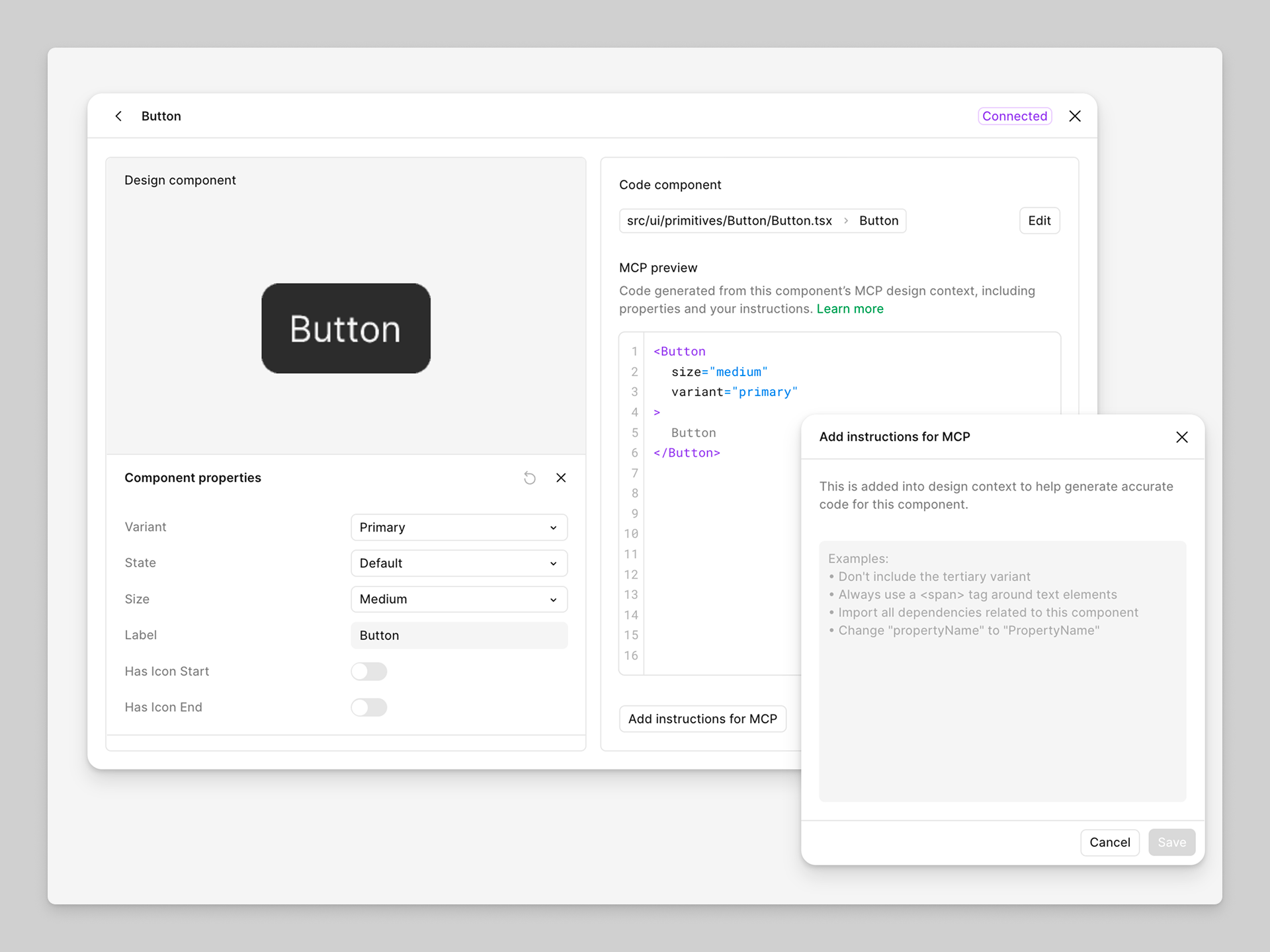

MCP Preview
Now that we have connected our button component, click to view the component and connection details. Here, you can see a side-by-side view of the design component and the code component, and the preview code of the button component, which will be sent to the agentic tools via the Figma MCP server.
Use Change properties to update the button’s component properties, and see the MCP Preview code reflects the change accordingly.
Add instructions for MCP
You can also add specific instructions for MCP to give extra design context for more accurate code generation.
- Click Add instructions for MCP.
- Add additional instruction in the textbox.
- Click the Save button.
A new MCP code preview will be generated based on the new instructions.
This is where the power of Code Connect comes in. Since now your design system file and your codebase is connected, it helps your agentic development tools build products even faster by giving direct references to your design and your codebase. This allows higher-quality code generation that’s aligned with your specifications.
