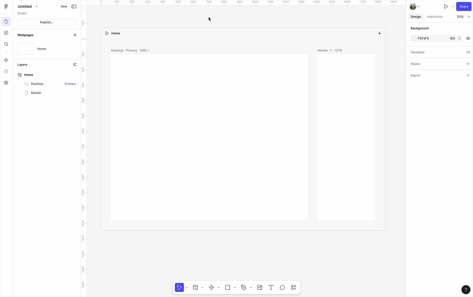

If you want to use website designs you’ve made in Figma Design, you can copy and paste their frames directly into Figma Sites with these steps:
- Select a frame in your Figma Design file and copy it.
- In your Figma Sites file, select an empty breakpoint you want to paste into. Not sure what to pick? Start with the Primary breakpoint.
- Paste the frame into the breakpoint.
- Make any adjustments to fine tune the design to fit the needs of each breakpoint.

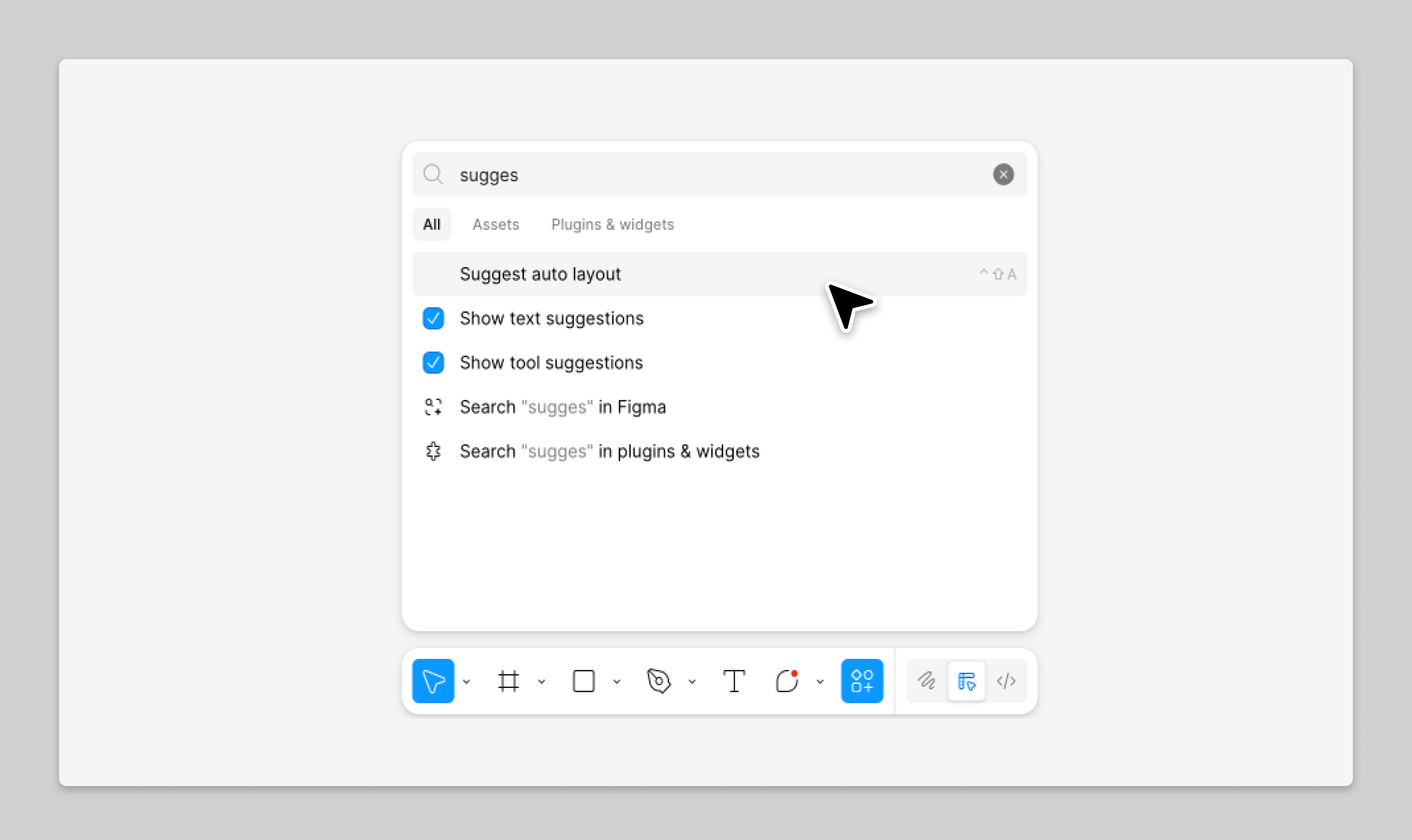

To use suggest auto layout:
- Select a frame that isn’t using auto layout.
Open the Actions menu:
- macOS: Command K
- Windows: Ctrl K
- Search for “Suggest auto layout”.
- Click on it, or highlight it and hit Enter.
- Figma will automatically apply auto layout to the selected frame and its nested frames. We still recommend checking the functionality in case it missed something.
