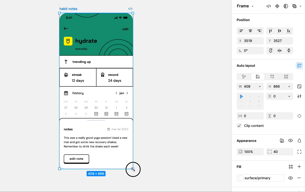

Add auto layout
To start using auto layout on designs, select one or more layers and press ⇧ Shift A or click Add auto layout from the right sidebar. Figma will try to determine which auto layout flow—vertical, horizontal, or grid—you want to use. You can switch to a different flow at anytime.
Learn more about toggling auto layout on designs.

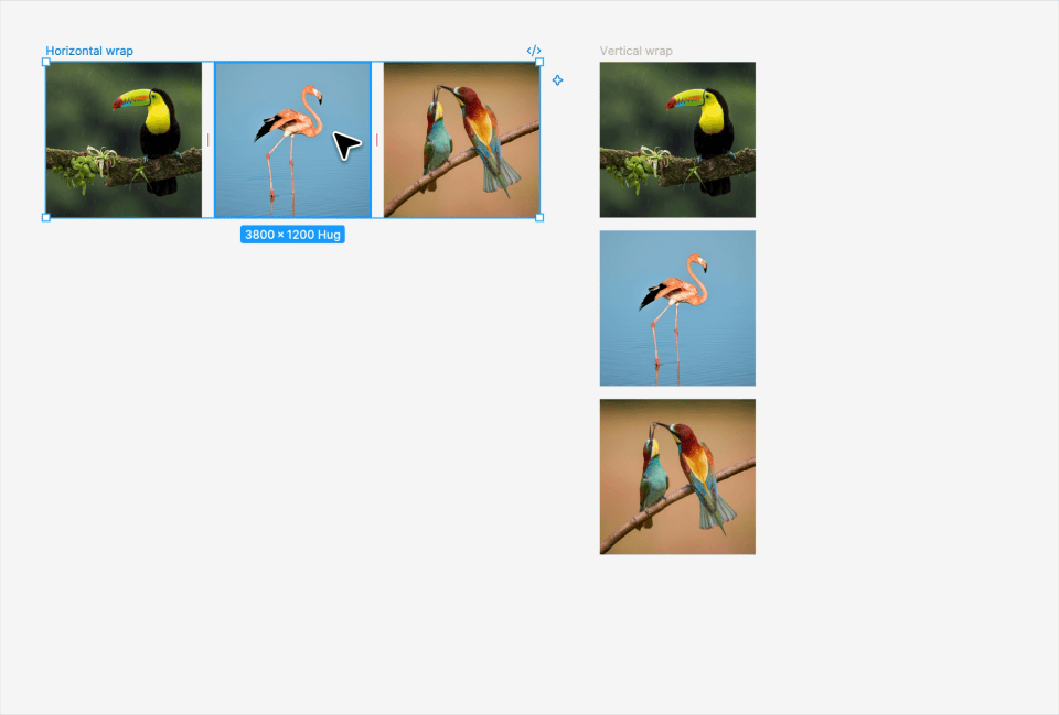

Horizontal and vertical
The Vertical option places objects in your frame along the y-axis. Any objects you add, remove, or reorder will follow the y-axis. For example: Multiple list items in a to-do list, or posts within a newsfeed or timeline.
The Horizontal option places objects in your frame along the x-axis. Any objects you add, remove, or reorder will follow the x-axis. For example: A row of buttons, or icons in a mobile navigation menu.
When you have the horizontal selected, Wrap becomes available. Wrap pushes any overflowing objects to the next line in your frame.
The horizontal and vertical auto layout options also have additional properties like resizing, spacing, alignment, and more.
Learn more about the horizontal and vertical auto layout flows.

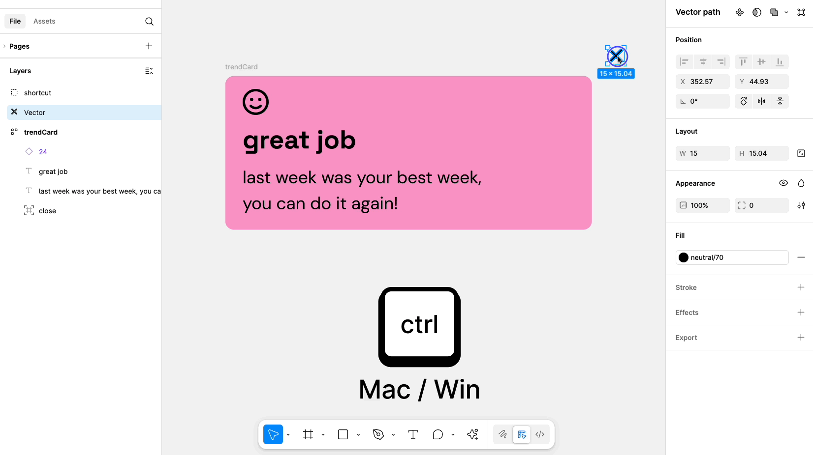

You can't apply constraints to child objects in an auto layout frame, unless the object ignores the auto layout flow. Instead, you can use the resizing property to define how objects respond as the frame, or the objects in the frame, resize.
You can still apply constraints to the auto layout frame itself if it's nested within a regular frame. The Constraints section and resizing options will appear, allowing you to set both the constraints for the Auto layout frame and the resizing behavior for any objects within it.
For example: Let's say we a habit logging app where each habit gets an analytics screen containing a calendar history of habit completions and a panel at the bottom for notes on any given day. This screen uses auto layout, but the notes panel ignores the auto layout flow. We can use set constraints Bottom and Left and right to make sure the notes panel responds correctly when its parent frame is resized.
