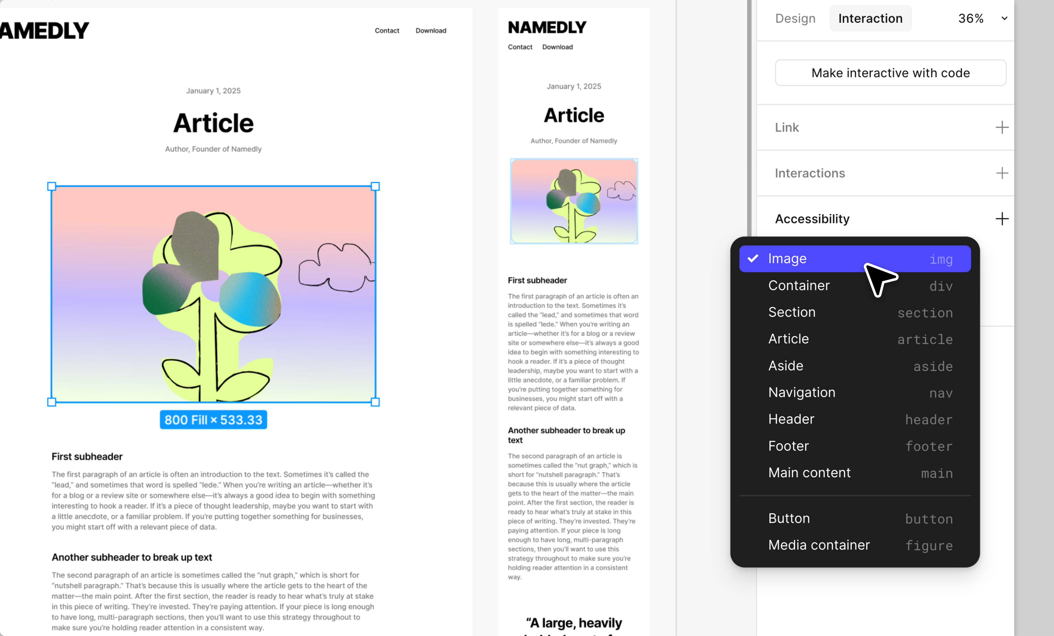

Select an element of your design and apply HTML tags and accessibility properties from the Accessibility section in the right sidebar.

- Add alt text to images that need description, or mark it as decorative. Keep alt text concise and functional—focus on the purpose of the image, and not its appearance.
- Set the correct HTML tag. Use a role only when no semantic tag fits.
- Add labels when visible text is missing or unclear.
- Mark purely decorative elements as hidden.

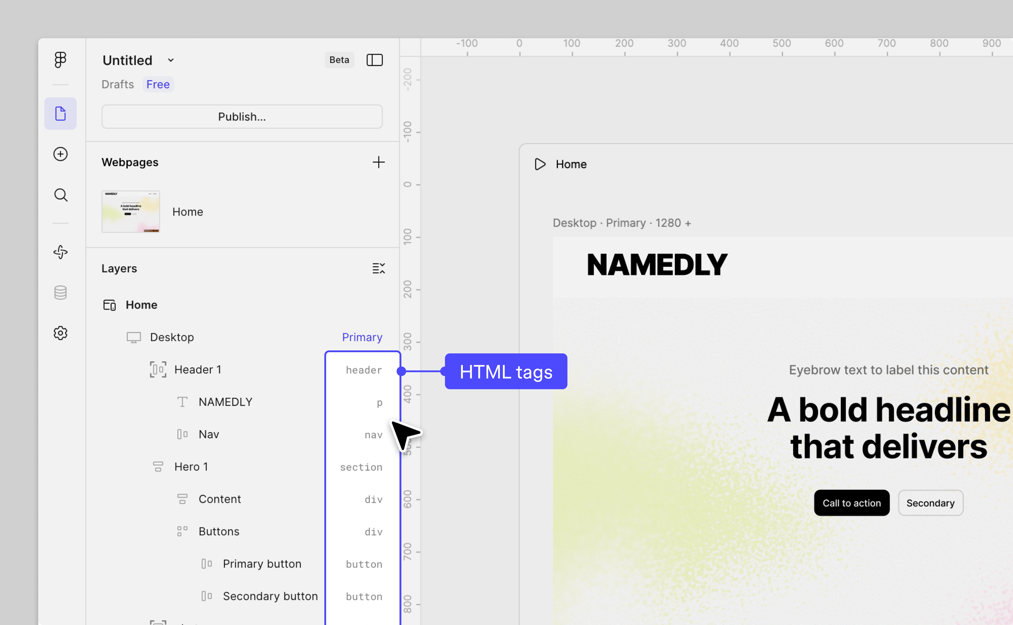

Automatic tags
The Layers panel shows each layer’s assigned HTML. By default, most layers will use a div tag. Figma also automatically applies these tags:
- Text layers use the
ptag. - Frames and rectangles with a media fill use
imgorvideo. - Layers with a link applied use an
atag. - Layers with on click interactions use the
buttontag.
