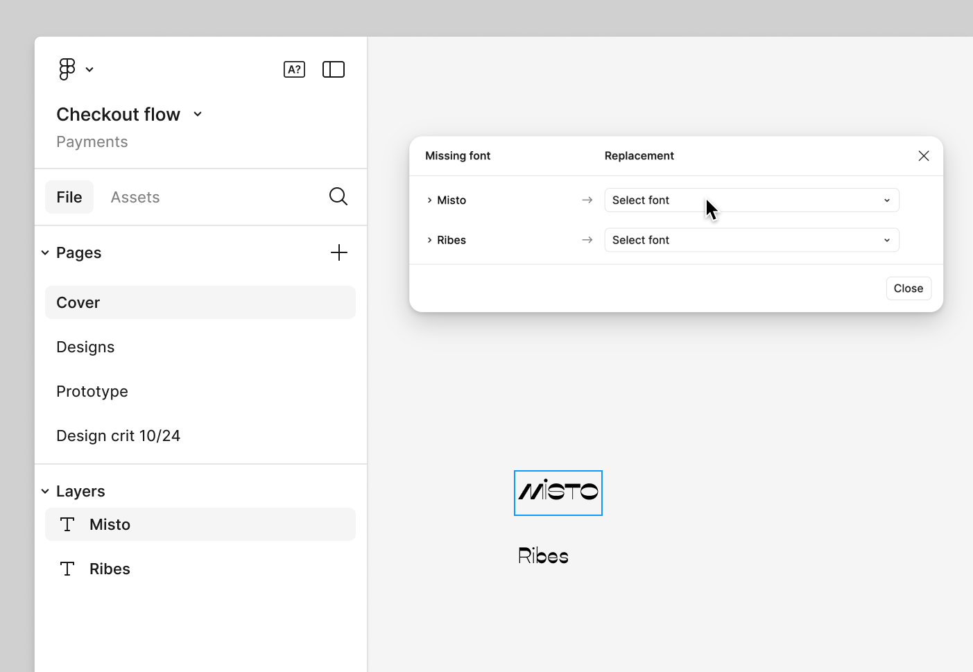

Replace the missing font with an existing one
The missing fonts modal allows you to quickly update affected text layers, so you can update the font to one that already exists. This could be a font that’s already installed or a Google font, which is always available in Figma. You can use this approach to select an alternative font to use in your files. Updating the font applies to everyone in the file, not just you.
Note: Updating the font applies to all collaborators, including those with access to the original font. You may want to save a version of the file before you do, in case you need to reverse those changes.
- Click in the left sidebar.
- View a list of fonts and styles that are missing or unavailable in this file:
- Use the dropdown fields below Replacement to update the family and style for each missing font. Figma will only show you fonts available to you.
- Click Replace fonts to complete the process. All text objects in the file will be updated to the new fonts.
