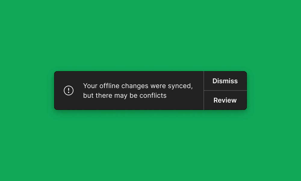

If you're working on a file with others, there may be some differences between the latest version of the file and your offline changes.
Figma will let you know if there are any conflicting changes via a notification. Click Review to open the file's version history, or Dismiss to ignore.
If something was synced incorrectly, or you don't want to keep the offline changes, you can restore a previous version of the file in the file's version history. Learn how to view and manage version history →
