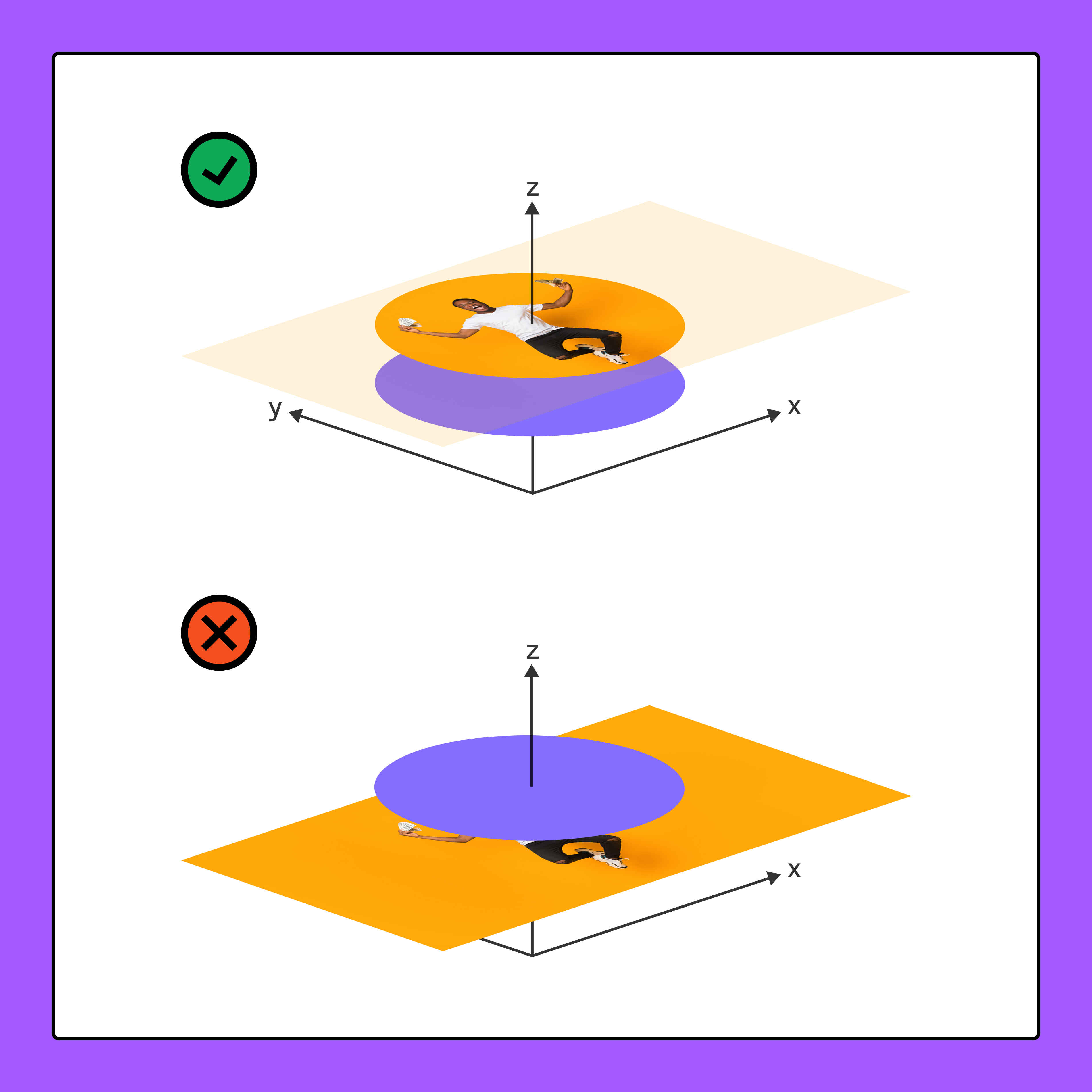

Masks are positioned below masked layers on the z-axis. The mask applies to all siblings above it until it reaches:
- Another mask or mask object
- The mask's parent frame or group
- A frame or component with clip content on
Learn more about parent, sibling, and child relationships.
In the example below, the purple ellipse is acting as the mask. If the mask sits below the image of the person on the z-axis, it'll successfully mask that image. If the mask sits above the image, it won't be masked.
