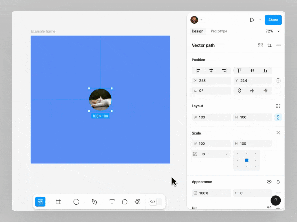

To resize an object using the scale tool:

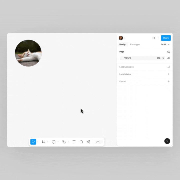

- Activate the scale tool by pressing K, or by clicking in the toolbar and selecting Scale.
- Select an object.
- Scale the object by doing one of the following:
- Click and drag: Hover over the object’s bounding box to make the cursor appear. Then, click-and-drag to resize.
- Scale multiplier: Use the scale multiplier, in the Scale panel of the right sidebar. Open the dropdown to select a multiplier, or type a multiplier in the text field and press Enter / Return to apply.
Dimensions fields: Use either the width or height fields, in the Scale panel of the right sidebar. Type a number in either field and press Enter / Return to apply. The other dimension field will automatically update.

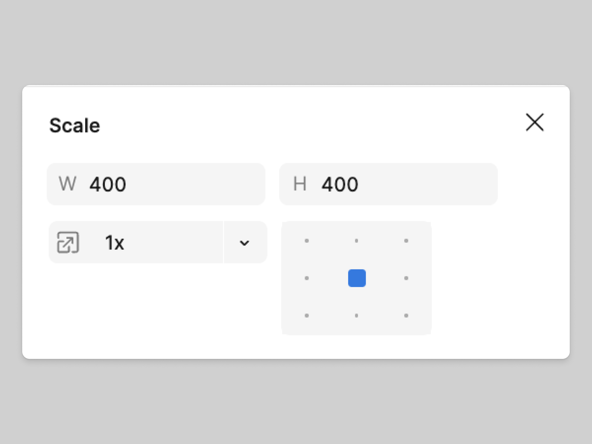

Set scale direction
The anchor box in the scale panel allows you to set which direction an object scales when using the scale multiplier or dimension fields.
You use the anchor box to set the object’s anchor point, which tells Figma which side of the object to stay put. Once you scale your object, it scales in the opposite direction of the anchor point.
For example, if the anchor point is set to center, the object’s center stays put and resizes in all directions. If you set the anchor point to the top-left, an object will resize down and to the right.
