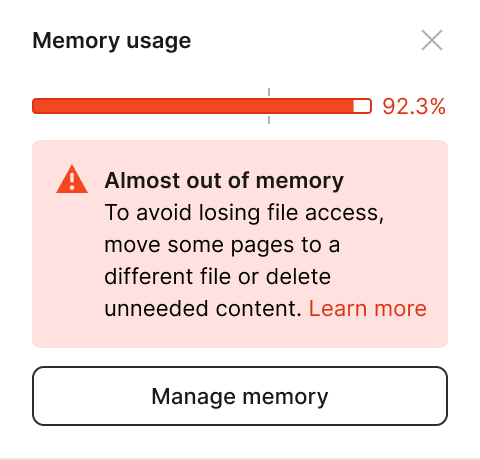

- Select Memory usage. The memory usage will appear as a meter in your left sidebar.
- Click Manage memory.
- From the Manage memory modal, toggle Show memory in layers panel. This allows you to view how much memory your layers and components are using.
Tip: You can also view Memory-reduction tips in the modal for best practices to manage your file's memory.

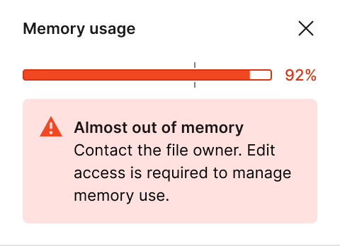

When you reach 75% of your memory limit, Figma will show a red alert tile in the left sidebar. You cannot dismiss this alert.
View only access
Edit access
You can still make changes to the file, but we recommend taking immediate action to protect your work. Failure to reduce memory usage now will increase the possibility of data loss.
Click Learn more to view suggestions for reducing memory usage or follow the tips we've outlined below ↓
