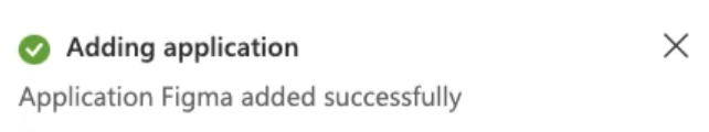

- Click Create to add the application to Entra ID
- Entra ID will show a success message and redirect you to the Figma application overview:

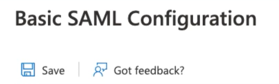

- Under Basic SAML Configuration, click Edit to make changes
- Switch to the Figma tab in your browser.
- Next to the Tenant ID, click Copy
- Switch to the Entra ID tab in your browser.
- Under Identifier (Identity ID), click Add identifier
- Type in
https://www.figma.com/saml/in the field provided, then paste your Tenant ID to complete the URL. - Copy the entire URL from the field to your clipboard.
- Under Reply URL (ACS link), click Add reply URL.
- Paste the identity URL in the field, then add
/consumeto the end of the link. - In the Sign on URL (Optional) field, paste the identity URL again, then add
/startto the end of the link. - Click Save at the top of the screen:

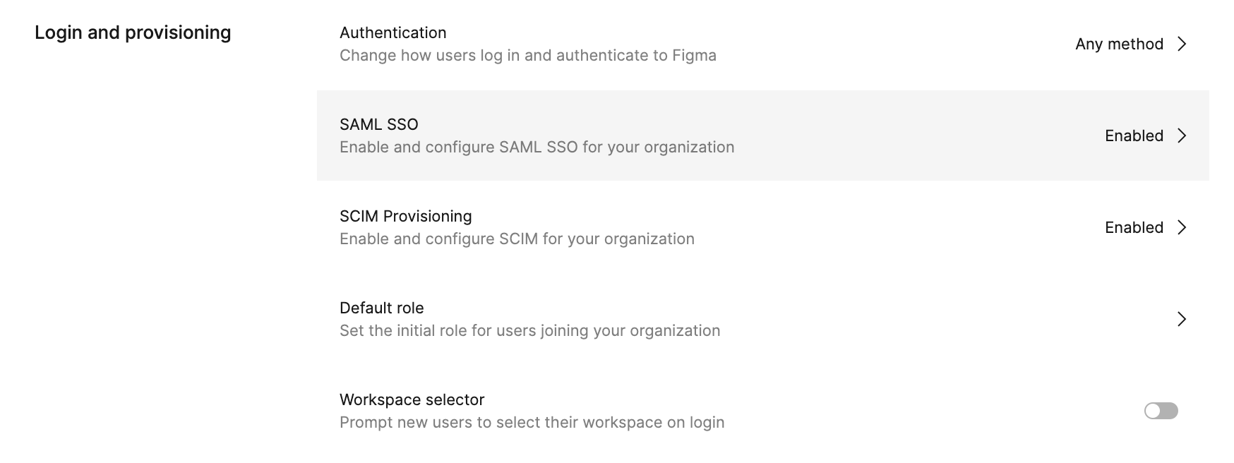

- Click Configure SAML SSO. Figma will return you to the Settings tab where you’ll see SAML SSO is now enabled:

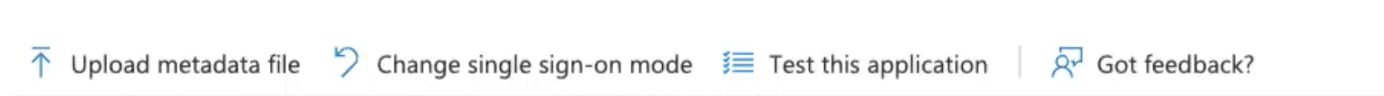

- Select Test this application at the top of the page.
- Click the Test sign in button. Entra ID will open a new tab and log you into Figma using SAML SSO.
