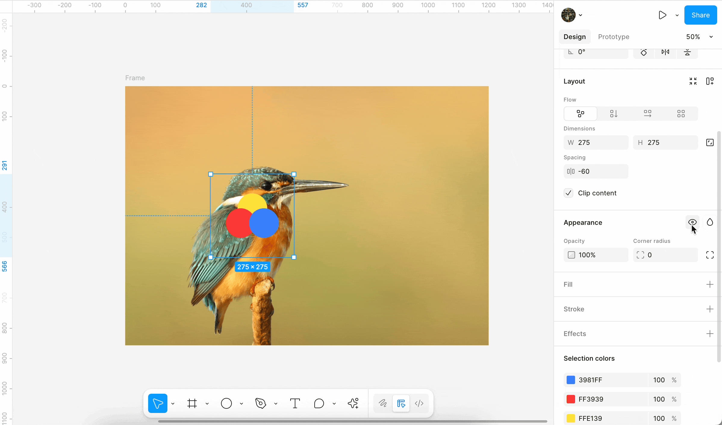

Apply a blend mode
You can apply a blend mode to an entire layer, individual fills, and certain types of effects. Each layer, fill, or effect can only have one blend mode applied.
To apply a blend mode:
- Select the layer you wish to apply a blend mode to.
- Do one of the following:
- Apply a blend mode to the entire layer: Click Apply blend mode in the Appearance section of the right sidebar.
- Apply a blend mode to a fill or stroke fill: Open the color picker in the Fill or Stroke sections of the right sidebar, then click Apply blend mode.
- Apply a blend mode to an effect: You can apply blend modes to inner shadows, drop shadows, and noise effects. Select the effect in the right sidebar, then click Apply blend mode.
- Choose a blend mode option from the dropdown menu. Hover over each option to see a live preview on the canvas. Experimenting with different blend modes can reveal unexpected color relationships and add visual interest to your designs.
Note: Blend modes cannot be applied to fills that use color styles. Instead, apply the blend mode to the entire layer or to the color style itself.

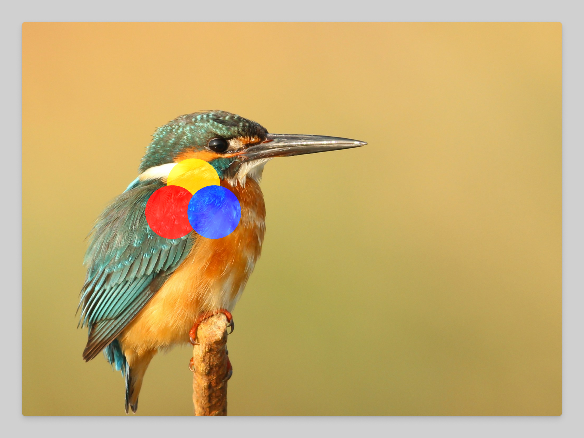

Pass through
Pass through is the default mode for layers. This mode produces no visible effect on its own but enables other blend modes to take effect.
On individual layers, Pass through enables blend modes applied to the layer’s fills and effects to interact with content below the layer.
On parent layers, such as frames or groups, Pass through allows blend modes on child layers to interact with content beneath them, instead of stopping at the parent layer.
The following image demonstrates the difference between using Normal and Pass through on a parent layer that has child layers with blend modes applied:
Note: Pass through cannot be applied to fills or effects.
Normal
Normal is the default mode for fills and effects. Normal displays colors exactly as they are, with no blending.
When applied to an individual layer, Normal prevents blend modes applied to the layer’s fills or effects from interacting with content below the layer.
When applied to a parent layer, Normal restricts blend modes applied to its child layers from interacting with content below the parent layer.

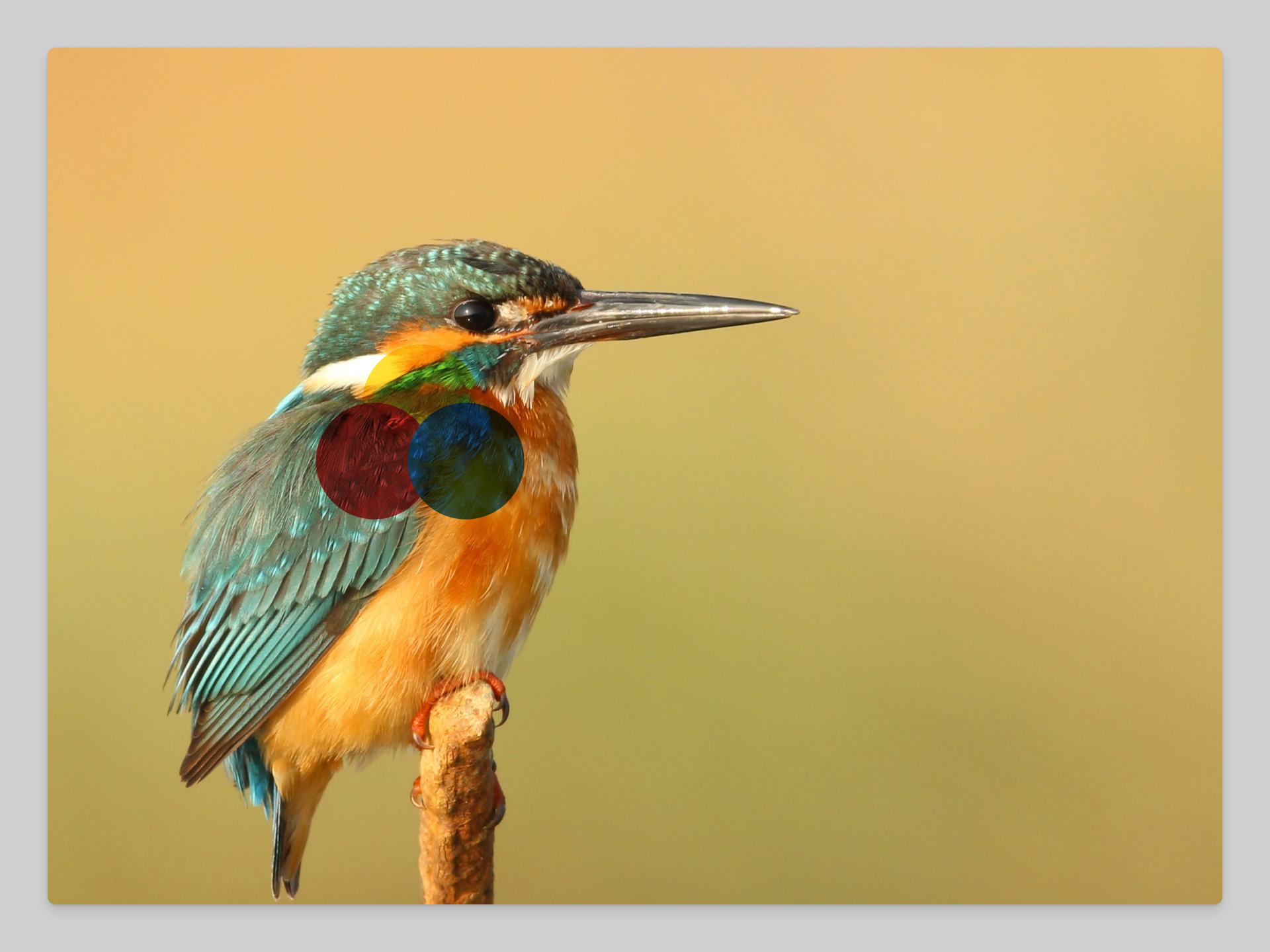

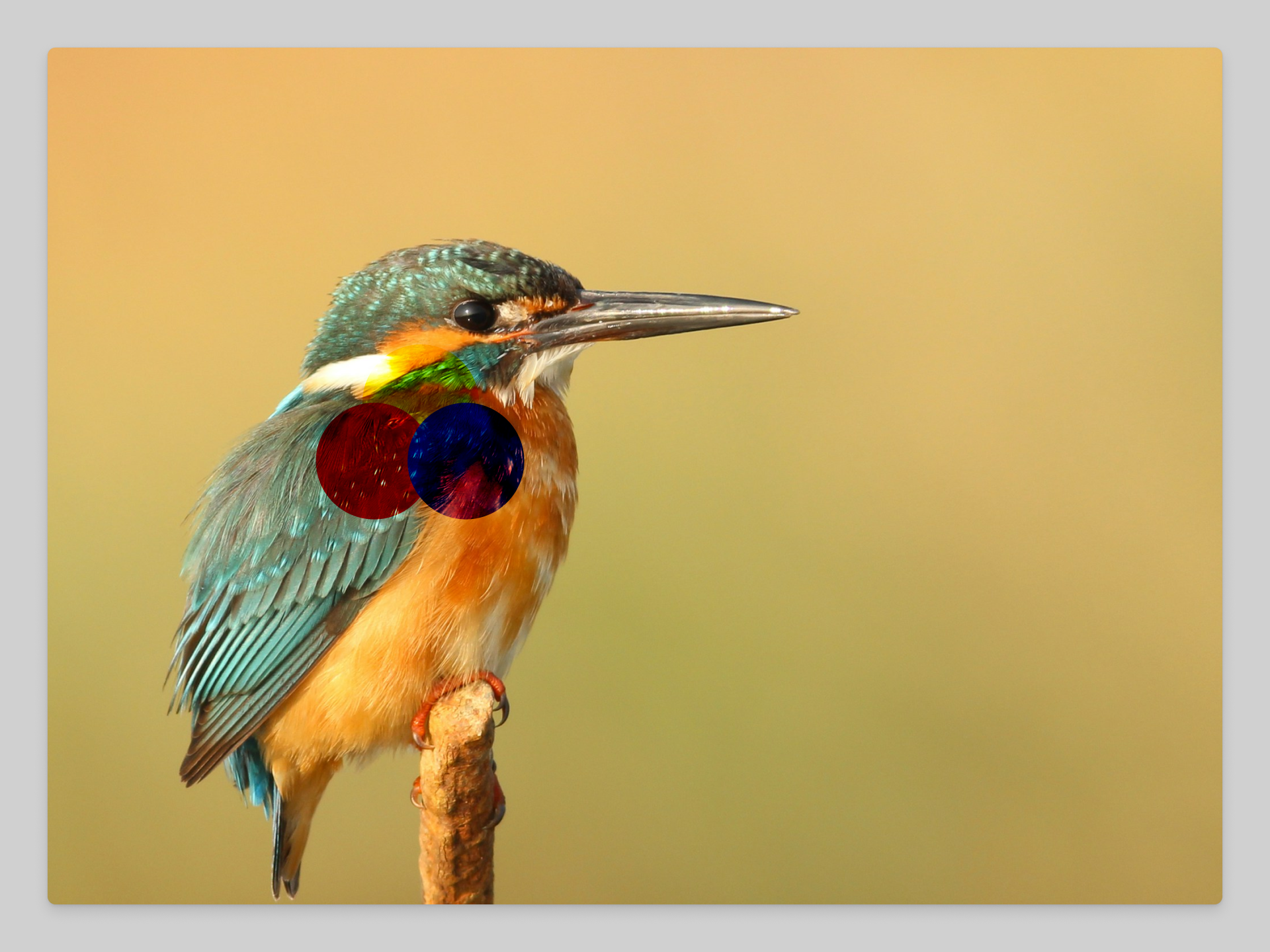

Darken
Darken compares the base and blend colors and selects whichever is darker as the result. Colors lighter than the blend color are replaced. Colors darker than the blend color do not change.
Multiply
Multiply combines the base and blend colors by multiplying their values, always producing a darker result. Blending with black results in pure black. Blending with white preserves the original color.
Plus darker
Plus darker works similarly to Darken, but with a stronger impact on mid-tones. Blending with white produces no effect.
Color burn
Color burn uses the blend color to darken the base color, increasing the contrast between them. Blending with white produces no effect.

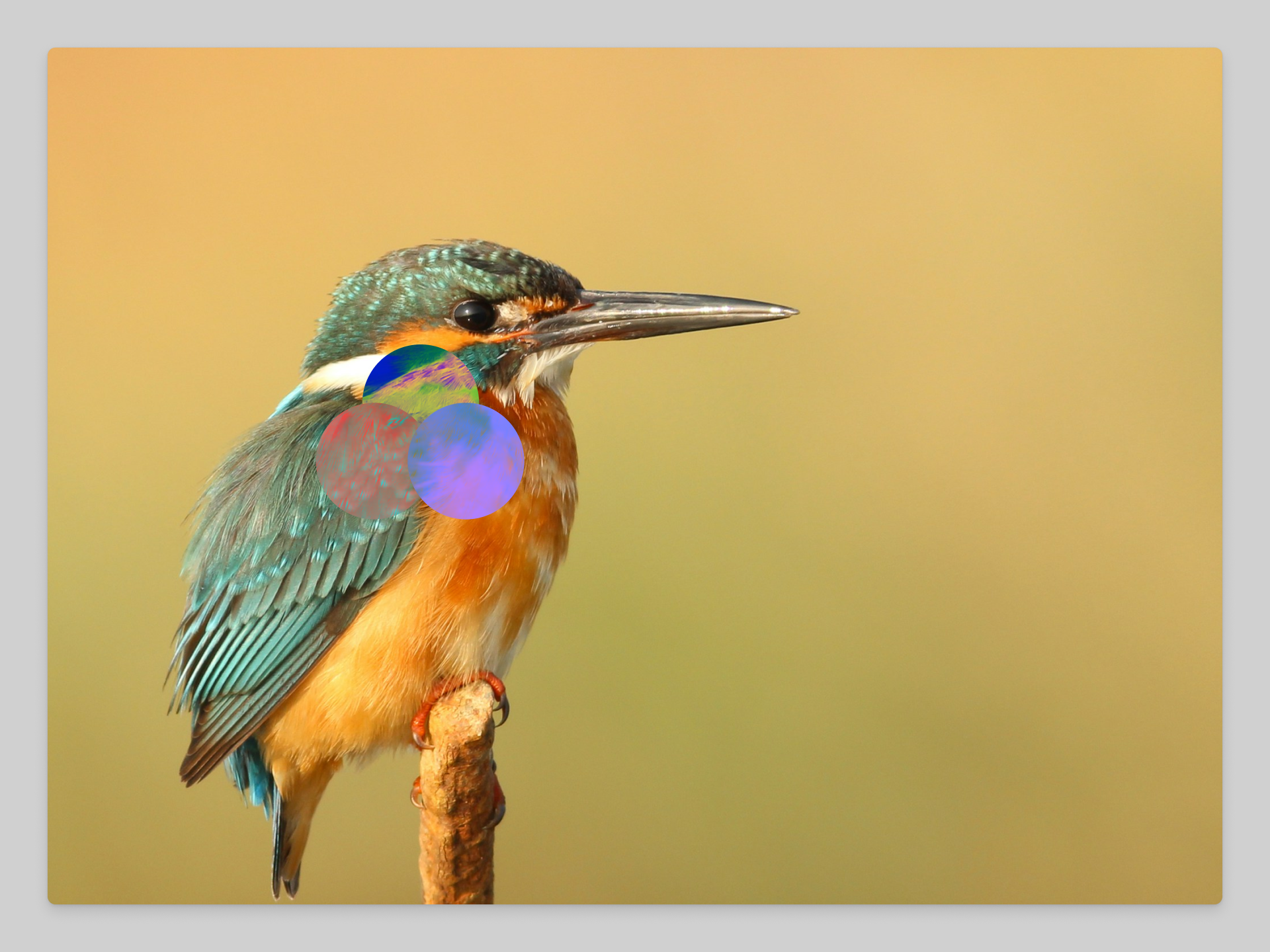

Lighten
Lighten compares the blend and base colors and selects whichever is lighter. Colors darker than the blend color are replaced. Colors lighter than the blend color do not change.
Screen
Screen multiplies the inverse of the base and blend colors, always producing a lighter result. Blending with white produces pure white. Blending with black preserves the original color.
Plus lighter
Plus lighter works similarly to Lighten but with a stronger impact on mid-tones. Blending with black produces no effect.
Color dodge
Color dodge uses the blend color to lighten the base color, reducing the contrast between them. Blending with black produces no effect.
