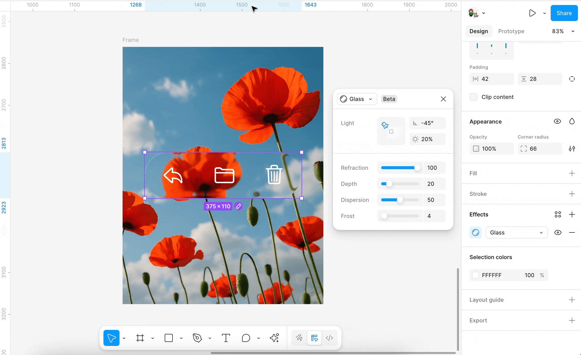

Glass open beta
The glass effect gives frames a translucent quality that dynamically alters the appearance of objects beneath them. Glass can only be applied to frames, and only one glass effect can be applied per frame.
Note: Glass is currently in beta. We expect to add new functionality throughout the beta period. You may experience performance issues when using the glass effect on complex designs.
Tip: Check out the Glass effect playground file for more hands-on learning opportunities.
Key considerations
There are some limitations when using glass:
- Glass cannot be applied to frames with mixed corner radii. All corners must have the same radius value for the effect to render.
- When you layer a glass frame over another, the background glass will not factor into the rendering of the foreground glass.
- Glass will not be visible on frames with a fill set to 100% opacity.
- Glass does not support environmental reflections.
- Glass is not supported when exporting to SVG.
- Glass is not available in Figma Sites.
There are some additional things to keep in mind when using glass and background blurs:
- You cannot combine a background blur and glass effect on the same layer. If both are applied, only the first effect encountered will be rendered. This is because glass and background blurs render in the same visual layer, creating a conflict when multiple effects are applied to a single layer.
- Layering a frame with a background blur on top of a glass frame will prevent the glass effect from rendering. A glass frame layered on top of a frame with a background blur will render correctly.
Apply a glass effect
To apply a glass effect:
- Select a frame.
- Click the plus in the Effects section to add a new effect.
- Choose Glass from the dropdown menu.
- Open the Effect settings menu to configure the effect:
- Light angle: The direction from which light is projected onto the frame.
- Light intensity: The brightness of the projected light.
- Refraction: The degree of optical distortion along the curved edge.
- Depth: How far the curved edge extends inward from the frame’s border. Higher values create a more domed appearance.
- Dispersion: The intensity of chromatic splitting along the curved edge. Higher values create a stronger rainbow effect.
- Frost: The amount of background blur present on the glass.

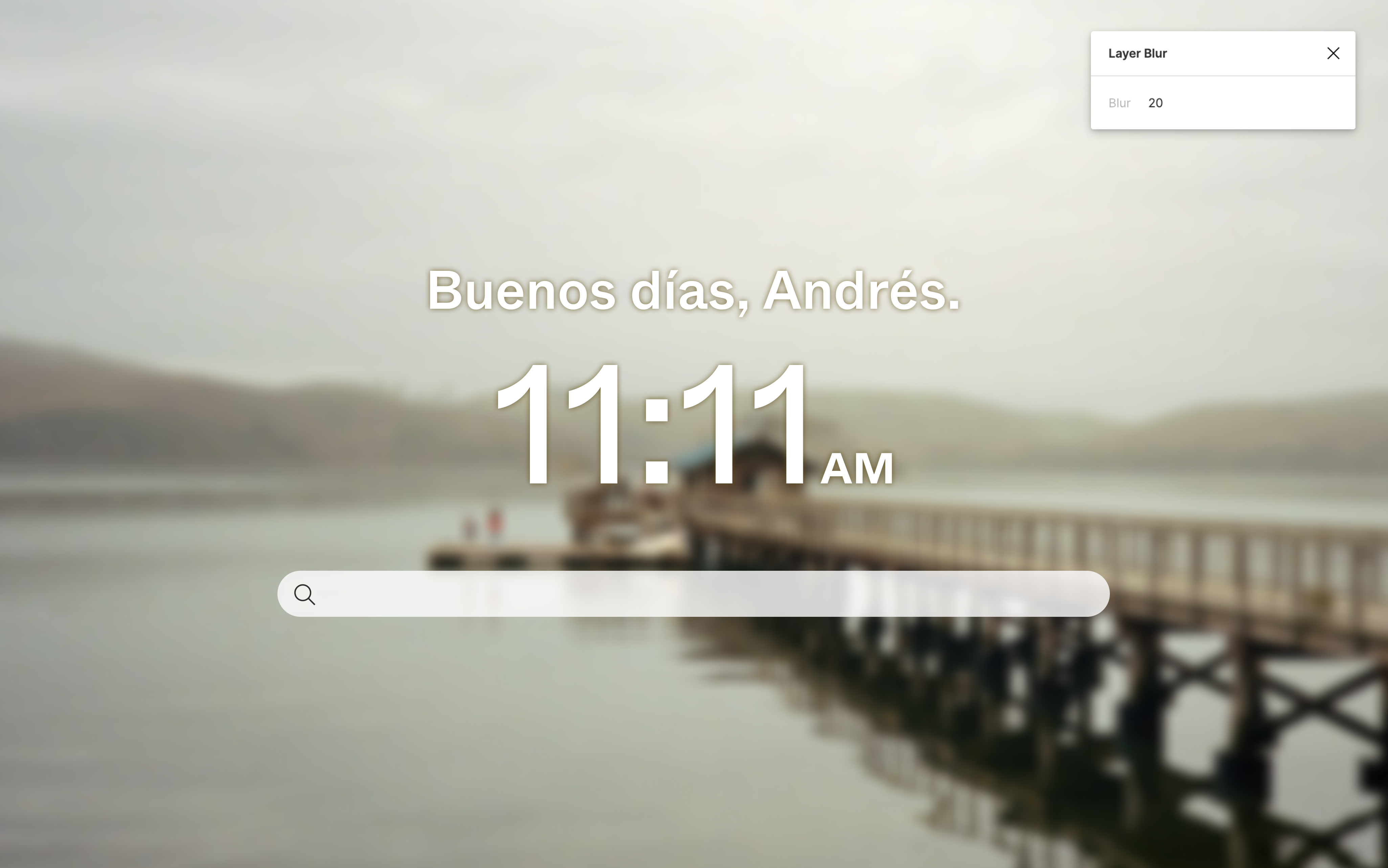

Layer blur
Blurs help to imply action or movement, or create the illusion of depth in two-dimensional designs. Use layer blur to:
- Anonymize information
- Soften or detract focus from the background
- Create abstract backgrounds from photographs and images
- Replicate camera depth and other photographic effects like bokeh
There are two types of layer blurs:
- Uniform: Applies the same blur across the entire layer
- Progressive: Allows you to control the blur’s size, direction, and intensity where it starts and ends

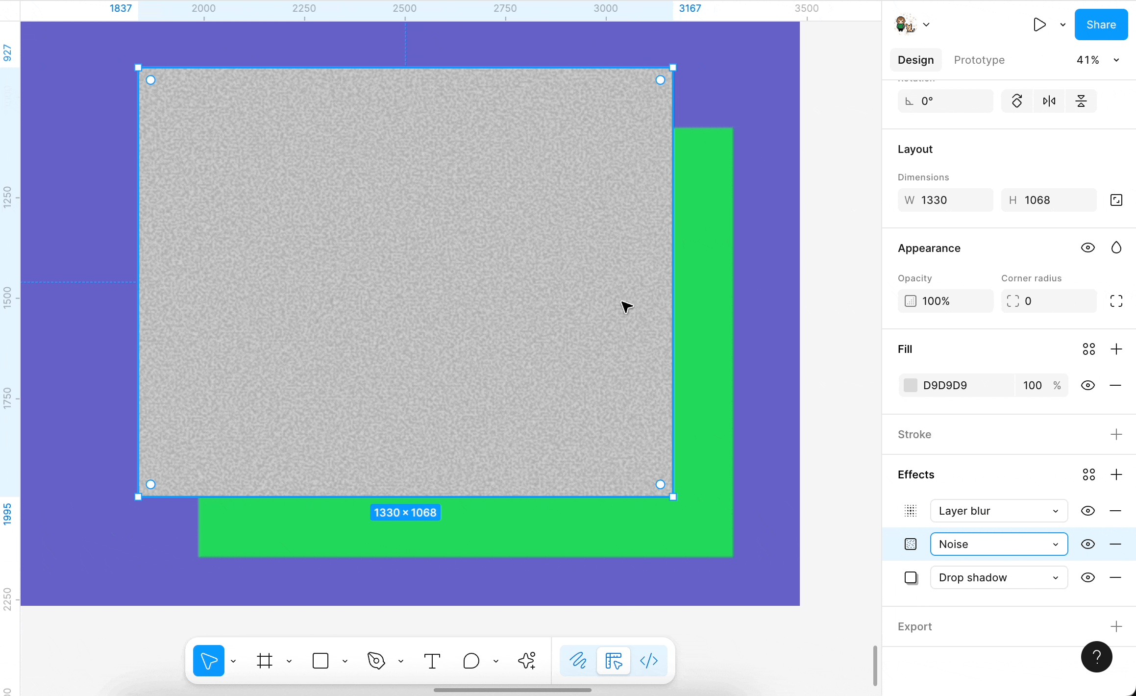

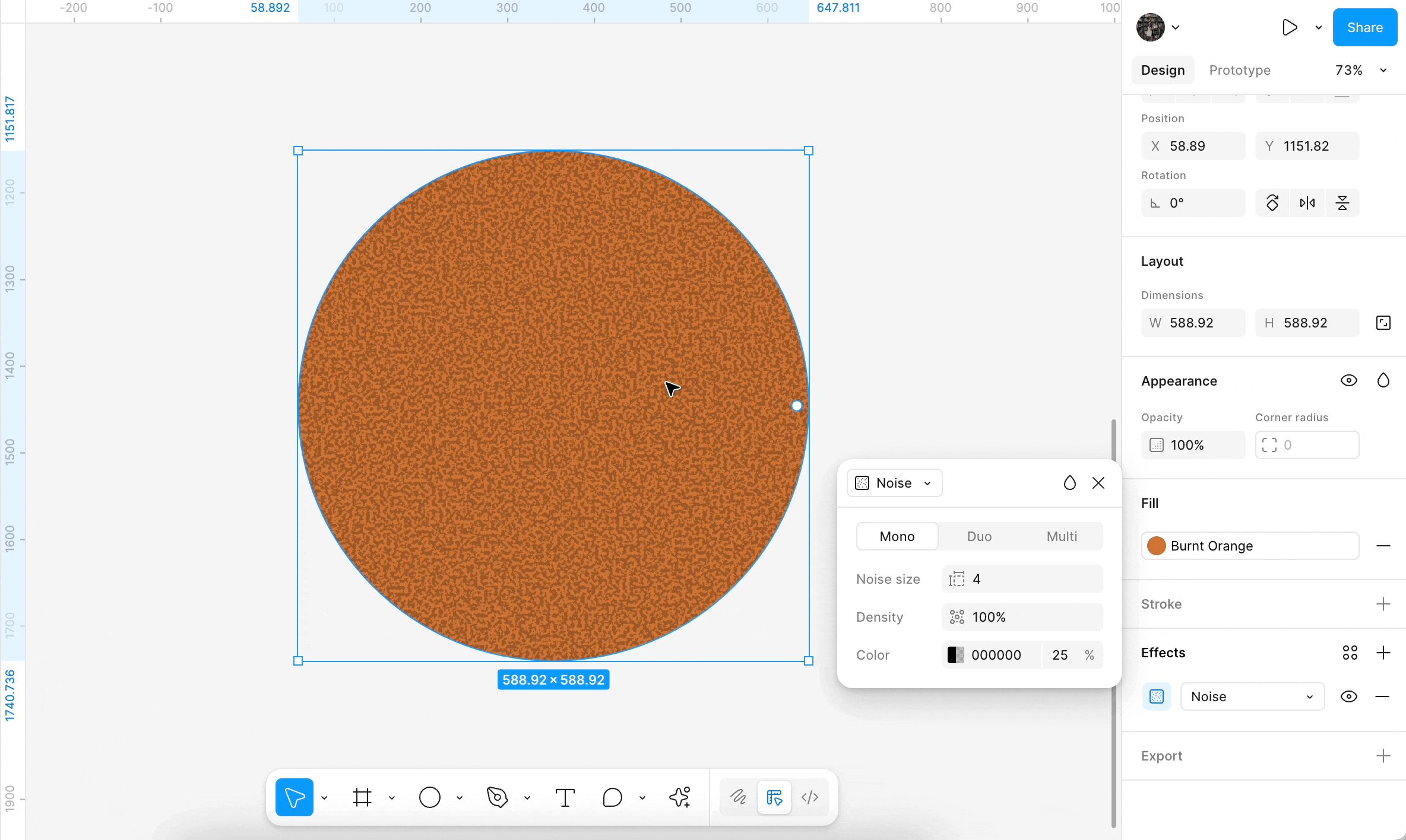

Noise
The noise effect applies random pixels to a layer, giving it a subtle grainy texture that mimics the visual characteristics of film photography.
Apply noise effects
You can apply noise effects to any layer type. It’s only possible to add two noise effects per object.
To apply a noise effect:
- Select the layer.
- Choose Noise from the dropdown menu.
- Number of colors: Choose between Mono (one), Duo (two), or Multi (many) to determine how many colors will be included in the noise
- Noise size: Adjust the scale of the noise pixels
- Density: Set the concentration of noise pixels
- Color (Mono or Duo only): Choose the desired color and opacity for the noise pixels
- Opacity (Multi only): Set the opacity for the noise pixels

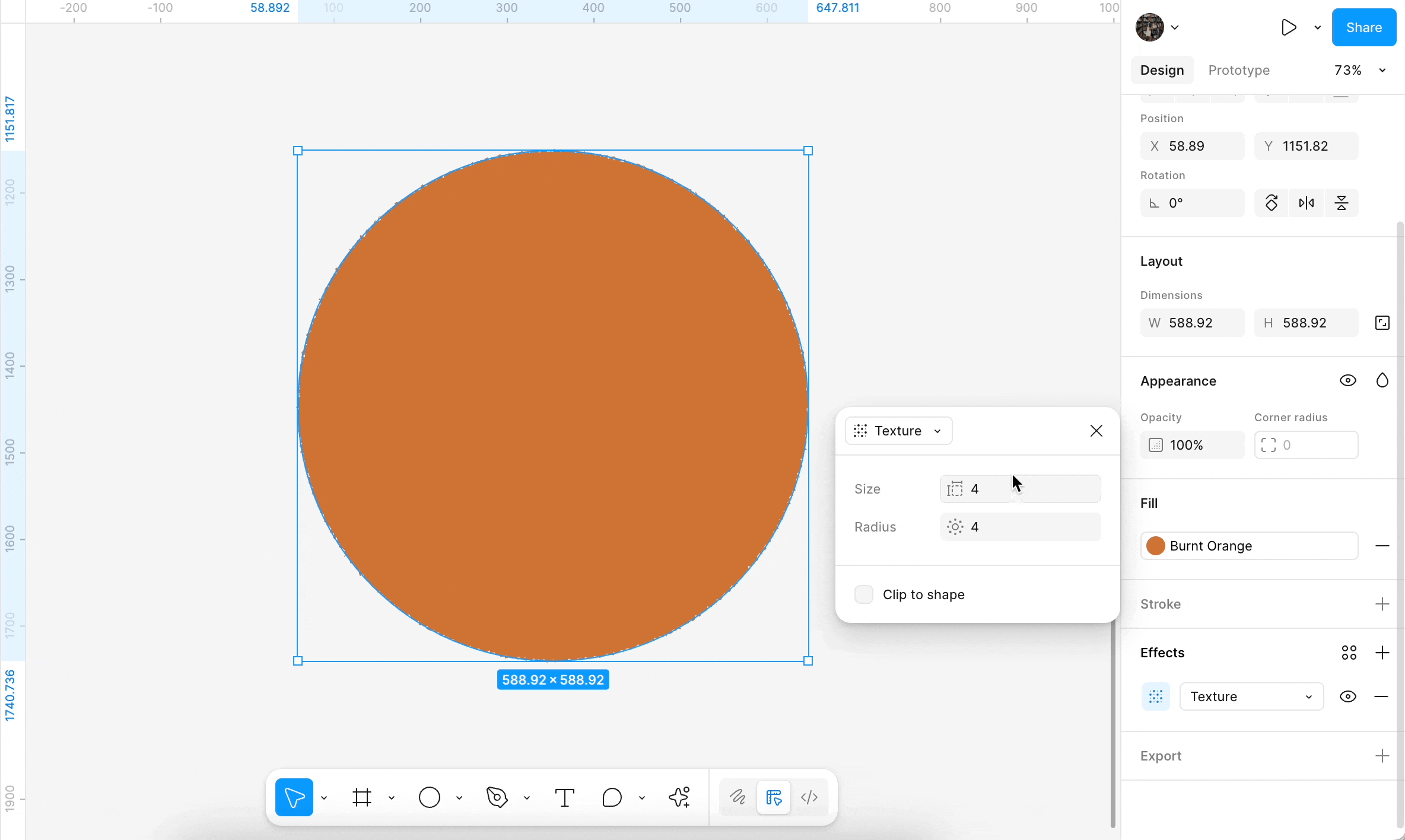

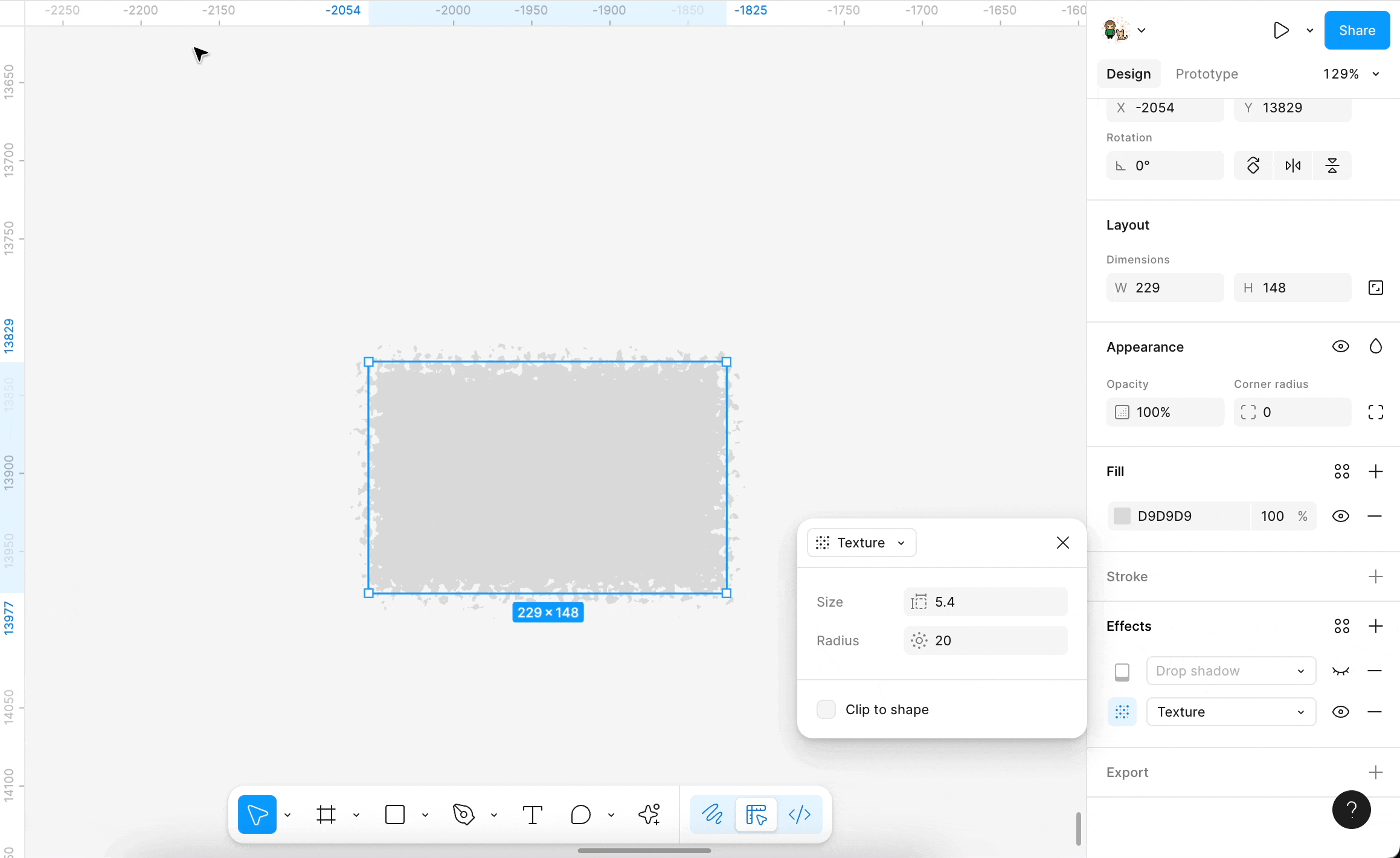

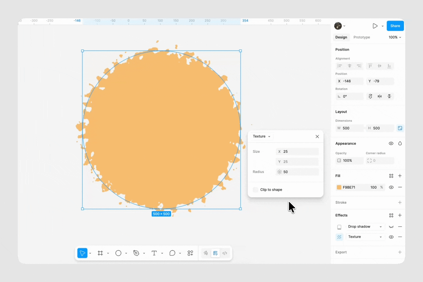

Texture
The texture effect distresses an object's edge, creating a roughened effect.

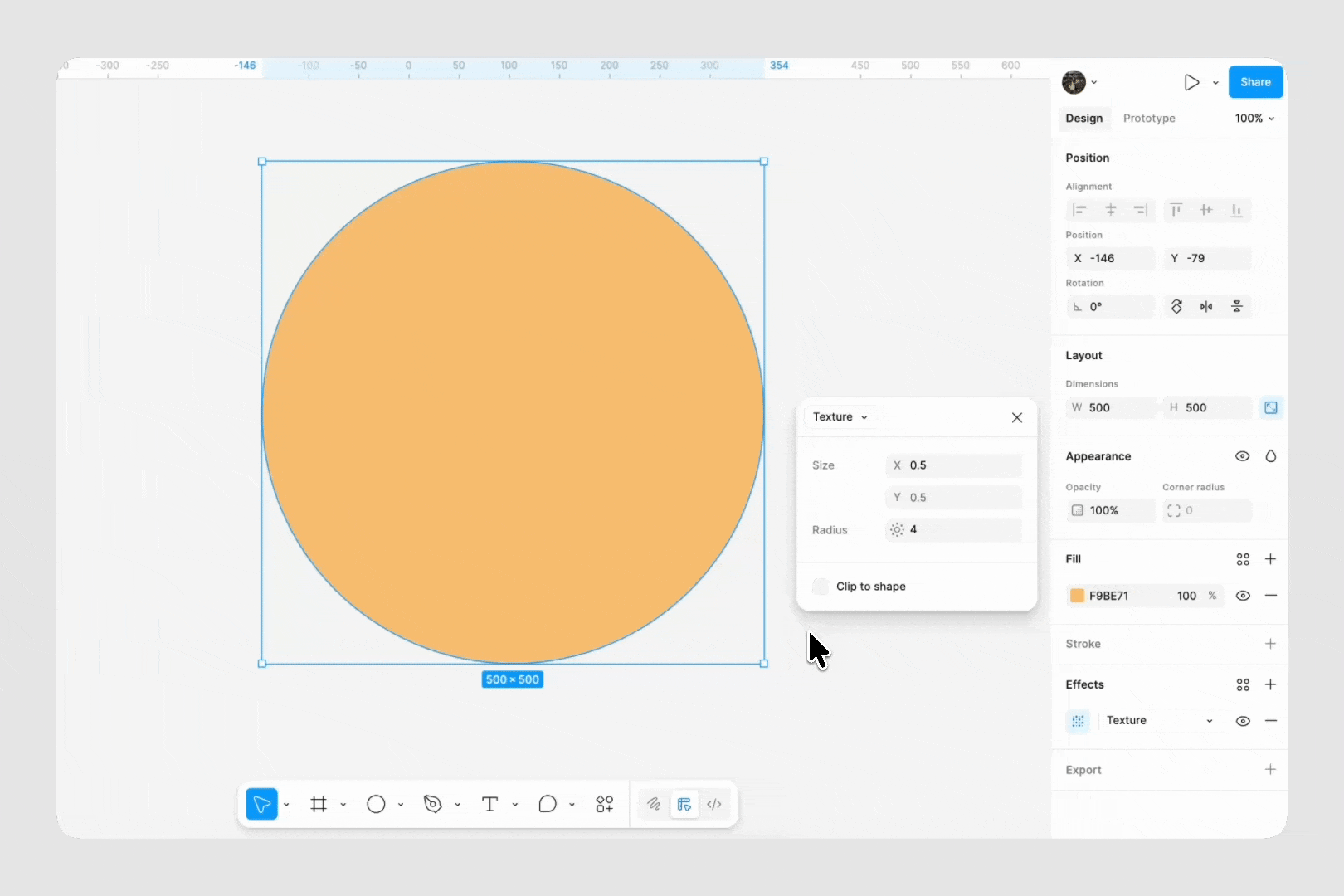

Apply texture effects
You can apply texture effects to any layer type. It’s only possible to apply one texture effect per object.
To apply a texture effect:
- Select the layer.
- Choose Texture from the dropdown menu.
- Size: Set the scale of the textured effect
- Radius: Adjust to determine how far past the layer’s boundary the effect will spread
Clip to shape: Enable this option to limit the texture effect to within the layer’s boundary. While the texture itself will be confined to the shape, drop shadows will still interact with the clipped texture, creating a textured shadow effect.

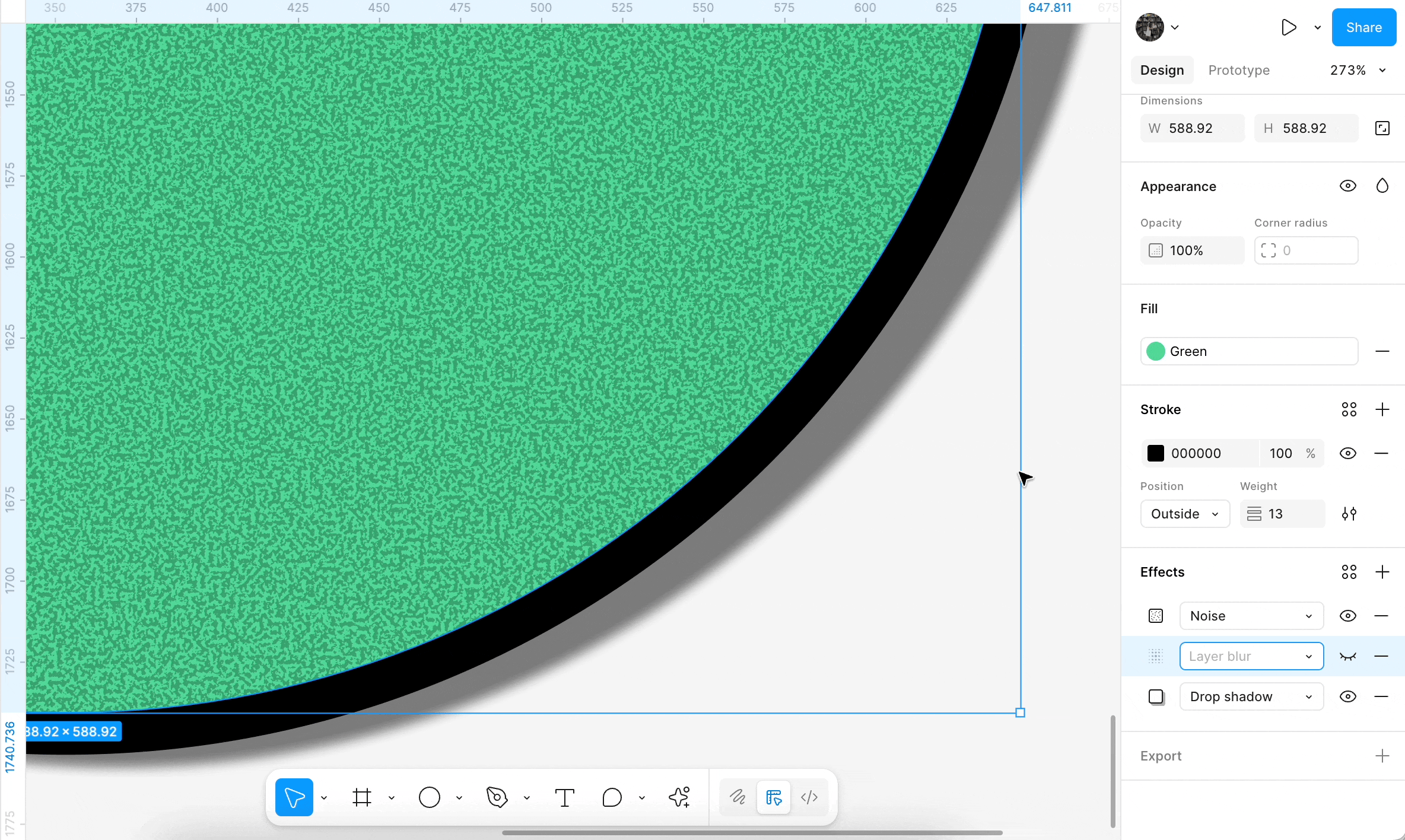

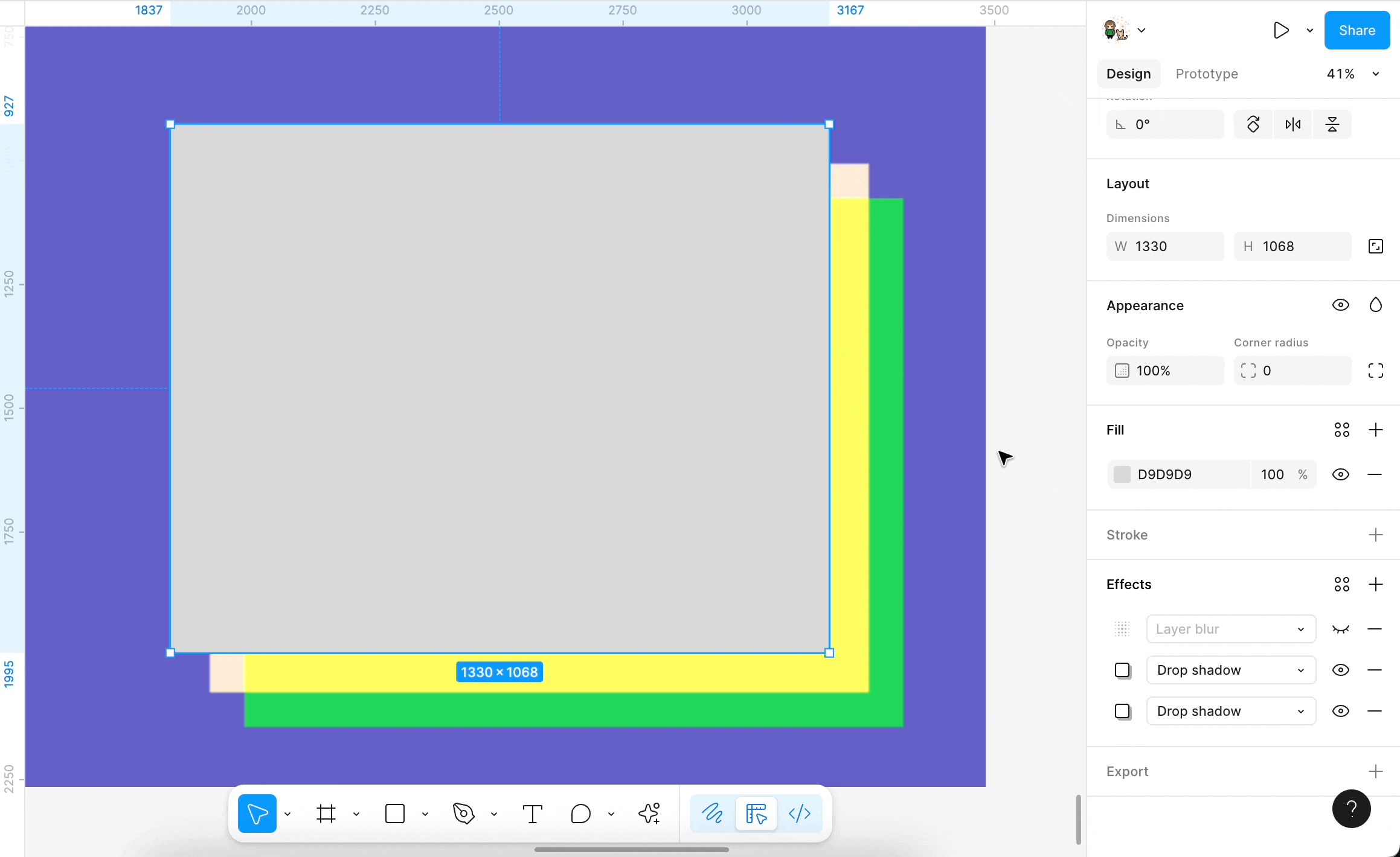

Reorder effects
If a selection has multiple effects applied, you click and drag the handles to reorder the effects. How effects are ordered in the Effects section impacts how the selection is rendered.
Render order
The way Figma renders a selection’s effects depends on the types of effects applied, their order in the Effects section of the right sidebar, and whether the selection is a layer or a group. Masks are considered groups in this context. The differences in group and layer shadows are most obvious on layers that overlap. When the shapes don’t overlap, they will appear the same.
Render order for layers
- Top: Layer blur, noise, texture (applied in their specified order)
- Stroke paints
- Inner shadow
- Fill paints
- Drop shadow
- Bottom: Background blur, glass (cannot render both effects on a single layer; only the first effect encountered will render)
Render order for groups
- Inner shadow
- Paints, masks, and effects for individual fills or strokes
- Drop shadow
How layer blurs and unclipped textures impact rendering
Layer blurs and unclipped texture effects extend past a selection’s boundary. There are some things to keep in mind when applying layer blurs or unclipped textures to a selection:
Noise and clipped textures
Noise and clipped textures normally do not extend past a selection’s boundary but can do so if placed above a layer blur or unclipped texture in the Effects section.
For example, to enable a noise effect to reach the edge of a drop shadow, you can place a layer blur or unclipped texture in between them in the Effects section.
