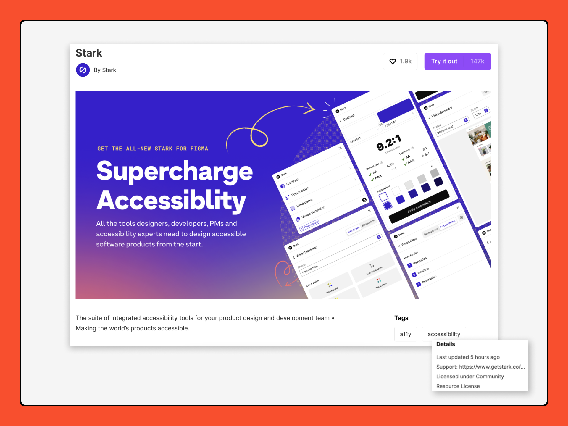

Your plugin's Community page helps users understand what your plugin does and allows them to install it for use. Creators, contributors, and publishers of a plugin can edit the details of the plugin's page at any time, without having to publish an update.
- Open the plugin's Community page.
- In the upper-right corner of the page, click Manage resource > Edit this page.
- In the Publish plugin modal, update the desired fields, then click Publish when you're finished.

Provide support
Figma does not provide support for third-party applications. As the plugin's developer, it's your responsibility to assist your plugin's users with technical issues.
You need to add a Support contact when you submit your plugin for approval. This can be an email address users can contact, or a link to a website or help center.
