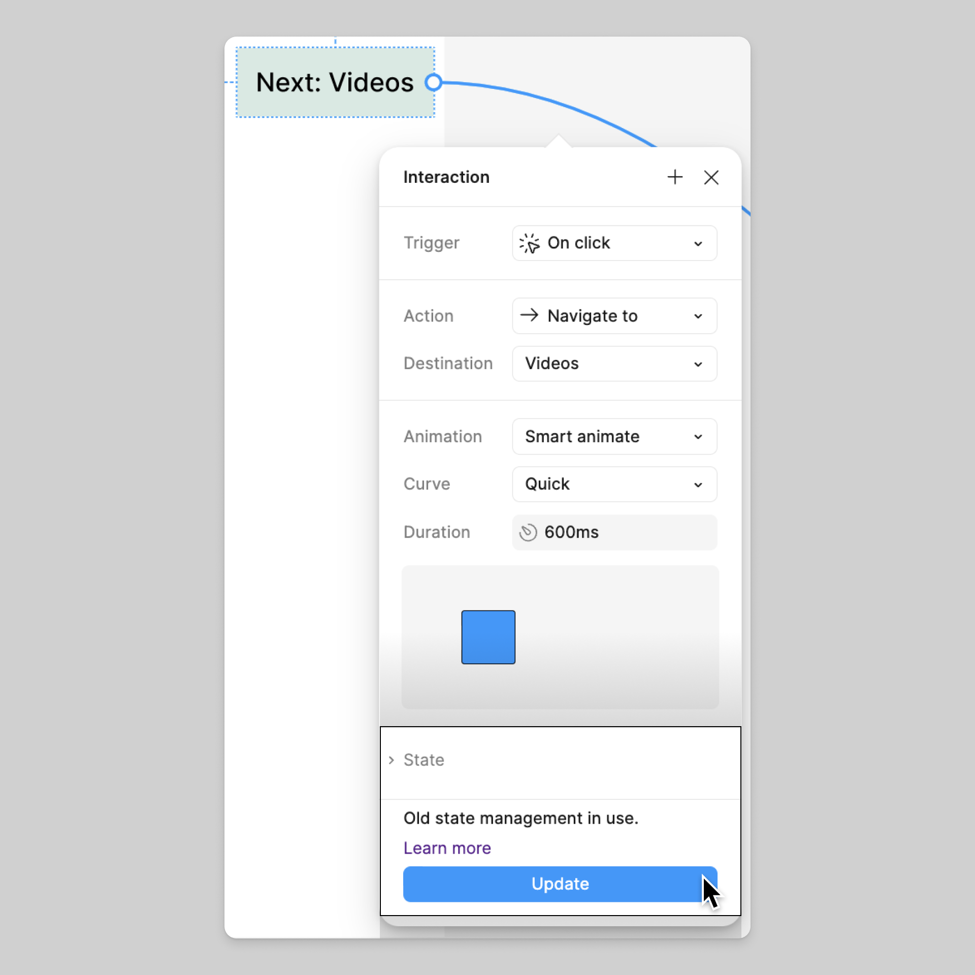

Update old state management: Preserve scroll position
On May 24, 2023, Figma updated its prototype state management controls. This update changed how preserve scroll position is applied on interactions.
To preserve scrolling between top-level frames, the top-level frame names have to be identical or have a matching prefix.
| Turn off preserve scroll position | Turn on preserve scroll position | |
| New state management | Use non-matching layer names or check reset scroll position |
Use matching layer names (Top-level frame names can be identical or have a matching prefix) |
| Old state management | Toggle off the preserve scroll position setting | Toggle on the preserve scroll position setting |
Any new interaction automatically follows new state management rules. To update an old interaction to the new state management controls, click the Update button on the Interaction details modal.
