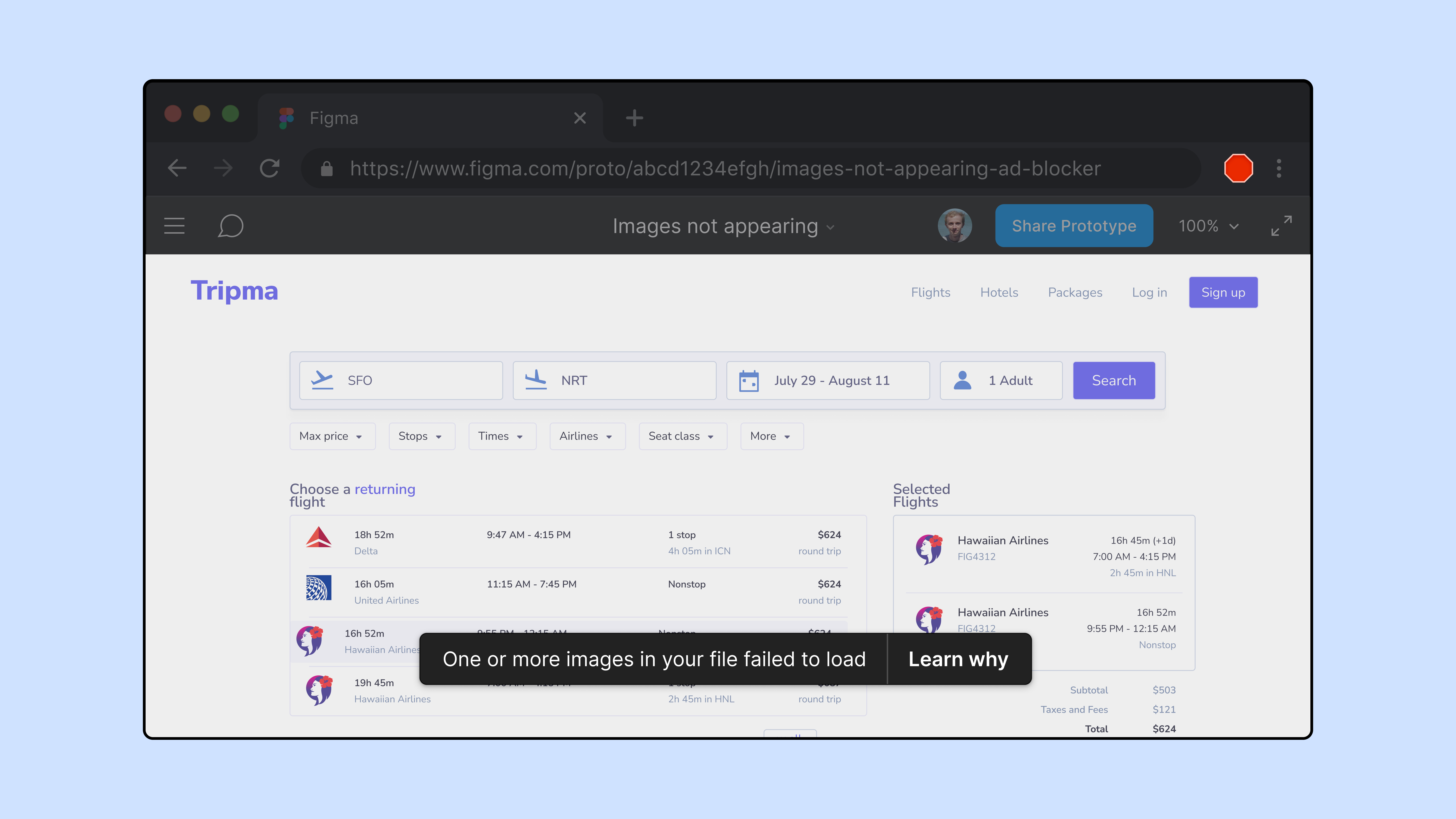

Images in prototypes not loading
There are two possible causes for images in prototypes not loading:
- Limited internet connection
- Blocked by a browser extension
Images may fail to load if your device is experiencing a limited internet connection, or is offline. Confirm your device has a reliable internet connection.
Browser extensions
Browser extensions, such as ad blockers, can prevent images from loading in presentation view.
You can disable the browser extension, or add figma.com to the extension’s allow list. The process for this varies by extension, so make sure to reference the documentation for the relevant extension.
