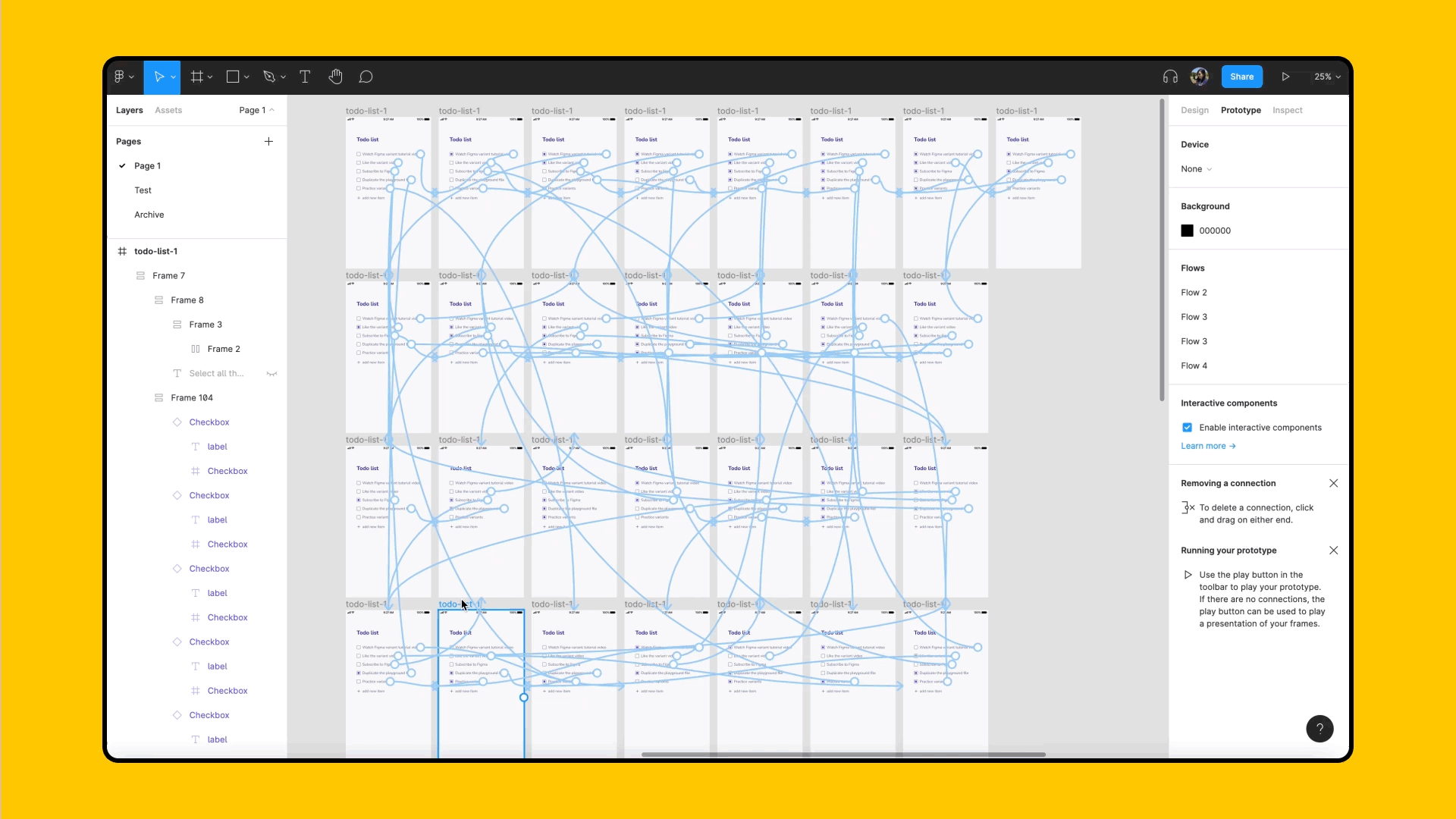

Before variant interactions
In the example below we've added all the possible connections to prototype a frame with five checkboxes. Without interactive components, we would need to duplicate the same frame 32 times and create 160 connections between them to prototype every possible combination.

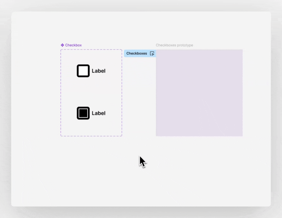

With variant interactions
With interactive components, we only need to add an instance of the checkbox to our design and its variant interactions are ready to go. When we view the prototype, Figma automatically switches between the checked and unchecked variants.

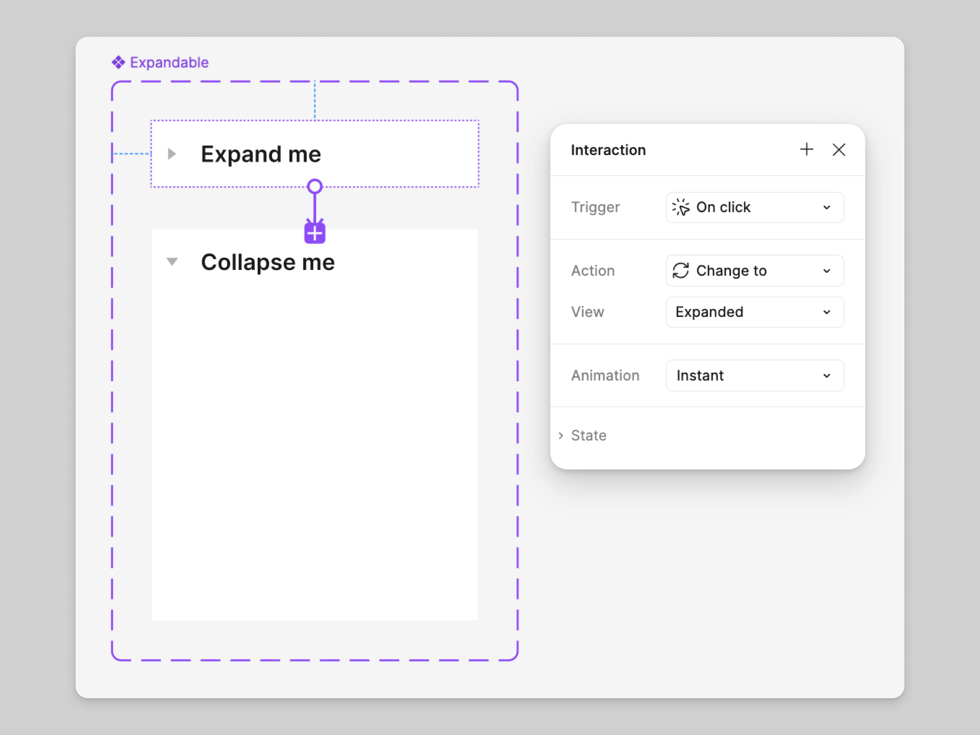

Create variant interactions
Interactive components introduces a new prototype action: Change to.
- Navigate to the Prototype tab of the right sidebar.
- Click the on the frame's bounding box and drag it to the destination variant. You can also click the in the Interactions section of the Prototype panel, set the action to Change to, then select the destination variant using the dropdown menu.
- Once the connection has been made, use the Interaction panel to adjust the trigger and action.
You can also use the Change to action on a nested instance to change the parent component variant. In the example below, a variant from a component set is nested within another Expandable
component set. A Change to interaction is placed on the nested instance to change the parent component from its Collapsed

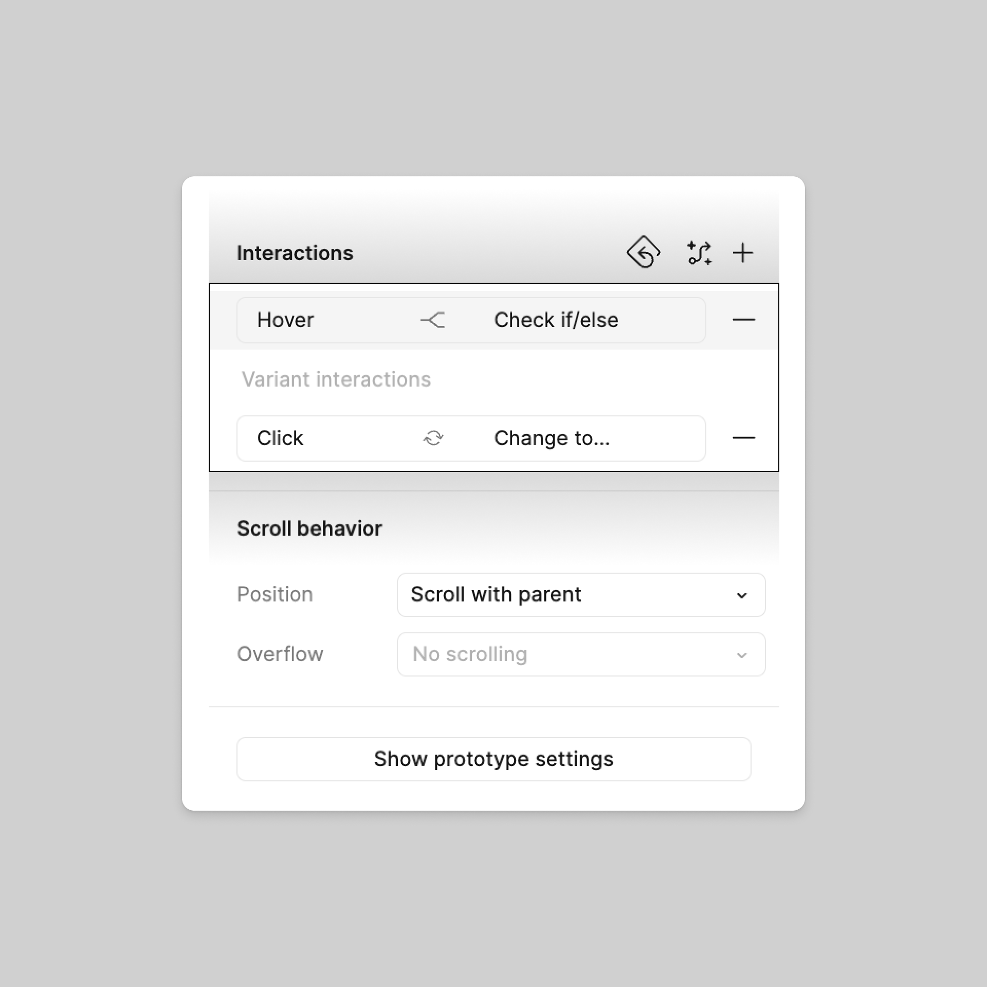

View interactions
When using interactive components, you will see separate sections for Interactions and Variant interactions in the Prototype tab of the right sidebar.
- Use the Interactions section to create prototype interactions and animations
- Use the Variant interactions section view a variant interaction's details

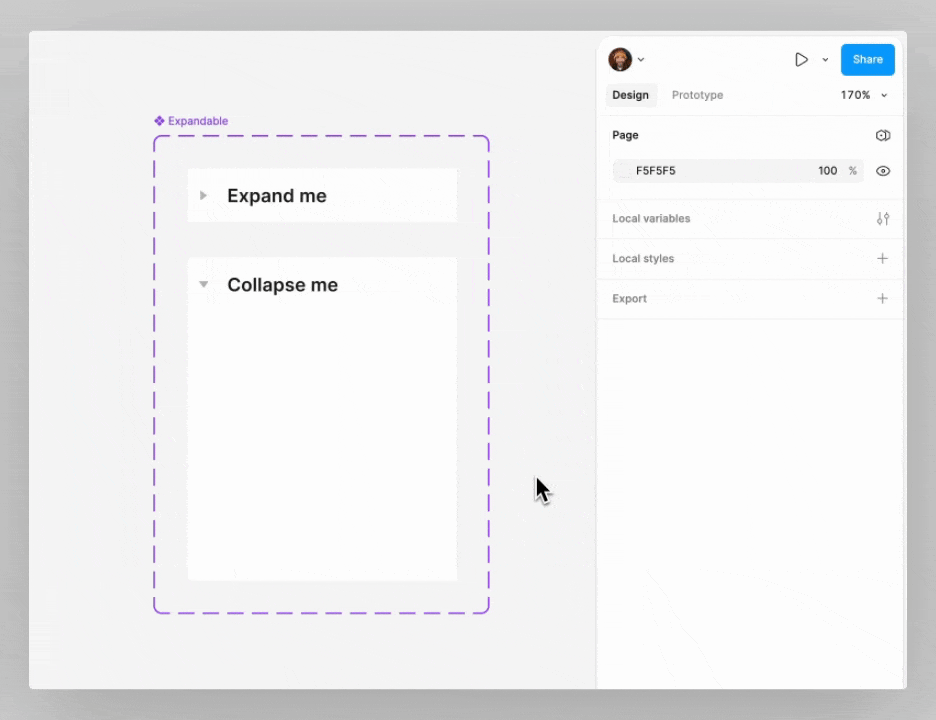

Edit variant interactions
You can override a variant interaction for an instance in your prototype. If you want to edit a variant interaction for the main component, you'll need to do so from the source file.
To access a component set from an instance and make your edits:
- In design mode, select the instance.
- At the top of the right sidebar, click .
- Select Go to main component.
- Make your edits to the variant interactions.
