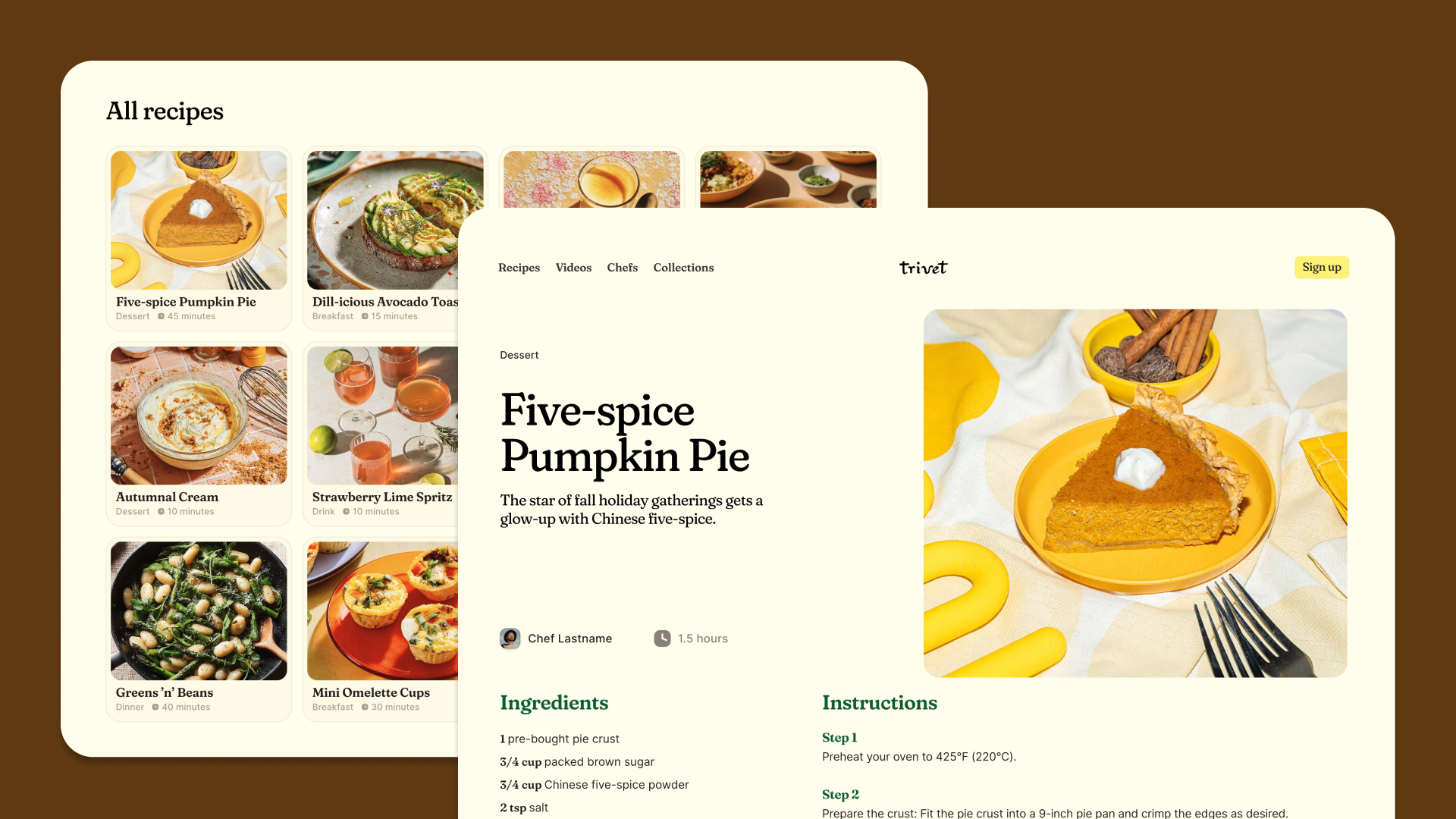

Suppose you’re working on a cooking website with lots of recipes.
A CMS list displays multiple items from a collection—like a grid of recipe previews with titles, images, and short descriptions. Visitors can browse through the list to find what they’re interested in.
A CMS page shows all the details for a specific item: the ingredients, steps, and photos. Each CMS page uses the same design template, but the content updates automatically based on the selected recipe.

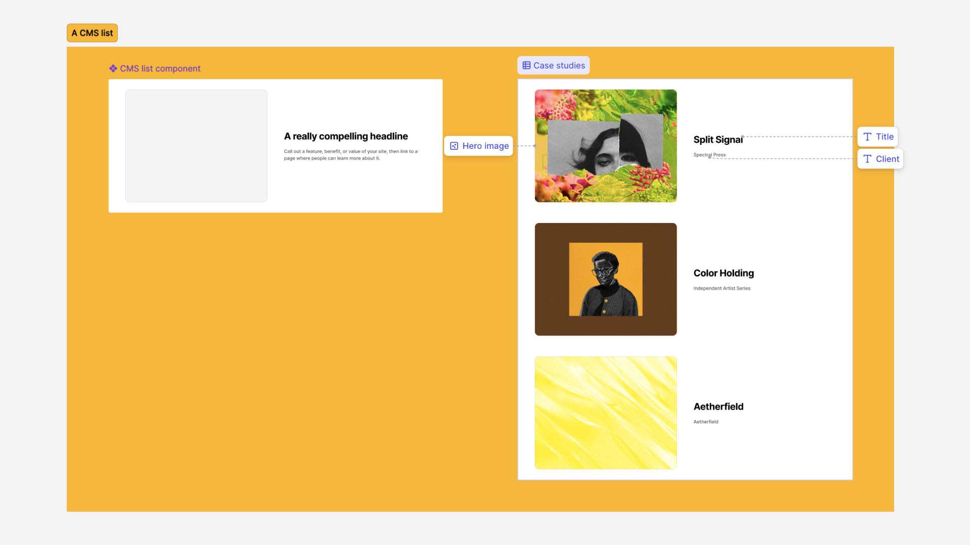

A CMS list has two parts:
- A main component that controls styling of the repeating list elements.
- A CMS list layer that contains repeating instances of the component. The child layers of these instances are connected to fields in your CMS collection.

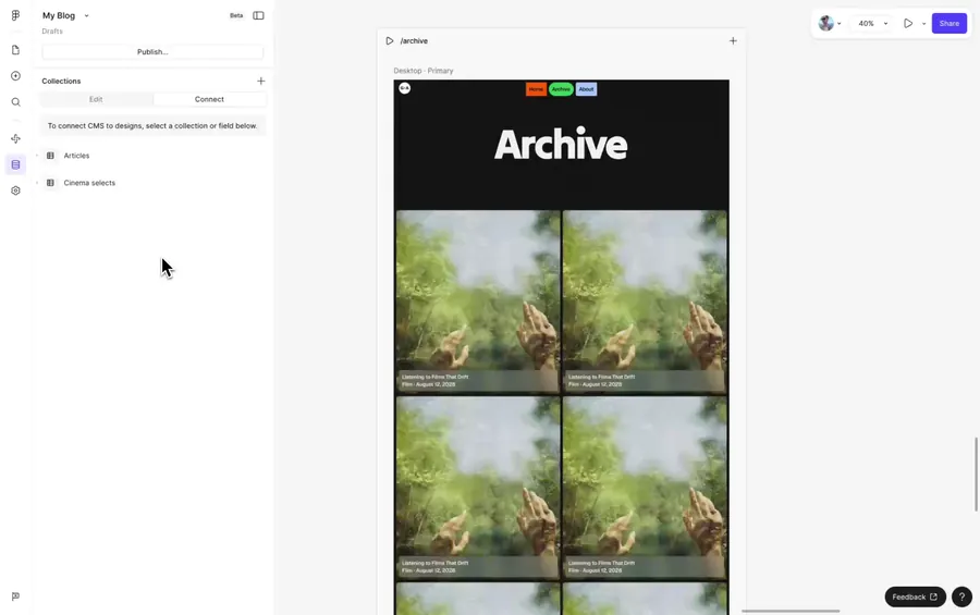

The easiest way to convert a design into a CMS list is from Connect view.
- Click CMS in the left navigation bar.
- Select the Connect tab.
- Hover over a collection, click Connect, then choose Part of a page.
- Select the parent frame on the canvas.

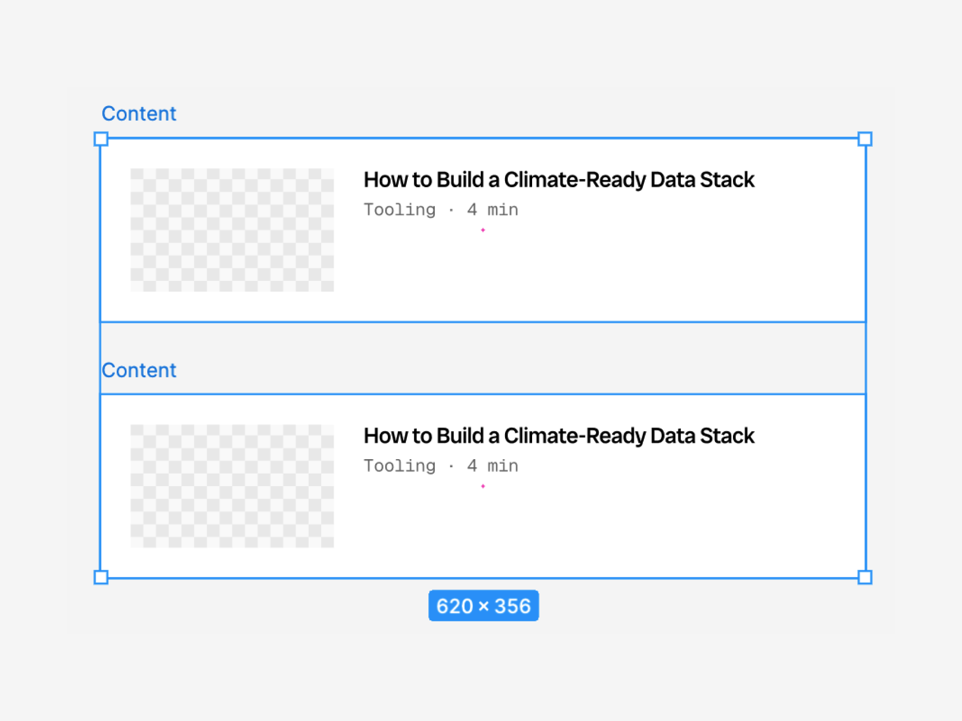

Two identical layers
- Select any two identical layers.
- In the right sidebar, click Connect to CMS and select a collection.
What happens:
- Figma wraps the layers in a new CMS list layer.
- Figma generates a new main component based on the identical layers if one doesn’t exist already.
- The identical layers become instances of the component.

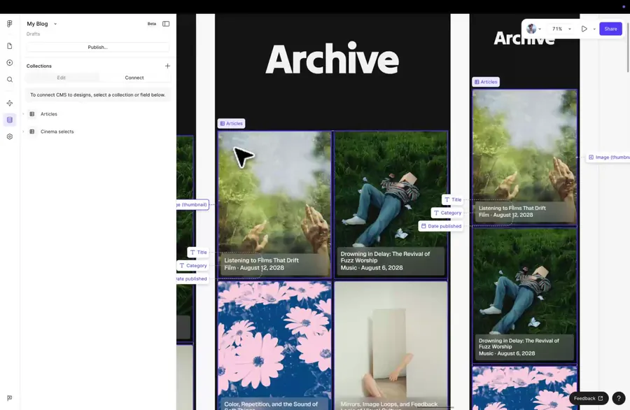

Connect layers in Connect view
The Connect view lets you quickly wire up an existing layout or review what’s already connected. In this view, you choose a field, then select the target layer in the CMS list to connect it.
Note: Certain field types only connect to compatible layer types. For example, you can’t connect a text field to a shape or frame.
- Click a field in the collection, then click a target layer in the CMS list to connect it. All items in the list will automatically update.
- Repeat for additional fields and layers.
Note: You can only connect fields to layers in the CMS list, not the main component.
Tip: While in Connect view, double click a connected design on the canvas to edit the field values for the current item.
