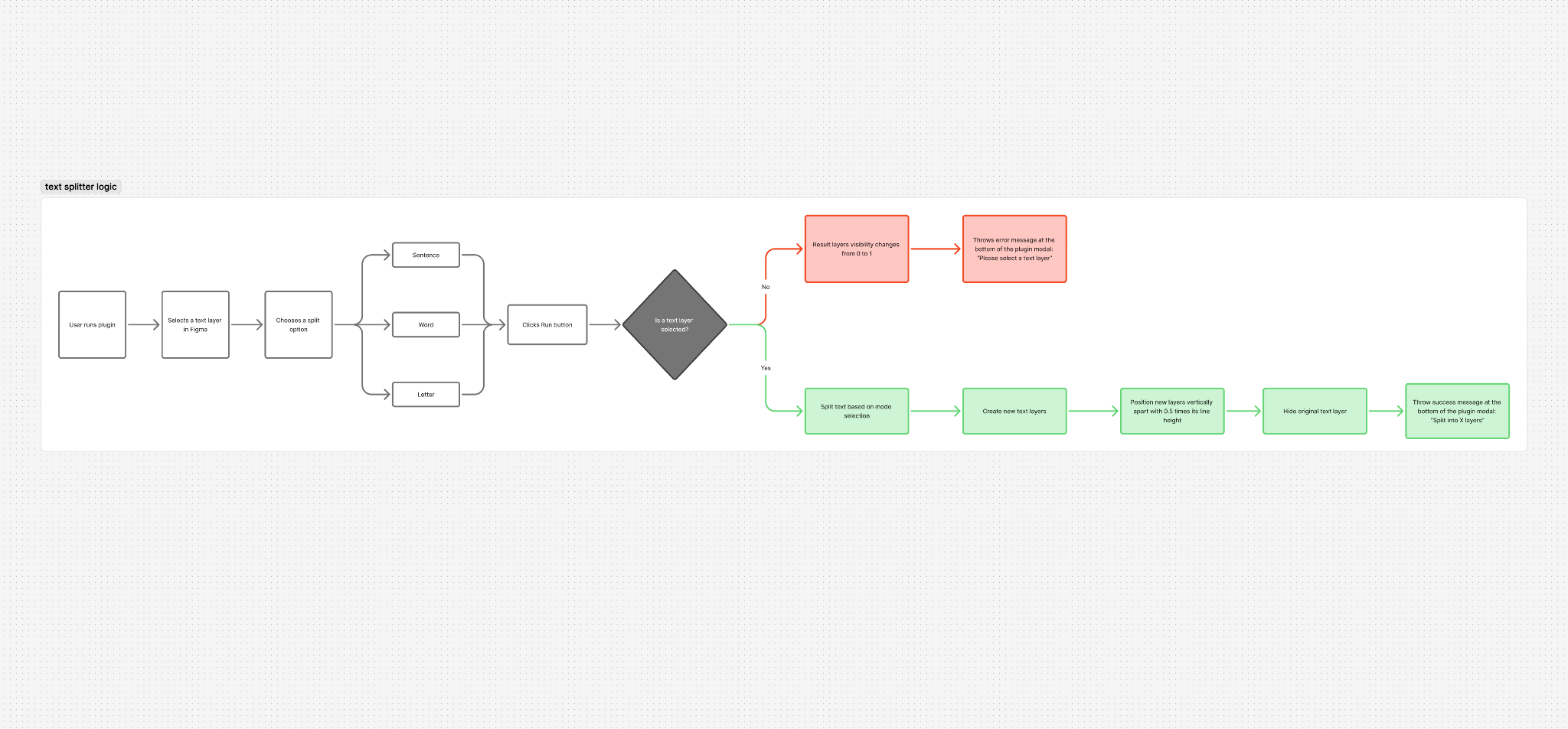

Let’s take a look at our diagram, which is wrapped inside a FigJam section.
The diagram shows how the text splitter plugin works from start to finish. It explains how the plugin checks for a selected text layer, handles errors, and creates new text layers by splitting text into sentences, words, or letters. If there isn’t a text layer selected when the user clicks the Run button, it will display an error. If the plugin runs successfully, it will display a success message that includes the number of layers created.

- Select the section that contains the diagram. If your diagram isn’t inside a section already, select the whole diagram and click Wrap in new section from the inline menu.
- Right-click and select Copy link to selection, or use the shortcut:
- Mac: Cmd L
- Windows: Ctrl L
Switch to your agentic tool and enter the following prompt:
Create a Figma plugin for text splitter based on the logic in this file [Insert link]. Users can take a single text layer and break it down into multiple layers based on their choice. Keep a simple and minimalistic design for now. - Submit the prompt.

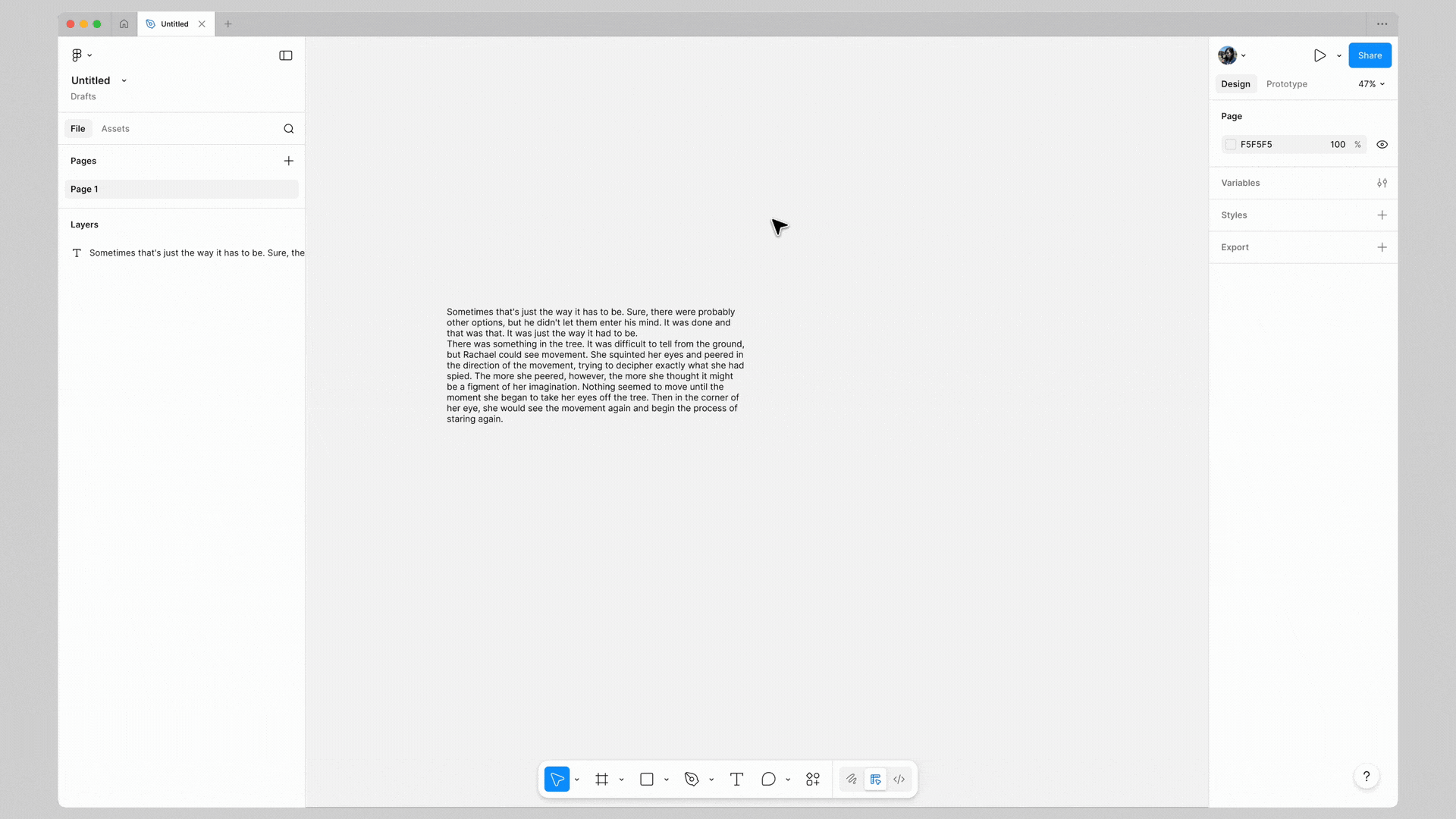

- Add a text layer to the canvas and enter a few lines of text.

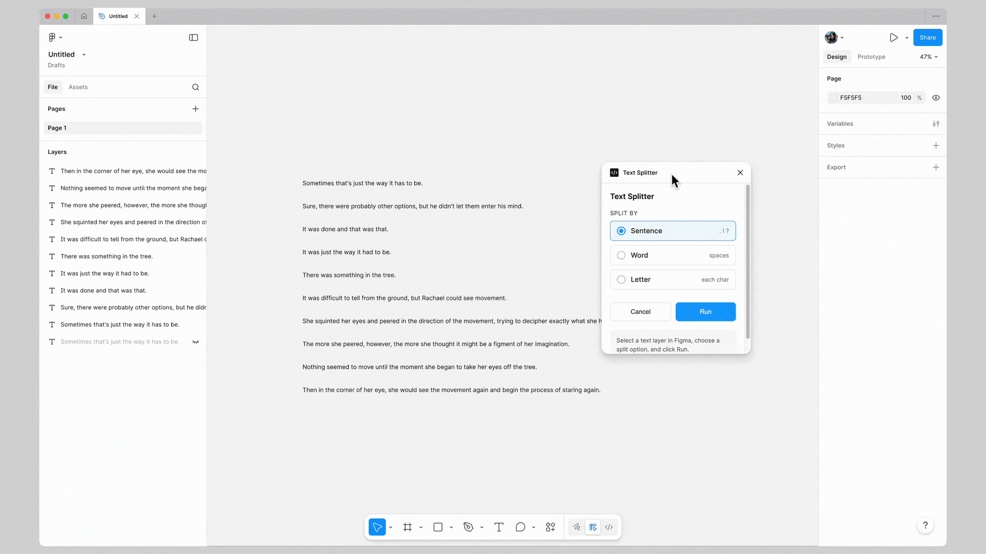

- Select the text layer on the canvas, then use the plugin to split the layer by sentence.
The paragraph is now broken down into multiple text layers, just as we expected!

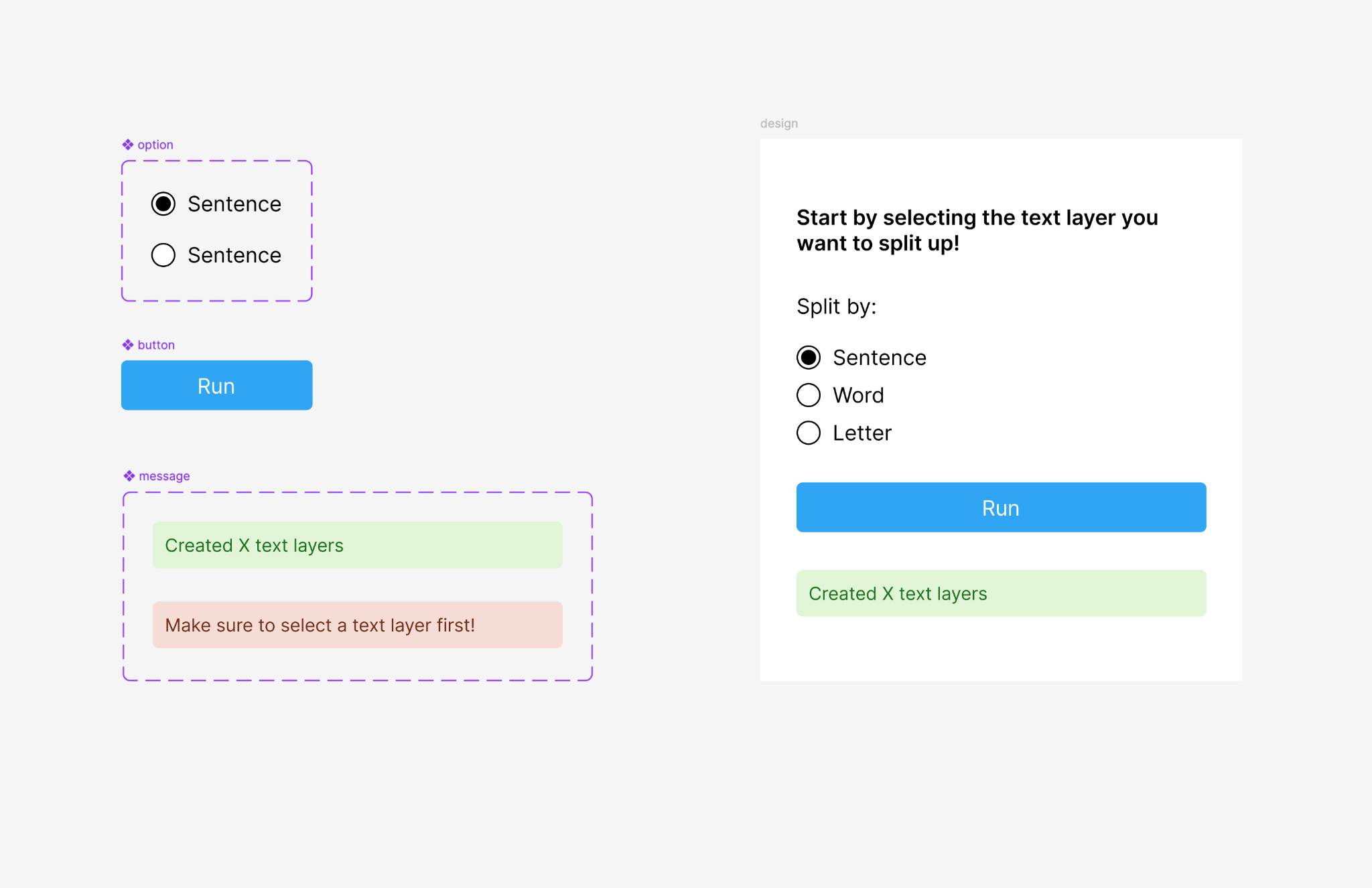

Let’s take a look at the design.
The design has a simple user interface with the options for users to choose how to split a text later by sentence, word, or letter, and use the Run button to trigger the action. There is also a success or error message to give quick user feedback.

- Select the design frame.
- Right-click and select Copy/Paste as -> Copy link to selection, or use the shortcut:
- Mac: Cmd L
- Windows: Ctrl L
Create a Figma plugin for text splitter using this design: [Insert link]. Users can take a single text layer and break it down into multiple layers based on their choice. If the user didn't select a single text layer before clicking on the Run button, it returns an error message. Otherwise, it will show a success message telling the user how many text layers it has splitted into. - Submit the prompt.

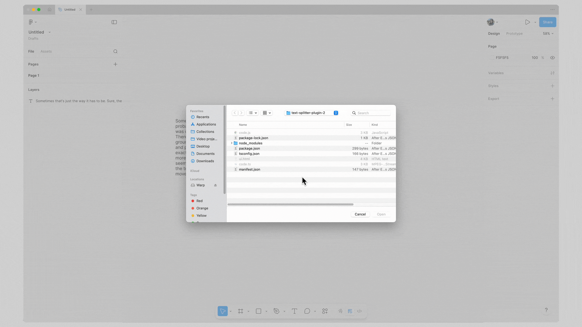

- Right-click on the canvas and navigate to Select plugins > Development > Import plugin from manifest.
- Locate the folder you created and select the
manifest.jsonfile to import your plugin. - Select the Actions menu in the toolbar, locate your plugin, and click on it to run it.

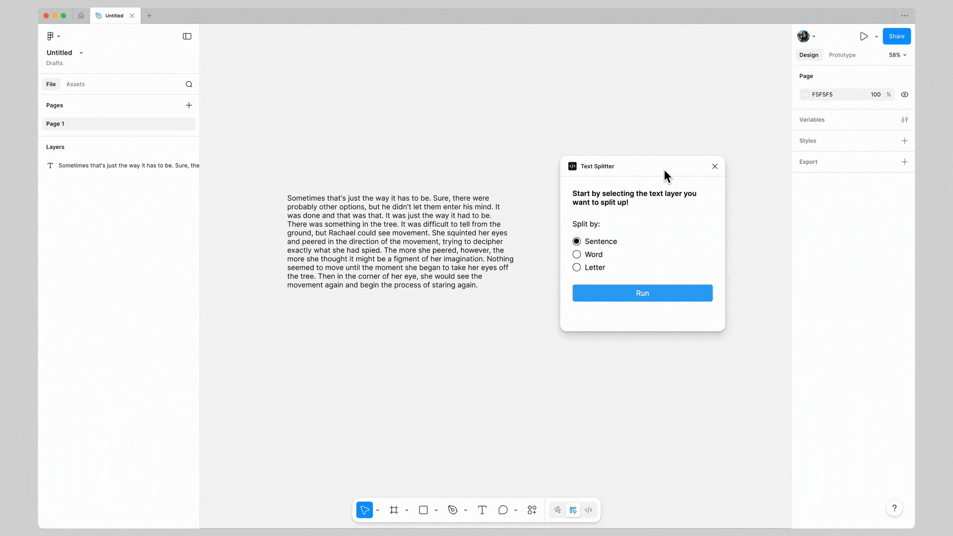

The paragraph is now broken down into multiple text layers just as we expected, and we can see a message at the bottom of the plugin telling us how many layers the paragraph is splitted into.
