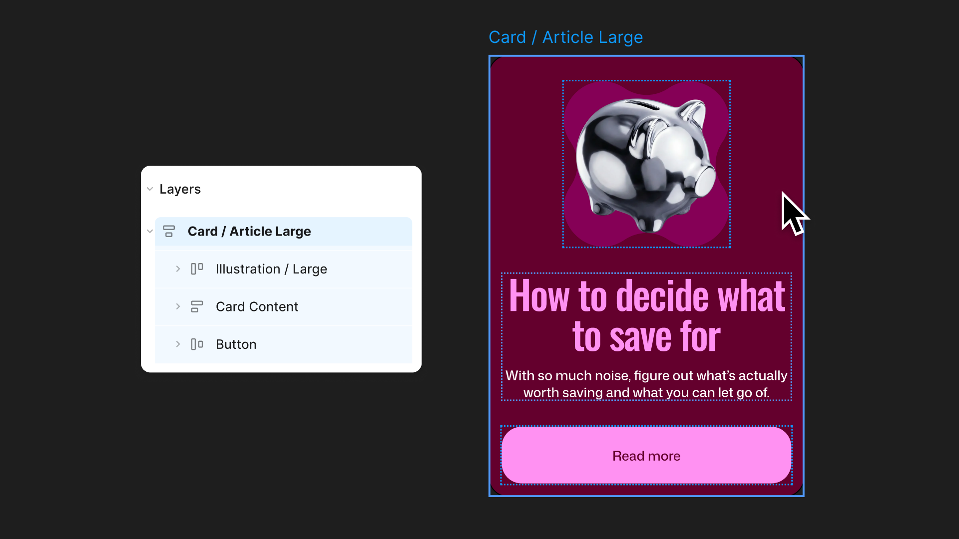

1. Build reusable blocks and patterns
Design systems are typically built around atomic components—buttons, inputs, icons, and other small pieces. These are essential, but they're difficult for AI to compose into coherent layouts on their own.
AI tools work best when they can reference complete, higher-order compositions: reusable blocks like cards, headers, feature rows, and carousels that already encode the spacing, color, and layout logic for a full section.
When Figma’s agent has access to these blocks, it can reuse them consistently across generated layouts rather than guessing how individual atoms should fit together.
For example, instead of relying on separate button, text field, and image container components, a reusable card component groups all three with predefined spacing, typography, and color tokens. When AI references your design system, it can drop that card into any layout confidently—rather than assembling it from scratch each time.
