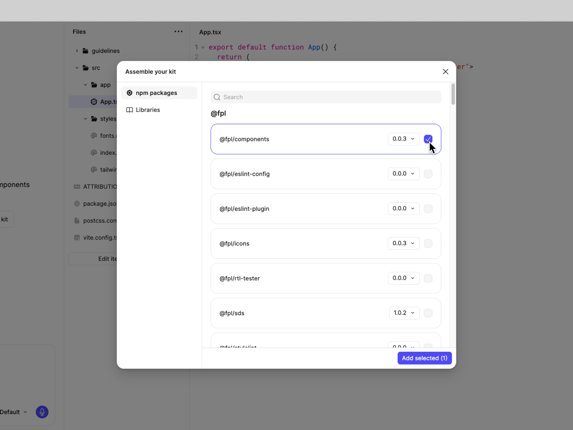

Step 2: Add npm packages and/or library styles
If you chose Assemble your kit as your starting point, then a modal will appear for you to import npm packages, public packages, and library styles to the kit.
If you choose Start from scratch as your starting point, you can prompt Make to build components for the kit. You can also click Add items to your kit to find packages and library styles to add.
Note: npm packages or libraries that contain a high volume of assets may take a few minutes to import to your kit.

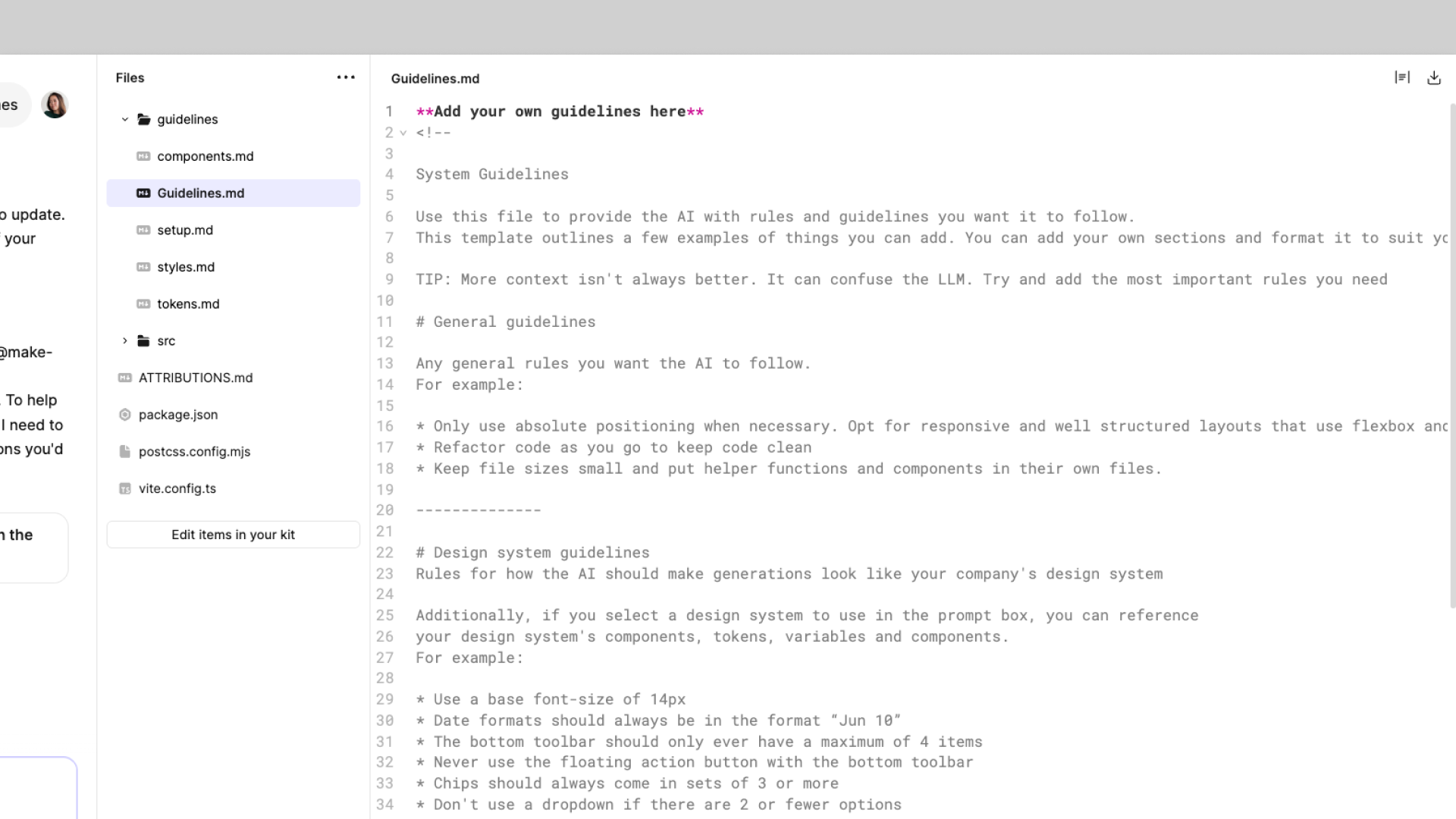

Step 4: Add guidelines
Guidelines are essential for getting accurate, on-brand results from your Make kit. They teach Make how to properly use your components, when to apply specific variants, or how to follow your design system's rules.

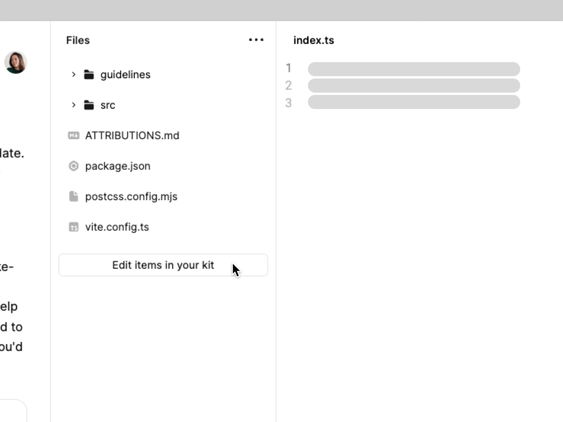

When you start a Make kit, a guidelines folder is created in the file explorer with at least one markdown file (.md) for you to add information on how Figma Make should consume the kit. This helps Make create an app that better meets your needs and expectations. This includes instructions for how you want Figma Make to behave in terms of coding and personality, and how to use things like style context.
The methods for adding guidelines to a Make kit is the same as adding guidelines to a Figma Make. Learn how to add guidelines.
When you're ready to start writing guidelines for your Make kit:
- Check out the section below to learn best practices for guidelines for library styles
- Check out our developer documentation for tips on guidelines for design system packages

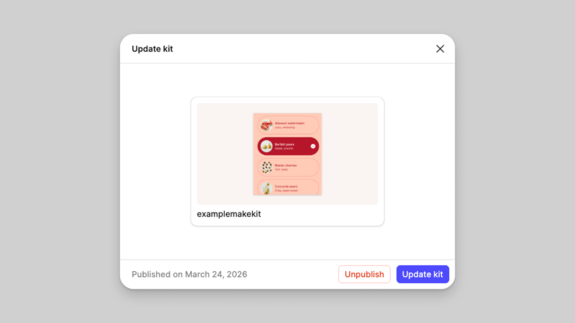

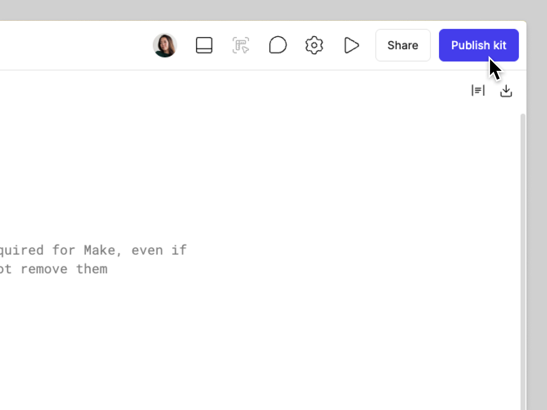

Once you’re done assembling your Make kit, you can publish it to your organization so your teammates can use it in their Make projects.
- Click Publish kit in the top right corner.
- A Make kit cannot be published if it lives in your drafts folder. If this the kit is in your drafts, you’ll be prompted to move it to a folder in the organization.
- Give your Make kit a name and thumbnail so that it’s easily identifiable.
- Configure your package.
- Choose whether to use default or custom package.json and vite.config.ts settings.
- Update any advanced settings: npm package name or library, scope, version number. If you’d like to use the Make kit in a production setting as well as in Figma Make and your team has formal standards around how npm packages are named and organized, you can customize the scope in the package name to (@scope/package-name) to match your team’s requirements.
- Click Publish.

When your library styles are added to a Make kit, an empty Guidelines.md file is also added. Guidelines are critically important for ensuring Figma Make uses your library styles in a way that creates high quality, reliable results.
Best practices
We recommend the following best practices when you’re writing the guidelines for your library styles.

Edit items in kit
With the Make kit file open, you can click Edit items in kit from the file explorer to:
- Update the npm package to a different version
- Configure the kit to use different npm packages or style libraries
Publish an update
When changes to a Make kit are republished, files using the Make kit will receive those updates and your teammates receive a notification next time they open the file. This is helpful when, for example, the version of an npm package is updated.
To publish updates to a Make kit:
- Open the Make kit file and make any edits and changes as needed.
- Click Update kit in the top-right corner.
- From the modal click Update kit and review the kit’s details.
- Click Publish.
Unpublish a Make kit
To unpublish a Make kit:
- Open the Make kit file and click Update kit in the top-right corner.
- From the modal, click Unpublish and follow the prompt.

After you add your library to a Make kit, head to the code view. In the editor, you'll see a folder that corresponds to the name of your library. The folder contains:
- A guidelines folder. You can edit the
guidelines.mdfile in this folder and add additional guidelines files. - A
styles.cssfile.
The Make kit also contains a setup.md file that instructs Figma Make to use your library styles.
The guidelines folder at the root of your Make kit will also have several files in it. Overall, your Make kit will look something like this:
├── guidelines/
│ ├── components/
│ ├── Guidelines.md
│ ├── setup.md
│ ├── styles.md
│ └── tokens.md
