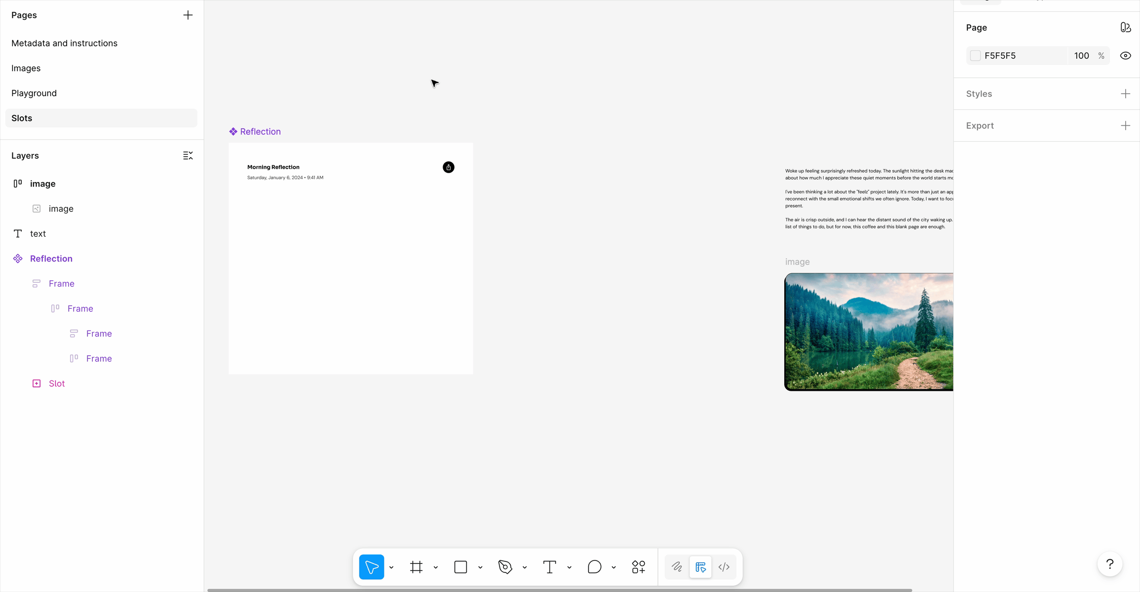

Slots are a type of component property that create flexible areas inside components where you can freely add and arrange content directly inside an instance without having to detach it.

Once a main component is set up with a slot, you can pull an instance of it and start adding content into the slot. A pink border will appear around a slot when you select or hover over its top level component.
Any layer type can be added to a slot. Here are some ways you can insert content into a slot:
- Drag objects from the canvas or Assets panel into the slot.
- Hover over the slot and click Add instances. A popup will appear with a list of components and libraries. If there are any preferred instances defined on the slot, the filter is set to Preferred by default.
- Duplicate layers within the slot.
- Use any tool to add layers directly into the slot.
