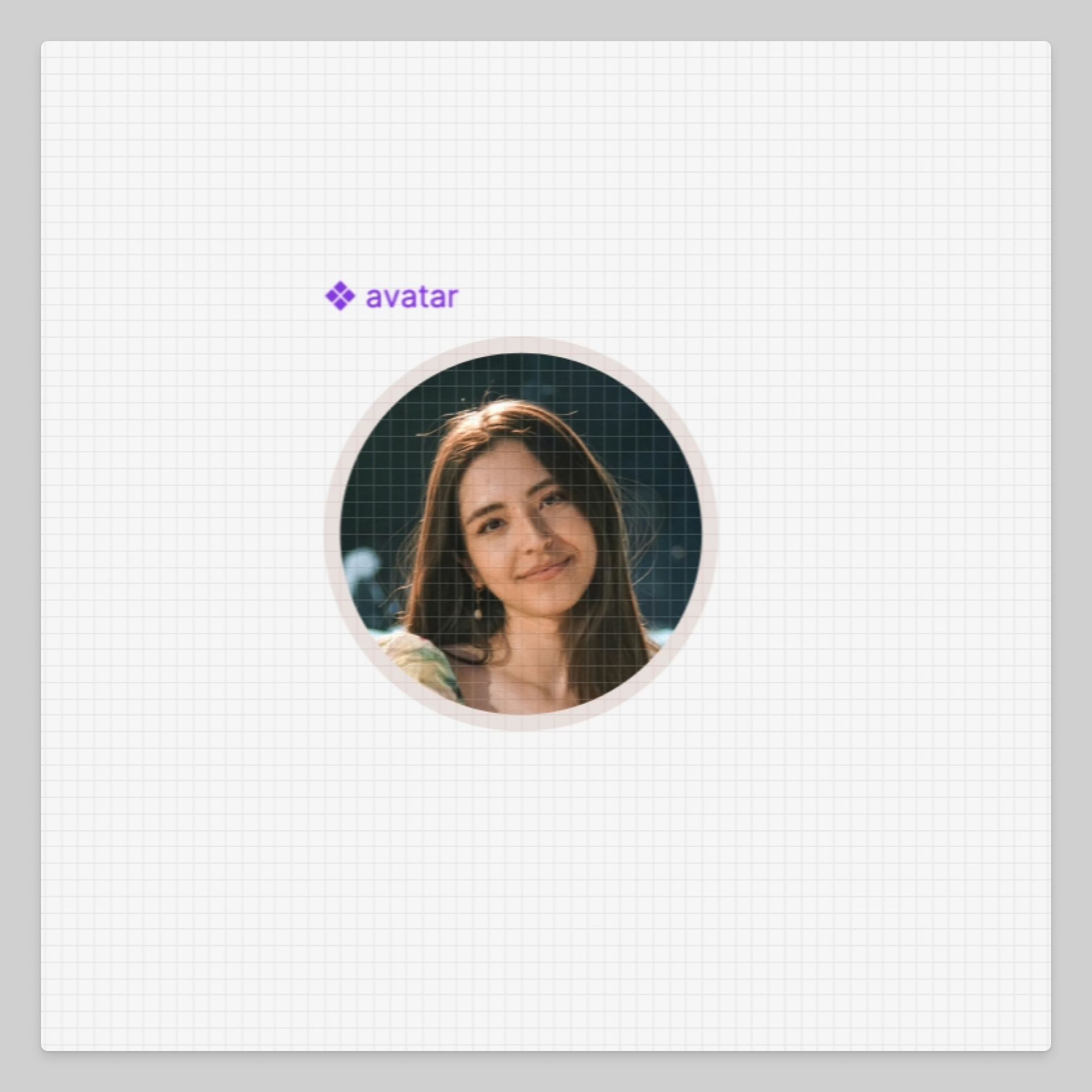

Create the avatar component
We’ll start by creating an avatar component, which we’ll be able to nest inside the list item component.
To create the avatar component:
- Use the Frame tool to add a 24 X 24 frame to the canvas.
- Double-click on the frame name and rename it to
avatar. - Change the Corner radius to
1000. - Click Add stroke in the Stroke section.
- Use the settings to configure the stroke to the following:
- Fill:
#E9DFDB - Position:
Inside - Weight:
1
- Fill:
- Click the color swatch in the Fill section to open the color picker menu.
- Select Image and upload an image from your computer as the avatar.
- Click Create component in the right sidebar or use the keyboard shortcut:
- Mac: Option Command K
- Windows: Ctrl Alt K

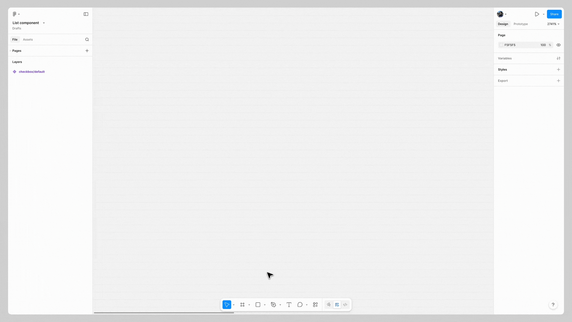

Create the trailing items
Next, we’ll create some trailing items for the list item: a checkbox component and a metadata component. These components will be placed on the right side of the list item component, and can be swapped out when using across different screens. For example, you can use the metadata component in a leaderboard to showcase user day streaks, or use the checkbox component in a filter menu.

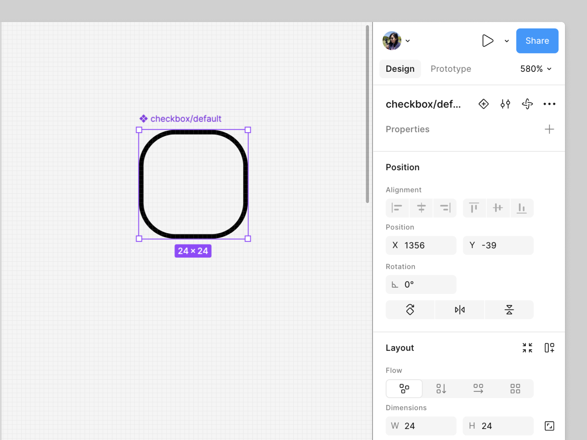

Create the checkbox component default state
Let’s start by creating the checkbox component set with two variants: default and selected.
We’ll start with the default state:
checkbox/default. - Press Shift X to swap the rectangle’s fill and stroke.
- Use the Stroke section of the right sidebar to configure the stroke to the following:
- Fill:
#000000 - Position:
Inside - Weight:
1
- Fill:
8. - Select the frame and click Create component in the right sidebar or use the keyboard shortcut:

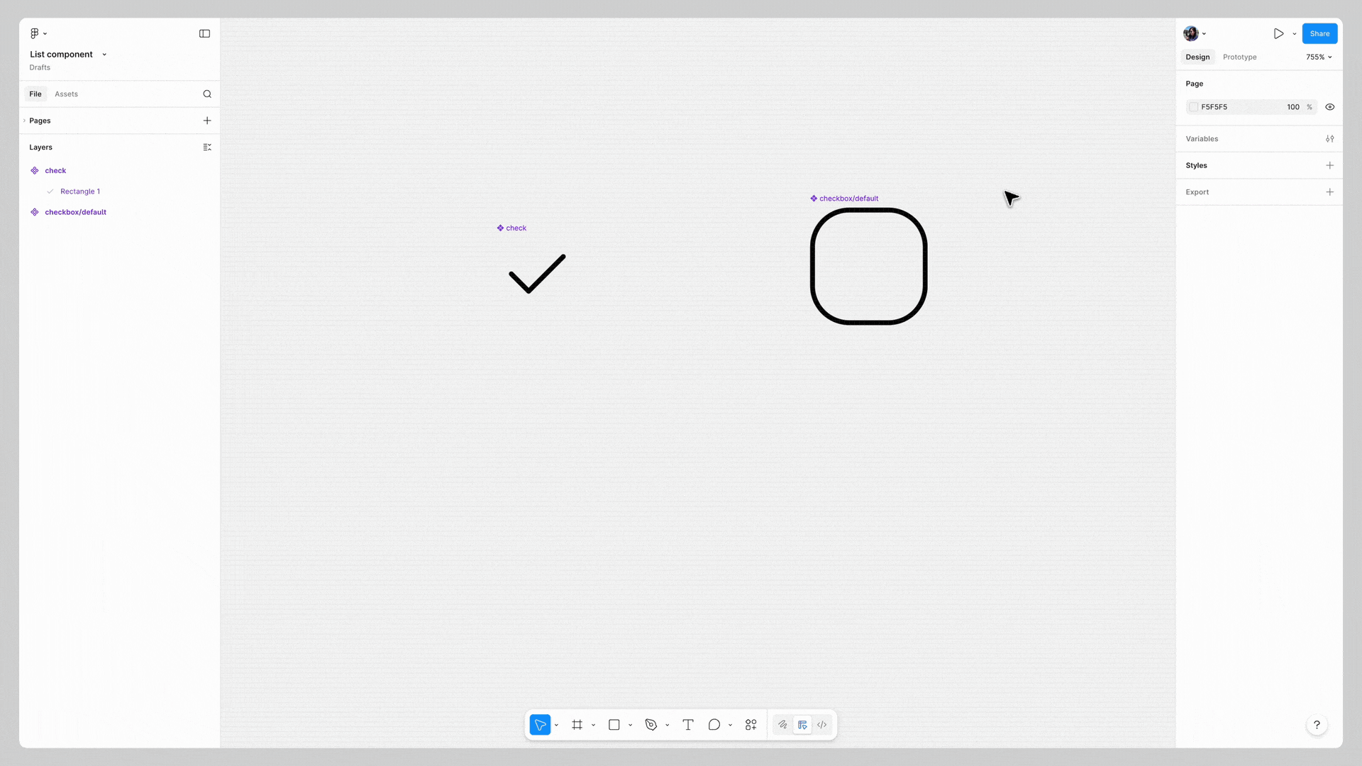

Create the check icon for the checkbox selected state
Before we create the selected checkbox variant, we need to create a check icon.
- Use the Frame tool to add a 16 X 16 frame to the canvas.
check. - Use the Rectangle tool to add a
5X10rectangle to the center of the frame. - Press Shift X to swap the rectangle’s fill and stroke.
- Fill:
#000000 - Position:
Center - Weight:
1
- Fill:
- Open the Advanced stroke settings and change the Join to
Round. - With the rectangle still selected, press Enter to open vector edit mode.
- Select the top-left node of the rectangle and press Delete to remove it.
- Press Enter again to close vector edit mode.
- In the Stroke settings, set the Start point and End point to
Round. - Enter
-45in the Rotation field in the Position section of the right sidebar to rotate the layer. - Right-click and select Flatten from the menu or use the keyboard shortcut:
- Mac: Option Shift F
- Windows: Alt Shift F
- Click and drag the check icon to make sure it’s centered in the frame.
- Select the
checkframe and click the minus in the Fill section to remove the frame’s fill. - Click Create component in the right sidebar or use the keyboard shortcut:

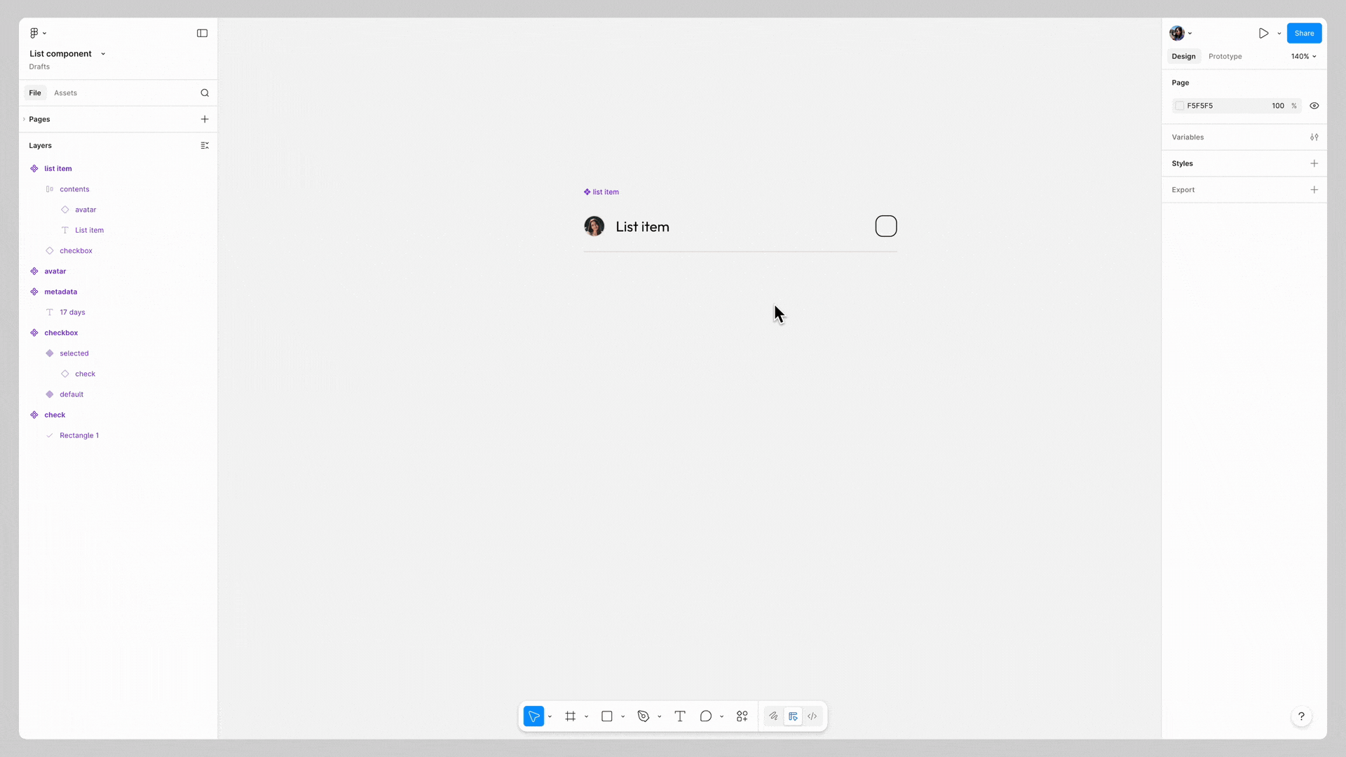

Create the checkbox selected state
Now that we’ve created the check icon, we can move on to creating the selected state for the checkbox component.
- Select the
checkboxcomponent you created previously and click Create variant in the right sidebar. - With the new variant selected, click on the property name (currently called Property 1) in the Current variant section of the right sidebar and rename it to
state. - Click on the property value (currently called Variant2) and change it to
selected. - With the
selectedvariant still selected, click the plus in the Fill section to add a new fill. - Change the fill color to
#FA8891. - Select the
checkicon component and hold the shortcut while dragging your cursor to create an instance:- Mac: Option
- Windows: Alt
- Drag the instance into the
selectedvariant, and place it in the center of the frame. Be sure to check the Layers panel to make sure the check icon is inside theselectedvariant, not just visually on top of it on the canvas.

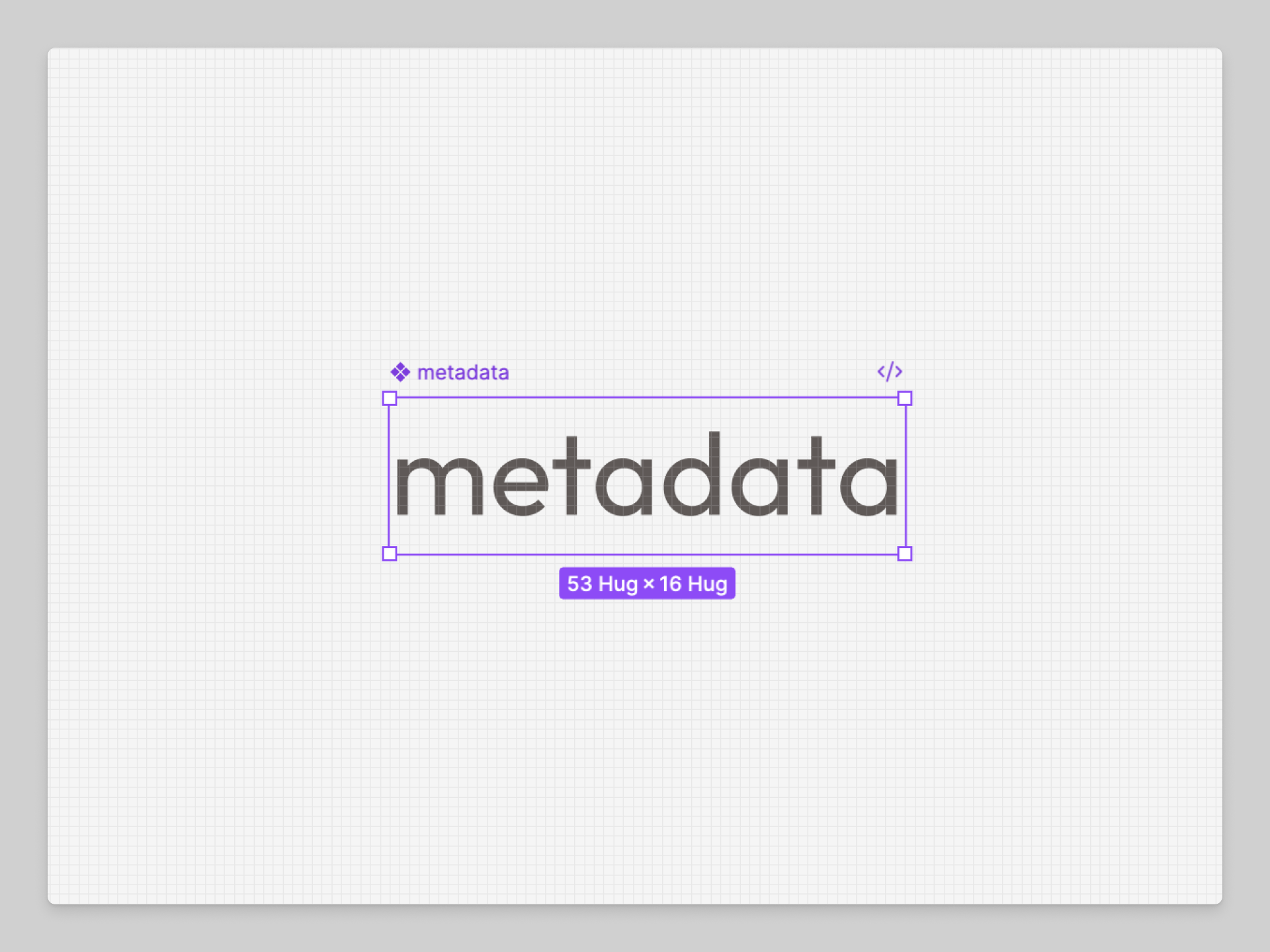

Create the metadata component
Now let’s create the metadata component:
- Select the Text tool, click on the canvas, and type
metadata. - Use the Typography section of the right sidebar to change the Font family to
Outfit, the Font style toRegular, and the Font size to12. - Update the fill to
#605957. - Press Shift A to apply auto layout.
- Double-click on the layer name and rename it to
metadata. - Change the Horizontal padding and the Vertical padding to
0. - Click Create component in the right sidebar or use the keyboard shortcut:

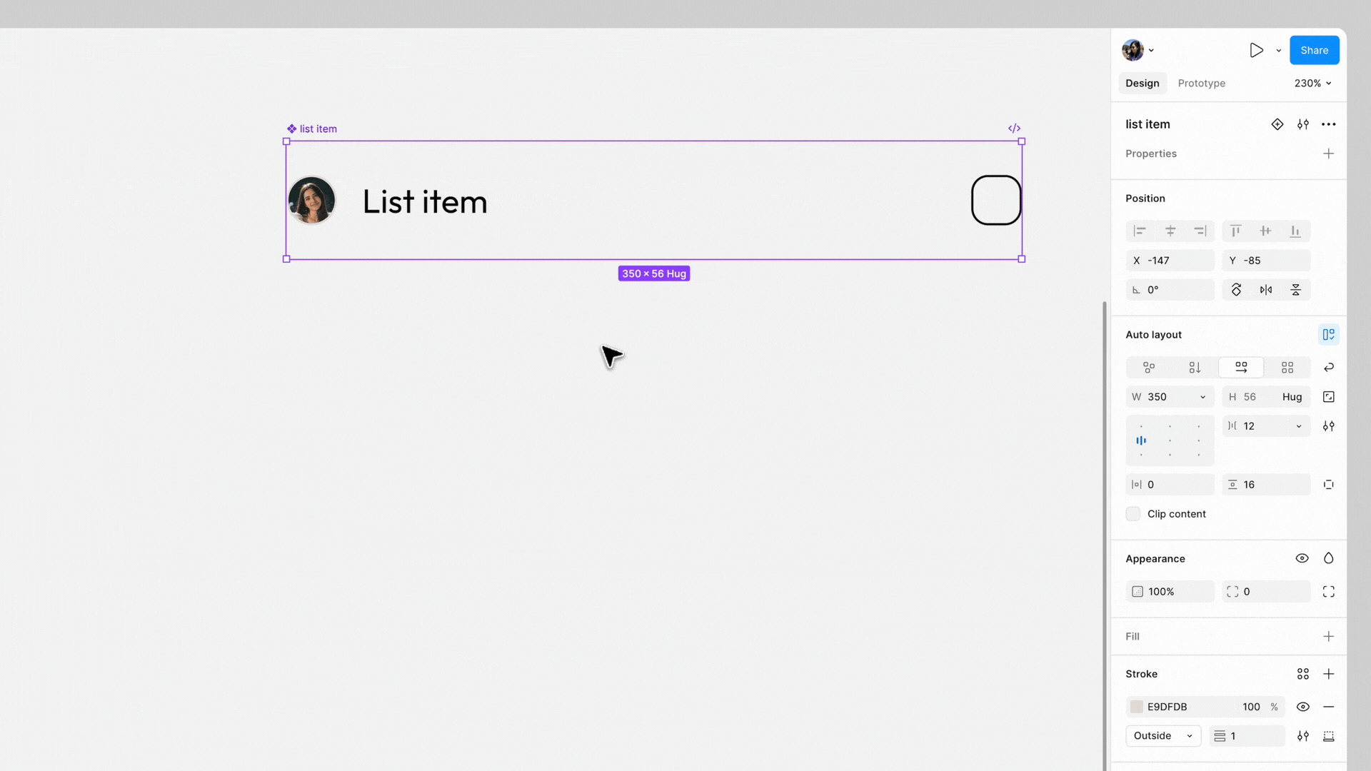

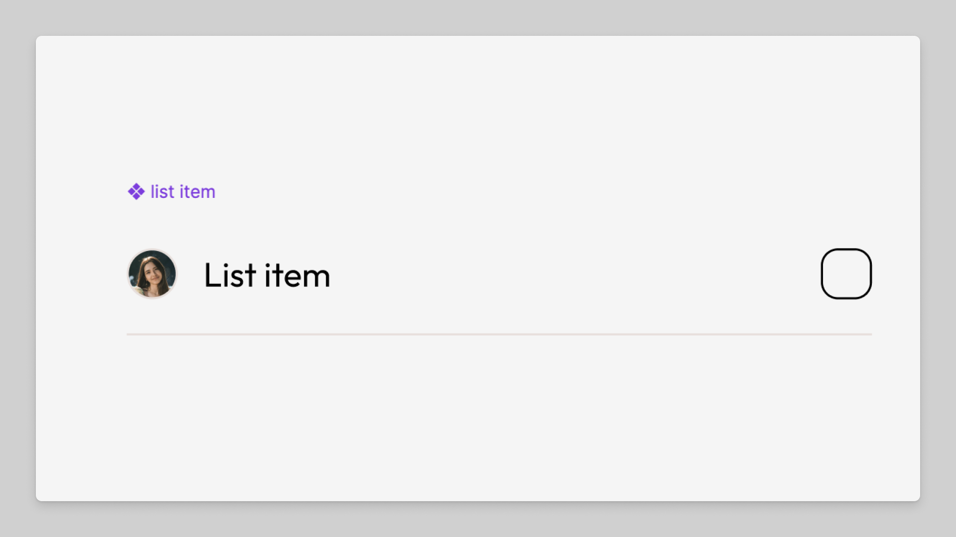

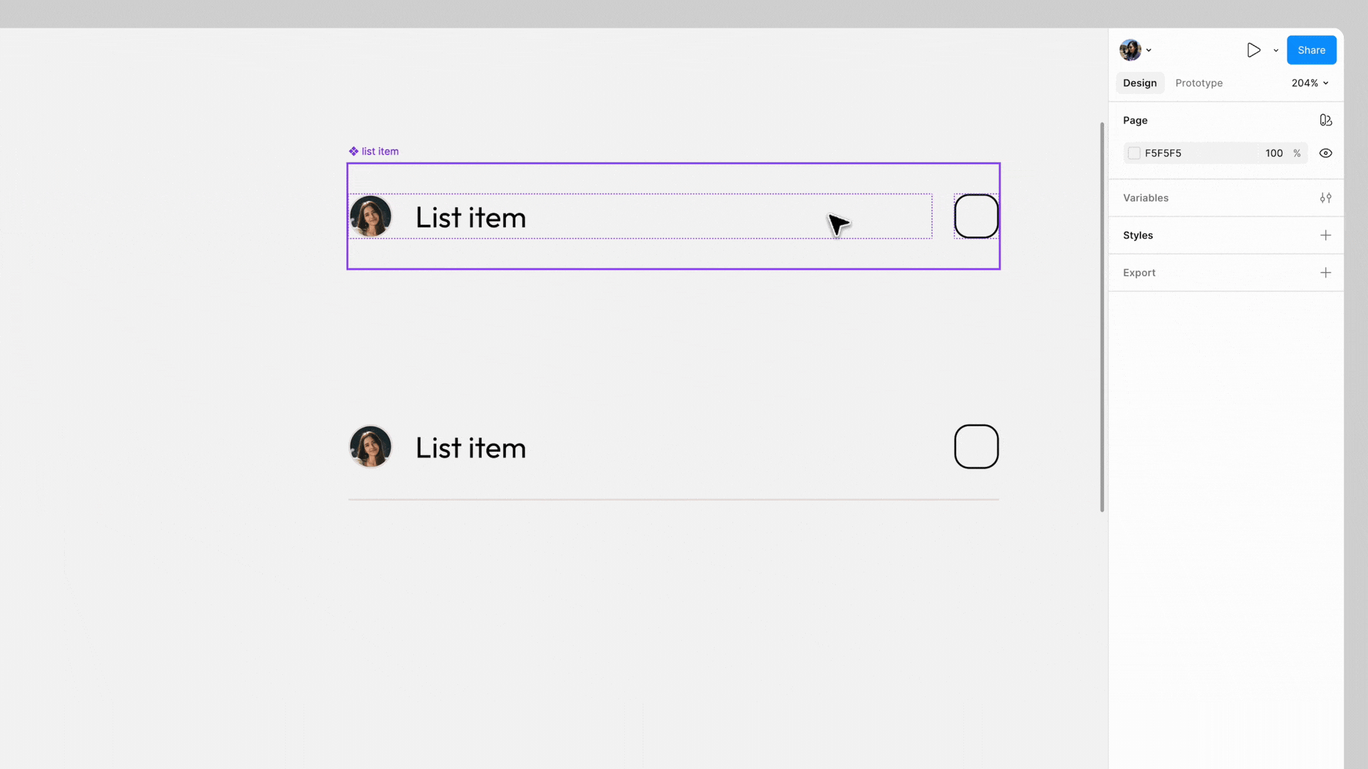

Create the list item component
Great! Now that we’ve created all the leading and trailing components, we’re ready to create the list item component.
List item. - Use the Typography section of the right sidebar to change the Font family to
Outfit, Font style toRegular, and the Font size to16. - Select the
avataricon component and hold the shortcut while dragging your cursor to create an instance:- Mac: Option
- Windows: Alt
- Drag the instance to the left side of the text layer we created.
- Select both the
avatarinstance and text layer, and press Shift A to apply auto layout. - Double-click on the new frame name and rename it to
contents. - Select the text layer inside the
contentsframe, and change its width resizing toFill container. - Select the
contentslayer and set the Gap to12in the Auto layout section. - Change the Horizontal padding and the Vertical padding to
0. - Select the default state of the
checkboxcomponent and hold the shortcut while dragging your cursor to create an instance:- Mac: Option
- Windows: Alt
- Drag the instance to the canvas, on the right side of the
contentsframe. - Select both the
contentsframe andcheckboxinstance, and press Shift A to apply auto layout. The spacing might look a bit off right now, but we’ll fix it in a few steps. - Double-click on the layer name and rename it to
list item. - In the Auto layout section of the right sidebar, change the Width of the frame to
350. - Change the Gap to
12. - Set Alignment to
Align left. - Change the Horizontal padding to
0and the Vertical padding to16. - Click Add stroke in the Stroke section to add a new stroke and configure it to the following:
- Fill:
#E9DFDB - Position:
Outside - Weight:
1
- Fill:
- Click Individual strokes and choose Bottom to apply the stroke along the bottom of the frame.
- Select the
contentslayer, and change its resizing toFill container. - Select the
list itemframe and click Create component in the right sidebar or use the keyboard shortcut:- Mac: Option Command K
Your component should look similar to the following:

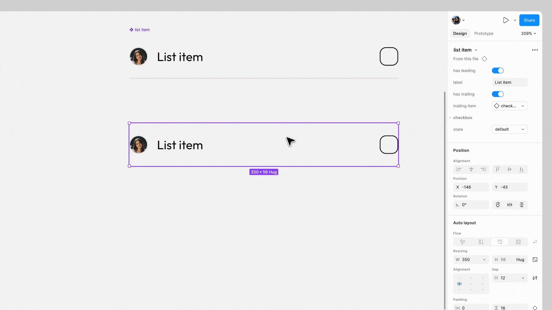

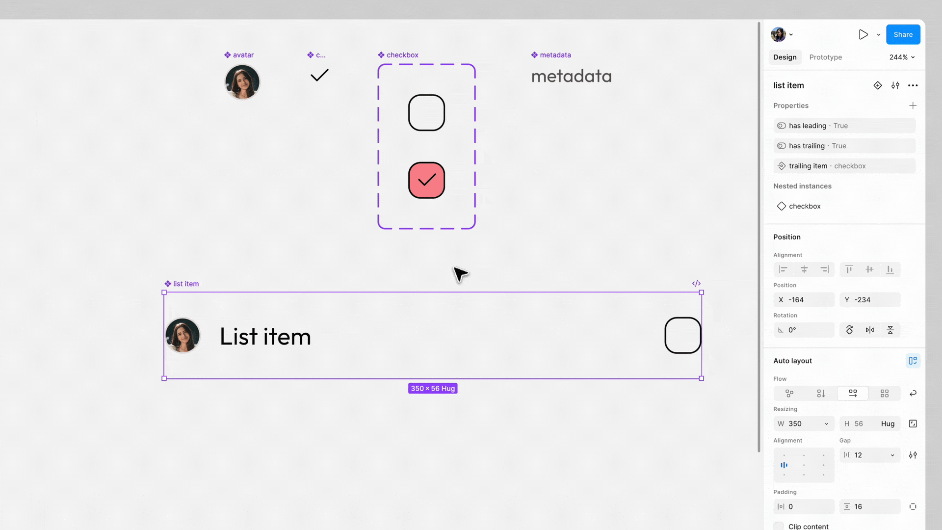

Apply component properties
The list item component is looking great! However, you may want to switch between different leading and trailing components, or you may not always need both items when reusing the component across different designs.
Instead of creating multiple variants to fit every possible combination, we can:
- Apply a boolean property to the leading and trailing components that will allow us to toggle their visibility on or off as needed
- Add an instance swap property to the trailing items that will let us easily switch between them
- Add text properties to the label and metadata that will create editable surfaces in the right sidebar that we can use to update the content

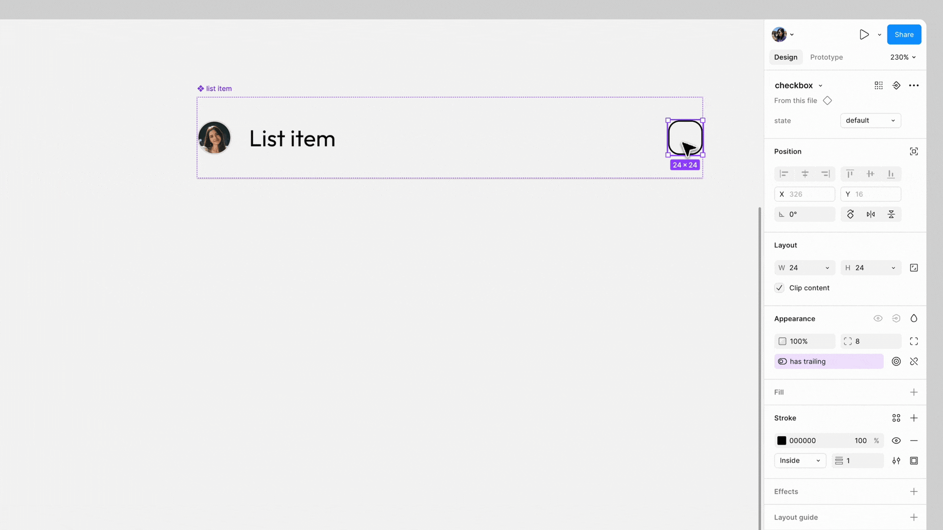

Apply the boolean properties
We’ll start by applying a boolean property to the leading and trailing items:
- Select the
avatarinstance inside thelist itemcomponent. - In the Appearance section of the right sidebar, click Apply variable/property.
- Click the plus to add a new property and configure it to the following:
- Create:
Property - Name:
has leading - Value:
True
- Create:
- Click Create property.
- Next, click the
checkboxinstance and repeat the process, configuring the new property to the following:- Create:
Property - Name:
has trailing - Value:
True
- Create:
Apply the instance swap property
Next, we’ll add the instance swap property for the trailing components.
- Select the
checkboxlayer inside thelist itemcomponent. - Near the top of the right sidebar, click Create instance swap property.
- Set the name to
trailing itemand keep the value as thecheckboxcomponent. - Click the plus next to Preferred instances to add the
metadatacomponent as a preferred instance. - Close the menu and click Create property.
Apply the text properties
Finally, we’ll a text property to the list item label and the text inside the metadata component.
We’ll start with the list item label:
list itemcomponent. - Next to the Content field at the top of the right sidebar, click Apply variable/property.
- Create:
Property - Name:
label - Value:
List item
- Create:
Next, apply a text property to the text inside the metadata component:
- Locate the metadata main component and select the text layer inside.
- Next to the Content field at the top of the right sidebar, click Apply variable/property next to the content input field.
- Create:
Property - Name:
textvalue - Value:
metadata
- Create:
Expose nested instance
To wrap things up here, we’ll expose the nested checkbox instance to reveal its properties alongside the list item component.
Why expose nested instances?
Exposing nested instances helps users discover nested instances and their associated component properties without having to deep-select individual layers to find them. It’s a small, but impactful, way to make your design system assets easier to use.
When you select a top-level instance with exposed nested instances, a list of component properties for the top-level and nested instances will appear in the right panel. When hovering over a property row, a purple highlight appears around the corresponding object on the canvas so you know what you’re editing.
- With
list itemcomponent selected, click plus in the Properties section of right panel and choose Nested instances under Expose properties from. - Select
checkboxand close the menu.
When you select the list item component, you’ll now see the new boolean properties and nested instance in the Properties section of the right sidebar.

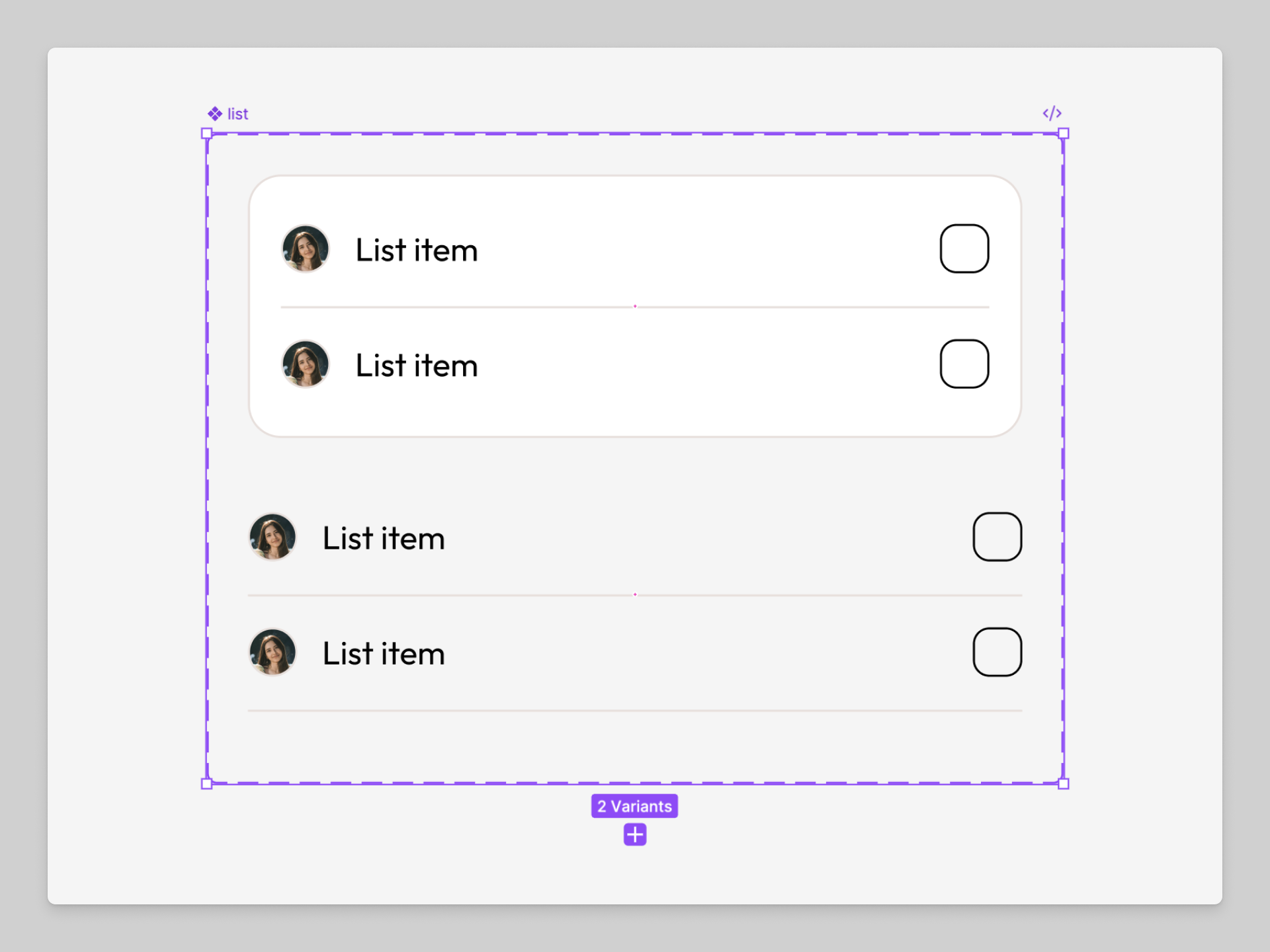

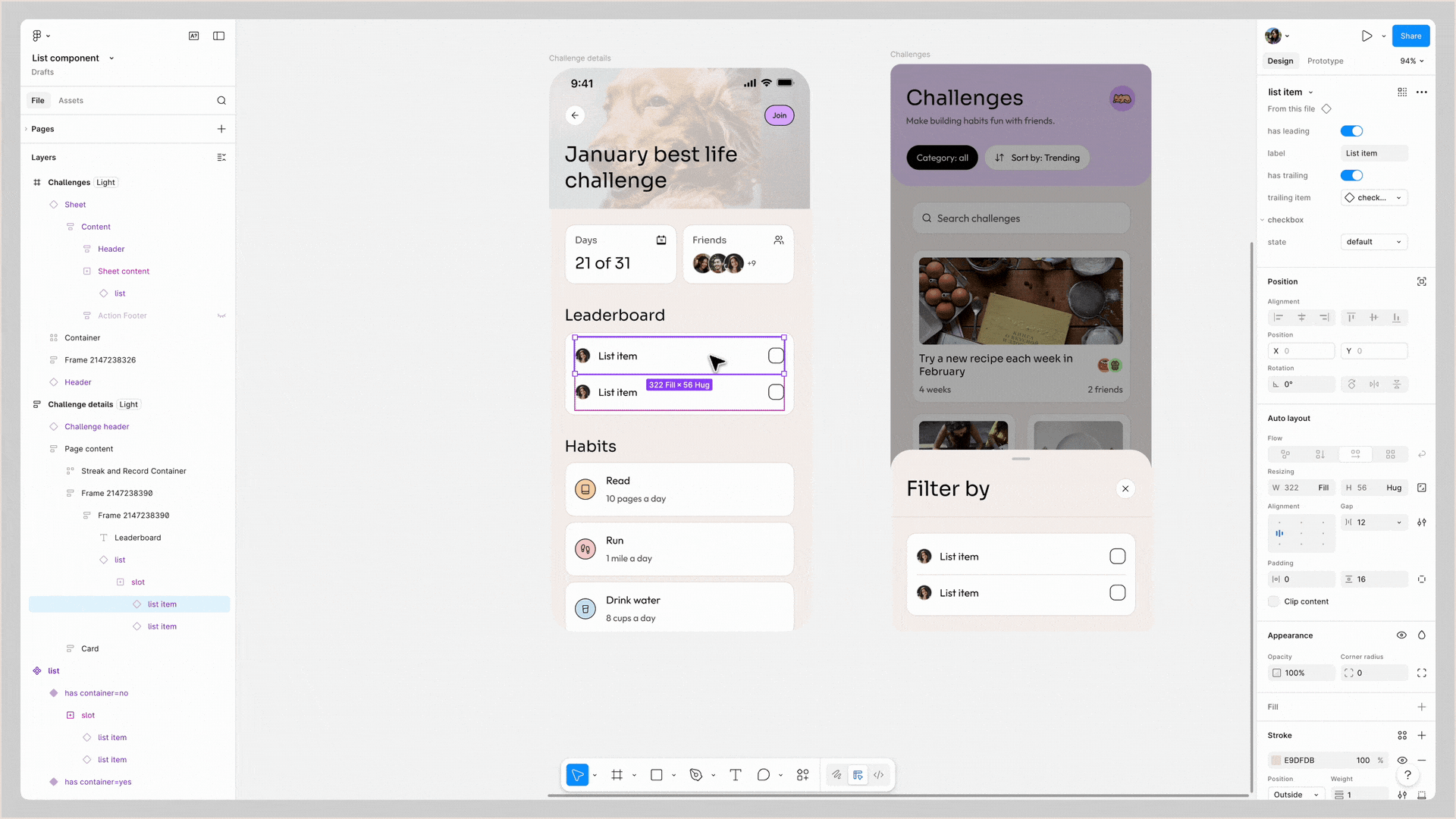

Create the list component
Now that we’ve created our list item component, we’re ready to build the list component. You might be wondering why we need to create an additional list component when we already have a list item component. Because list items are often used in repeating sets, a list component can help provide a consistent structure for layout and spacing.
To make the list component flexible enough to accommodate varying lengths, we’ll apply the slot property. This gives designers the freedom to control how many items appear in the list while preserving a consistent arrangement.
We’re going to create two variants for the list component: one with a container, and one without a container.
Create the variant with a container
We’ll build the container variant first:
- Select the
list itemcomponent and hold the shortcut while dragging your cursor to create an instance:- Mac: Option
- Windows: Alt
- Drag the instance to the canvas.
- With the instance still selected, duplicate it using the keyboard shortcut:
- Mac: Command D
- Windows: Ctrl D
- Select both instances, and press Shift A to apply auto layout.
slot. - In the Auto layout section of the right sidebar, change the Gap to
0and check the Clip content box. - Now with the
slotlayer still selected, and press Shift A to apply auto layout again. - Double-click on the layer name and rename it to
list/yes. - In the Auto layout section of the right sidebar, change the Gap to
0. - Change the Horizontal padding to
16and the Vertical padding to8. - Click the plus in the Fill section to add a
#FFFFFFfill. - Click the plus in the Stroke section to add a new stroke.
- Configure the stroke to the following:

Create the variant without a container
Now let’s create the variant without a container.
- Select the
list/yescomponent you just created and click Create variant in the right sidebar. - In the Current variant section of the right sidebar, click on the property name (currently called Property 1) and change it to
has container. - Click on the property value (currently called Variant2) and change it to
no. - Update the following auto layout settings:
- Gap:
0 - Horizontal padding:
0 - Vertical padding:
0
- Gap:
0. - Click the minus in the Fill section to remove the frame’s fill.
- Click the minus in the Stroke section to remove the frame’s stroke.
- Select the
slotlayer and uncheck the Clip content settings to reveal the bottom stroke of the last list item.

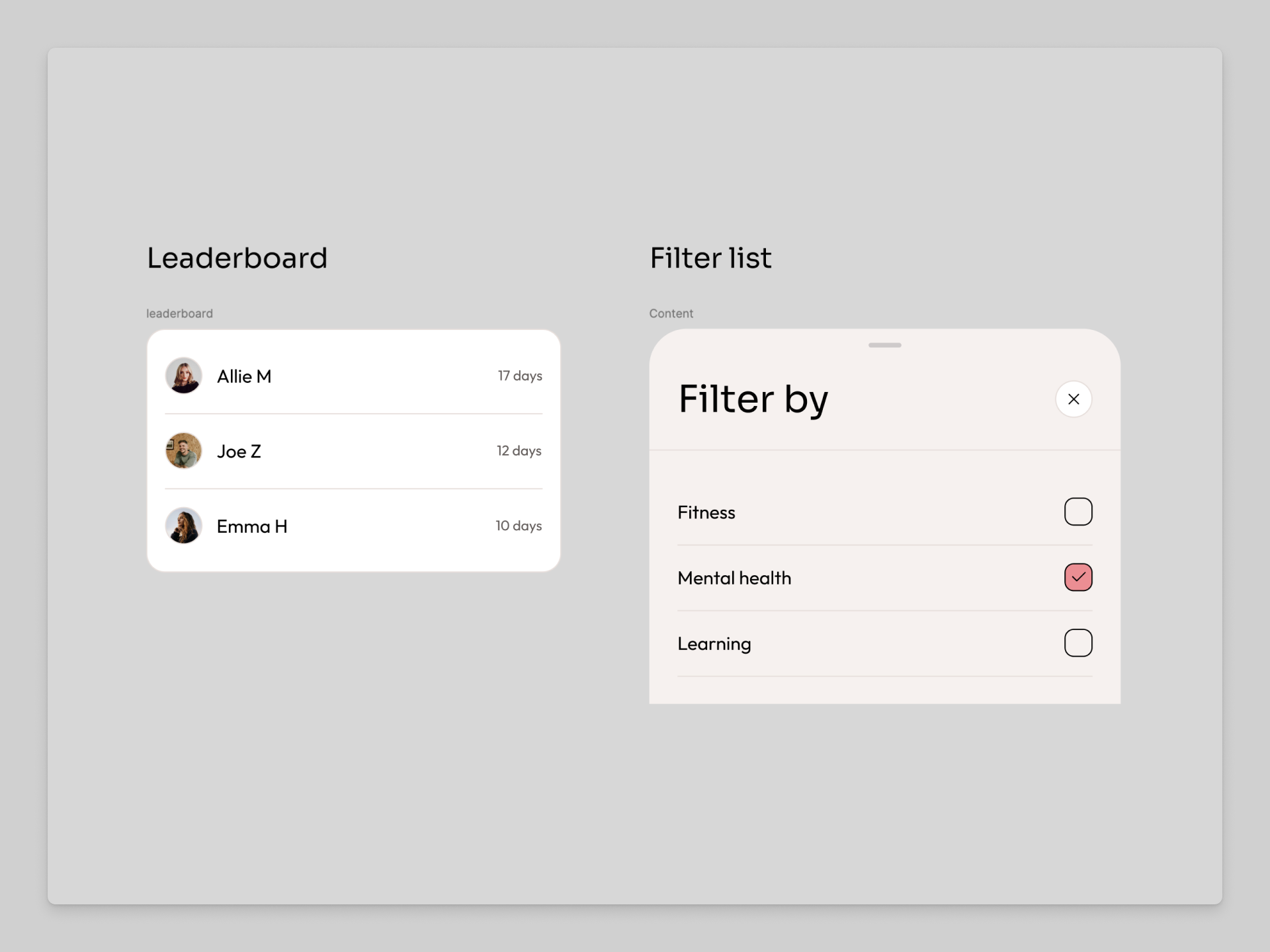

Test your list component
Our component set is now completed and now you can use it across different screens. With the slot property, users are able to add and arrange new list items directly without detaching your component. This gives more flexibility to design system consumers and allows healthier design systems.
