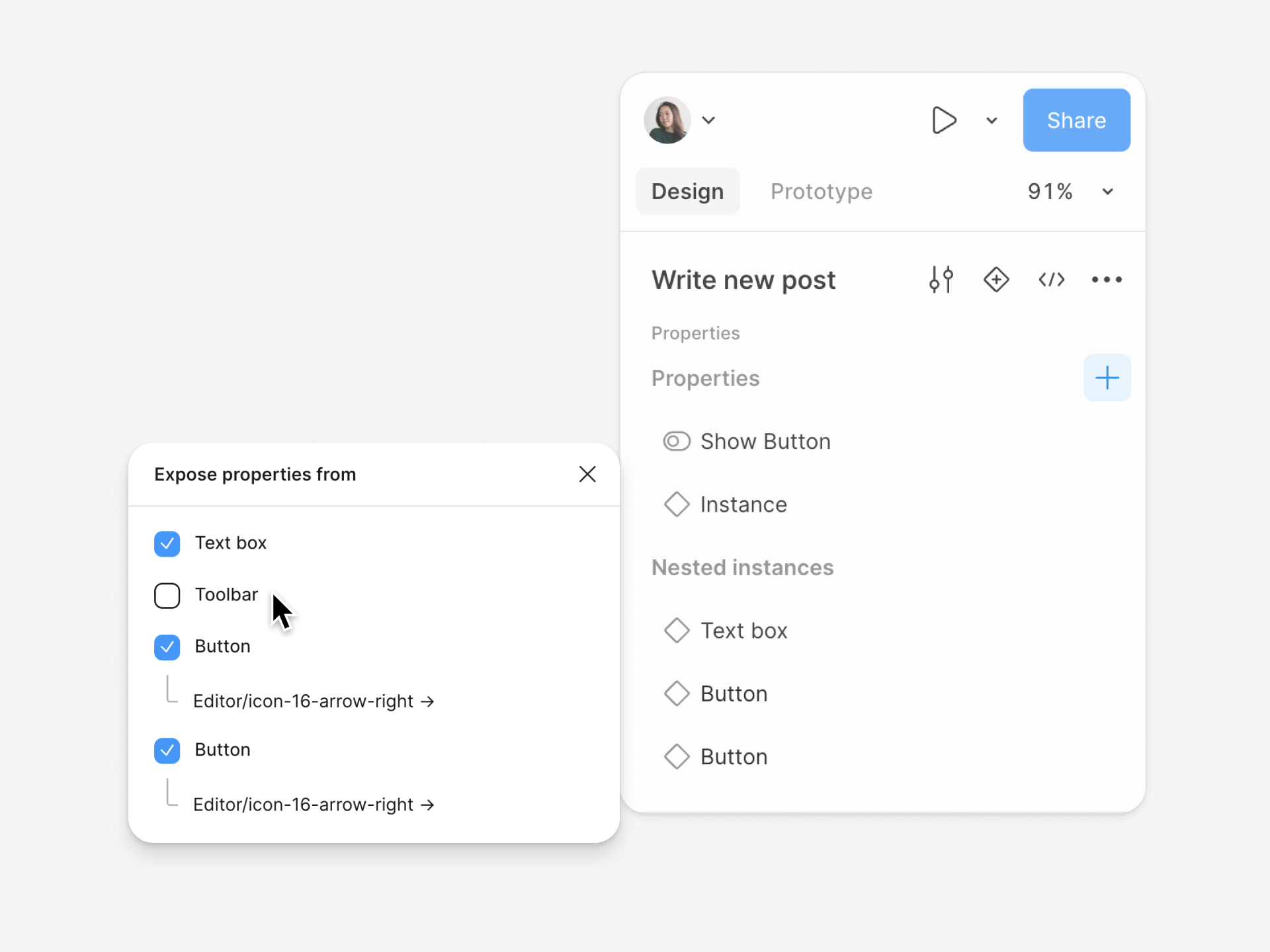

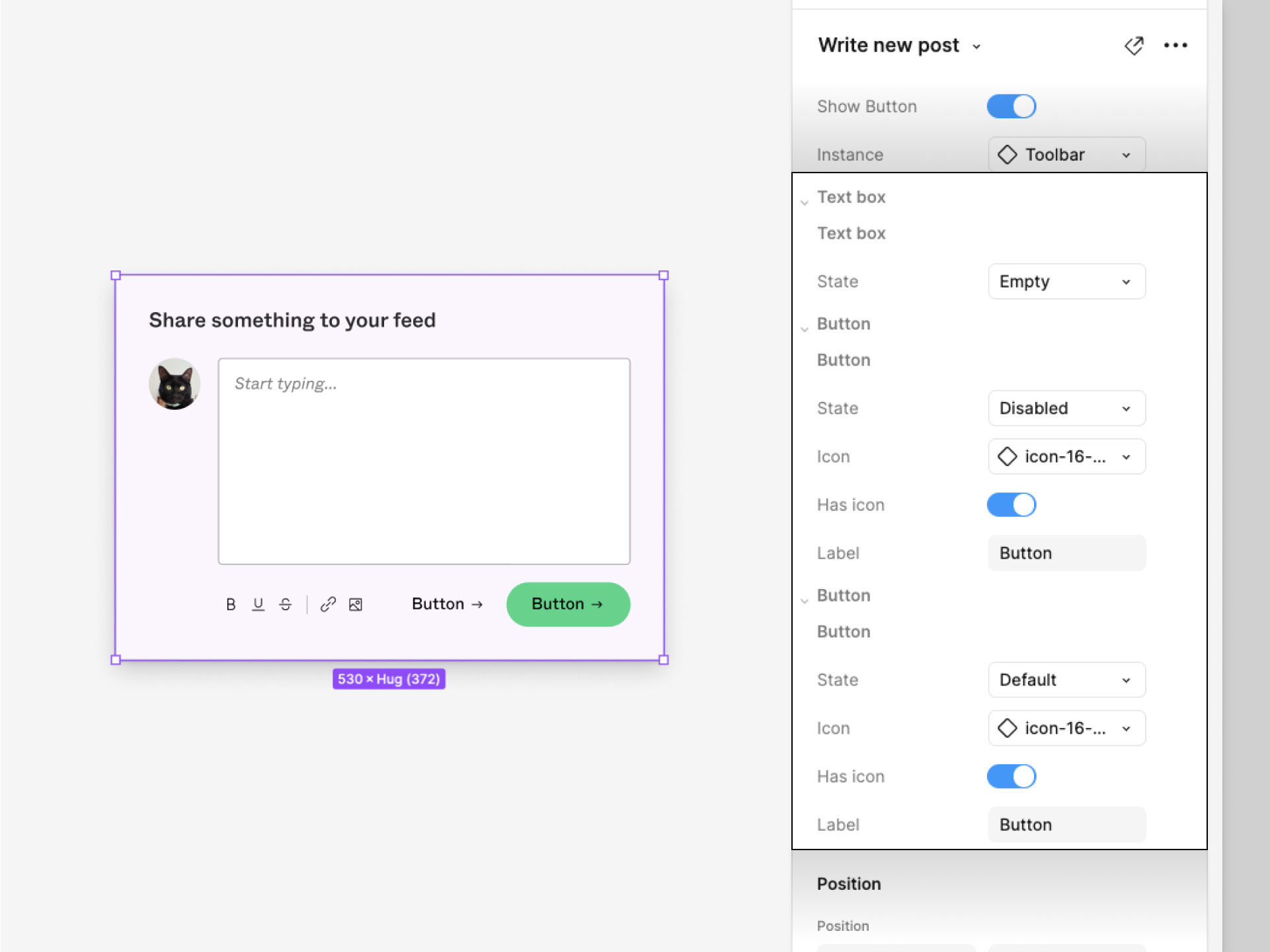

Expose nested instances
Expose specific nested instances to reveal their component properties alongside those of the top-level instance. This helps design system users discover nested instances and their component properties without deep-selecting layers to find them.
For example, you create a social media card component with multiple components nested inside — an avatar, name, buttons, and so on. You want to change the icon of the default button to a “send” icon, and change its text. You also want to change the cancel button state to a disabled state.
Instead of deep-selecting into each layer to find their component property controls, exposing nested instances allows you to click just the top-level component — in this case, the social media card — and edit your instance from a single place.
When you select a top-level instance with exposed nested instances, a list of component properties for the top-level and nested instances will appear in the right panel.
When hovering over a property row, a light purple highlight appears around the corresponding object on canvas so you know what you’re editing.
Note: If you have an exposed nested instance with visibility set to hidden on a boolean property, any component properties attached to the instance will be hidden as well.
Choose nested instances to expose
With a main component or component set selected, click in the Properties section of right panel and choose Nested instances under Expose properties from.
Note: The option to expose nested instances is available only if a main component:
- already has an exposed nested instance, or
- contains nested instances with component properties applied to it
If you don’t see the Nested instances option, try applying a component property to a nested component first.
From the Expose nested instances modal, check the boxes for instances you want to reveal at the top-level.
A list of chosen nested instances will appear in the right panel.
To remove nested instances from being exposed, hover over the instance name on this list and click .
