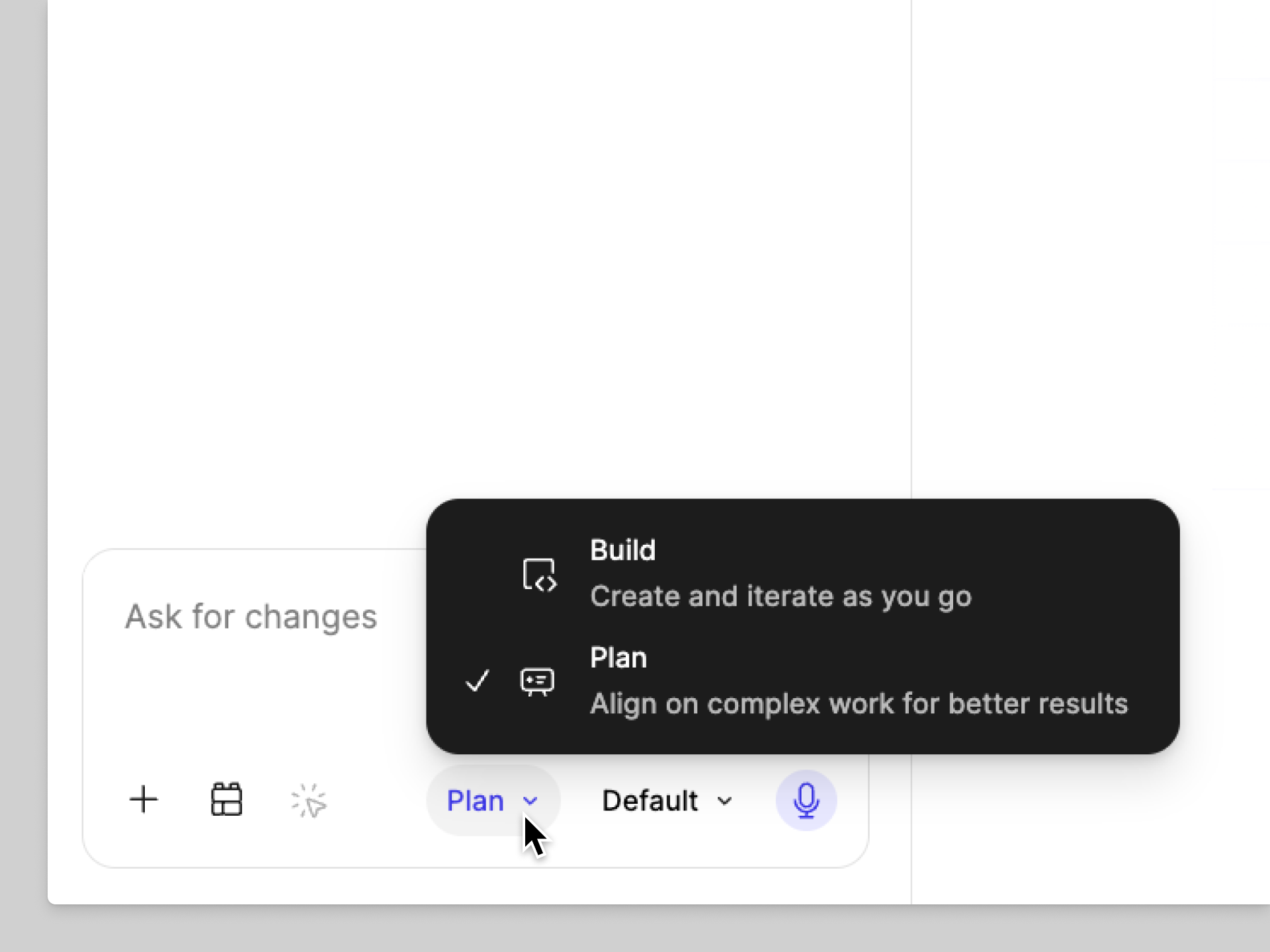

Turn on plan mode
You can switch on plan mode in two ways:
- In the prompt box, click the mode dropdown and select Plan.
- Type
/planin the chat
To switch back to build mode, click the mode dropdown in the prompt box and select Build.

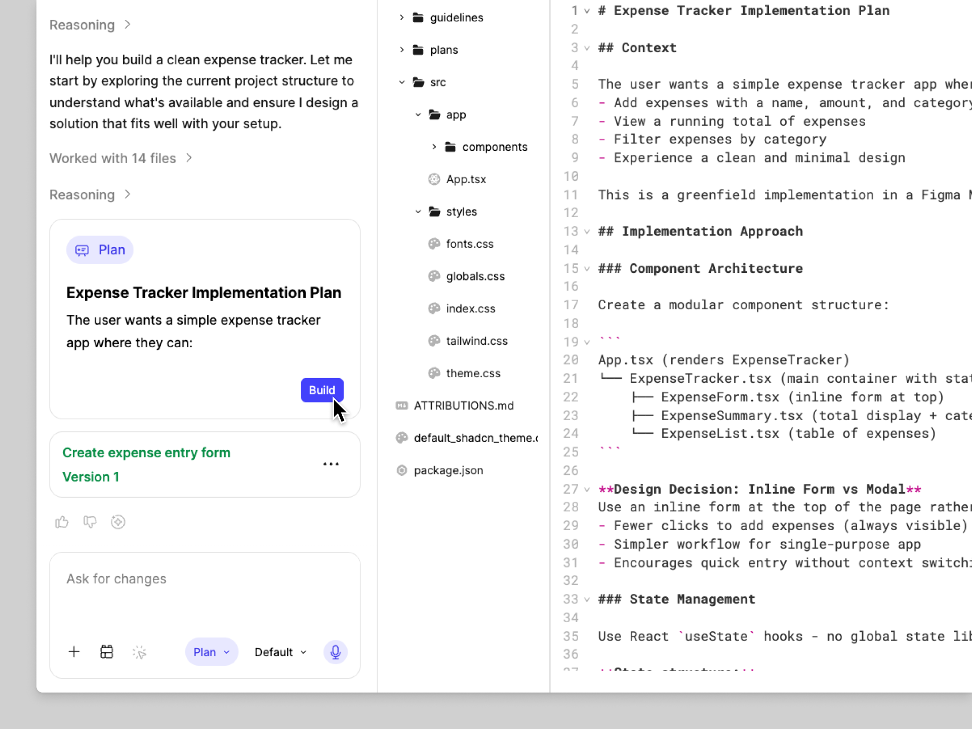

Generate and refine
Once it has what it needs, Make generates a structured plan in real time. The plan appears in the chat and creates a plan markdown file, which opens automatically when the plan is ready.
Before anything gets built, you can edit the plan until it looks right:
- Open
plan.mdto adjust the structure, add details, or remove sections - Continue the conversation in the chat to ask Make to revise the plan
There's no limit to how many times you can refine before approving.
Approve and build
When the plan looks right, click Build in the chat. Make will execute the plan and begin generating code for your project.
