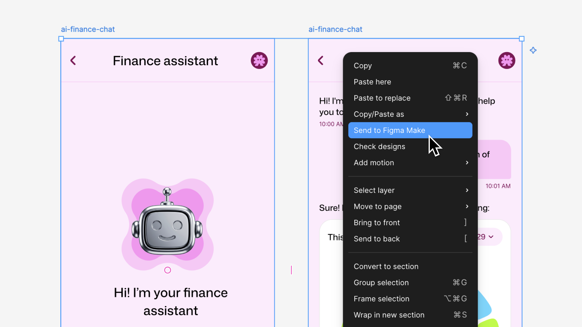

Use Send to Make when you don't have an existing Make file and want to kick off a new prototype using the current selection on the canvas.

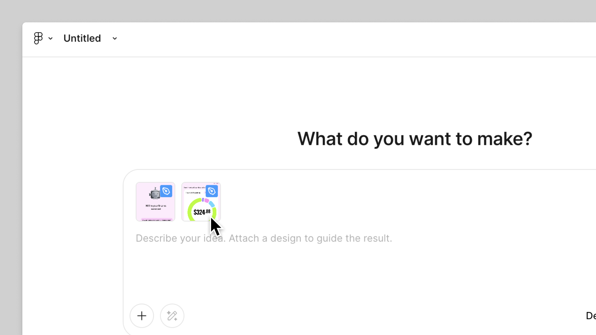

Start by attaching your design to a Make prompt. You can do this in a fresh Figma Make file, or one you've been working on for a while.
The easiest way is to copy frames directly from your design file and paste them into the prompt box.

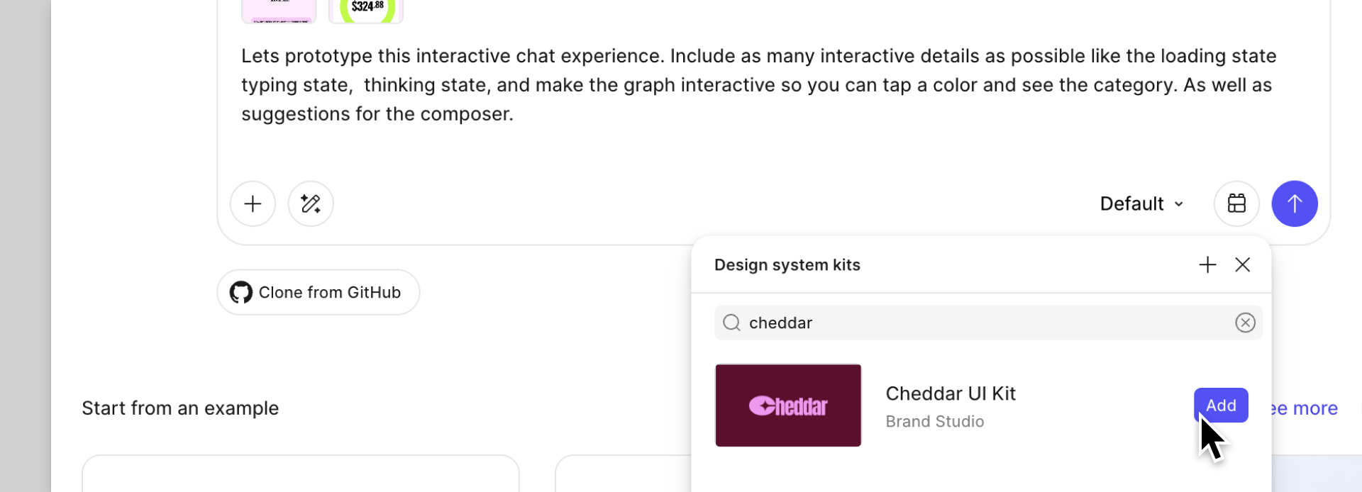

Apply a Make kit
A Make kit bundles your design system — npm packages, library styles, and usage guidelines — so Make builds using your actual components and tokens. Without it, Make falls back on generic web defaults. Your first output will be closer if the kit is in place from the start.
If your team has published one, select it before prompting.

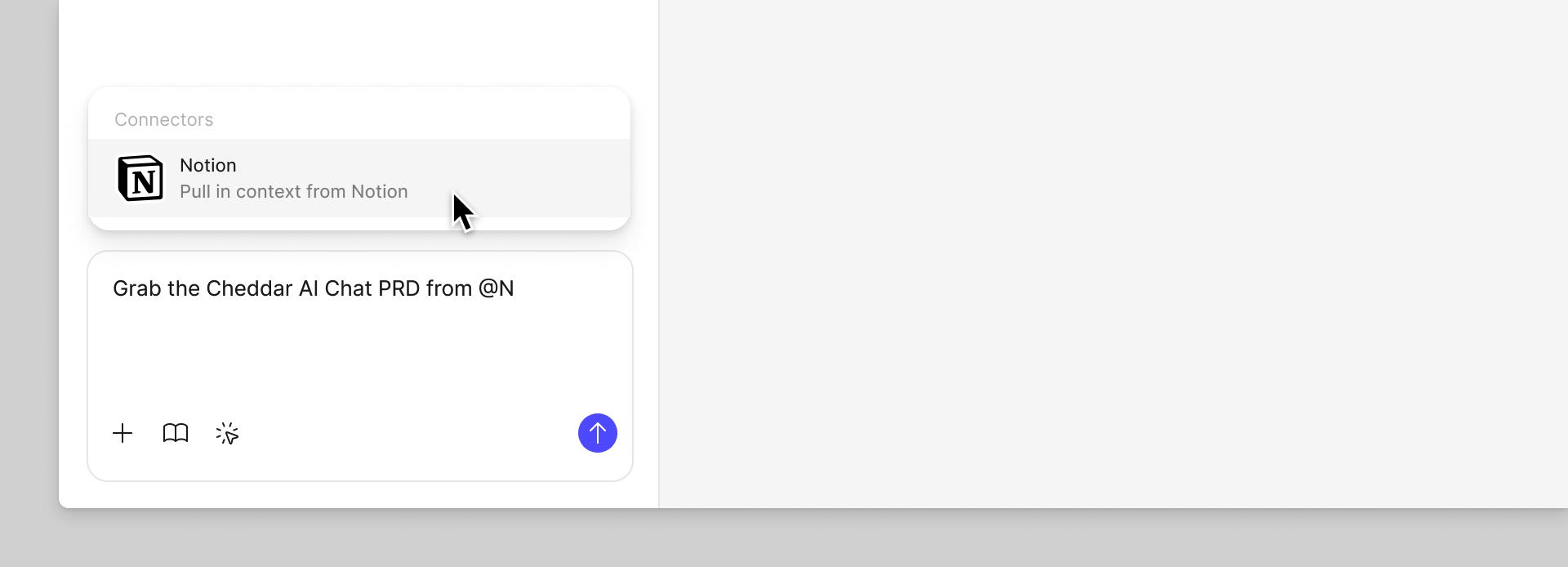

Connect external context
If the component ties back to a spec or PRD, connect the relevant source using an MCP connector. Paste a Notion link and tell Make to use it as the brief — if the spec updates, run the connector again and Make will incorporate the changes. The Figma Make connector library includes Notion, Jira, Confluence, Linear, and others. You can also create a custom connector to connect any MCP server your team runs.

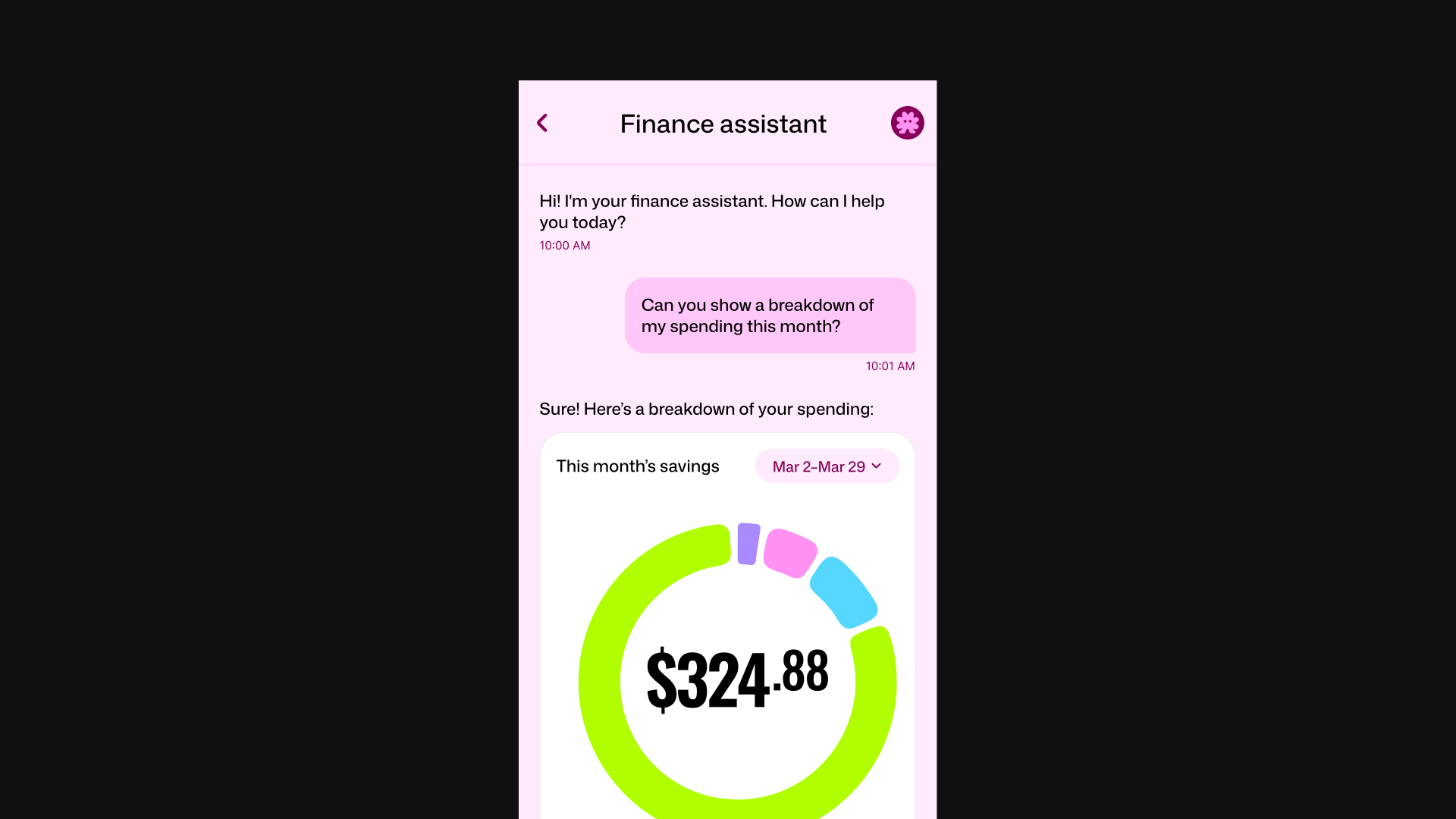

Keep iterating
Once the initial build lands, keep prompting. Ask for specific interactions, edge states, loading behavior. Make remembers what you've attached, so you can build on it step by step rather than re-explaining the design each time.
How’s the interaction looking?
Working through an interaction in Make tends to surface things that don't show up in static frames. For example, an edge state you hadn't designed for or a transition that feels off at real speed.
In this case, Rachel’s been inspired by the auto-suggestions that pop up above the chat box. She’d like to explore that idea a bit more on the canvas.
