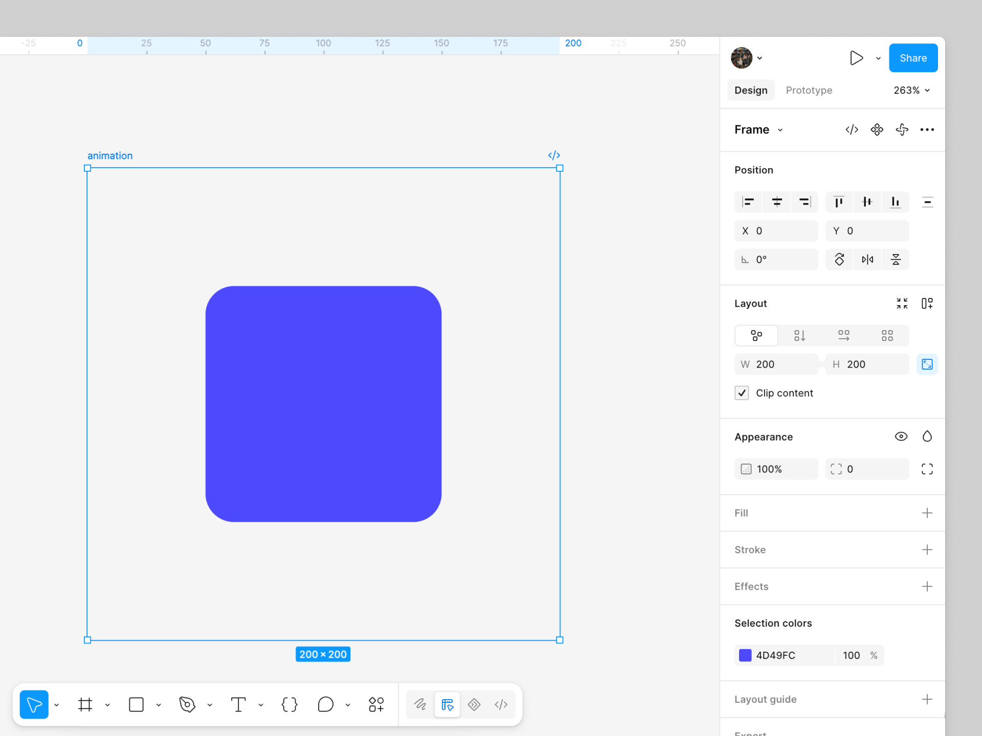

- Use the Frame tool to add a 200 X 200 frame to the canvas.
- Double-click the frame name and rename it to
animation. - Use the Rectangle tool to create a 100 X 100 square and center it inside the frame. Rename this layer to
square. - Select the
squarelayer, set its Corner radius to 12, and change its fill to any color you’d like. We’re using#4D49FC. - Select the
animationframe and click the minus in the Fill section to remove its fill.
Your square should look similar to the following:

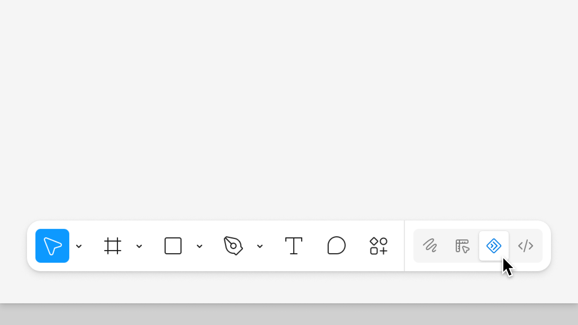

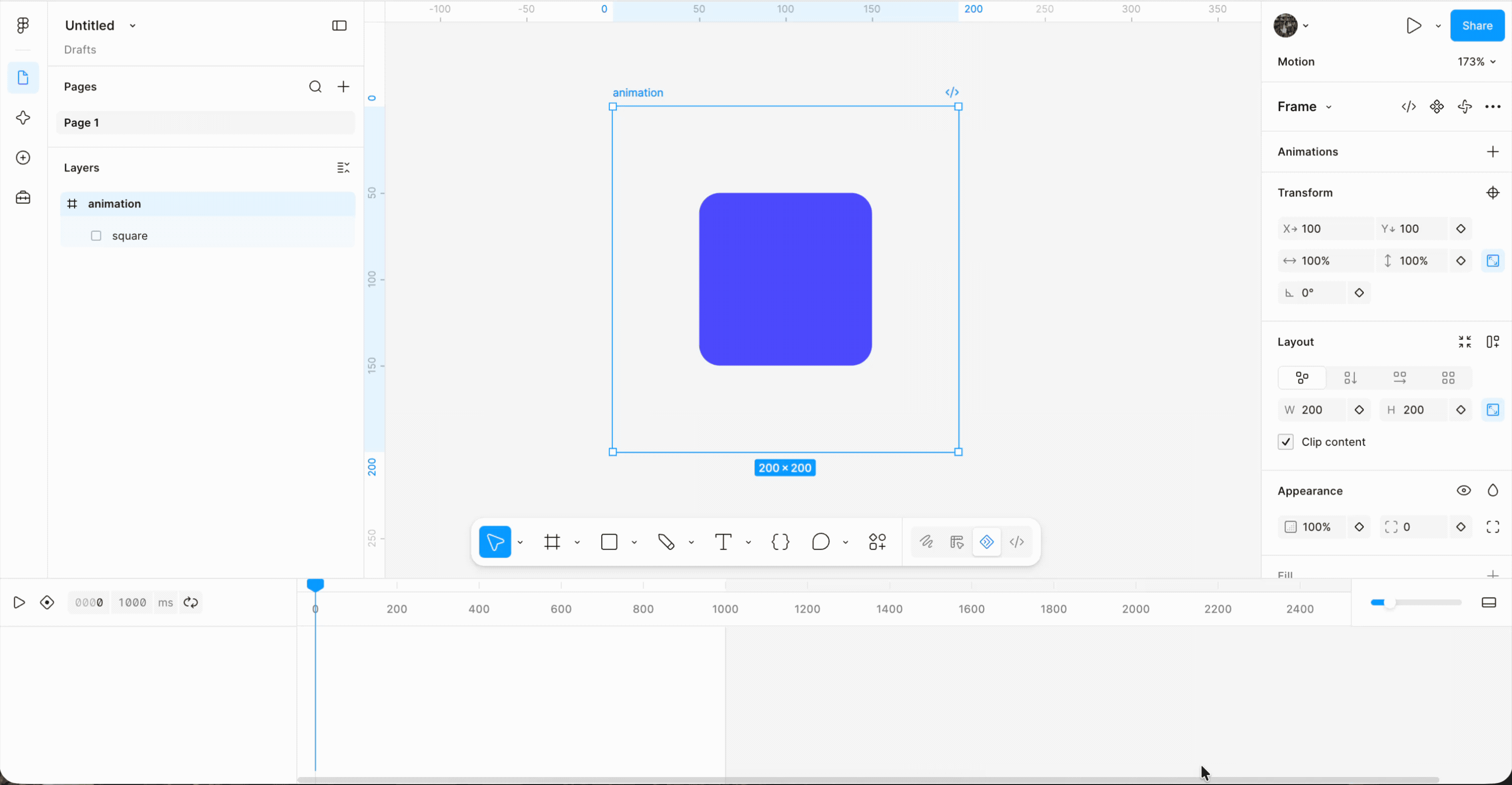

Open Figma Motion
To open Figma Motion, switch the toolbar toggle to Motion. Once enabled, you’ll see the timeline across the bottom of your screen.
Change the timeline duration
Select the square layer inside the animation frame and take a look at the timeline controls. By default, the timeline is set to 2000 milliseconds for new animations. That’s longer than we need so update the value in the Duration field to 1000.

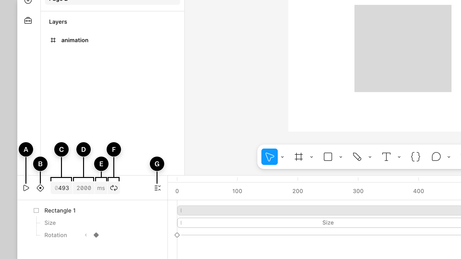

Becoming familiar with the timeline controls
If you're new to working with the timeline, here's a quick explanation of each setting:
A. Play: Click Play or press Spacebar to preview your animation. Click Pause or press Spacebar again to stop the playback.
B. Auto-keyframe: When enabled, any change you make to an object is automatically recorded as a keyframe on the timeline.
C. Current time: Shows the playhead's current position on the timeline. Enter a value to jump to a specific point in time.
D. Duration: Shows the total length of the timeline. Enter a value to increase or decrease it.
E. Time unit: Shows the time unit displayed on the timeline. Click to toggle between seconds and milliseconds.
F. Playback: Controls how the animation repeats. Click to cycle between once, loop, and ping-pong.

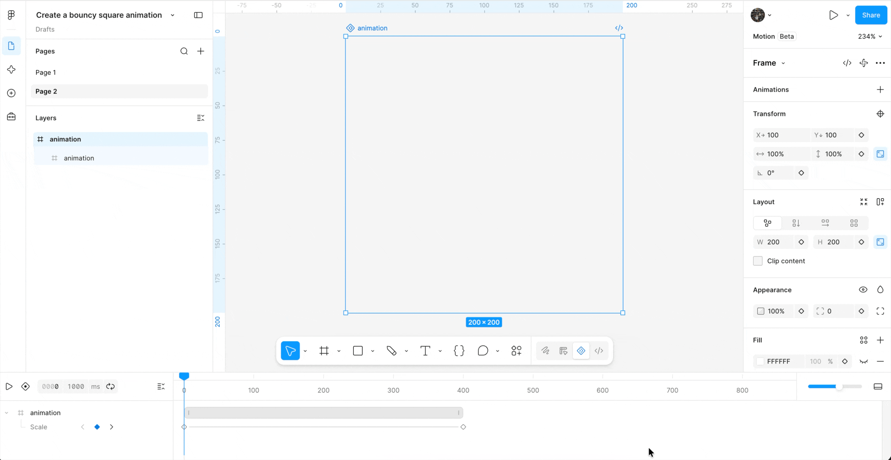

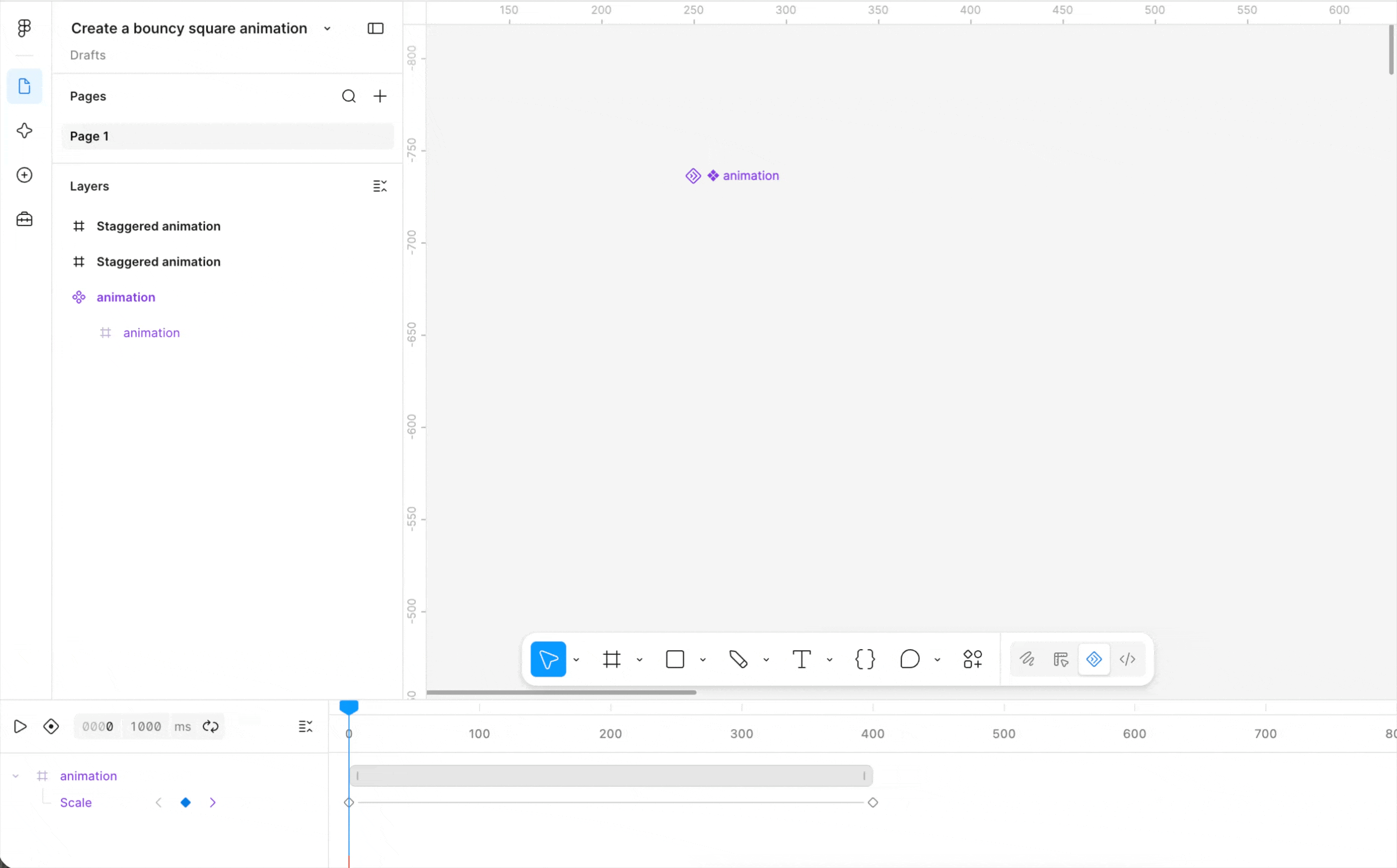

Create the scale animation
We want our square to scale from 0% to 100% over 400 milliseconds. We’ll build this animation backwards, starting with the final state.
- Move the playhead to the 400 millisecond mark by clicking and dragging it, or by typing 400 in the Current time field.
- Select the
squarelayer. In the right sidebar, click Add keyframe next to the Motion scale X and Motion scale Y fields to add a new keyframe to the timeline. Since this is our end state, leave the value set to100%. - Move the playhead back to the 0 milliseconds mark.
- Click Add keyframe next to Motion scale X and Motion scale Y again, then change the value to
0%. Setting the scale to0%will hide thesquarelayer until you preview the animation. - Click Play or press Spacebar to preview your animation.

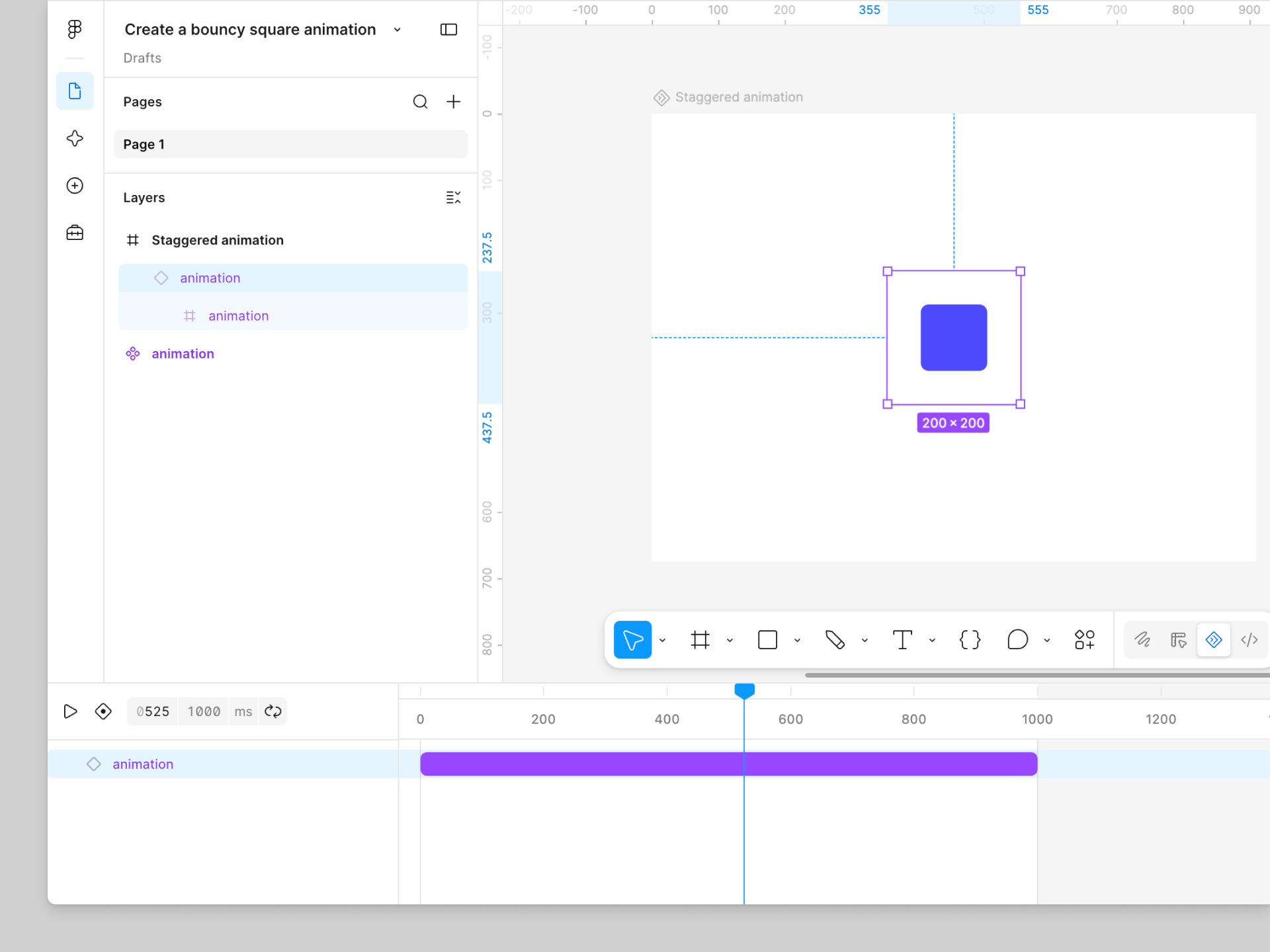

Use instances to create a staggered animation
Now that your animation is a main component, you can add instances of it to create more complex animations.
- Add a new 800 X 800 frame to the canvas.
- Select your
animationmain component and duplicate it to create an instance using the shortcut:- Mac: Command D
- Windows: Control D
- Click and drag the instance into the new frame you just created.

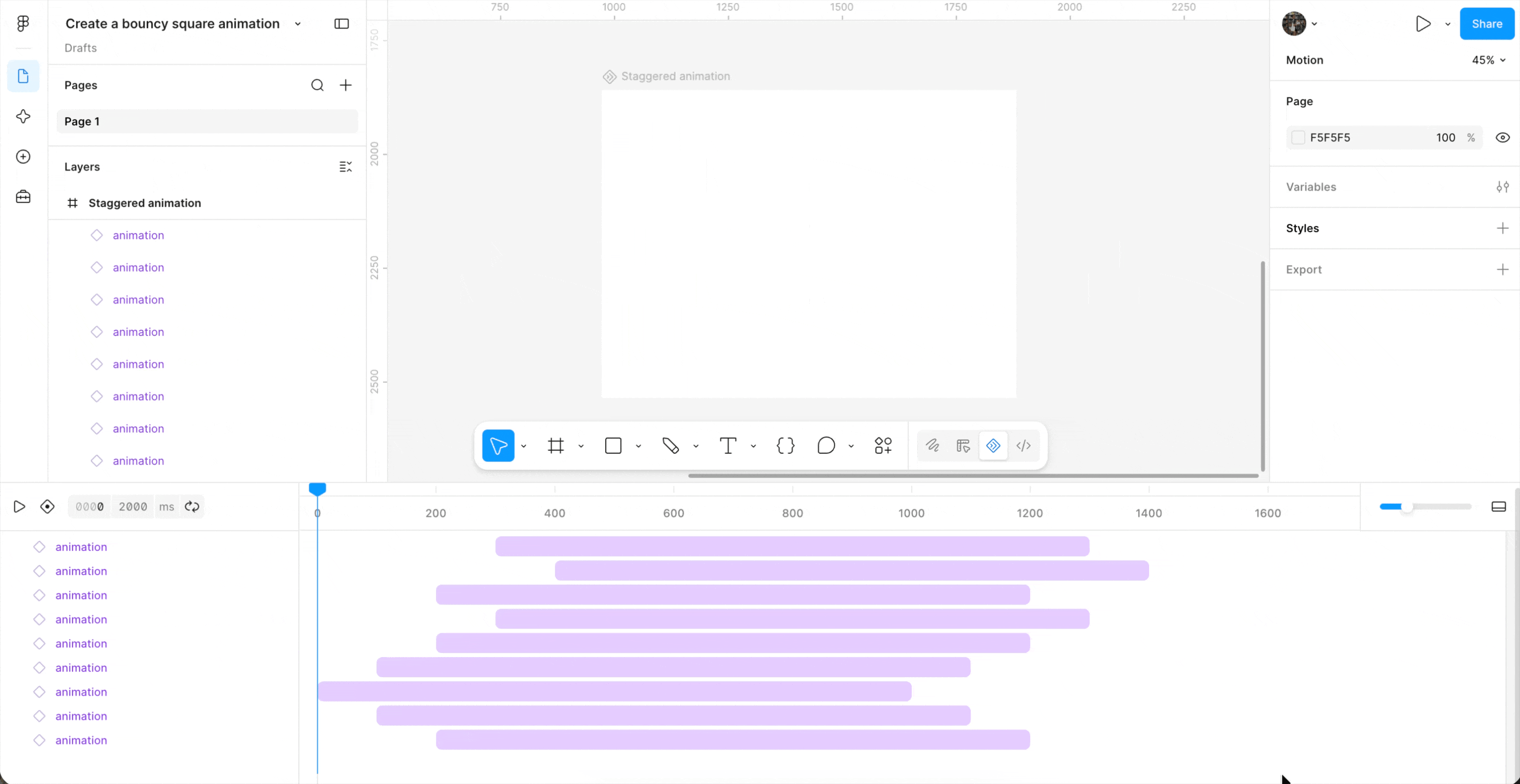

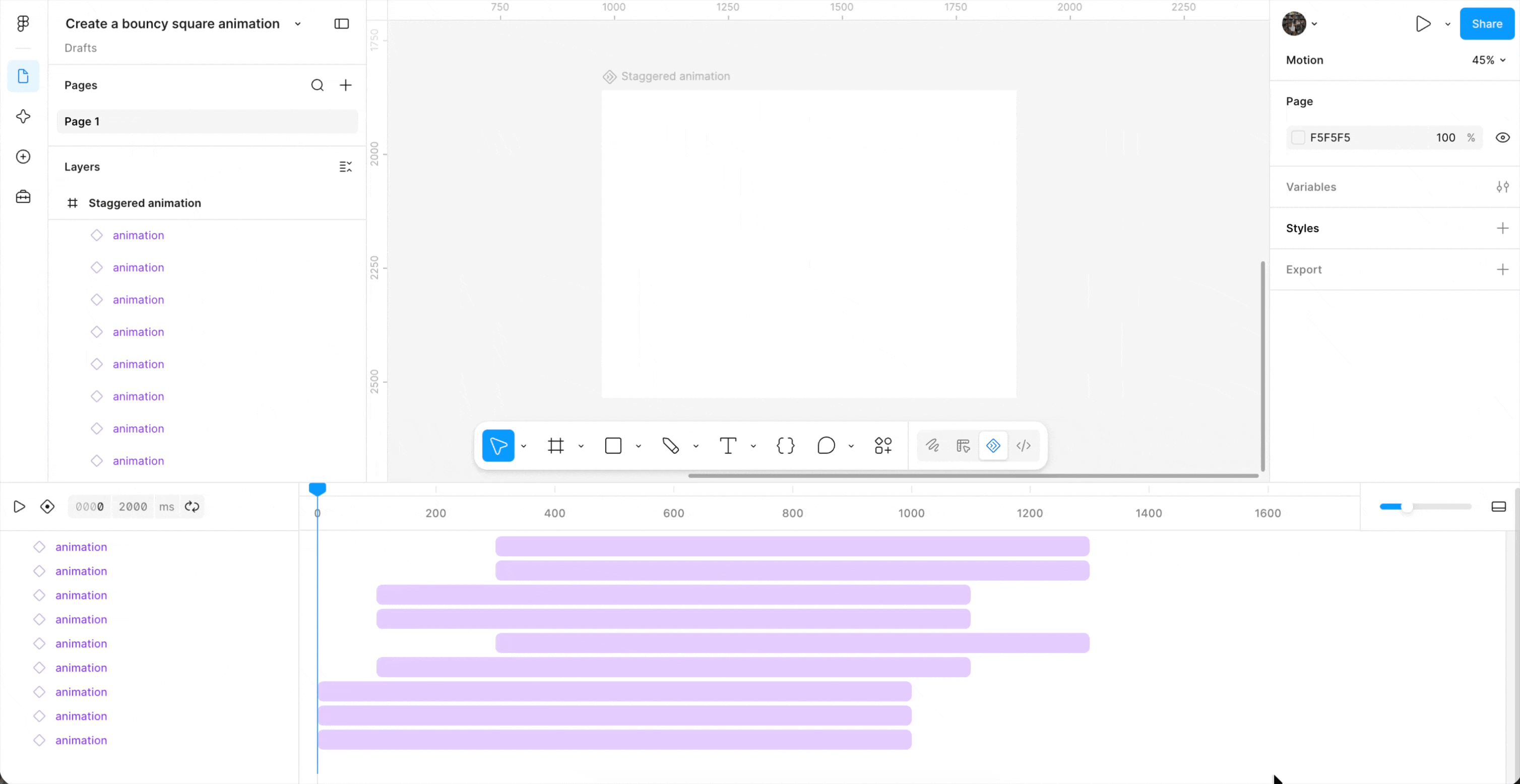

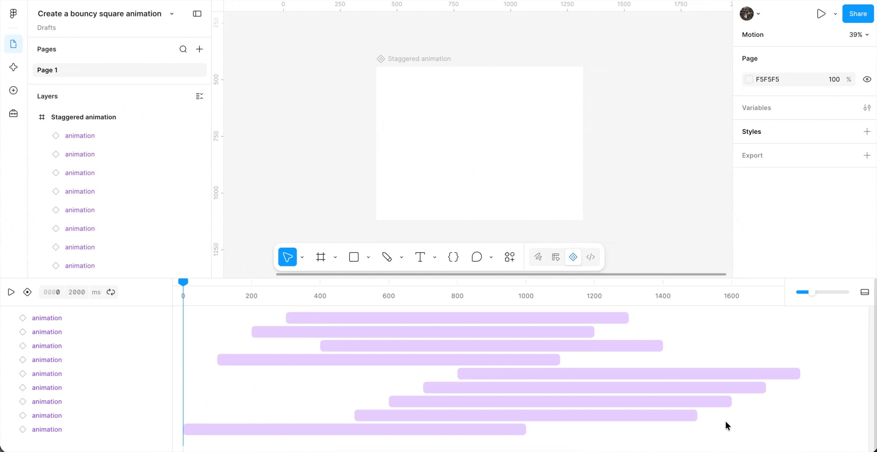

Take a look at the timeline. You’ll notice that animated instances look a bit different than other layers. Instances appear as purple layer tracks on the timeline. You can click and drag the layer track to reposition it, but you cannot change its duration or any animations applied to it. You’ll need to make those changes at the main component level.
Add as many instances as you’d like and play around with staggering their start times. Here are a few ideas to spark your inspiration.
