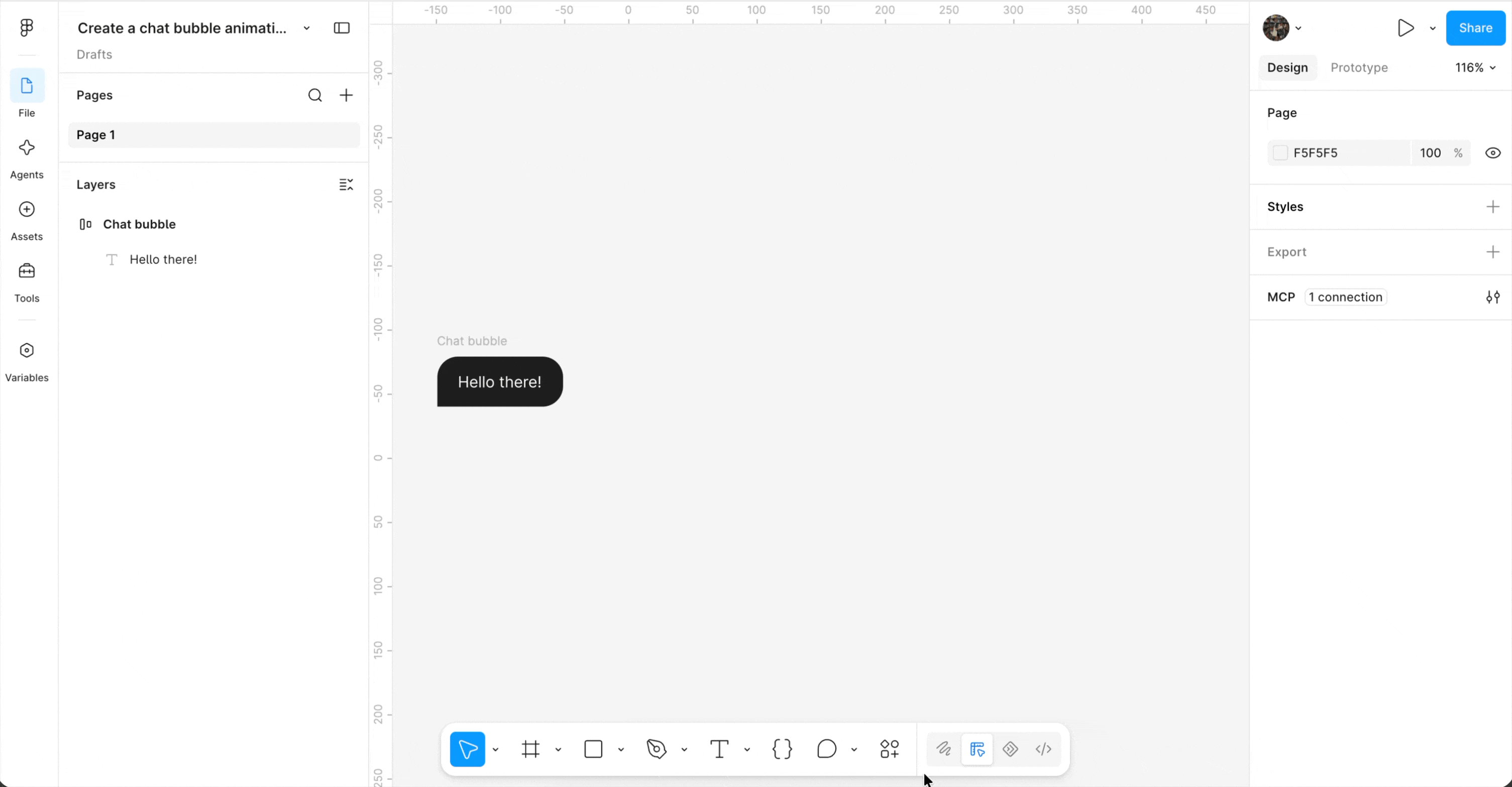

Create the chat bubble
We’ll start by creating a quick chat bubble design.
- Use the Text tool to add a new text layer to the canvas and enter a short message like ‘Hello there!’.
- Use the Typography section to style the text. We’re using:
Font family:
Inter -
Font size:
20 -
Font weight:
Regular
Font family:

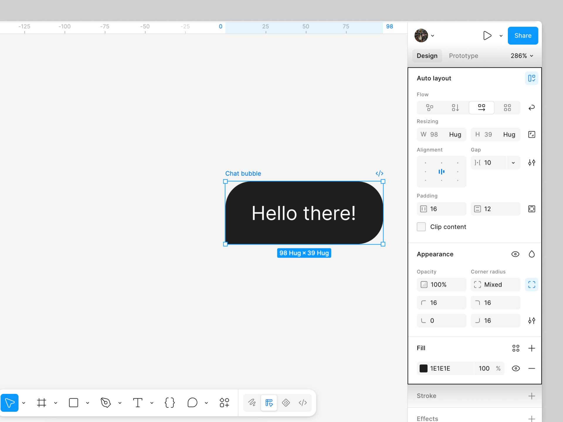

- Select the text layer and press Shift A to apply auto layout.
- Rename the frame to
Chat bubble. - Click the plus in the Fill section to give the
Chat bubbleframe a fill and set it to#1E1E1E. - Set the text layer fill to
#FFFFFF. - In the Auto layout section of the right sidebar, configure the auto layout settings:
Alignment:
Center -
Horizontal padding:
16 -
Vertical padding:
12
Alignment:
- In the Appearance section of the right sidebar, click Individual corners, then set the corner radius to the following:
Top left corner radius:
16 -
Top right corner radius:
16 -
Bottom right corner radius:
16 -
Bottom left corner radius:
0
Your chat bubble should look similar to the following:

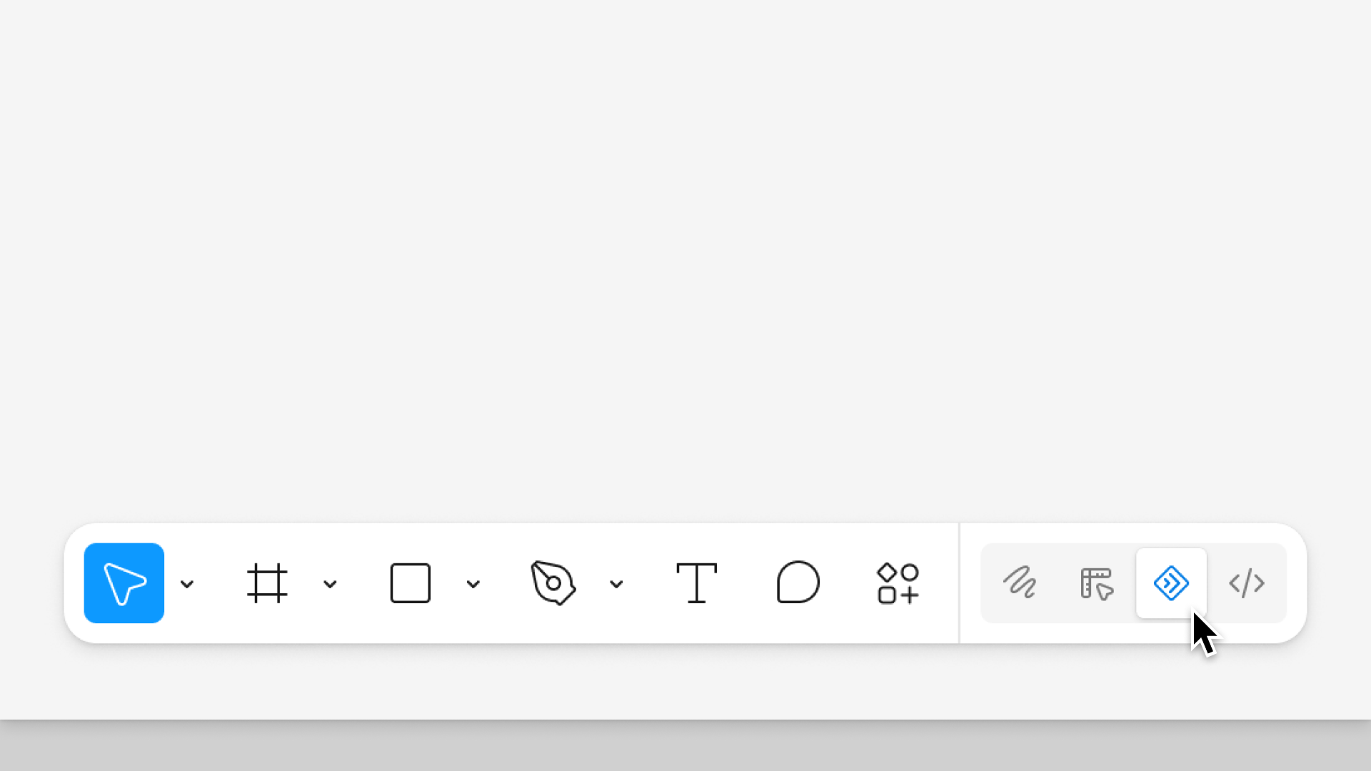

Open Figma Motion
To open Figma Motion, switch the toolbar toggle to Motion. Once enabled, you’ll see the timeline across the bottom of your screen.

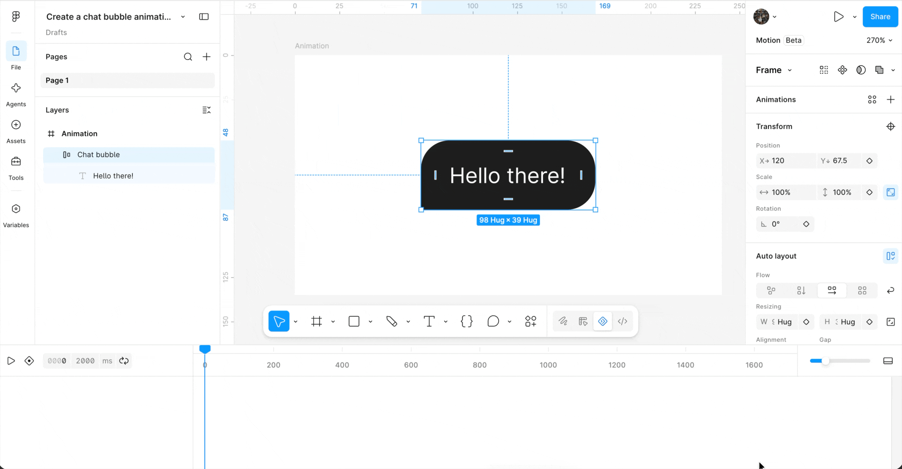

- Select the
Chat bubbleframe. - Click Edit anchor point in the Transform section of the right sidebar or use the shortcut to reveal the anchor point target:
- Mac: Option R
- Windows: Alt R
- Click and drag the target to the bottom left corner of the frame.

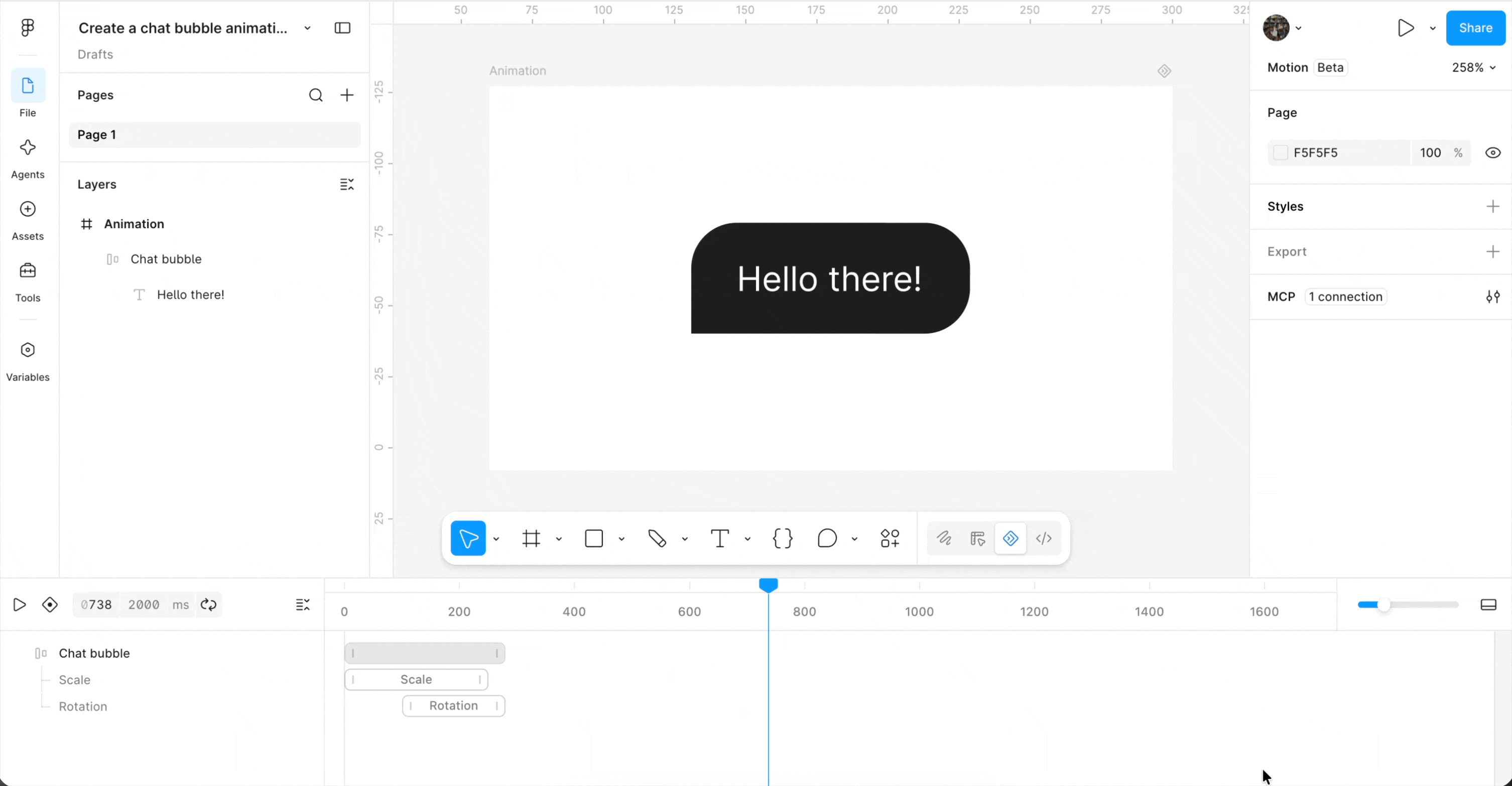

Add a scale animation
Now that our anchor point is set, we’re ready to start adding animations.

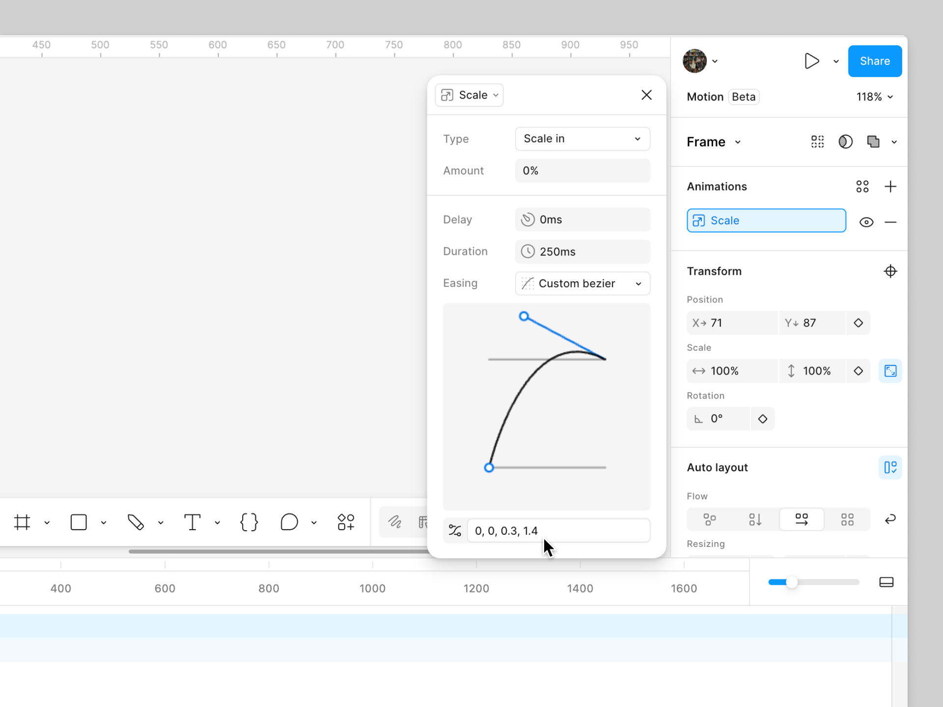

First, we’ll add a scale animation:
- Select the
Chat bubbleframe. - Click the plus in the Animations section to add a new animation.
- Select Scale from the dropdown menu, then configure the following settings:
Type:
Scale in -
Amount:
0% -
Delay:
0ms -
Duration:
250ms
Type:
- From the Easing dropdown menu, choose Custom bezier, then enter
0, 0, 0.3, 1.4in the Bezier field to configure the custom curve.

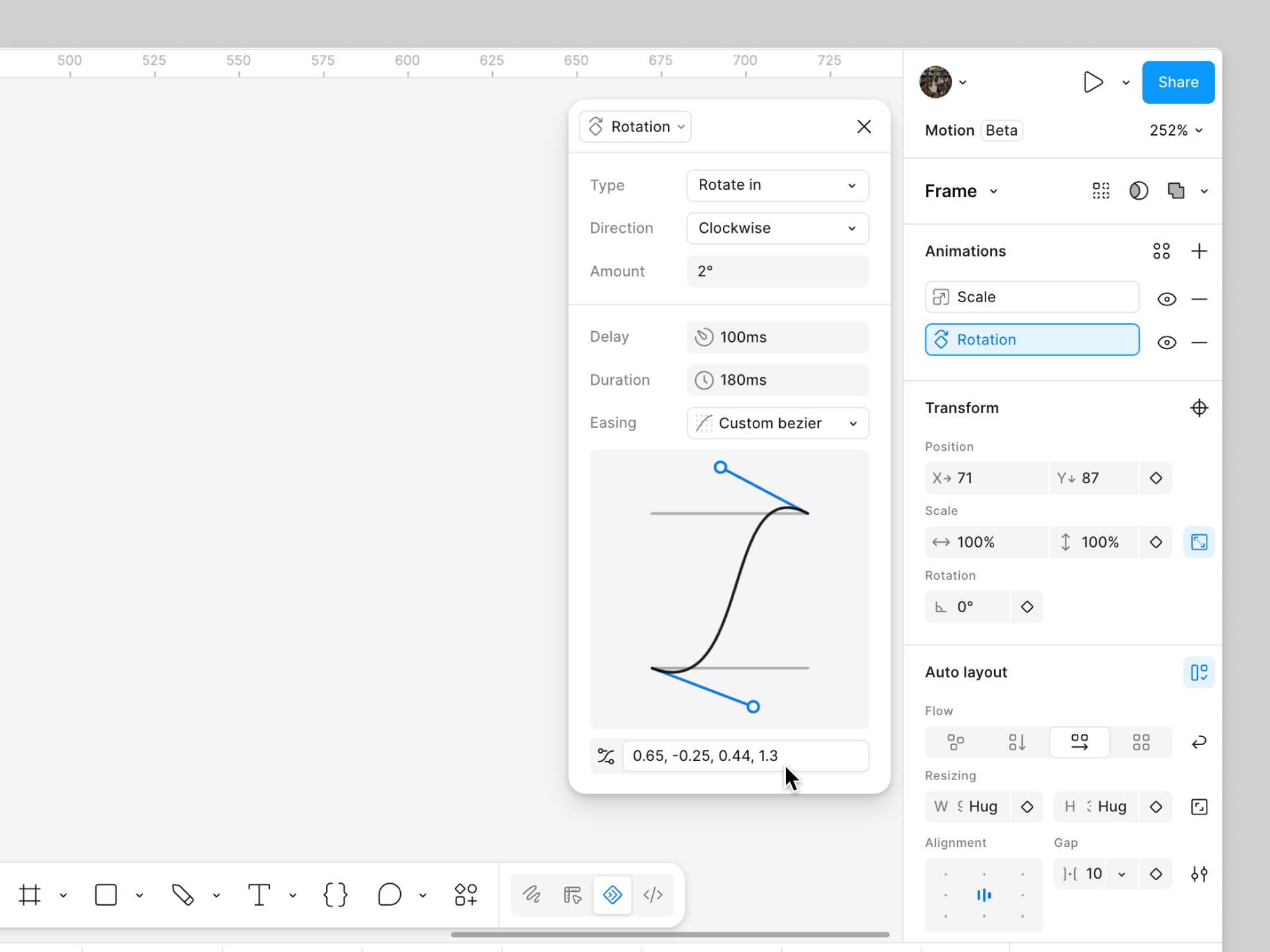

Add a rotation animation
Next, we’ll add a rotation animation to give the chat bubble a slight wiggle as it scales in.
- Select the
- Select Rotation from the dropdown menu, then configure the following settings:
Type:
Rotate in -
Direction:
Clockwise -
Amount:
2° -
Delay:
100ms -
Duration:
180ms
Type:
0.65, -0.25, 0.44, 1.3in the Bezier field to configure the custom curve.
Play your animation
Nice job! To play your animation, click Play or press Spacebar.

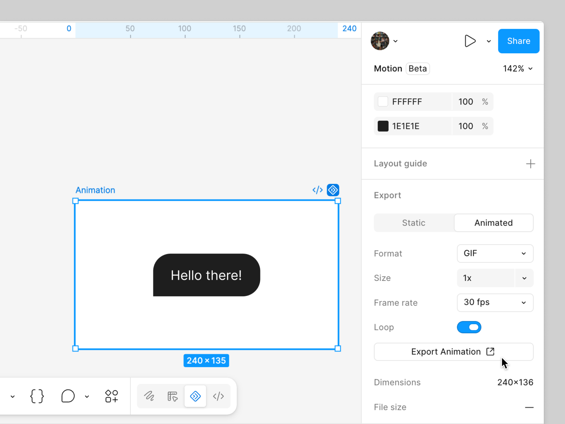

Export your animation
The animated chat bubble looks great! You can export your animation to share with others or to save a copy outside of Figma.
- Select the
Animationframe. - In the Export section of the right sidebar, switch the tab to Animated.
- Use the settings to configure your export.
Note: If you don’t see the Animated tab in the Export section, make sure you’re selecting the top-level Animation frame. Only top-level frames can be exported as animations.
