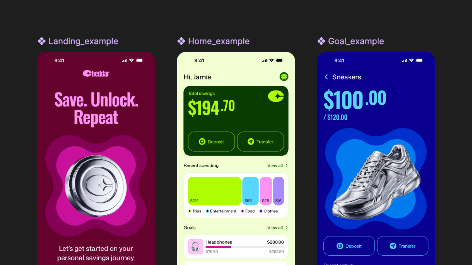

The examples in the image above show savings goals for headphones and sneakers. A guidelines file can explain the audience behind those choices, helping the agent create other goals that feel equally relevant. For examples:
When creating placeholder savings goals, choose purchases and experiences that make sense for a Gen Z audience just starting their savings journey, such as headphones, sneakers, or concert tickets. Use modest, achievable target amounts. Avoid defaulting to major financial milestones like a house deposit or retirement, which don’t reflect the everyday saving this product is designed to encourage.
