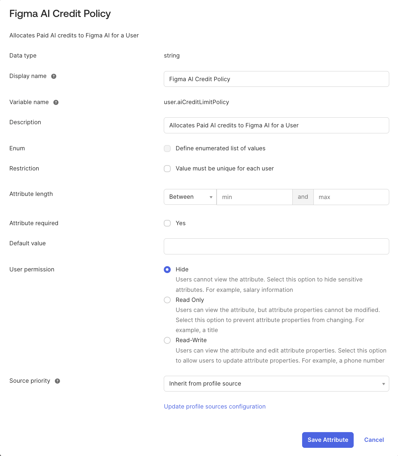

2. Add the source attribute to the Okta user profile
Next, you need to create a field on the Okta user profile to store each person’s paid AI credit policy.
- In the Okta Admin Console, open Directory → Profile Editor.
- Filter the profiles to Okta.
- Open User (default), or the Okta user profile used by the people you want to manage.
- Select Add Attribute.
- Configure the attribute using the following settings.
| Setting | Value |
| Data type | String |
| Display name | Figma AI Credit Policy |
| Variable name | user.aiCreditLimitPolicy |
| Description | Stores the paid AI credit limit to provision to Figma |
| Required and unique | Leave both unchecked |
| User permission | Read-only or hidden from end users, if available |
- Select Save.
If aiCreditLimitPolicy already exists, confirm its settings instead of creating a duplicate.

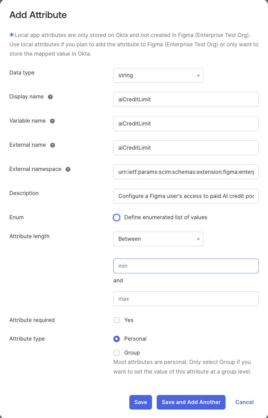

3. Add the attribute to the Figma application profile
Next, create the application attribute that Okta sends to Figma.
In Okta:
- In Directory → Profile Editor, open your Figma application’s profile.
| Setting | Value |
| Display name | aiCreditLimit |
| Variable name | aiCreditLimit |
| External name | aiCreditLimit |
| External namespace | urn:ietf:params:scim:schemas:extension:figma:enterprise:2.0:User |
| Attribute type | Personal |
| Required and Enum | Leave unchecked. Do not add a length restriction unless your policy requires one. |
- Select Save.
Use the complete external namespace shown in the table.

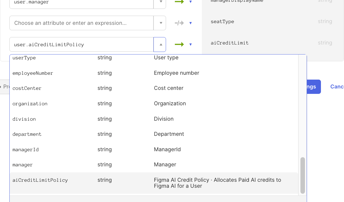

4. Map the attributes and enable updates
Next, you need to map the Okta source attribute to the Figma application attribute.
In Okta:
- In the Figma application’s Profile Editor, open Mappings.
- Select Okta User to Figma.
- Find the destination attribute
aiCreditLimit. - Enter
user.aiCreditLimitPolicyas its source. - Open the mapping arrow menu and set the mapping to apply on user creation and updates.
- Preview the mapping with your test user.
- Select Save Mappings.
In Applications → your Figma application → Provisioning → To App, confirm that Update User Attributes is enabled.

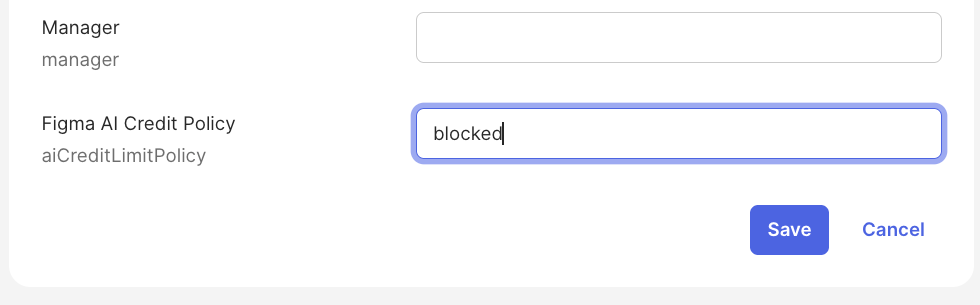

Set a test value in Okta
- Open Directory → People.
- Select your test user.
- Open Profile → Edit.
- Find Figma AI Credit Policy.
- Enter
blocked, without quotation marks. - Select Save.
- Confirm the saved profile shows
blocked.
Confirm that provisioning completes without an error. If an update fails, check the application’s provisioning tasks or the Okta System Log.

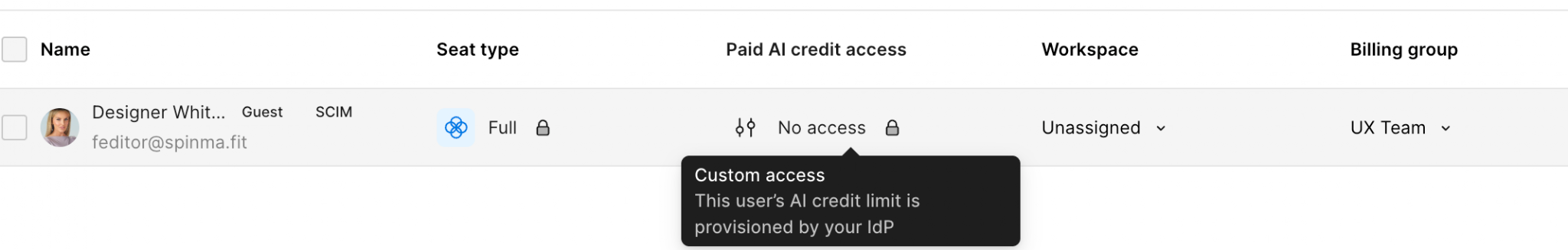

Verify the result in Figma
- From the file browser, select Admin.
- Select the People tab.
- Find the test user by email.
- Check the Paid AI credit access column. The user should show No access with a lock.
- Hover over the access value or lock. The message should read: “This user’s AI credit limit is provisioned by your IdP.”
Confirm that the person’s seat, workspace, billing group, and other managed attributes still match their expected configuration.
Blocking paid-credit use doesn’t remove the credits included with the person’s seat.
