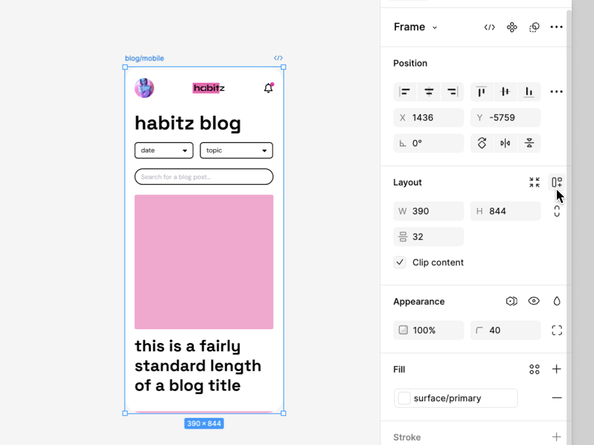

- Use the keyboard shortcut ⇧ Shift A
- In the right panel, click next to Auto layout
- Right-click on a frame or object and select Add auto layout

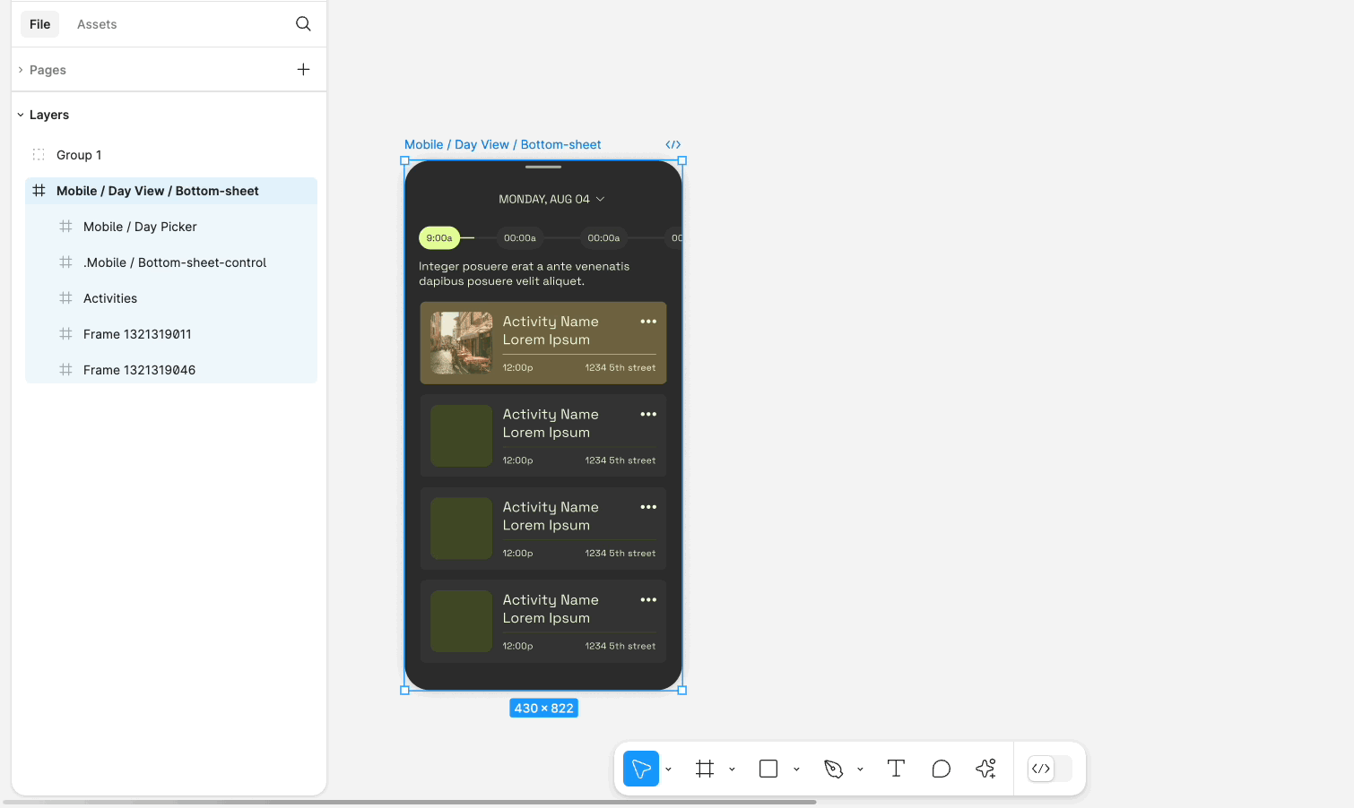

Suggest auto layout
Suggest auto layout lets you turn a design responsive with just a click of a button.
When you use Suggest auto layout, Figma will try to determine which objects in a frame or component should be placed in an auto layout frame, then adds as many auto layout frames as needed to make the full design responsive. These auto layout frames are created all at once, while attempting to preserve the placement of your designs.
This saves you time so that you don’t have to do the tedious work of adding auto layout frame-by-frame.
Note: Suggest auto layout can handle moderately-complex designs, such as cards, navigation bars, or mobile screens. If you’re working with a large or complex design, such as website, use suggest auto layout in batches.
You can access this option from a few places:
- Use the keyboard shortcut:
- Mac: ⌃ Control ⇧ Shift A
- Windows ⌃ Control Alt ⇧ Shift A
- Right-click the frame or object and go to More layout options > Suggest auto layout
- Select Suggest auto layout from the Actions menu
After you use this action, any nested auto layout frames that were created are indicated with a blue dot in the layers section in the left panel.
Note: Occasionally, you may find an object in a different auto layout frame than you intended; or with a horizontal direction applied when you wanted vertical. Suggest auto layout might not get it right every time, but it is intended to speed up your workflow.
For elements that may be a bit trickier, we recommend framing, grouping, or using auto layout on nested elements before using Suggest auto layout on the parent frame.

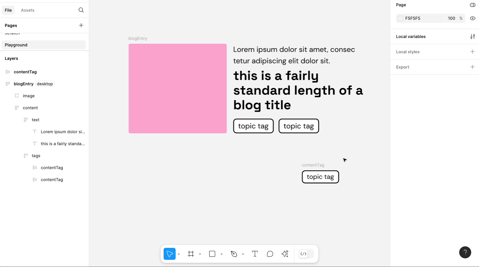

Nest auto layout frames
You can nest an auto layout frame within another auto layout frame. This allows you to combine horizontal and vertical layouts to create complex interfaces.
When you nest an auto layout frame, the nested frame will have both parent and child properties.
In our example below, there are four levels of auto layout:
- Button: Each button is a horizontal auto layout. This allows the button to grow and shrink as we change the label text.
- Button Row: We then add both buttons to another horizontal auto layout. This allows objects to respond when we make any changes to a sibling's contents.
- Post: We then add our buttons to a vertical auto layout with the other objects in the post. This includes a description, an image and the user's profile.
- Timeline: We've added three to a vertical auto layout to create our timeline. The auto layout frame is the top-level frame which sits on the canvas.
