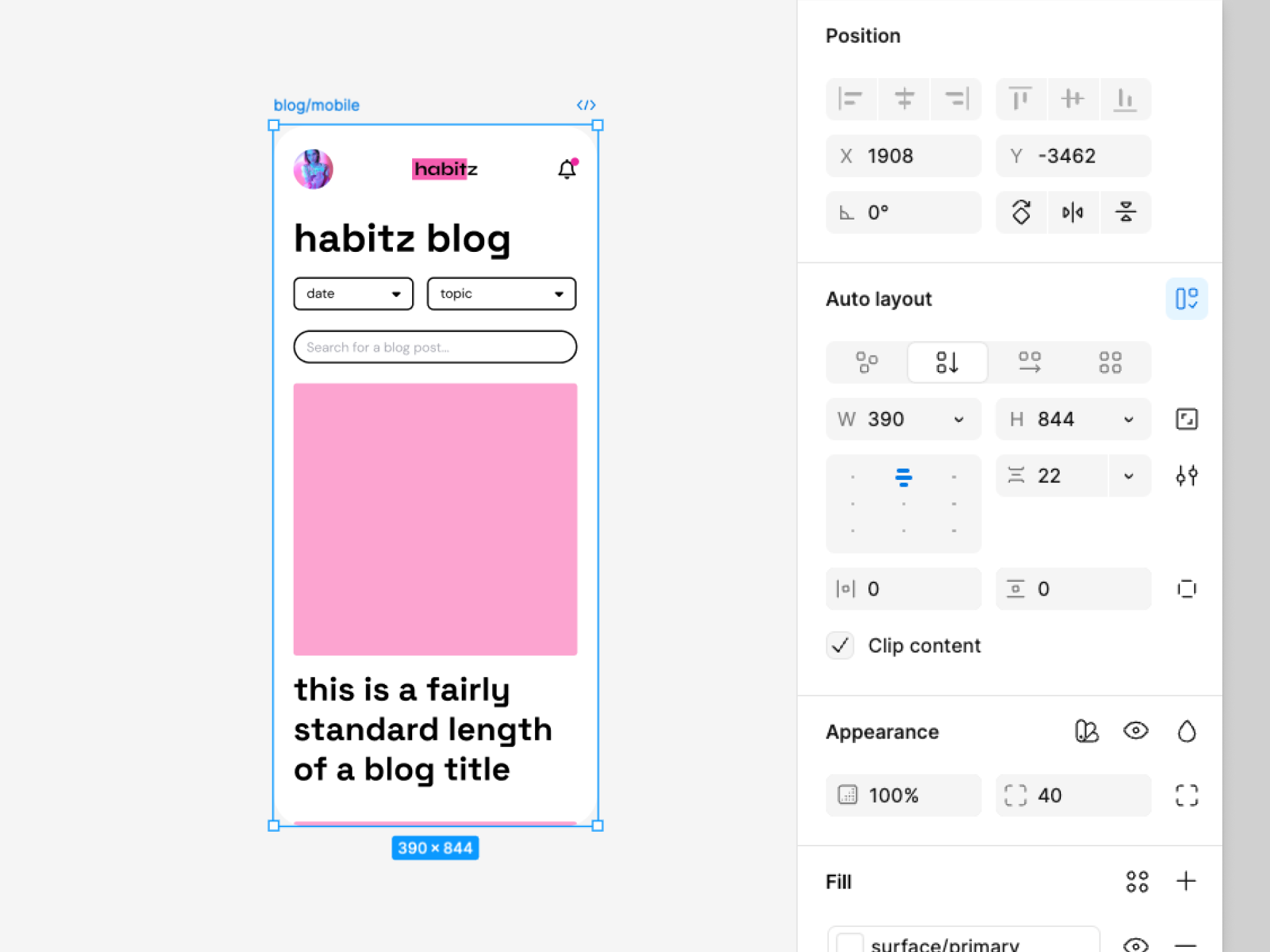

To use auto layout, select one or more layers and use one of the following methods:
- Use the keyboard shortcut ⇧ Shift A
- In the right panel, click next to Auto layout
- Right-click on a frame or object and select Add auto layout
If you have a frame or a main component selected, you can also choose from one of the auto layout flows in the Layout section of the right sidebar:
- Vertical
- Horizontal
- Grid
Note: Auto layout is only supported on frames. If you have a one or more layers selected, Figma will create an auto layout frame around them.
