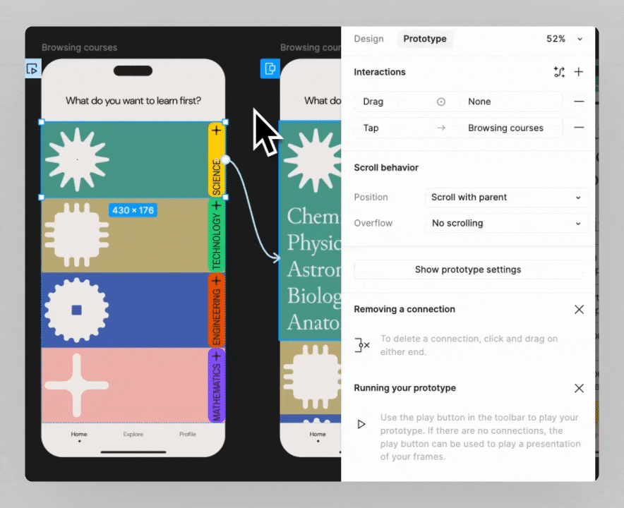

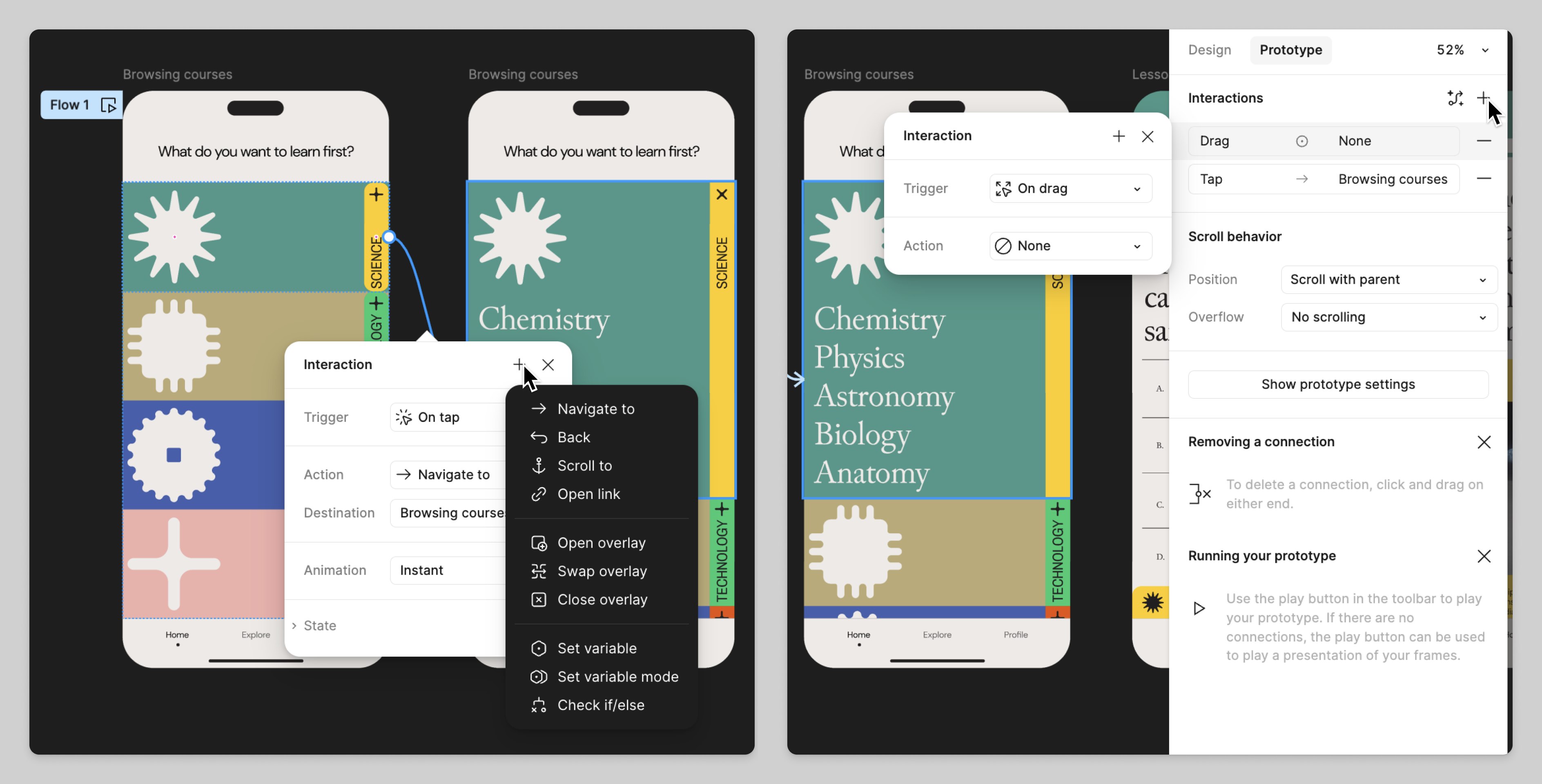

- Create a prototype interaction.
- To add an additional action, click Add action.
- From the Interaction panel, select any action from the Action dropdown menu.

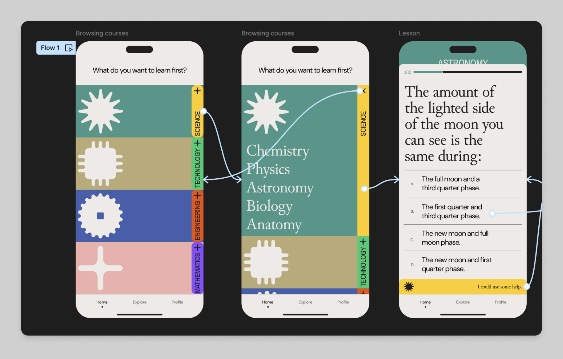

Prototype animations can be used to create smooth transitions between pages and define the behavior for actions like Navigate to, Scroll to, Open overlay, and more.
If you have multiple animations on a trigger, they run sequentially.

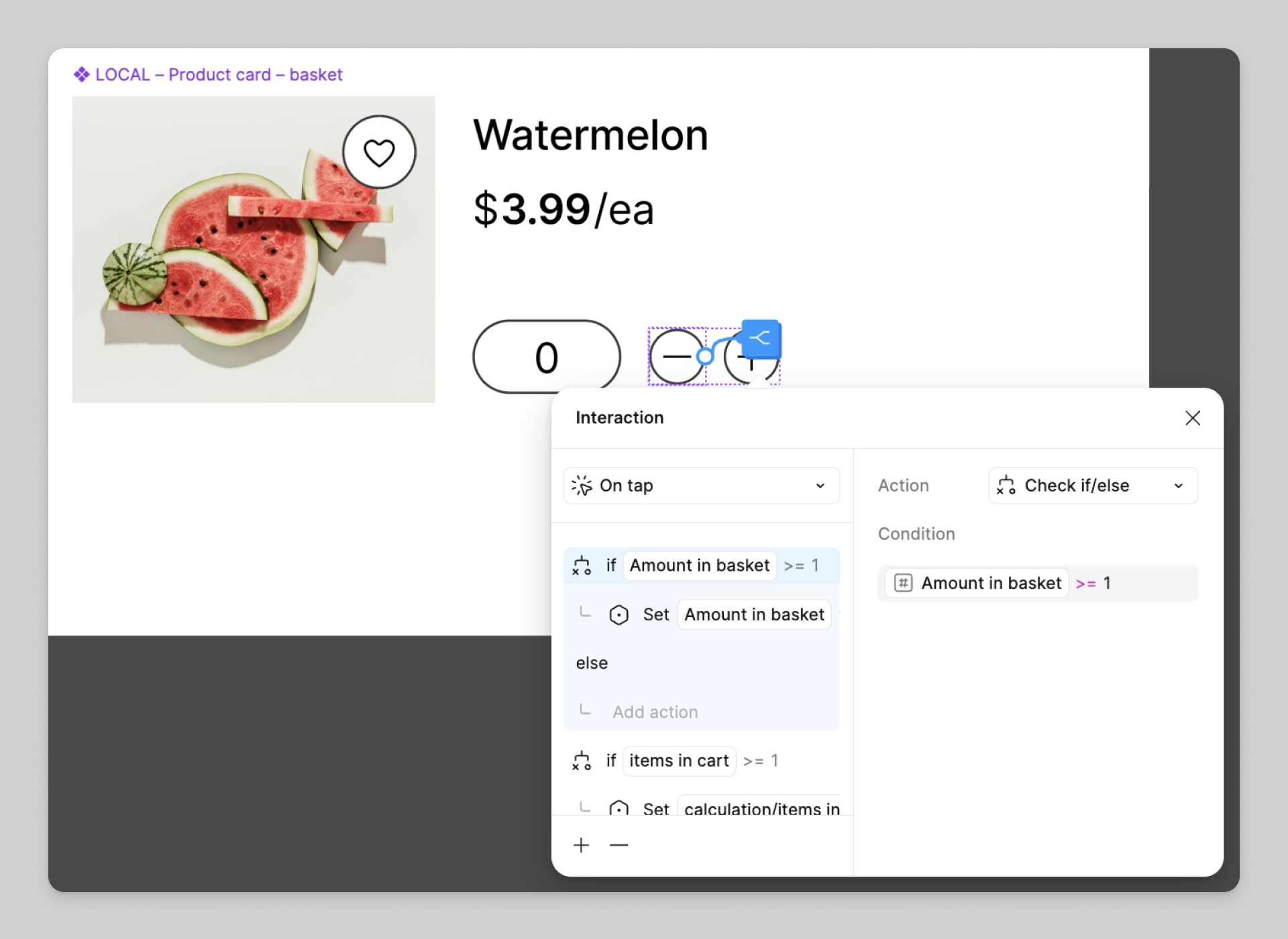

- From the Interaction panel, select any trigger from the dropdown menu.
- From the Actions dropdown menu, select Conditional.
- Complete the If condition:
- In the If field, write a boolean expression to represent the condition that must be met.
- Select an action (or multiple actions) from the dropdown menu. These actions will be triggered if the If statement is met.
- Complete the Else condition:
- Select an action (or multiple actions) from the dropdown menu. These actions will be triggered if the If statement is not met. Alternatively, leave the Else action blank.
Only conditionals written with supported operations and format will work. Invalid conditional statements will be outlined in red.
