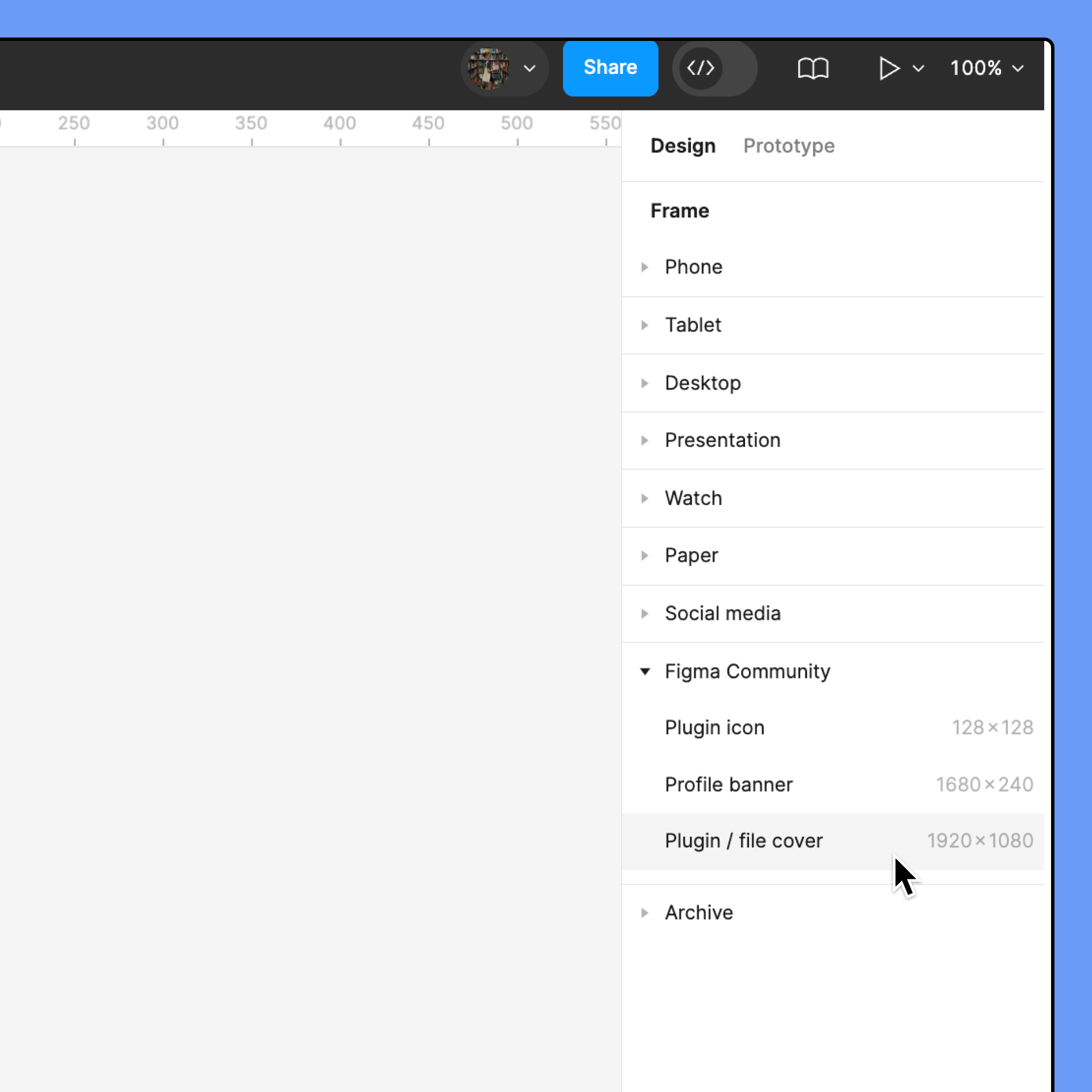

The first thing we need to do is create the frame we’ll use for our thumbnail. 1920x1080 pixels is the recommended size for file thumbnails. Instead of manually resizing a frame, we can use the frame preset to automatically add a frame of the correct size.
- Select the Frame tool in the toolbar or press F.
- In the right sidebar, select Plugin / file cover under Figma Community. A new frame is automatically added to the canvas.
- Select the frame you just added.

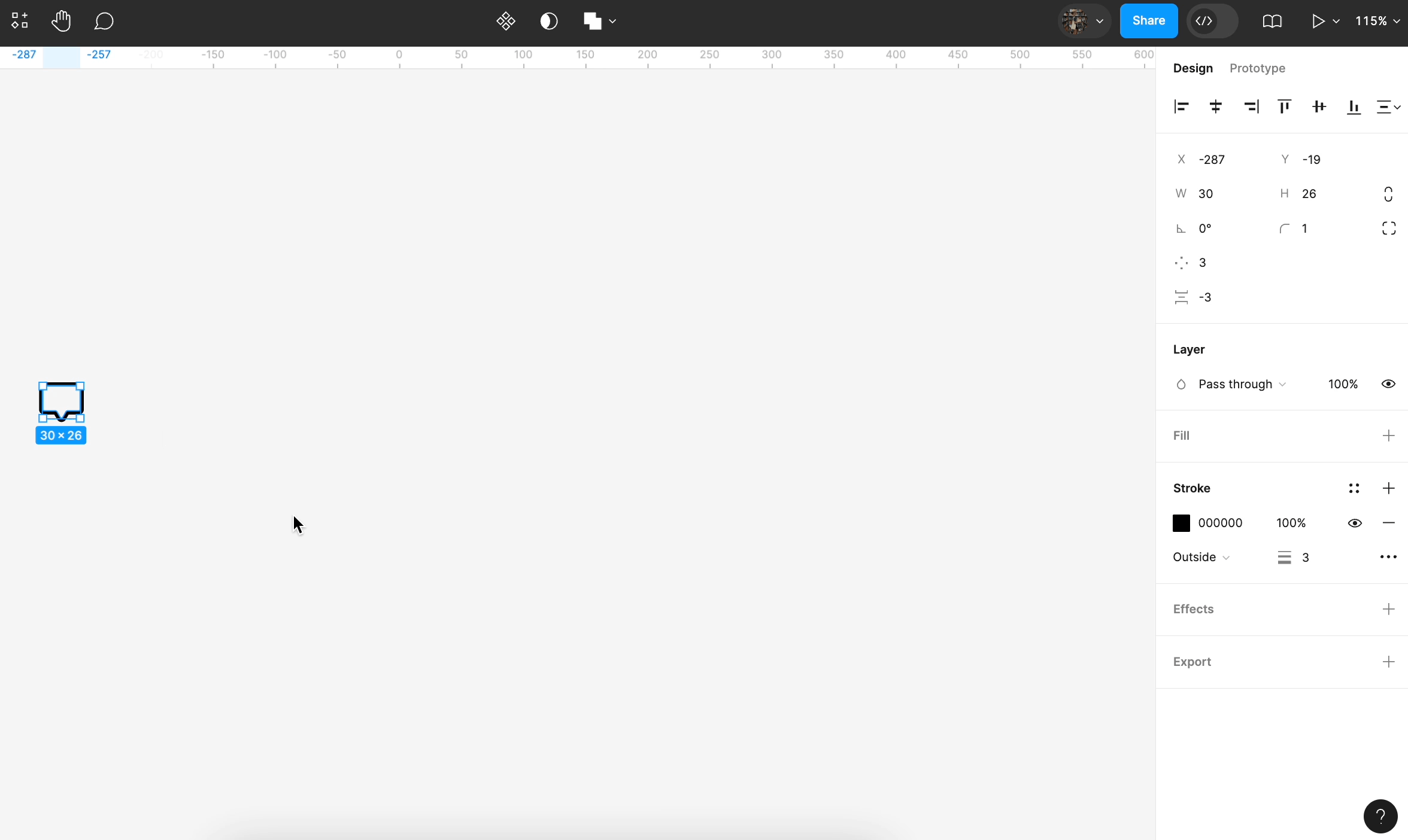

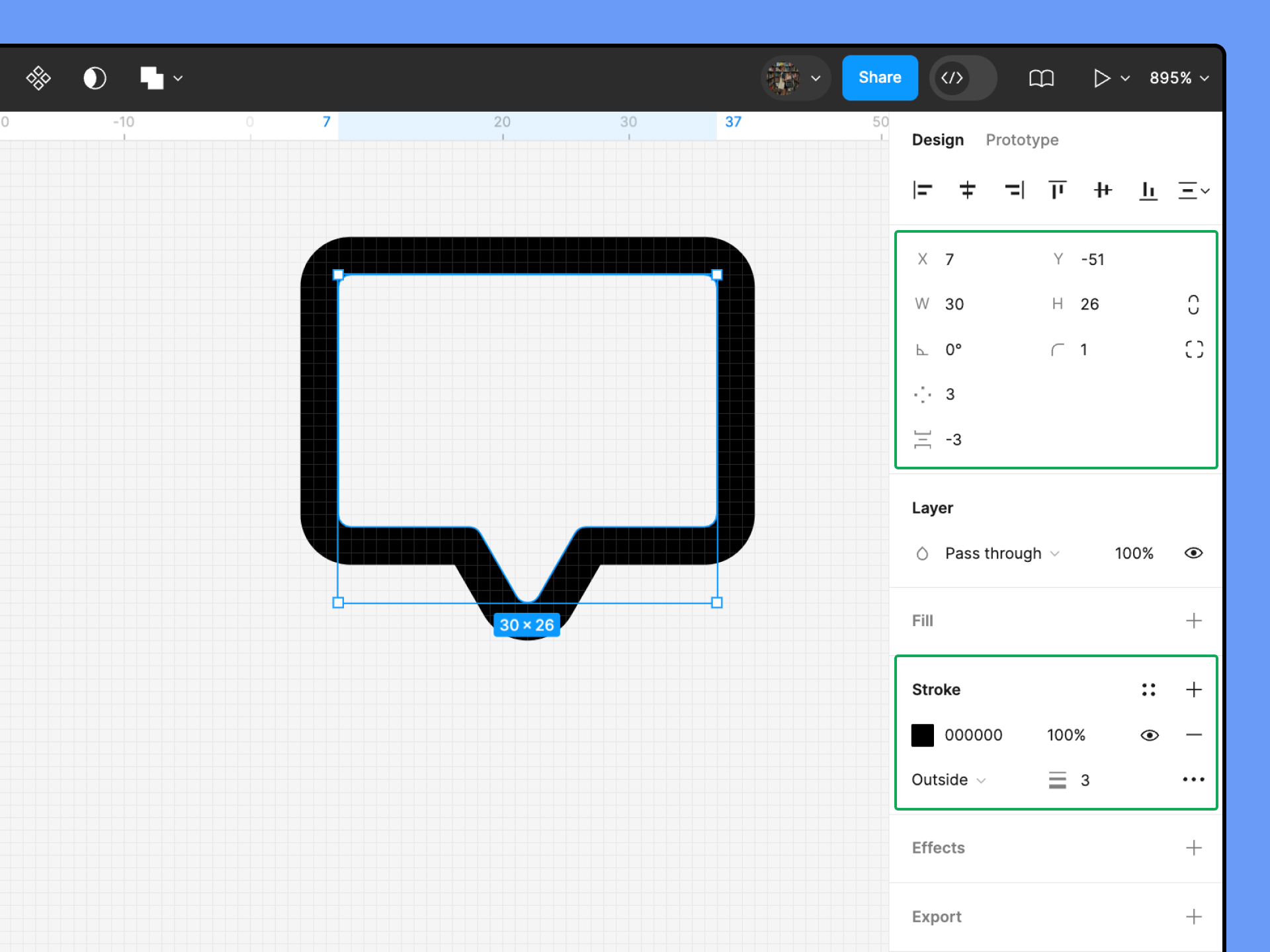

- Click the plus in the Stroke section to add a stroke.
- Select Outside from the dropdown menu and change the stroke’s width to
3
. - Click the minus in the Fill section to remove the fill.
- Change the corner radius to
1
Before moving on, check to make sure your icon looks similar to the following:

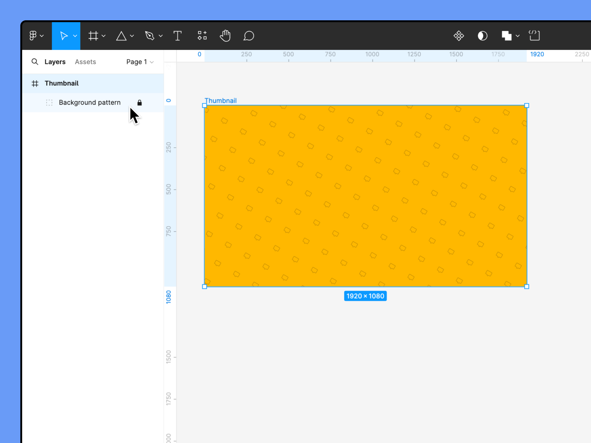

- Select the Background pattern layer.
- In the Stroke section, change the stroke transparency to
20%
. - With the group still selected, change the Rotation to
-30%
using the setting in the right sidebar. - Drag the pattern into your thumbnail frame. Check the right sidebar to make sure it’s nested under the Thumbnail frame.
- Click Lock to lock the layer.
Before moving on, check to make sure your Thumbnail frame looks similar to the following:

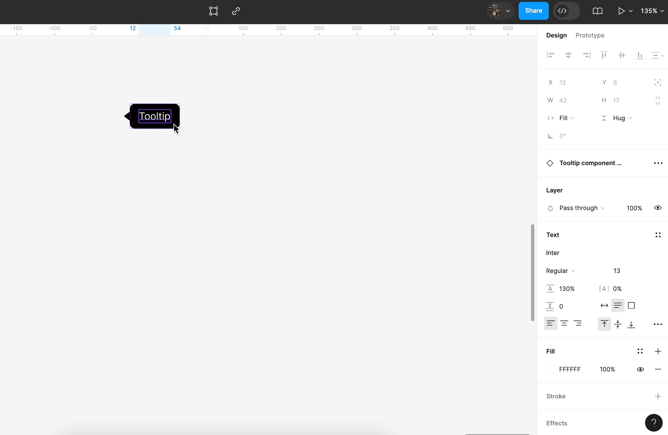

We’ll use an instance of the tooltip component for our main heading.
- In the Assets panel in the left sidebar, locate the tooltip component under Created in this file.
- Click and drag the component onto the canvas to create an instance.
- In the right sidebar, change the arrowDirection property value to bottom using the dropdown menu.
- Double-click on the tooltip’s text and enter
Web Tooltips
. - Select the text and change it to bold.

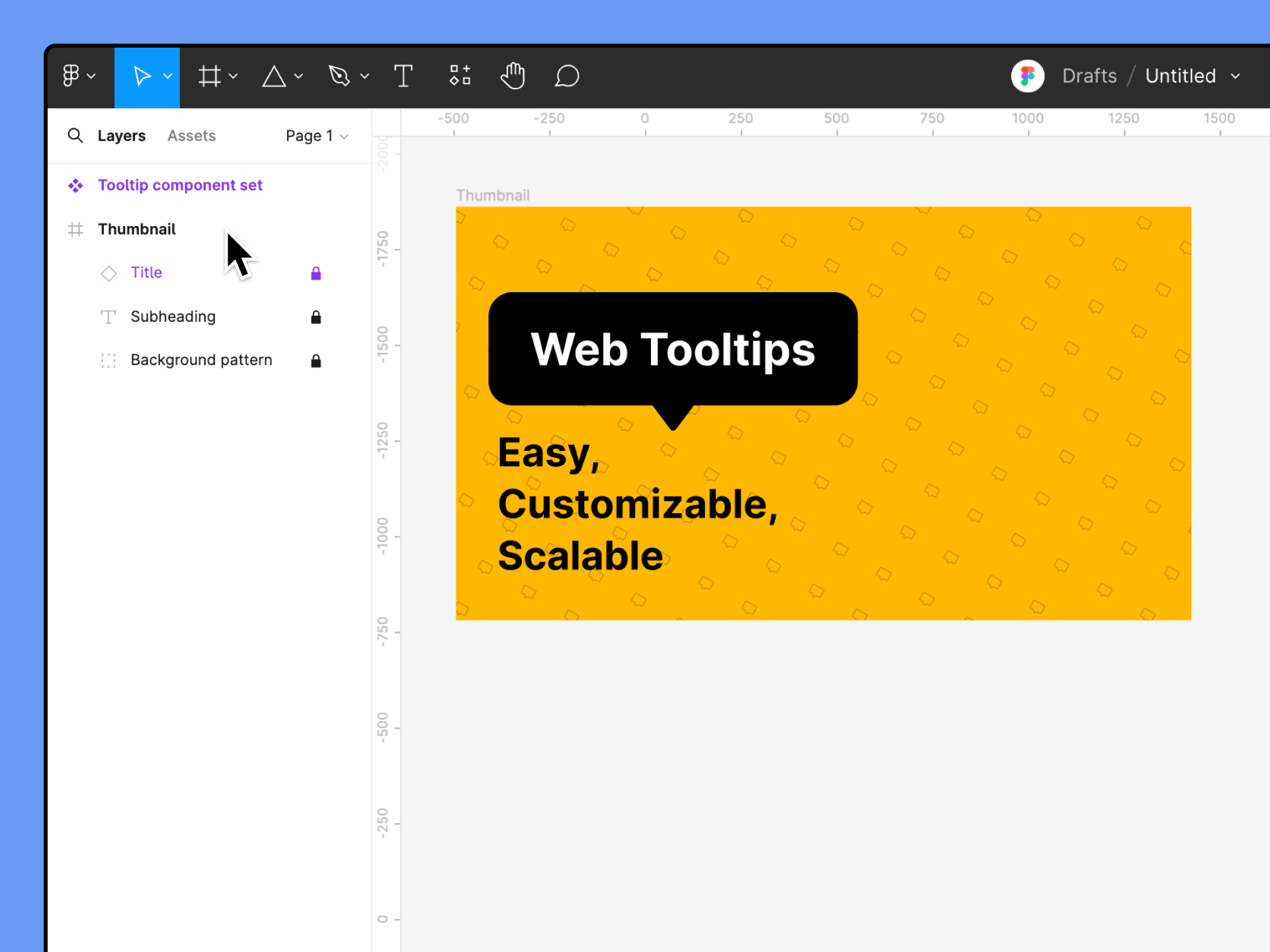

Now let’s add the subheading.
- Select the Text tool in the toolbar or press T.
- Type out
Easy, Customizable, Scalable
, pressing Enter after each comma to add a line break. We’re using the default Inter font for this project but feel free to choose something else. - In the Text section of the right sidebar, change the font size to
104
and make sure the text is bold. - Double-click on the layer name and change it to
Subheading
. - Click and drag the Subheading layer up into the Thumbnail frame below the Title layer and lock it.

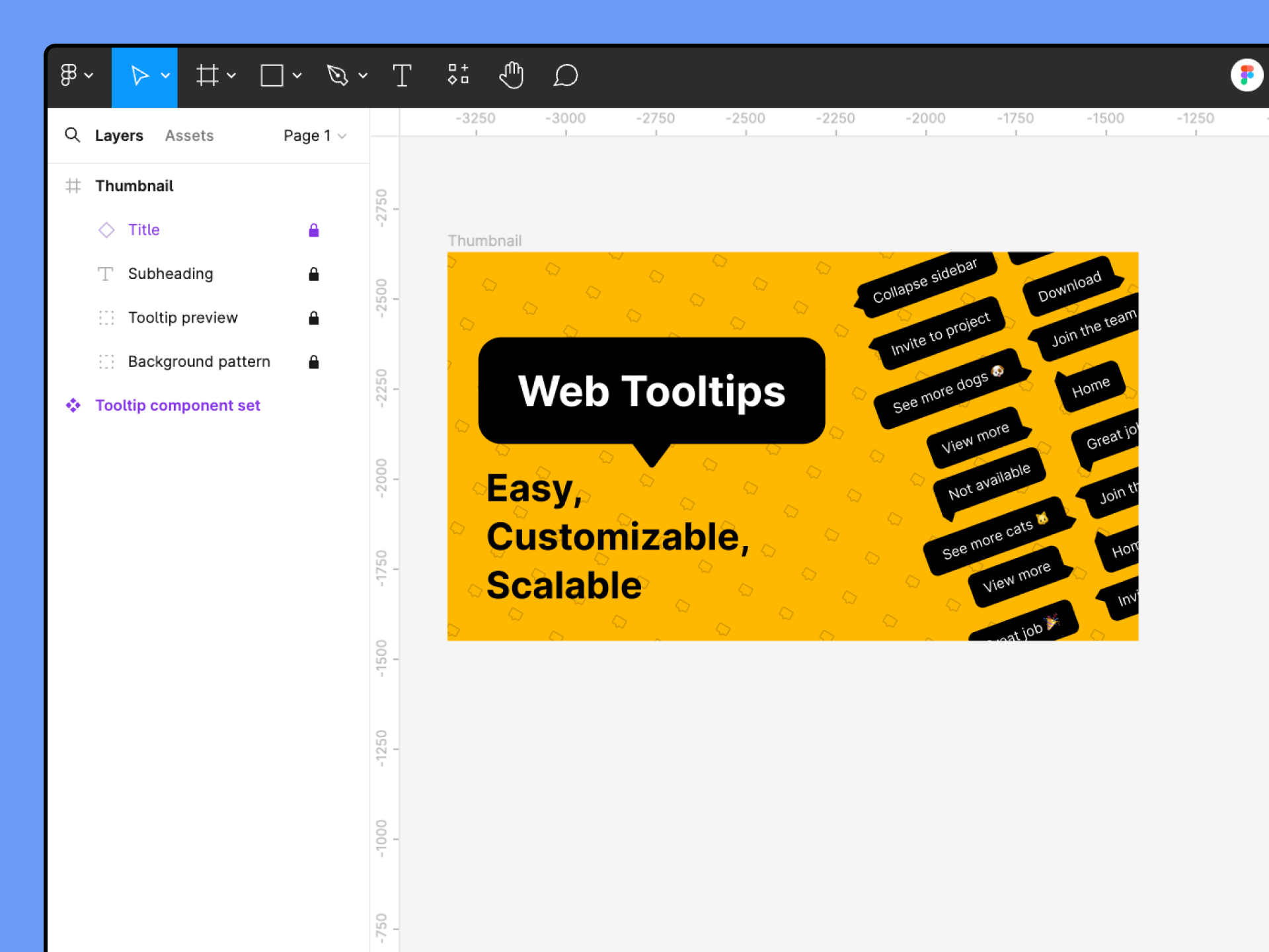

Before moving on, make sure your thumbnail looks similar to the following:

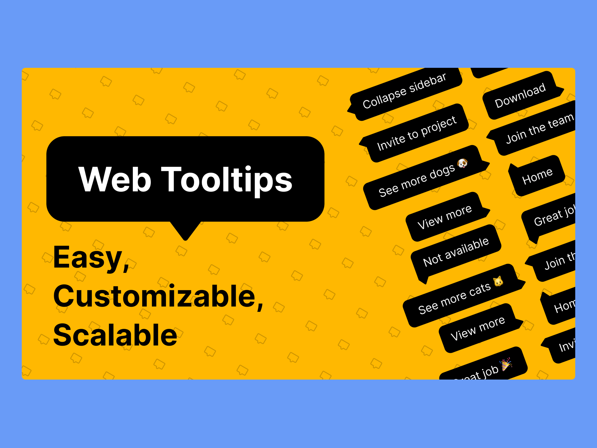

Add the preview elements
Our thumbnail is almost done. But the right side of the frame is looking a little bare. We’ll use the tooltip component set again to add some visual interest and give people a preview of what the tooltips could be used for.
- From the Assets panel in the left sidebar, add another instance of the tooltip component to the canvas.
- We want to add some personality to the thumbnail. Here’s where you can get creative. Duplicate the instance a few times. Play around with the layout and use the variant properties in the right sidebar to change the direction of the arrows. Double-click on the text layer in each tooltip and change it to something different. Ours will be a mix of common tooltip copy with a few fun ones thrown in. Don’t worry too much about spacing but try to keep things relatively consistent.
- When you’re happy with your layout, select all of the tooltips and group them using the same keyboard shortcut we learned earlier.
- Select the tooltip again and press K to open the scale tool.
- Change the Scale to
9
. - Change the Rotation to
20%
. - Drag the group to the right side of the Thumbnail frame. Feel free to play around with the positioning until you’re happy with how it looks.
- Double-click on the group name and rename it to
Tooltip preview
. - Click Lock to lock the layer.
Your final thumbnail should look similar to the following:
