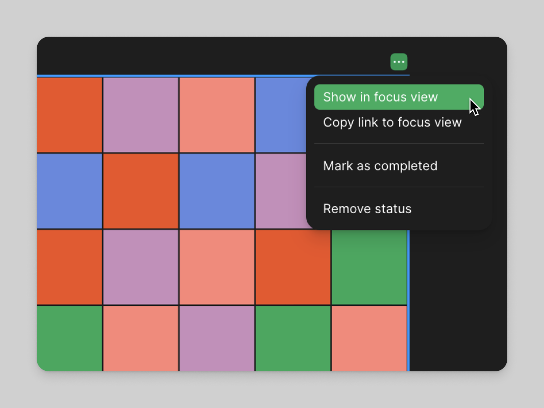

To access the focus view from Design mode:
- Open a Figma Design file.
- On the canvas, for the design you want to focus on, click the dev status and select Show in focus view.
- Optionally, click Copy link to focus view to get a link to the focused design that you can share with others.

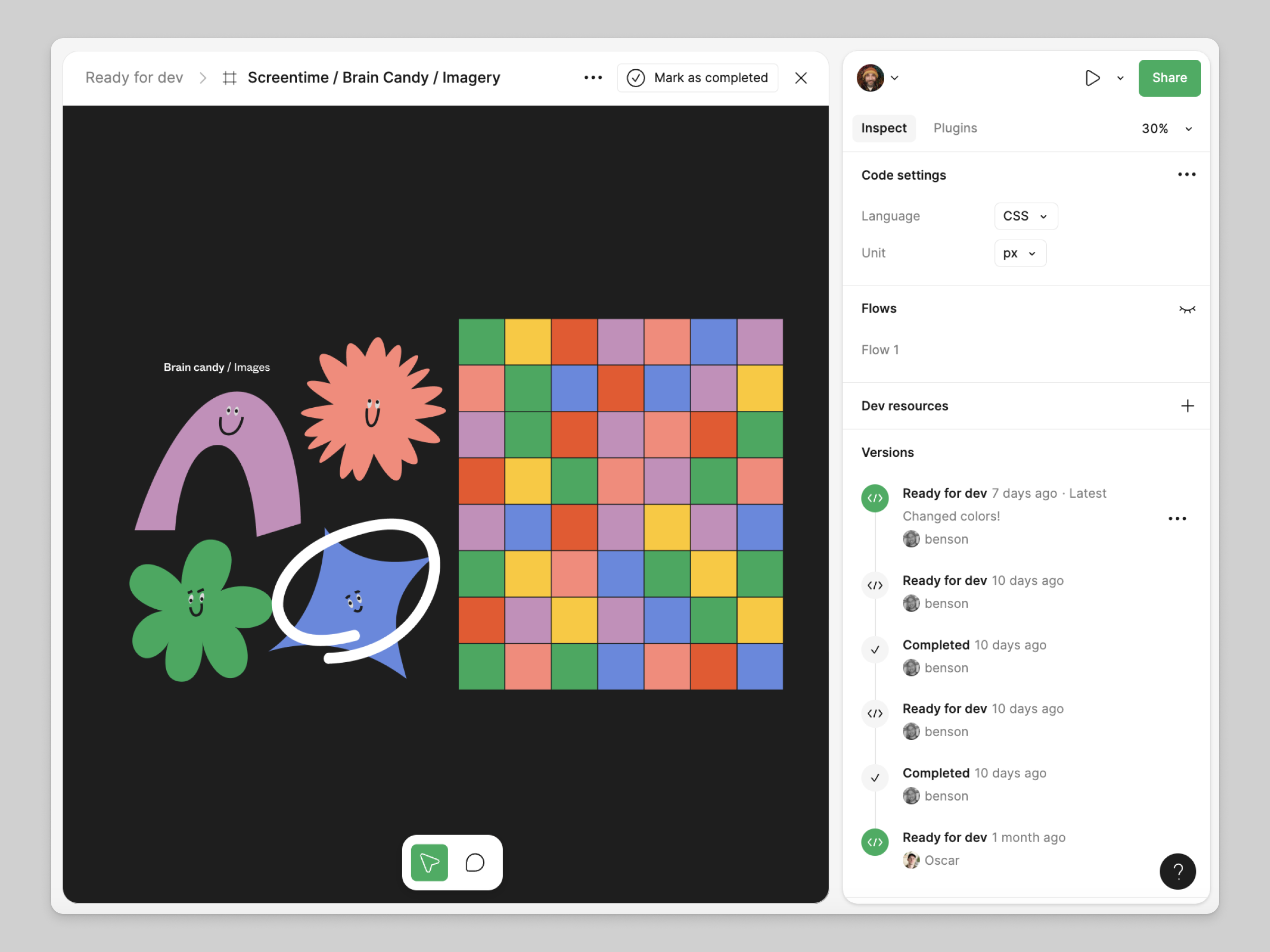

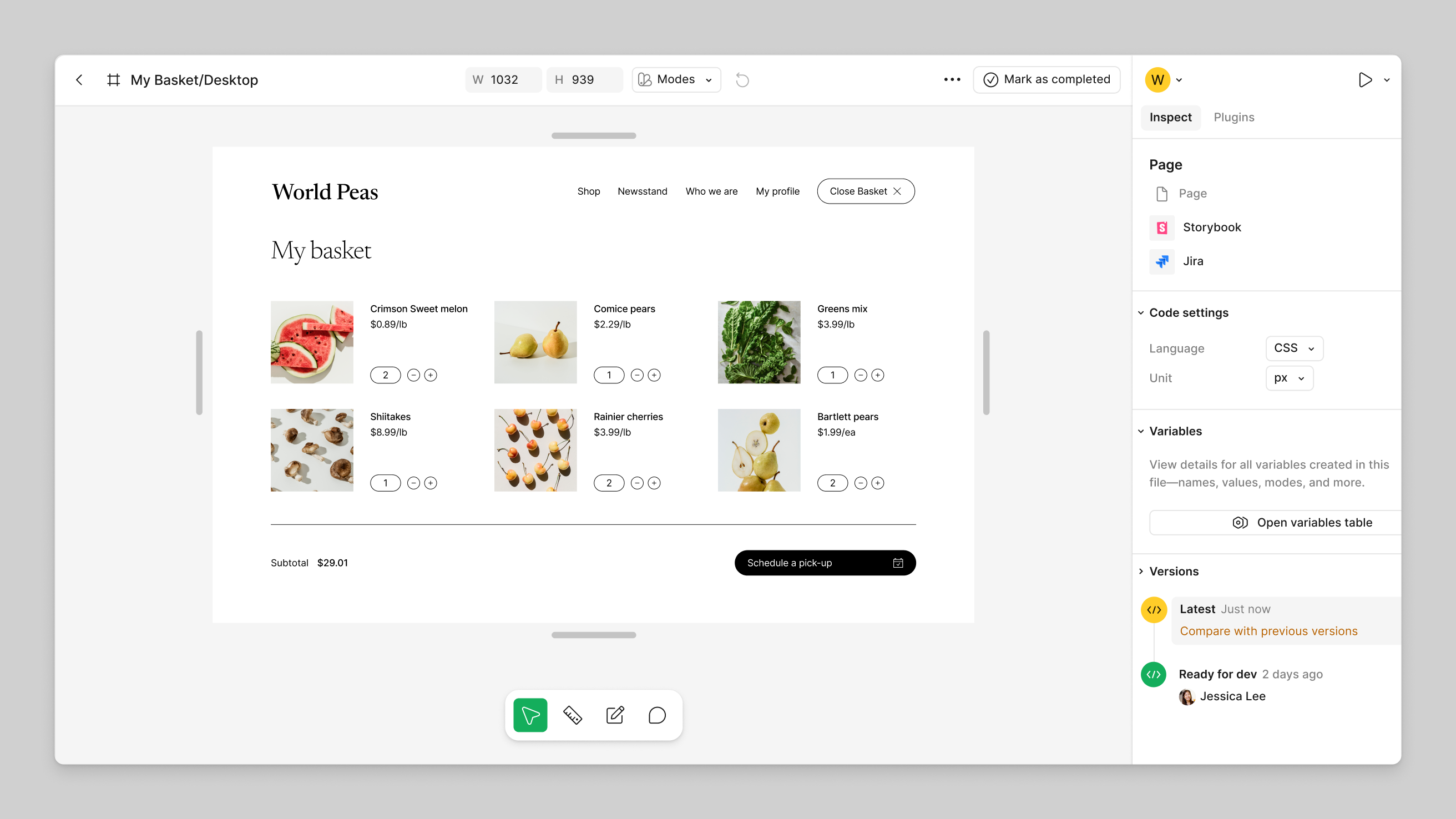

The focus view opens, displaying the following:
- The design you wanted to inspect appears in the center of the focus view. You can use your Dev Mode tools to do things like measure, annotate, and comment on the design.
- The Inspect and Plugins tabs, where you can do things like generate code, view the properties of the design, export or download various, and run plugins for Dev Mode.
- Interactive inspection controls that let you preview how a design responds to different variable modes and frame sizes without making any changes to the actual design or affecting what others see.
- The Mark as completed button, which you use to confirm that the dev work for the design is done.

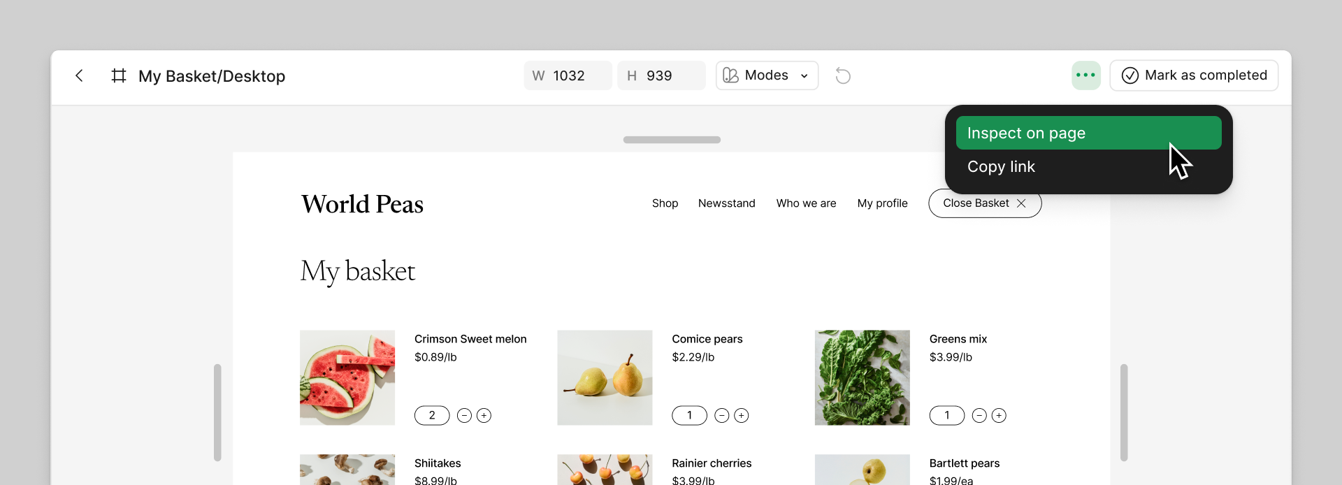

To go to the ready for dev view, in the upper-left corner of the focus view, click See all ready for dev.
To see the design in the context of the canvas, in the upper-right corner of the focus view, click and then select Inspect on page.
To return to the area of the Figma interface you were using before you entered the focus view, in the upper-right corner of the focus view, click . If you entered the focus view from the canvas, you’re returned to the position you were at on the canvas. If you entered from the ready for dev view or using a link, then you are returned to the ready for dev view.

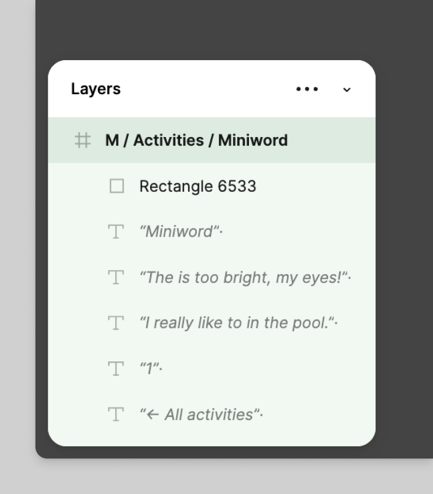

Explore layers
The focus view provides an easy way to explore the individual layers of a given design. The focus view’s layer panel appears when you select one or more parts of the design.

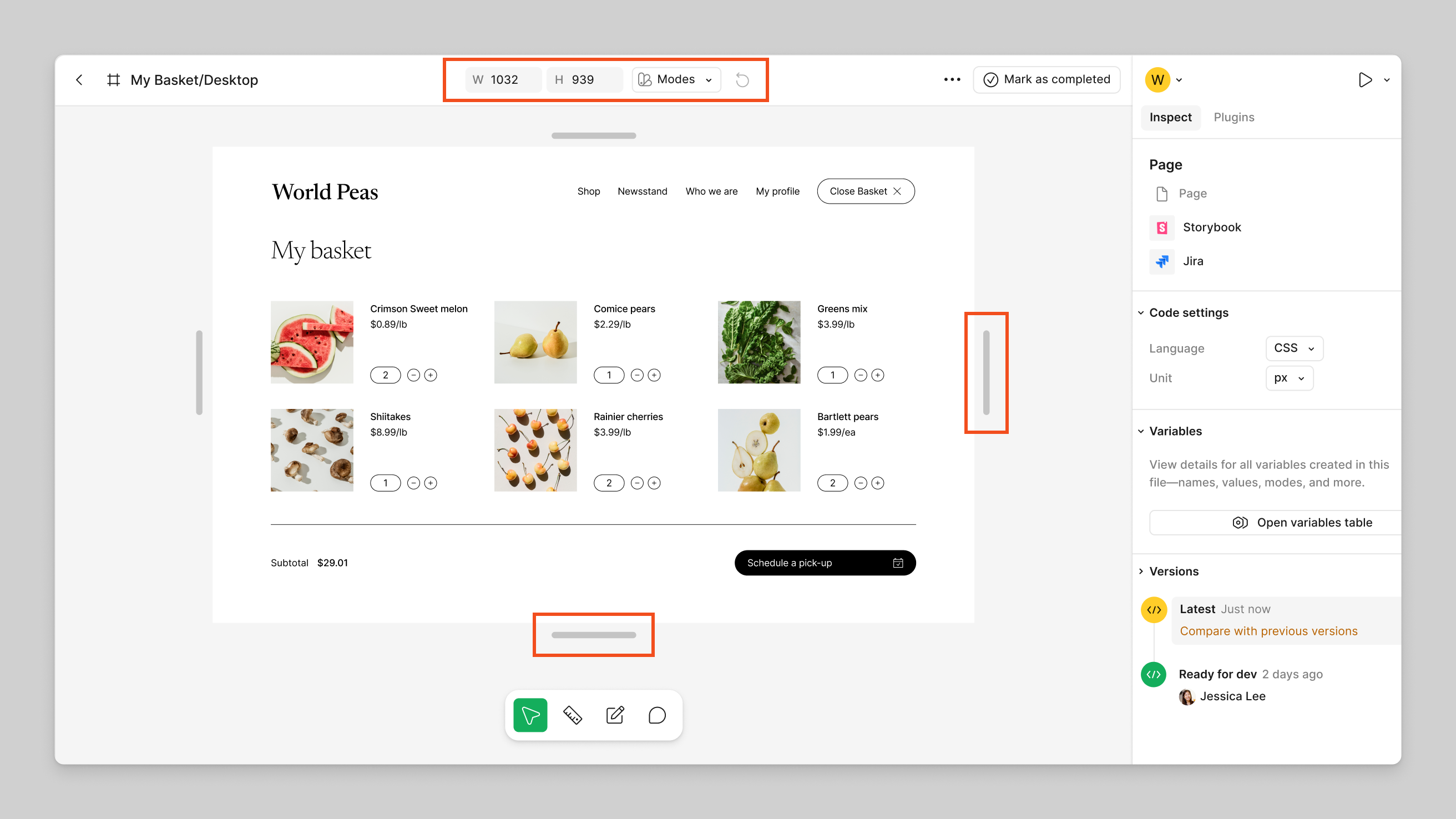

Focus view includes interactive inspection controls that let you temporarily explore how a design behaves in different scenarios. Use these controls to:
- Resize the top-level frame by typing specific values for width and height, or dragging the horizontal and vertical handles around the frame to adjust the size manually.
- Use the dropdown menu to preview the design in different variable modes (like light and dark themes).
Any changes you make with these controls are temporary and only visible to you. They’re helpful for previewing how a design responds to different conditions without affecting the file or what other collaborators see. Changes reset when you leave focus view or click the reset button.

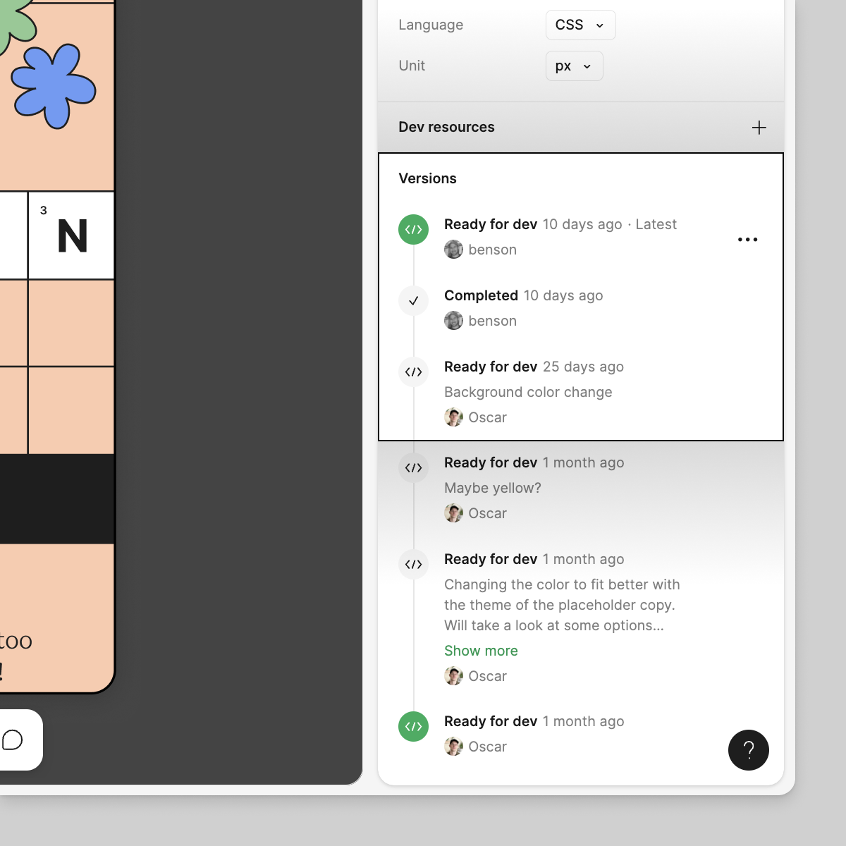

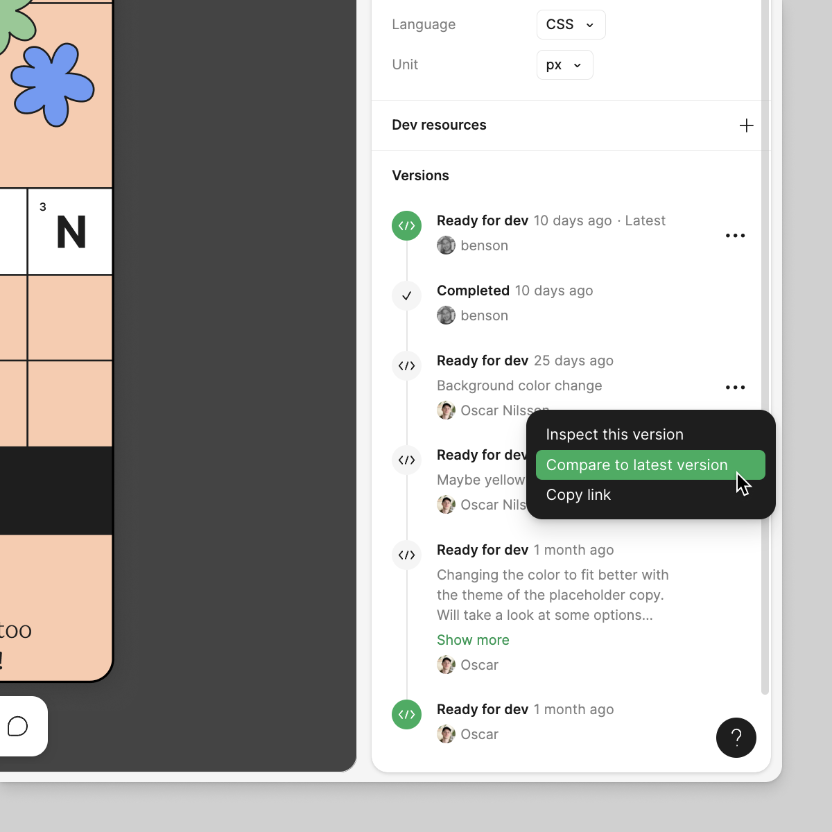

Version history
Similar to the version history that’s available for files, the focus view includes an annotated version history that tracks iterations of work on the design.
Normally, the file-wide version history shows you every version in a file, but often there can be a lot of activity and you care most about what’s changed in a specific frame or section that you’re reviewing and implementing. The version history in focus view shows you versions and works the same as the file-wide history, but is scoped to only versions that affect the specific design you have open in focus view.
As designers and developers iterate on a design, they update the status and add notes to describe the changes. Each time the status updates, an entry in the version history is added. You can also compare different versions in order to identify the changes between each iteration.
You can inspect older versions, copy a link to that particular version, or compare it to the latest version currently in your file. Learn more about comparing in Dev Mode →

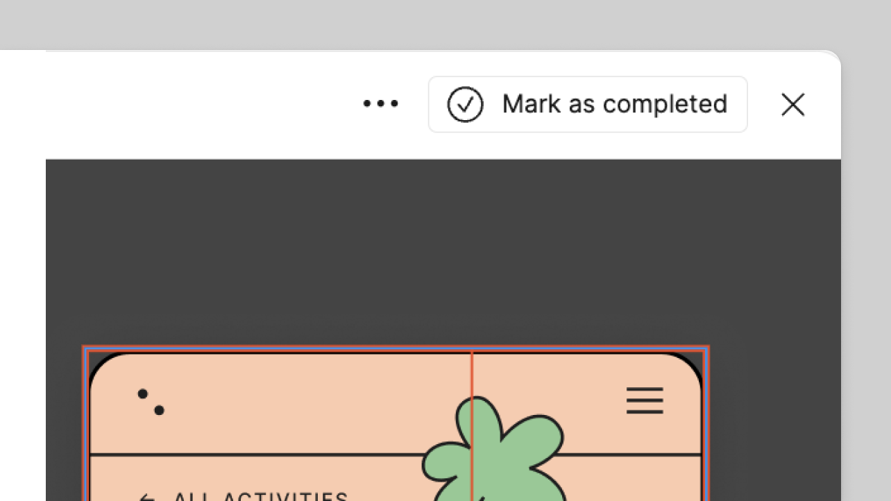

Mark as completed
To show the dev work for a design is done, use the Mark as completed button at the top of the focus view.
When a design is marked completed, a new entry is added to the version history, and the design remains available in the ready for dev view for later iterations.
