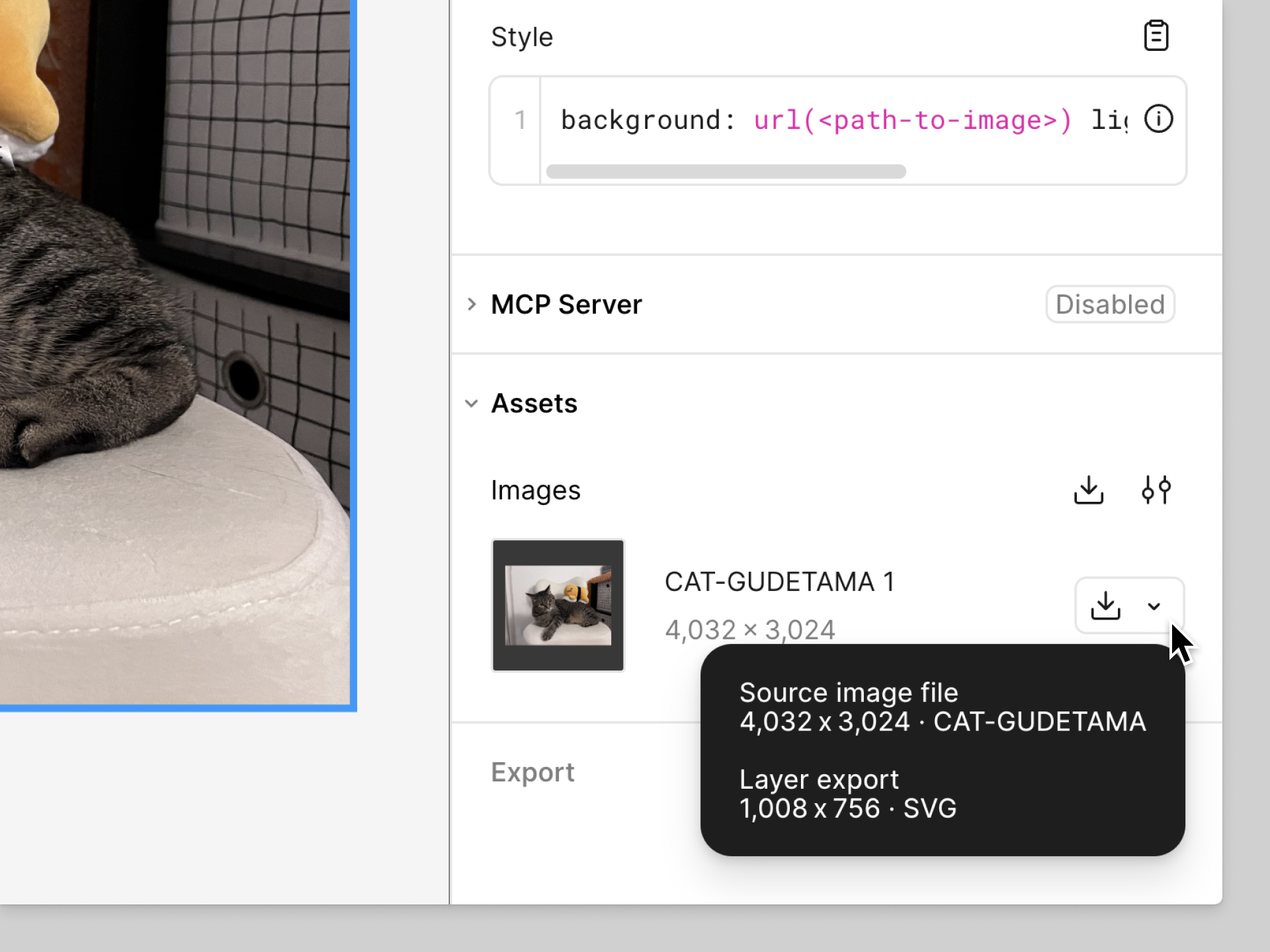

Specify size of image export
Download any selected image on the canvas, and choose between downloading the image at its current size on the canvas or the original image at full resolution.
- In Dev Mode, select the image you want to download.
- From the Assets section in the right sidebar, hover over the image you want to download and click the Export icon that appears.
- From the dropdown, choose from one of the options:
- Source image file: Download the original image that was used when the image was first imported into Figma.
- Layer export: Download the image at its current layer size.
Tip: If you’d like to do a layer export, you can choose which file format to export the image to. In the Assets section, click the Open image export settings icon, then use the dropdown to choose from PNG, JPEG, SVG, or PDF formats.
