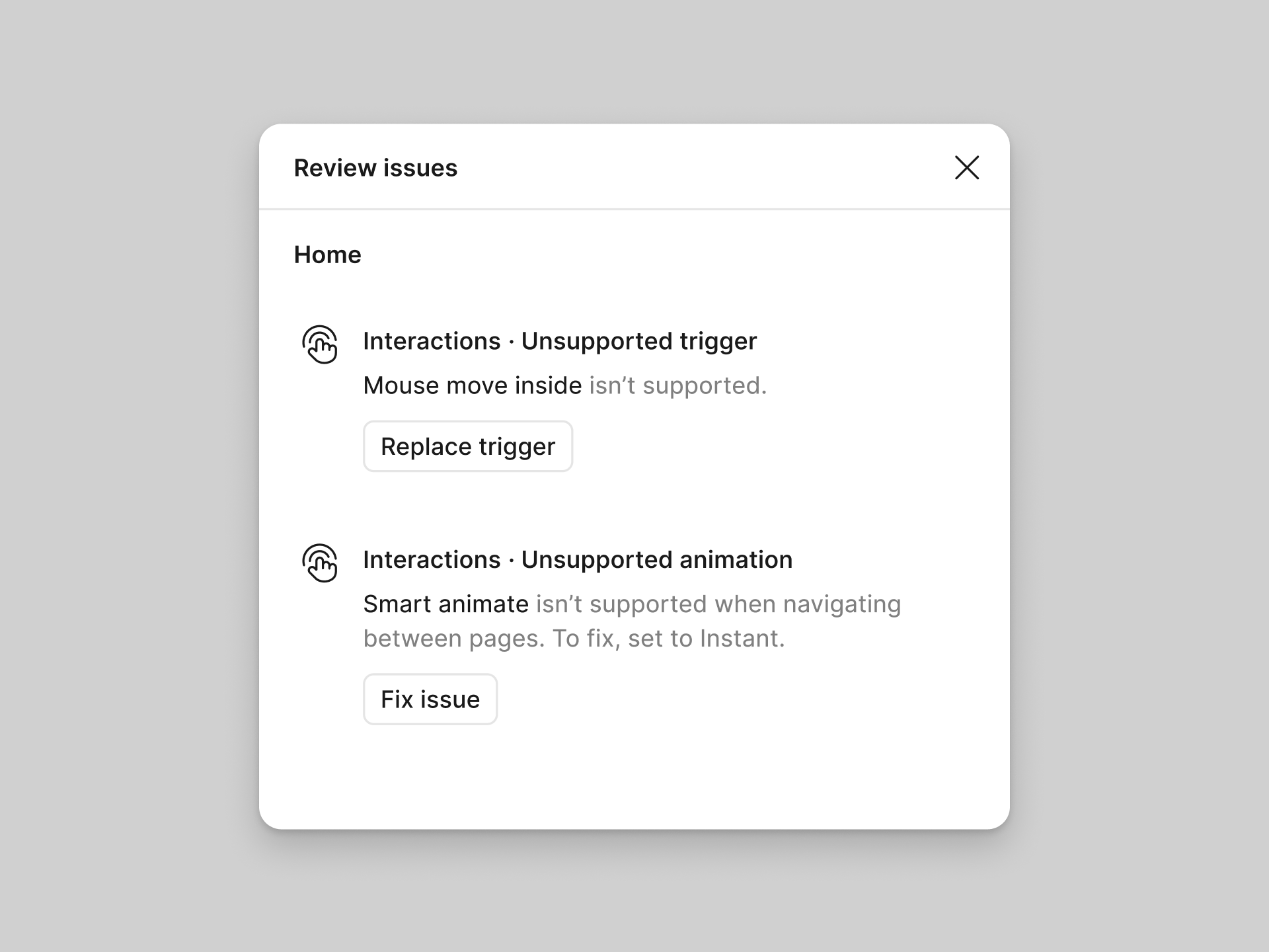

Check the Review issues modal
After copy and pasting into a Figma Sites file, check for any unsupported triggers or actions using the Review issues modal.
To access this modal, click Review issues at the bottom left corner of the file. You can also click Publish in the left sidebar, then click Issues.

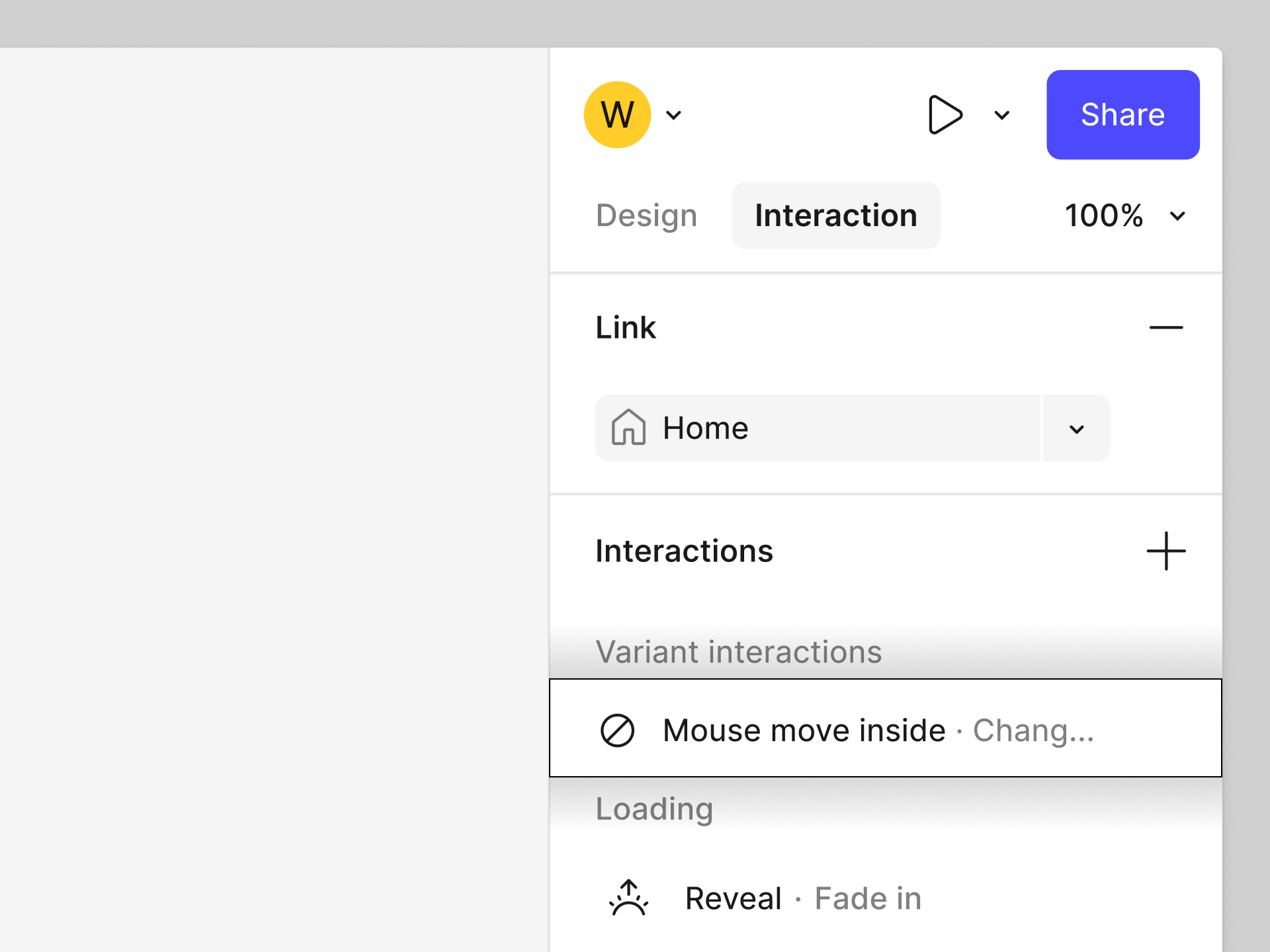

Update the interaction
In the Interaction tab of the right sidebar, unsupported interactions are represented by the icon.
Click the interaction and choose a different trigger or action to get it working again.
