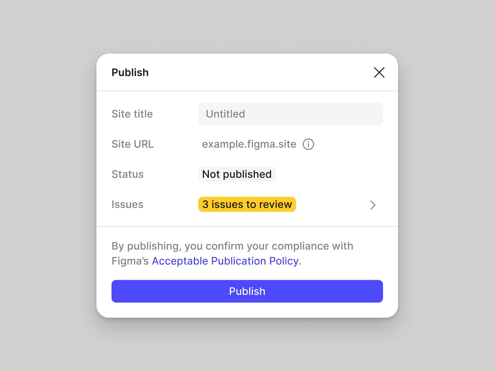

In the publishing window, review the details below before clicking Publish.
The site title appears in browser tabs, search engine results, and social media. Adding a title helps people understand what site they viewing, improves SEO, and improves accessibility.
Tip: We recommend reviewing and updating the site settings before publishing.

The default status is Not published. If the site is live, you’ll see Published instead.
Issues shows a list of technical issues that might prevent your site from working properly. Click the right arrow to explore flagged issues.
We recommend addressing all issues before publishing, but it’s not required.

Once you publish your site, the publishing window will display the following:
- The site’s domain, which is autogenerated by Figma. Click the domain to visit your published site. You can now switch to using a custom domain if you prefer.
- The status will change to Published.
- A new field will appear showing the last published date.

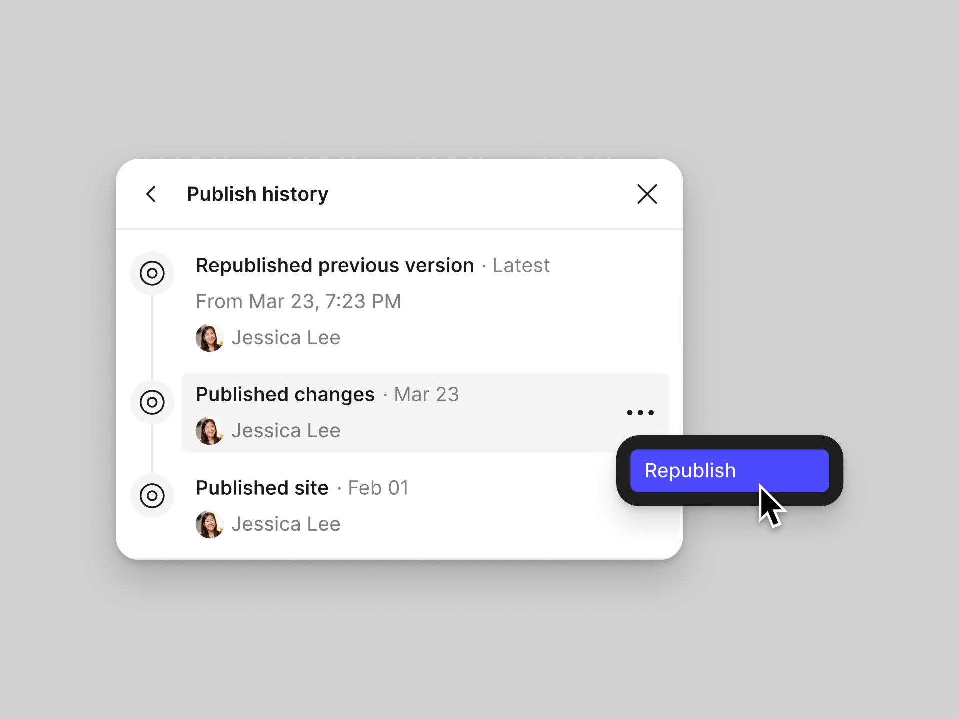

Republish a previous version of a site
If needed, you can revert to a previously published version of your site. Republishing a previous version will restore the HTML, CSS, and other files that were generated at the time of publishing. The result of this action is:
- The previous version is immediately published.
- Everything on the canvas will remain as-is. Republishing a previous version does not modify your site file.
- A new entry titled Republished previous version appears in the Publish history modal.
To republish a previous version:
- Click the File icon in the left navigation bar.
- Click Publish in the left sidebar.
- Click the right arrow at the end of the Last published row.
- Navigate to the version you’d like to restore, click More, then select Republish.
