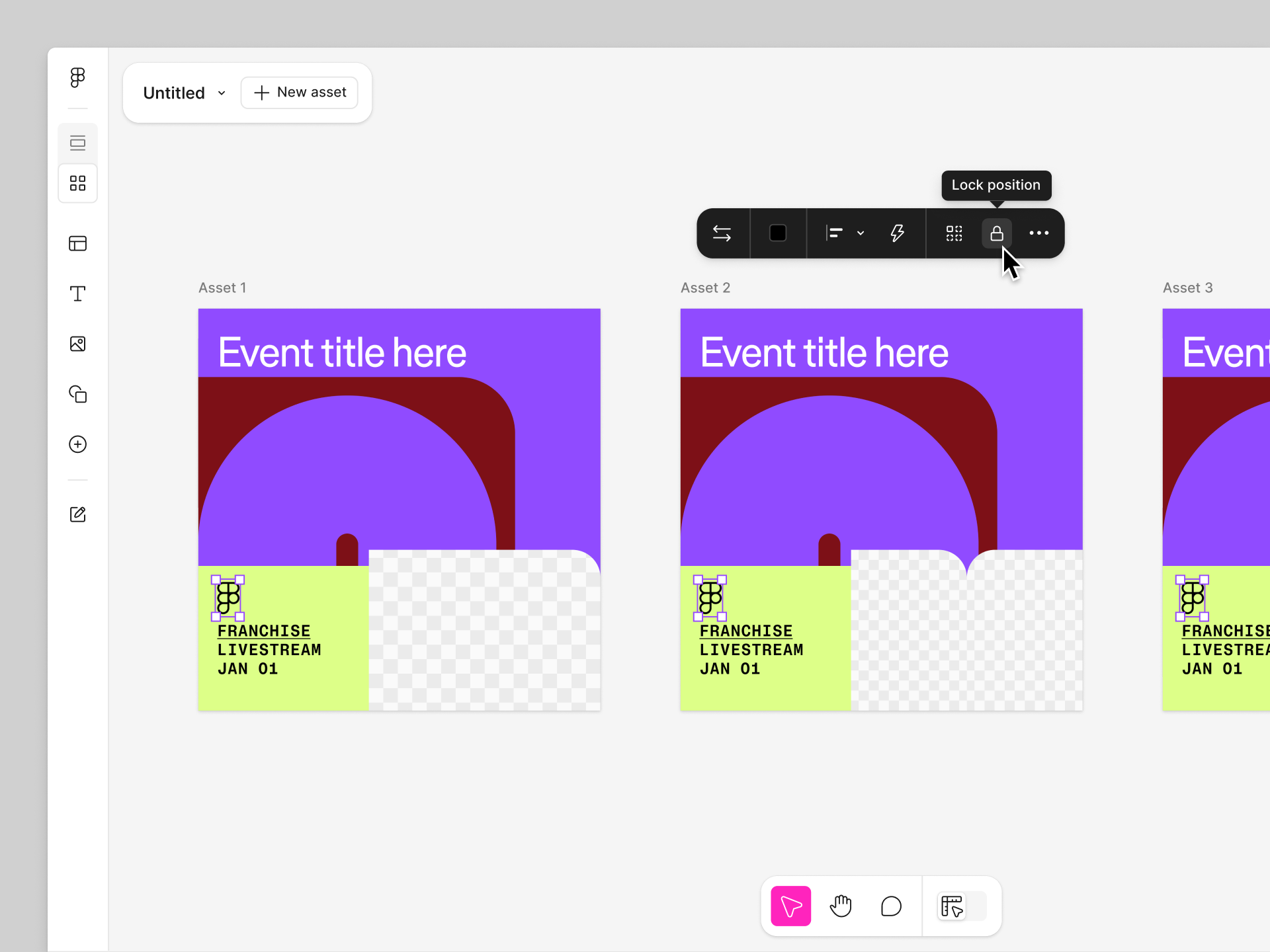

Lock objects
Lock objects before publishing a template to keep anyone using it on brand, or prevent them from making unwanted edits.
Locking objects will impact what users see when they use your template.
- When someone uses your template, they will only see unlocked object fields available for editing in their Edit content tab.
- To edit locked objects, someone using your template can click to remove editing restrictions from the template.
- If a user switches to design mode, locked objects will be indicated in the Layers panel, and can be unlocked by clicking the lock icon.
To lock objects in your assets:
- Select the object in asset.
- Click Lock position.
