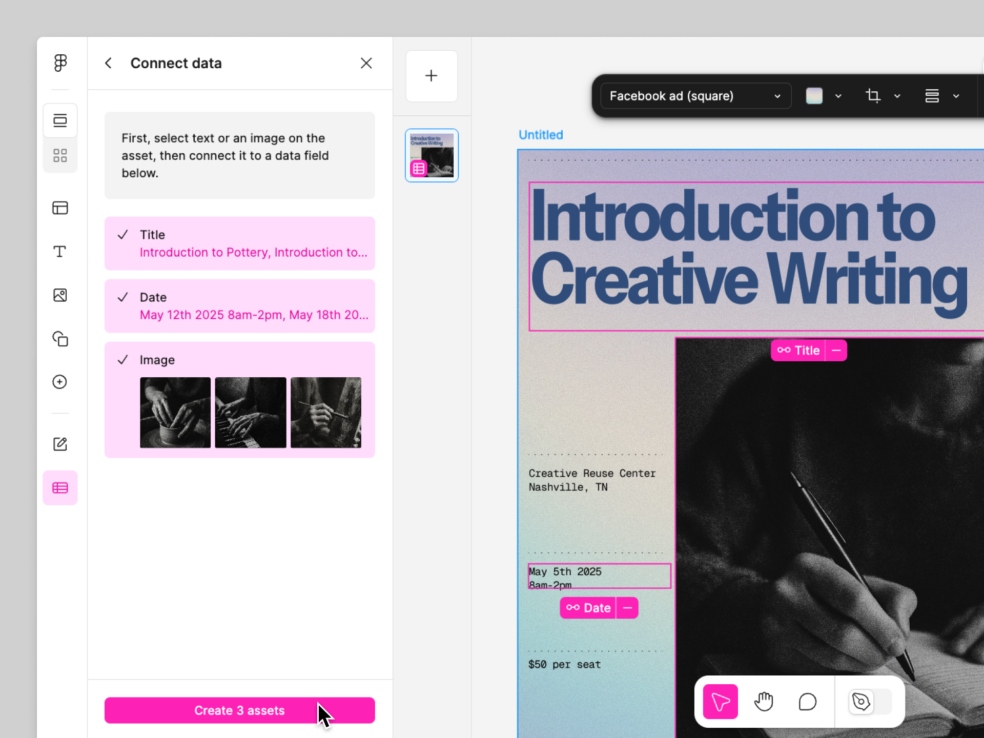

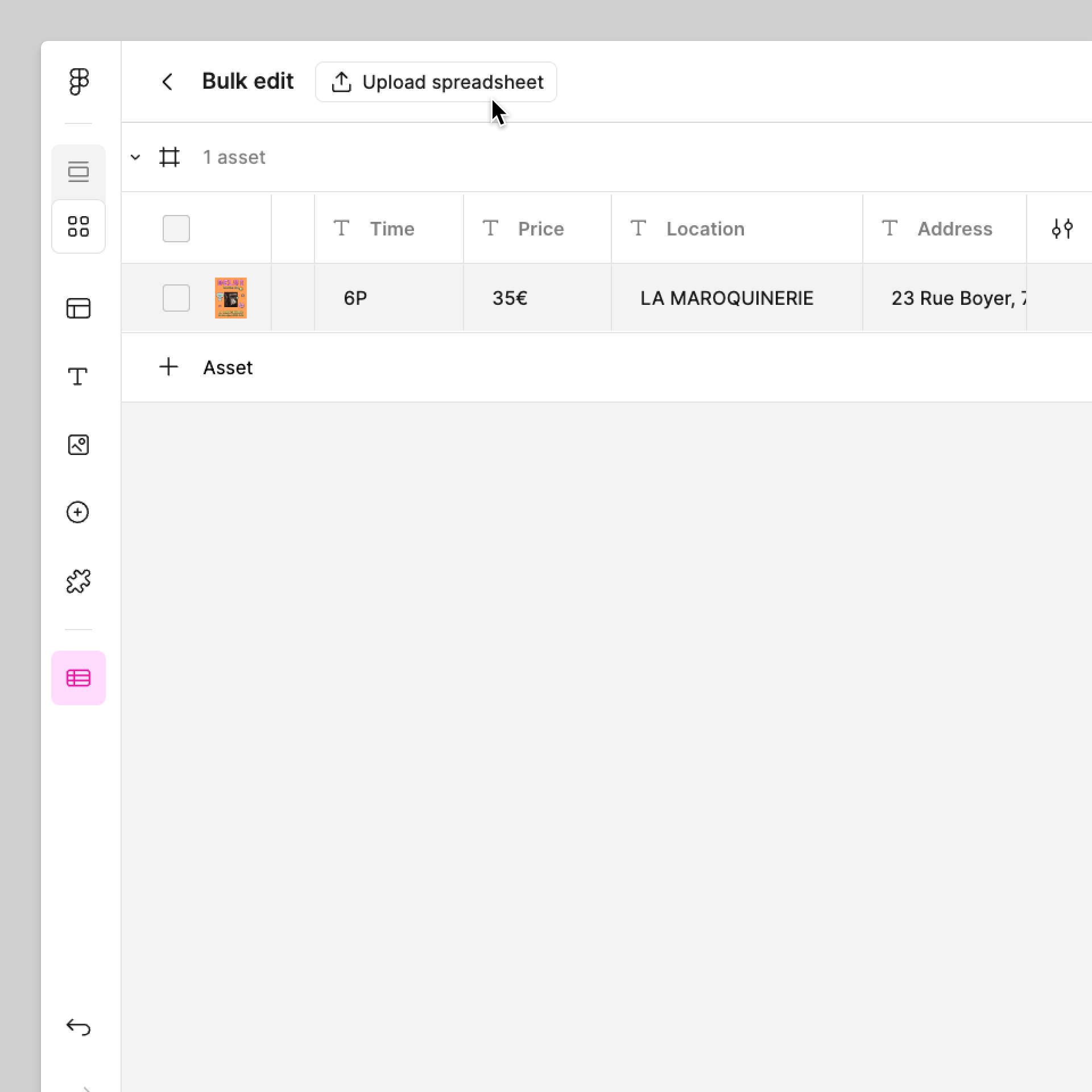

- Create or select a single asset in your Figma Buzz file.
- Click Bulk create from the left navigation bar.
- Click Upload spreadsheet.
- Select a CSV or XLSX file from your device.
- Select piece of text or image on your asset, then select the corresponding data field from the left sidebar. You can only link text fields with text, and image fields with images. Once an object is linked to a data field, the data field will be marked with a check and highlighted pink. You can also click from the selected object’s toolbar and Select matching objects to connect multiple of the same object type across multiple asset sizes.
- Repeat step 5 for each object you’d like to update.
- Click Create assets.
Note: If you’re working from a template, you won’t be able to select any locked objects. To use locked objects in bulk create, first remove editing restrictions from the template.
New assets will be created after the selected asset. To view all new assets, navigate to Grid view.
