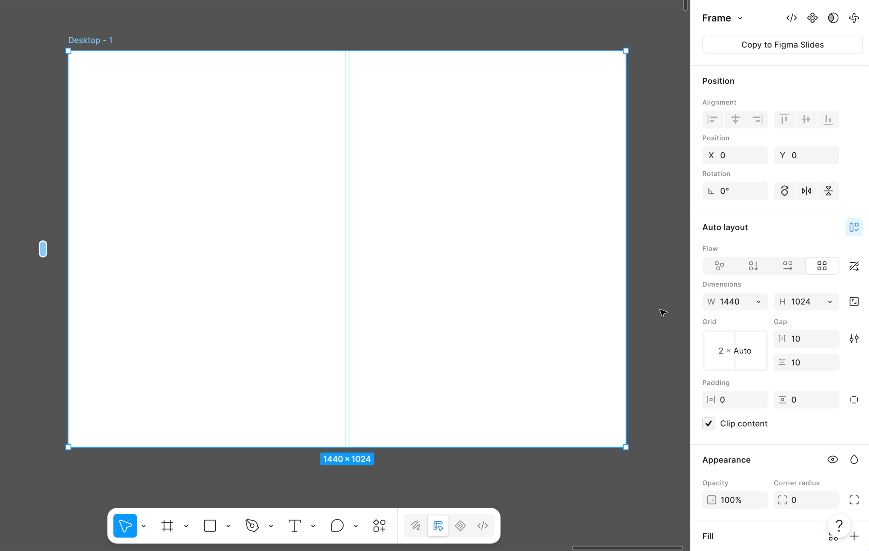

Columns and rows (tracks)
The grid auto layout flow brings two-dimensional layout controlârows and columnsâinto your designs. Once youâve enabled grid on a frame, you can choose the desired number of rows and columns by clicking on the grid picker in the right sidebar. Enter a value in the Number of columns and Number of rows fields, or use the interactive selector.
Tip: You can use mathematical operationsâlike add +, subtract -, multiply *, and divide /âto change the number of tracks (columns and rows) in a grid.

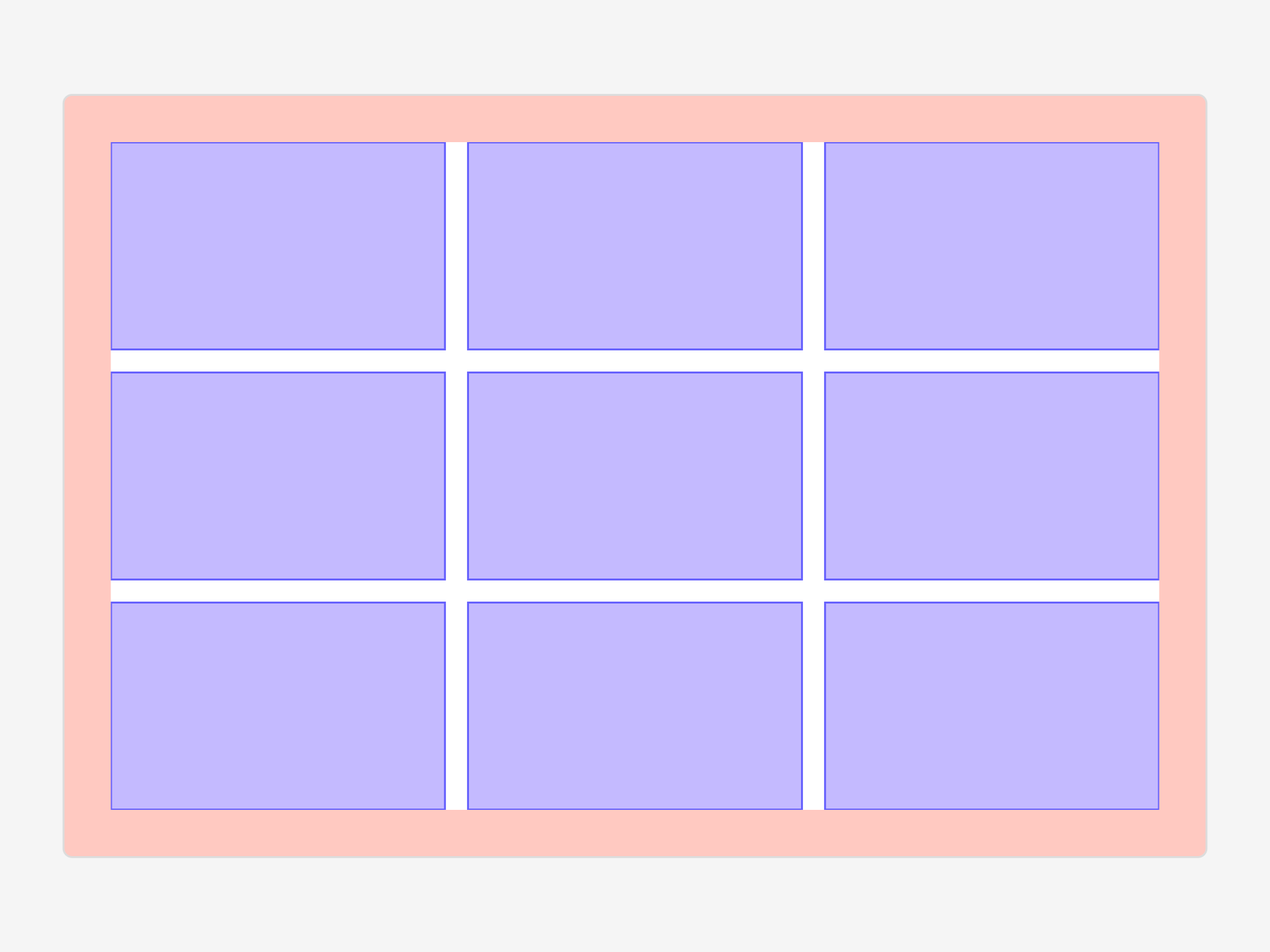

Spacing
Gap between
Gap between sets the distance between columns and rows. You can do this using the Gap between rows and Gap between columns fields in the right sidebar when the grid auto layout frame is selected. Enter a number value into the field, nudge the values using your arrow keys, or scrub the field using your cursor.
Padding
Padding controls the empty or white space between the boundary of the auto layout frame and the frameâs cells. Using the Horizontal padding and Vertical padding fields in the right sidebar, you can set padding uniformly, vertically and horizontally, or have different values for top, right, bottom, and left paddings.

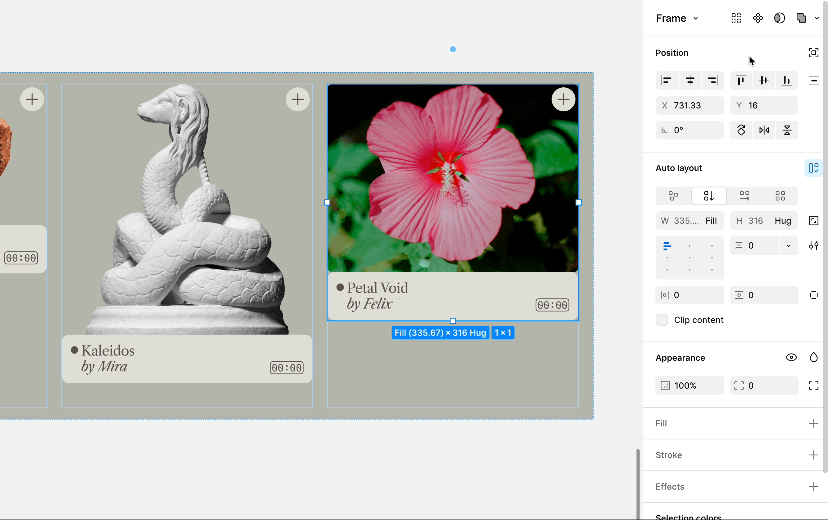

The following resizing properties are available.
Fixed dimensions
Use fixed width or fixed height so that the dimension will remain the same, regardless of the size of its parent cell or parent frame.
Fixed width and height can be applied to cell objects, nested auto layout frames, and top-level auto layout frames.
Fill container
Use fill container so that the dimension always fills the width or height of the cell or frame. Fill container is only applicable to nested objects inside an auto layout frame and grid tracks. Top-level auto layout frames cannot use fill container, because they do not live inside another container.

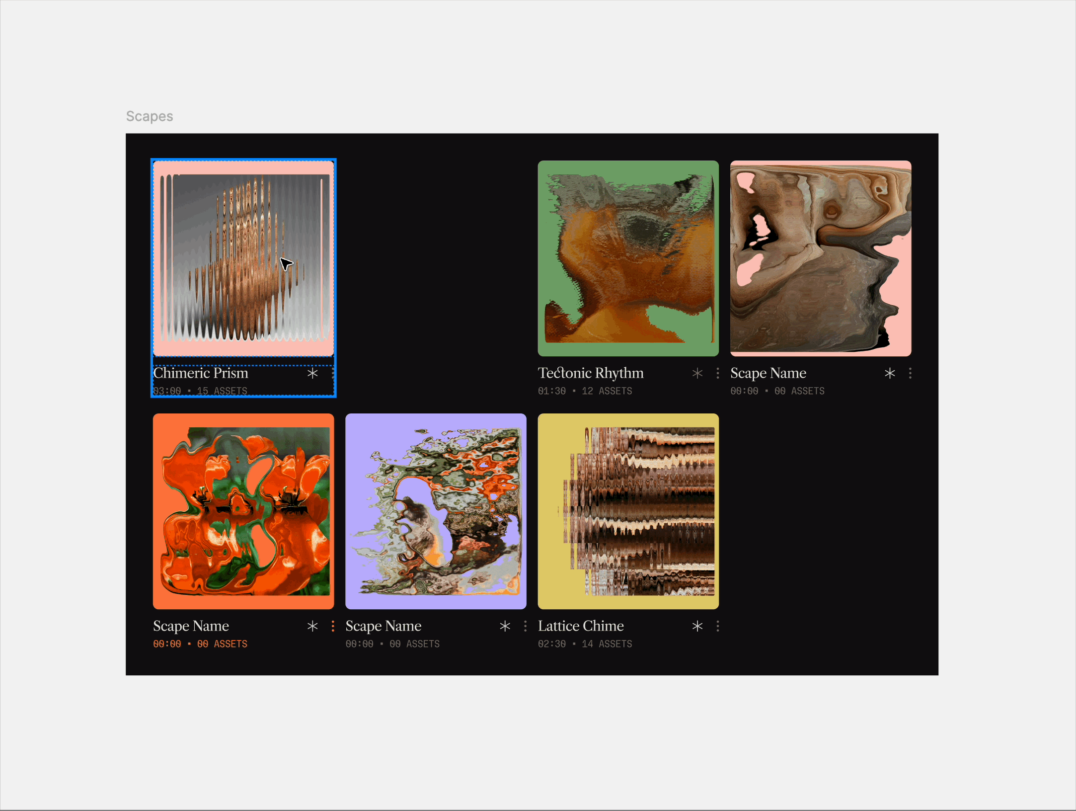

Add and move objects in a grid
- Create shapes, frames, and text layers: Create these elements directly in a cell
- Move objects into a grid: Drag one or more layers and drop it into any empty cell or in between two cells
- Reorder child objects: Drag one or more child objects and drop it into an empty cell or in between two cells. Or use the arrow keys on your keyboard to reorder objects in the grid.
- Swap positions of two child objects: Select two or more child objects that span the same number of cells, then drag the pink circles to swap them. Learn more about smart selection.
- Duplicate existing objects: Select one or more child objects and use the keyboard shortcut â Command D for Mac, and Ctrl D for Windows
Objects will be placed in succession from left to right, top to bottom. If there are not enough empty cells available, Figma will reposition obstructing objects into available cells or create new rows or columns to accommodate.

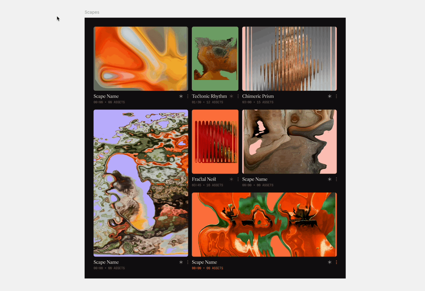

Span objects across multiple cells
You can span a child object to stretch across multiple cells in a grid, allowing it to resize when the parent is resized.
To span a child object, be sure the child object is set to Fill container. Then select it and resize it on the canvas until it object snaps to the edge of a cell. You can also use the Column span and Row span fields in the right sidebar.
