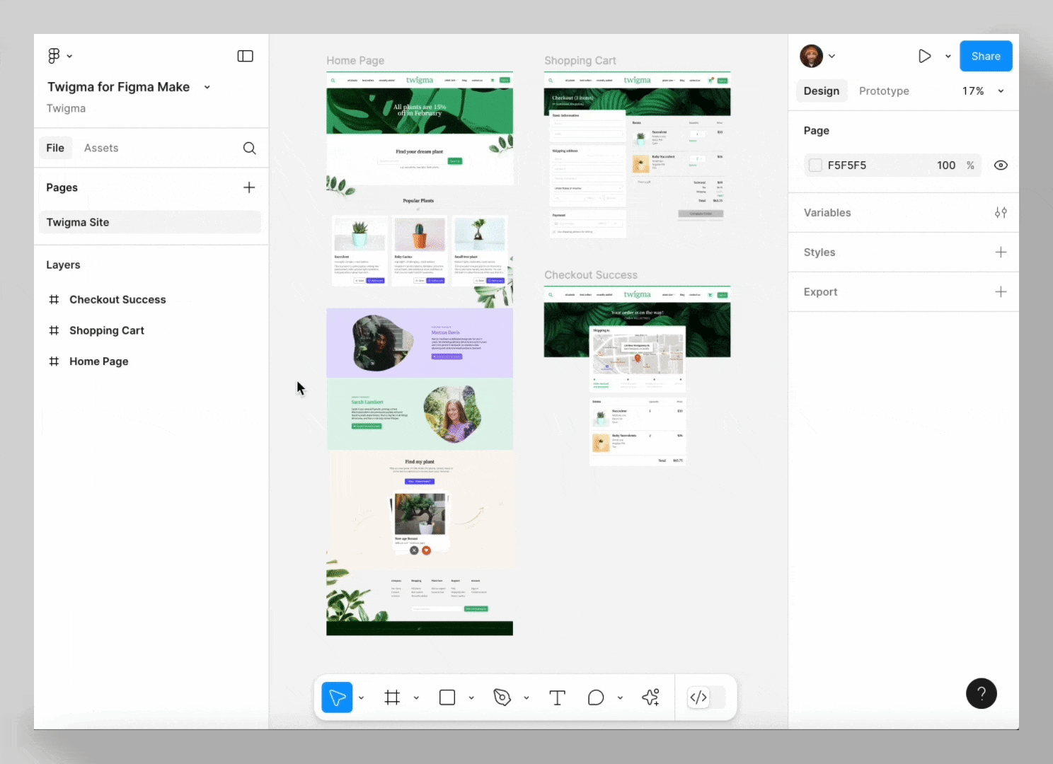

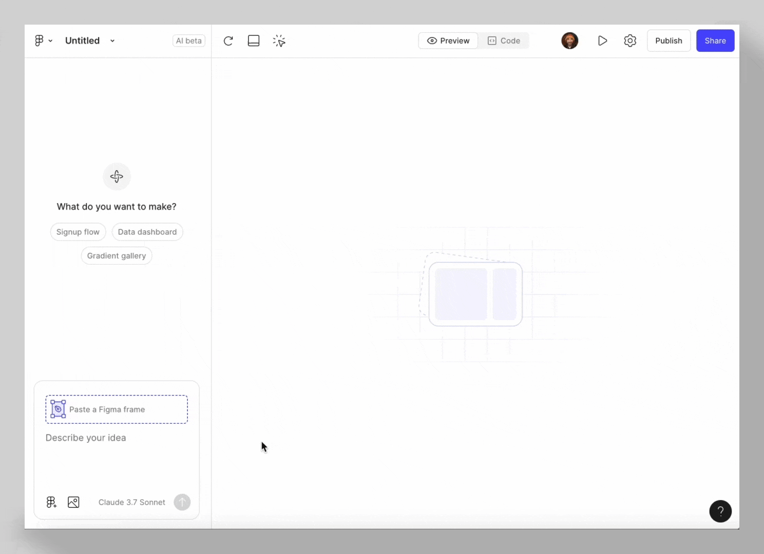

To attach Figma designs in Figma Make:
- In the prompt box, click and then select Add context.
- In the modal, paste design layers, components, or a link to a Figma frame or FigJam file.

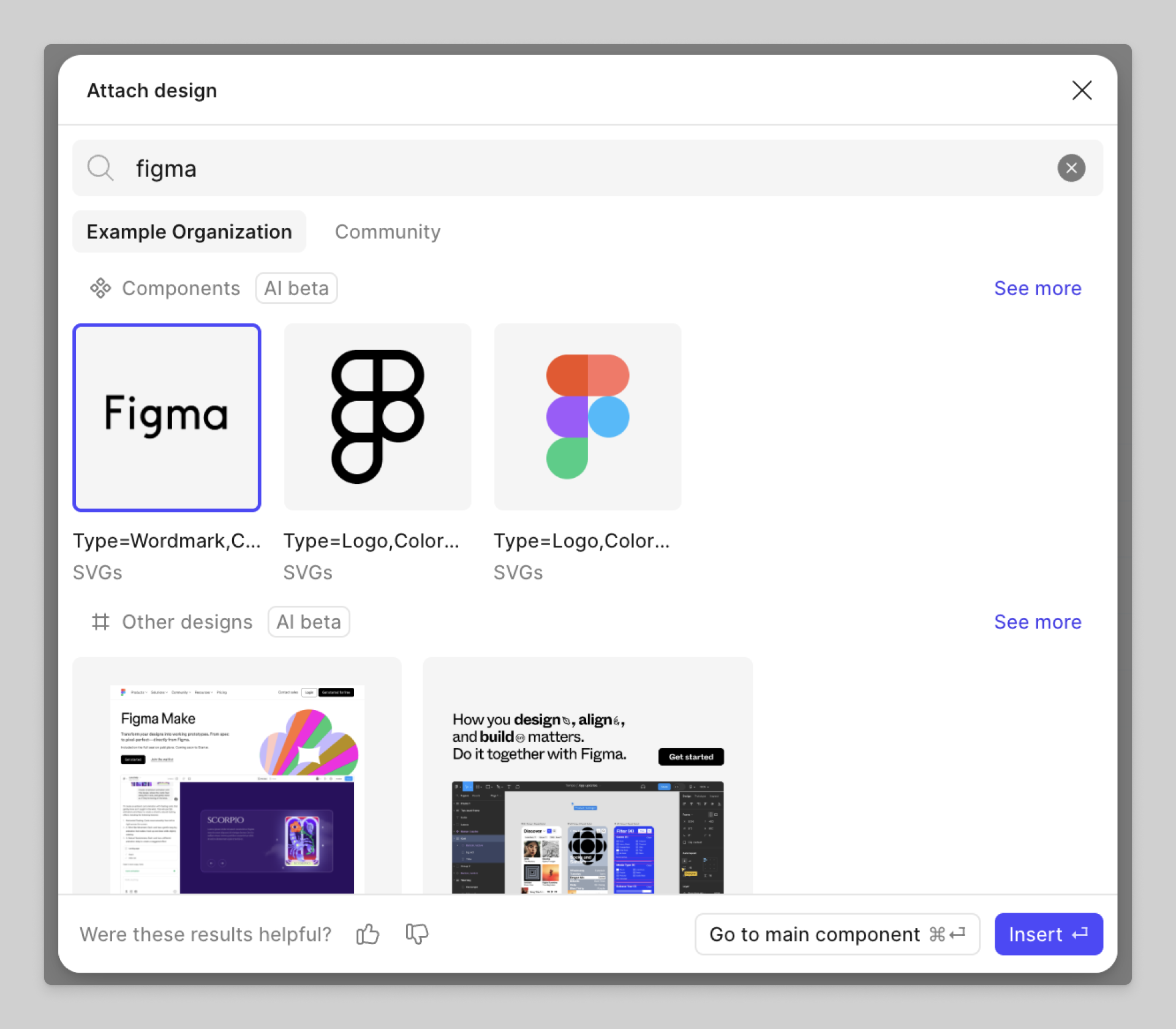

To browse and attach a design in Figma Make:
- On the left side of the modal, click Designs.
- Browse through the designs from your files and frames from the Figma Community.
- Hover your cursor over the design you want to add, then click Attach.

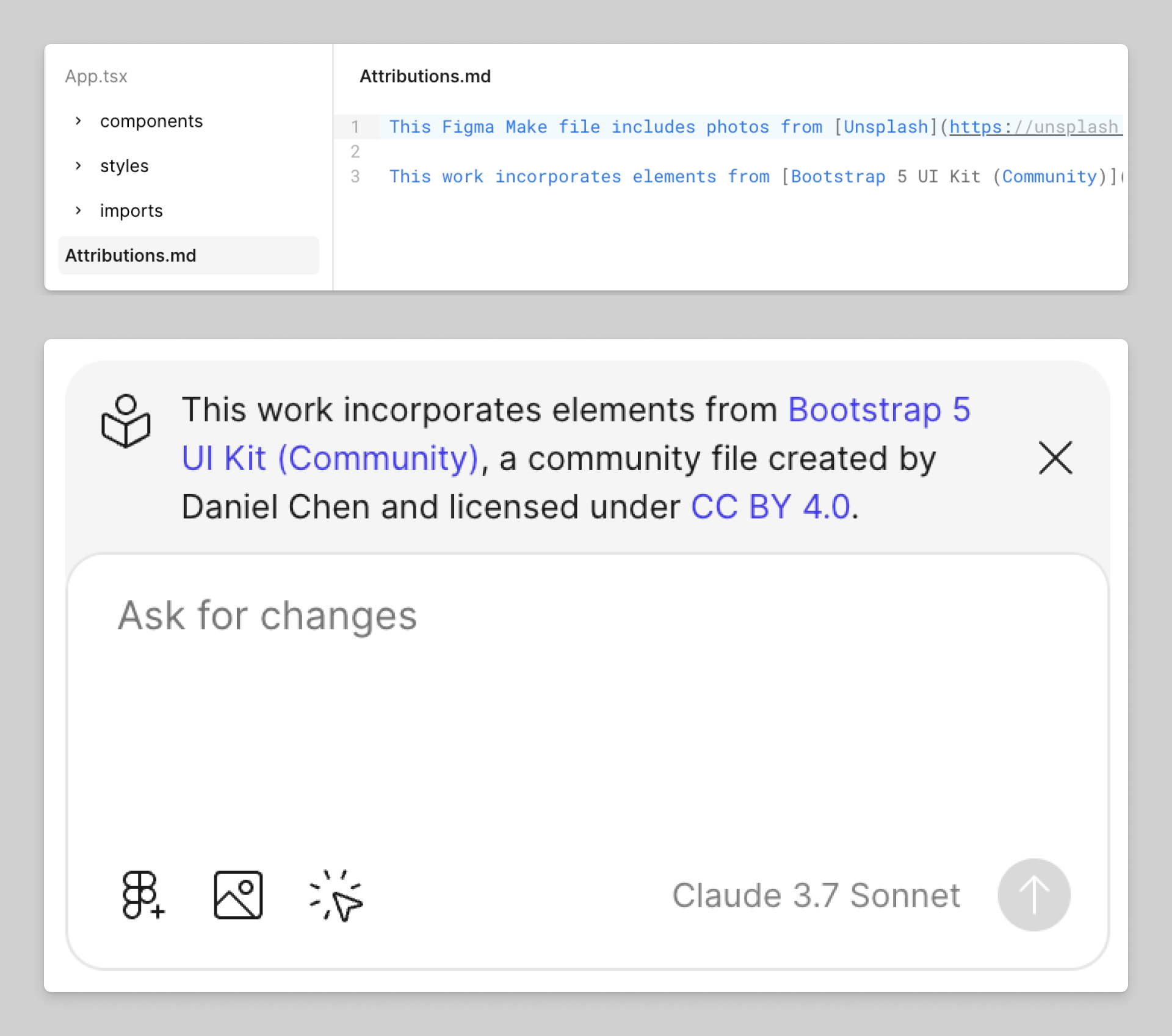

Note: When you use a Community design for prompts in Figma Make, a reminder appears above the prompt box that lists the designs. Additionally, Figma Make creates an Attributions.md file that includes a list of all assets that require attribution. The file is packaged with your functional prototype or web app to ensure proper attribution to original creators.

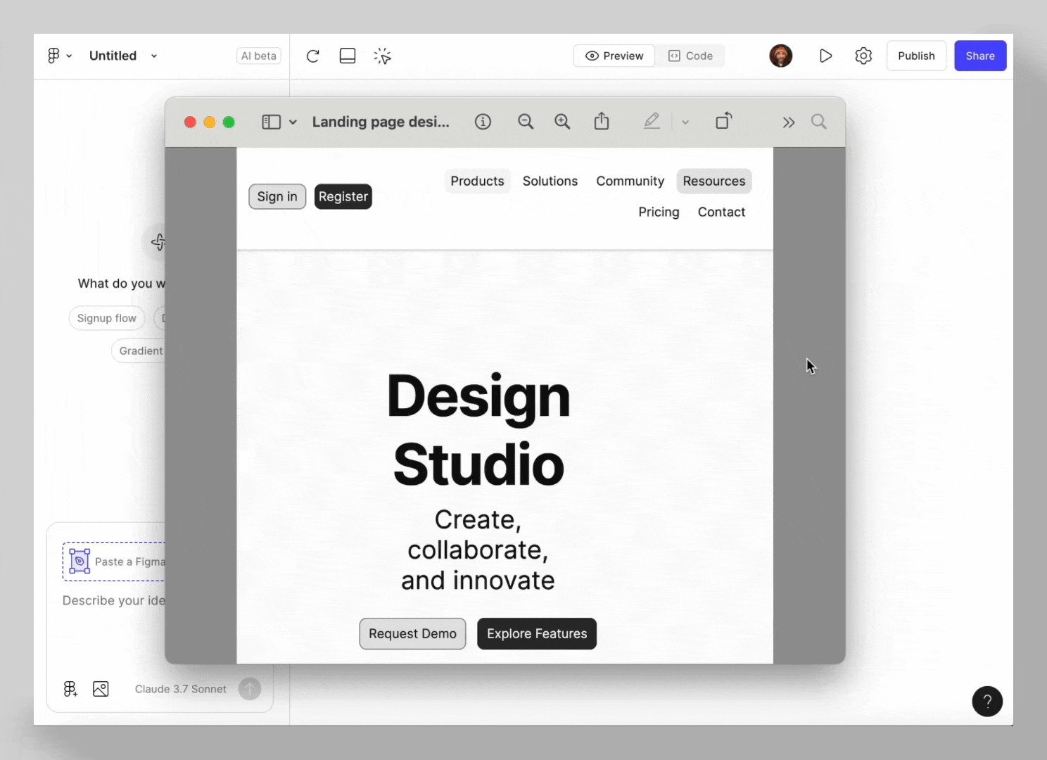

To attach a file:
- In the prompt box, click and then select Upload files.
- Select one or more files from your system's file browser.
Tip: You can also drag and drop files directly into the prompt box.
