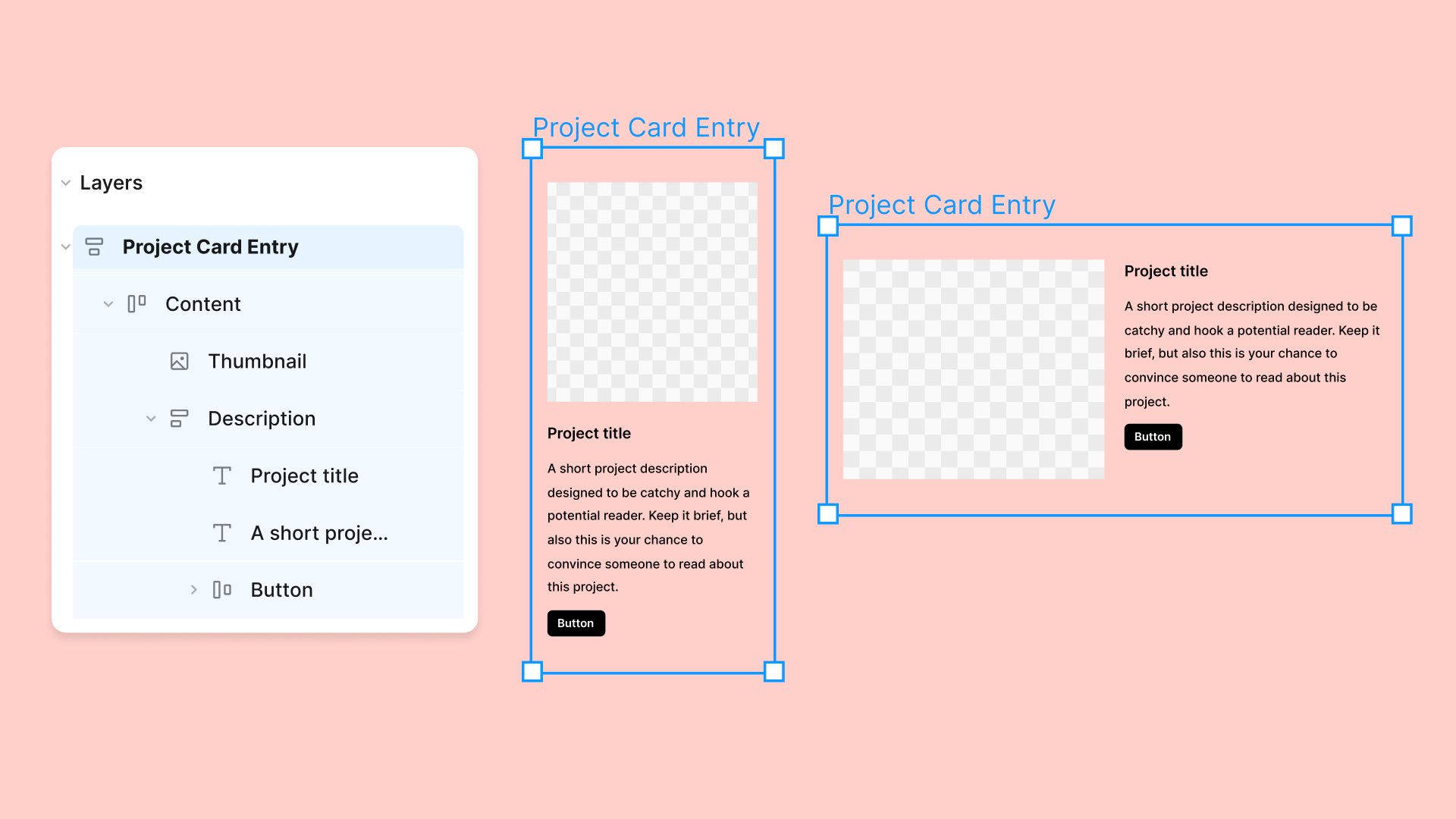

For example, the ‘project card’ design below uses four auto layout frames. This ensures the content in this card will reflow depending on parent frame’s size—without a designer needing to make changes.

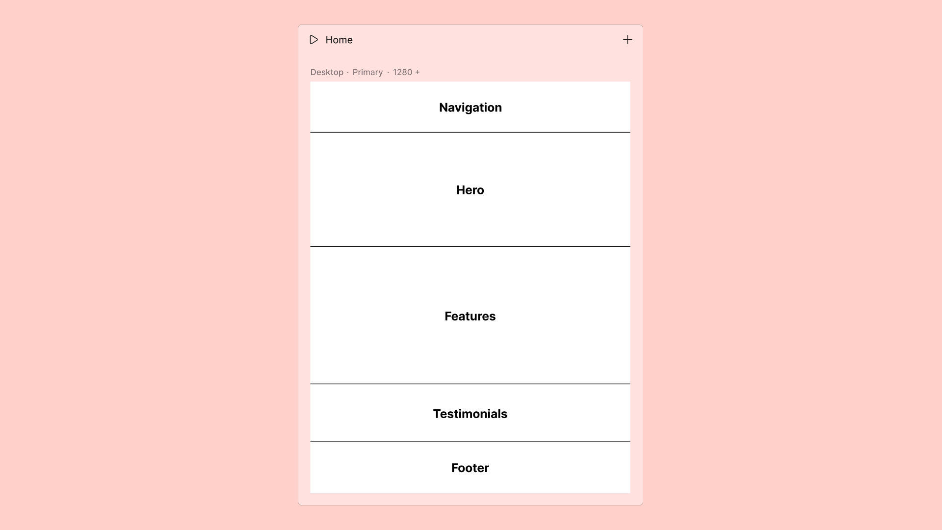

Think of webpage layouts in Figma Sites as a series of vertically stacked frames. Each of these frames represents a ‘block’ or ‘container’ for a specific section of the page.
There are a few benefits to adding this structure to your layout:
- You can nest content and design elements inside each of these parent frames, giving you granular control over the layout of each section as you make adjustments for different screen sizes.
- A structured layout improves both SEO and accessibility, making content easier for search engine and assistive technologies to interpret.
- You can swap, duplicate, or reorder sections just by dragging them around the webpage.
