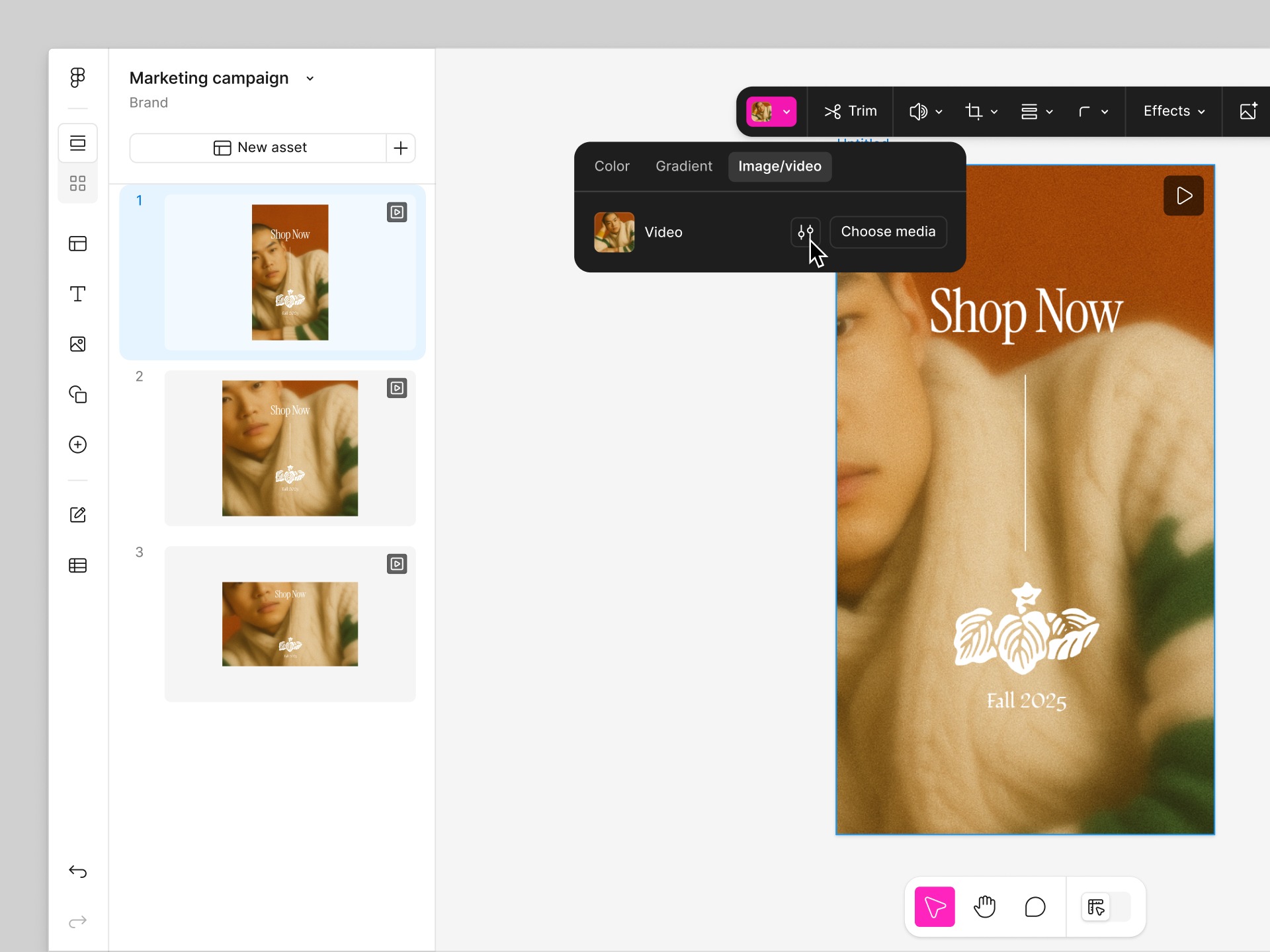

You can enhance the visual quality of your video using the Adjust video tool:
- Select the video.
 - From the inline toolbar, open the Fill dropdown.
 - Select the Image & video tab.
 - Click Adjust video.
 - Use the available sliders to modify:
- Exposure
 - Contrast
 - Saturation
 - Temperature
 - Tint
 - Highlights
 - Shadows
