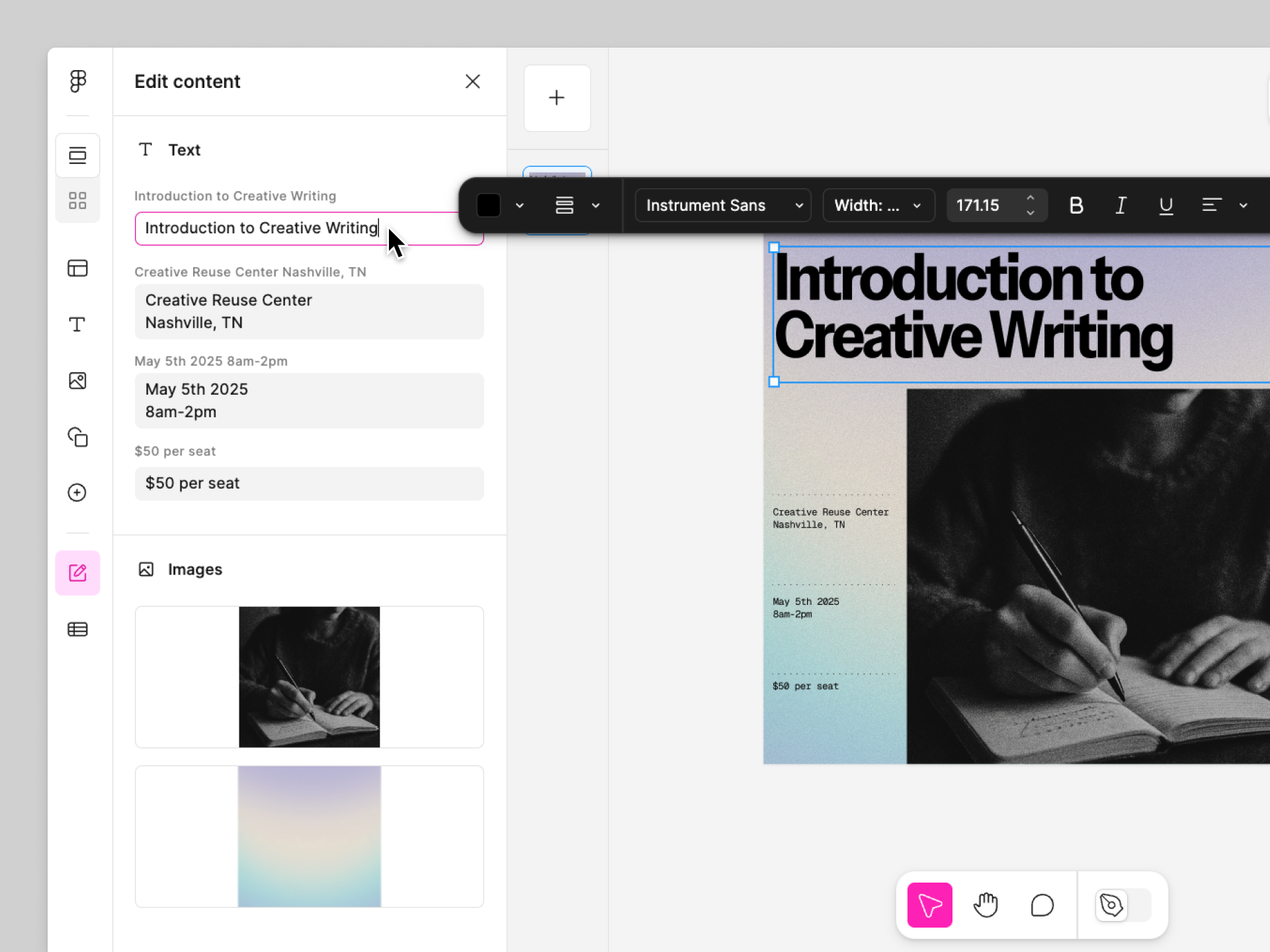

Edit content
If you just need to make simple updates—like swapping images or changing text—you can use the Edit content panel.
- Select an asset on the canvas.
- Click Edit content in the left sidebar.
- Update text and image fields using the creation tools in the panel:
- For text, edit the text field directly.
- For images, hover over the current image, select Choose media, and upload a new file from your device.
Changes made in the Edit content panel automatically stay aligned with your template’s typography and layout settings.

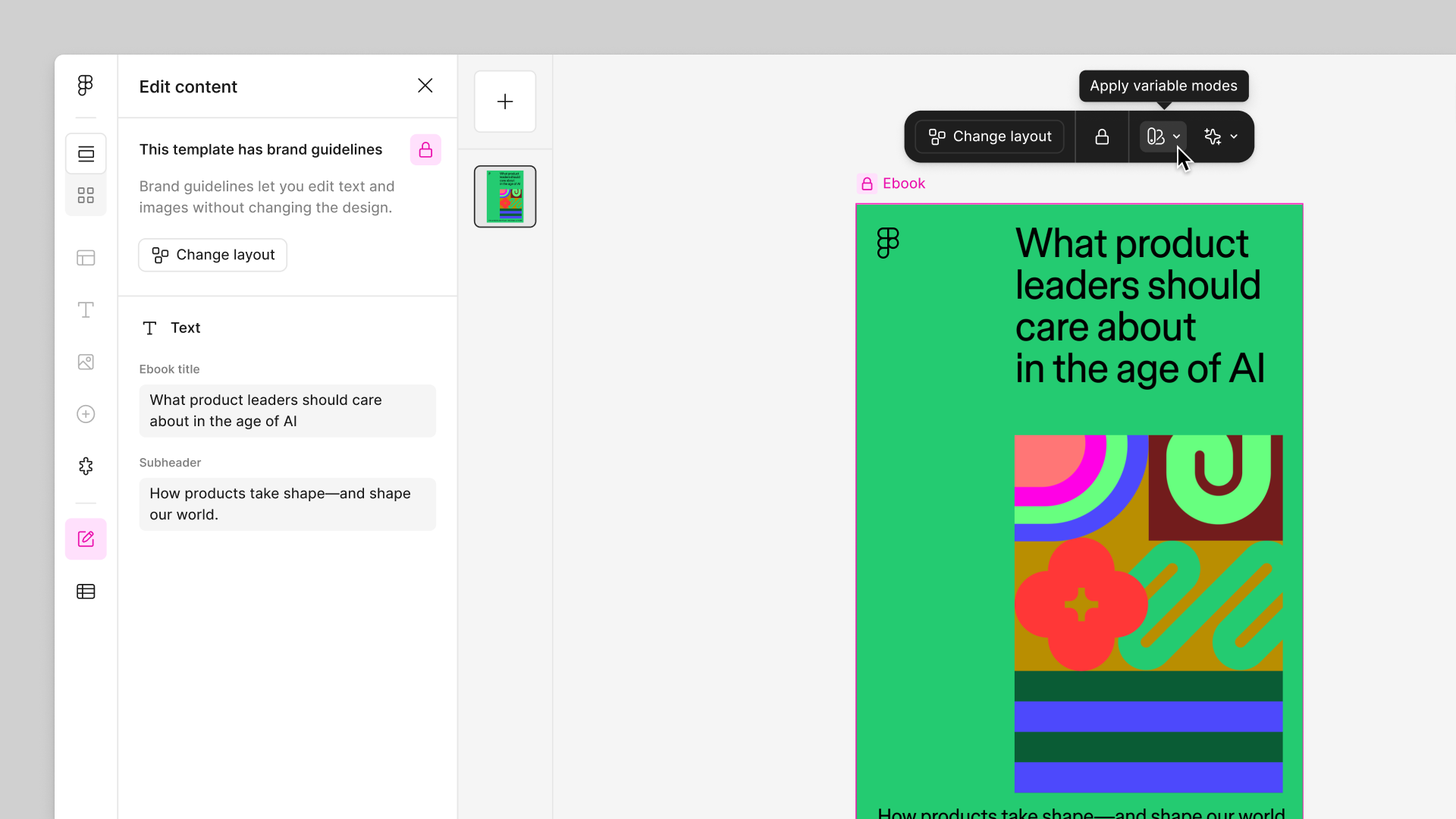

Apply variable modes
Some templates support multiple themes—for example, different color palettes, sub-brands, or localized versions. These are powered by templates created with variable modes in Figma Design.
When a template includes variable modes, you can switch between them directly in Figma Buzz.
To change the variable mode of a template:
- Select the asset on the canvas.
- From the inline toolbar, select Apply variable modes.
- Select the variable modes you’d like to apply from the dropdown menus.
The Apply variable modes option only appears for templates that were created using variables. If you don’t see it, your selected template may not support variable modes.
