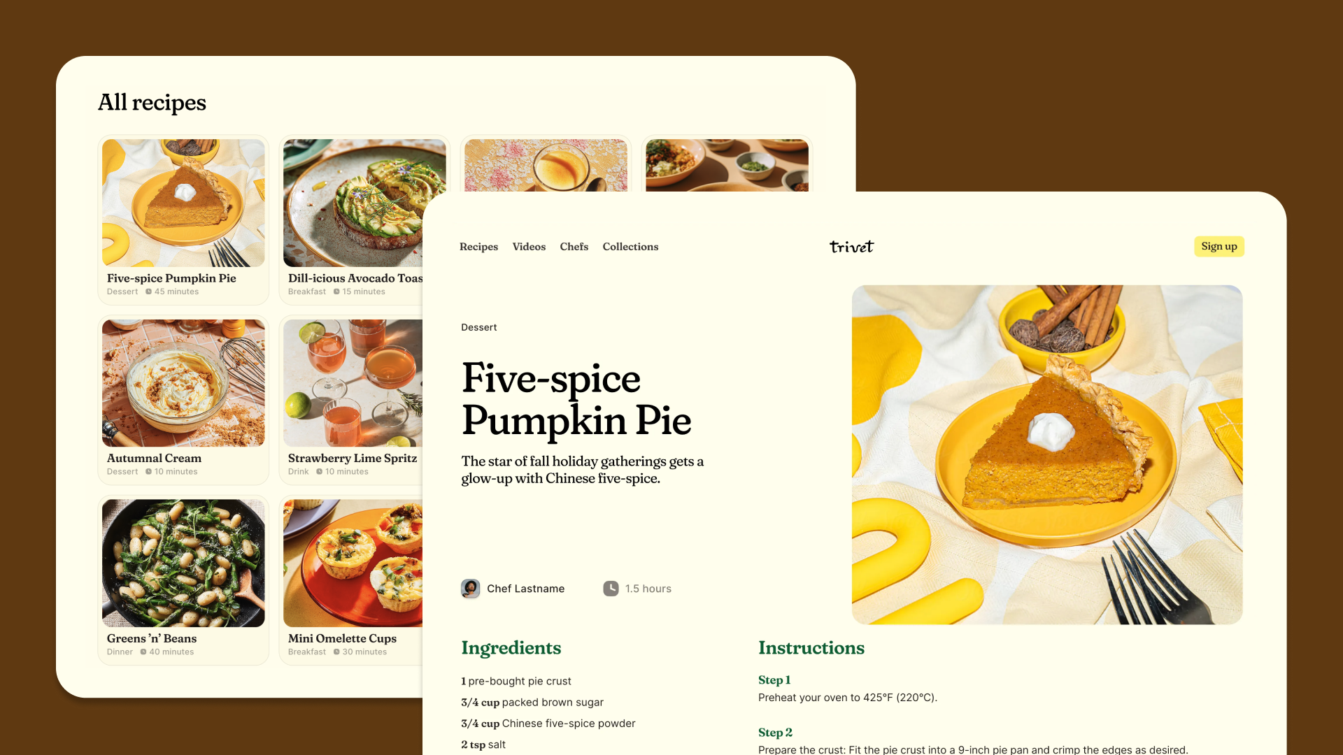

Suppose you’re working on a cooking website with lots of recipes.
A CMS list displays multiple items from a collection—like a grid of recipe previews with titles, images, and short descriptions. Visitors can browse through the list to find what they’re interested in.
A CMS page shows all the details for a specific item: the ingredients, steps, and photos. Each CMS page uses the same design template, but the content updates automatically based on the selected recipe.

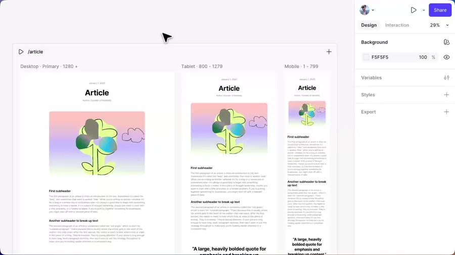

To create a CMS page:
- Select the webpage on the canvas.
- In the right sidebar, click CMS and select a collection.
Tip: You can also create a CMS page from Connect view. Click CMS in the left navigation bar, then switch to the Connect tab at the top of the left sidebar. Hover over a collection name, click Connect, and select Full page. Then, click your webpage to connect it.
With the page connected, you can now switch between collection items in the webpage header. Notice how the page content doesn’t change as you switch between items? To make it dynamic, follow the steps below to connect the CMS collection to layers on the page.

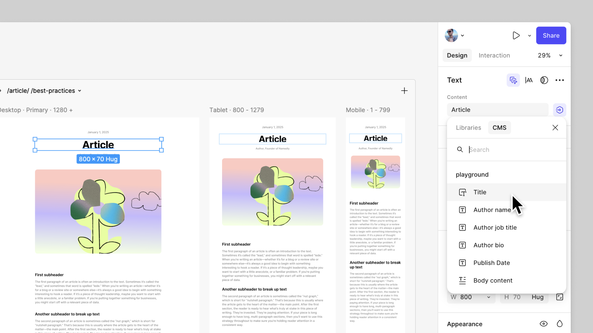

Connect to a text layer
- Select a layer. For text layers, make sure you select the actual text layer and not any parent layers, like a frame.
- At the top of the right sidebar, click Apply variable or CMS field, then select a field.

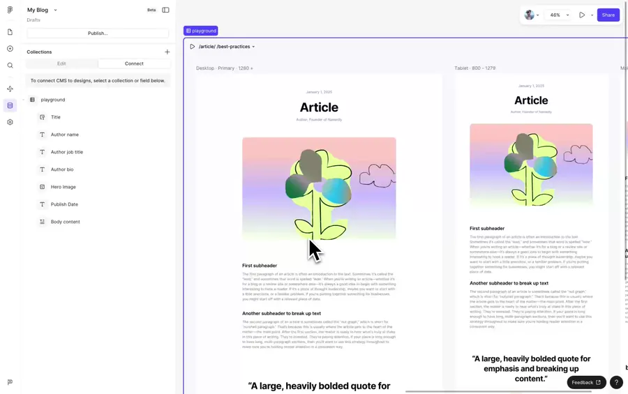

Connect layers in Connect view
Connect view helps you wire up an existing layout or review what’s already connected. In this view, you choose a field, then select the target layer in the webpage to connect it.
Note: Certain field types only connect to compatible layer types. For example, you can’t connect a text field to a shape or frame.
- Click CMS in the left navigation bar.
- Select the Connect tab.
- Click a field in the collection, then click a target layer in the CMS page to connect it.
- Repeat for additional fields and layers.
Note: If you can’t connect a field to a layer, make sure you’ve already created the CMS page.
Tip: While in Connect view, double click a connected design on the canvas to edit the field values for the current item.

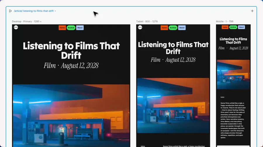

Preview items in the CMS page
Once layers are connected, you can preview how the page looks for different items in the collection.
Click the slug in the header of the CMS webpage to switch between items.
Tip: You can also click Preview to view the page in a full screen preview, or press Shift Space to open the inline preview.
