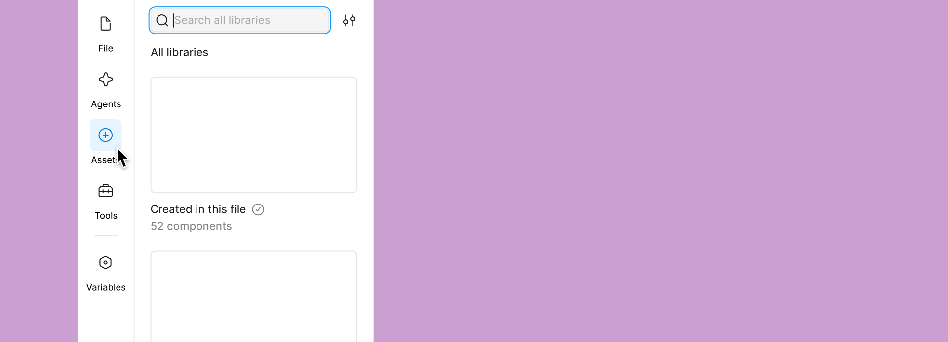

Assets panel
The Assets panel in the left sidebar allows you to search for components to add to your file. You can choose which libraries are available in the Assets panel.
To open the Assets panel:
- Select the Assets tab in the left sidebar, or use the shortcut:
- Mac: ⌥ Option 2
- Windows: Alt 2
- Select a library with the component you'd like to use
- Find the component you want to use
- Click and drag the component onto the canvas to create an instance of that component.
Tip: You can customize the appearance of the Assets tab to match your preferences. Click to switch between a grid or list view, and show or hide sub-folders.
Note: Is the library you need missing from the Assets panel? Click to browse available libraries in your team or organization and add them to your file.

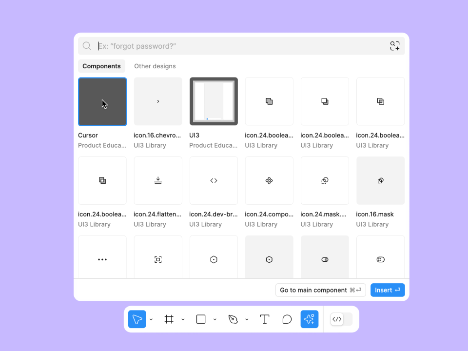

Quick insert from the actions menu
Insert instances of components from your keyboard using quick insert. Quick insert opens the Actions menu where you can find and view components from libraries that have been added to the file.
- Use the shortcut Shift I to open quick insert.
- Use the search bar to find a specific component.
Tip: Need to locate a main component from one of its instances? Right-click any instance and select Go to main component or use the keyboard shortcut:
- Mac: ^ Control⌥ Option⌘ Commandk
- Windows: ControlAltShiftk

Assets panel
- Mac: ⌥ Option 2
- Windows: Alt 2
- Find the component you want to use:
- View components Created in this file
- Explore components from libraries added to the file
- Open the Library modal to manage available libraries
- Use the and to switch between grid and list view
- Use the search field to find components from any library you have access to, including team or organization libraries and files you have at least can view access to
- Hover over a component to view the number of variants available, if any
- Click a component to open the component’s details modal
Tip: Press Tab to navigate between assets in the assets panel. Press Enter on a selected asset to insert it into the file.

Quick insert
Insert instances of components from your keyboard using quick insert. Quick insert opens the Resources modal where you can find and view components from enabled libraries.
The components found in the Resources modal mirror what you see in the Assets panel.
- To locate a component, do one of the following:
- Use the search bar to find a specific component or use the arrow keys to navigate to the relevant component.
- Use the and icons to switch between grid and list view.
- Select from recent components used across your files, or select from an enabled library. If a library is not displaying, you may need to enable the library first. Manage libraries in design files →
- To swap: Select or hover over the instance, then hold down ⌥ Option for Mac or Ctrl for Windows. Swap components and instances →
