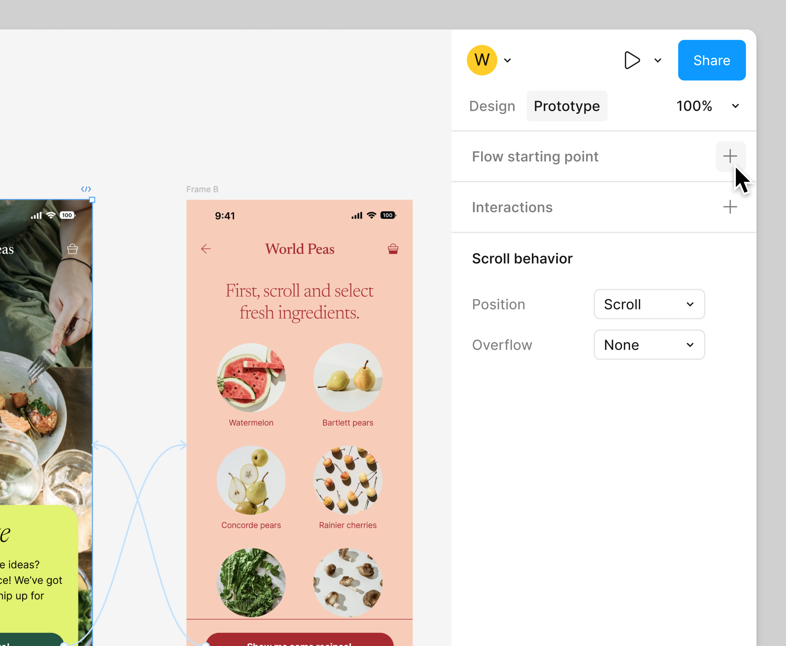

You can also manually create a flow starting point.
- Select the starting frame.
- Select the Prototype tab from the right sidebar.
- Click the plus sign in the Flow starting point section.

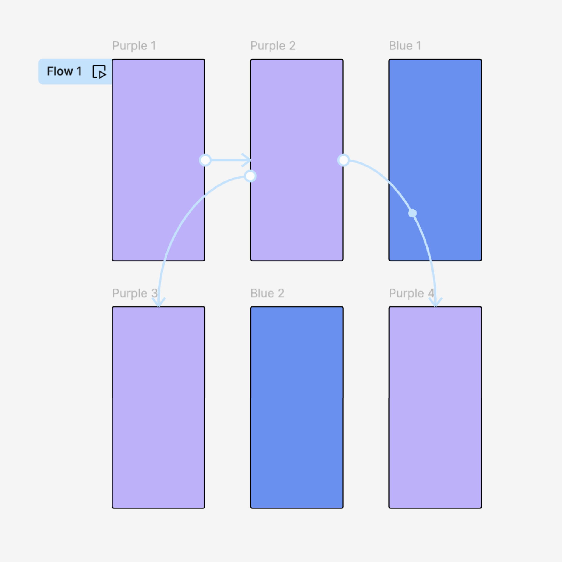

Once you have a flow starting point, the rest of the flow consists of any frames that are connected to the starting point with prototyping interactions. This includes frames that are directly connected to the starting point, as well as frames that are connected through other interactions.
For example, all purple frames in the image below are included in Flow 1:
To remove a frame from a flow, remove any prototype interactions that connect the frame to other frames in the flow.
Frames can be included in multiple flows. For example, the blue frame in the image below is included in both Flow 1 and Flow 2:
Once a user navigates to a frame that is included in multiple flows, they can use any interactions on that frame. This opens up the original flow to include any connections from that frame.

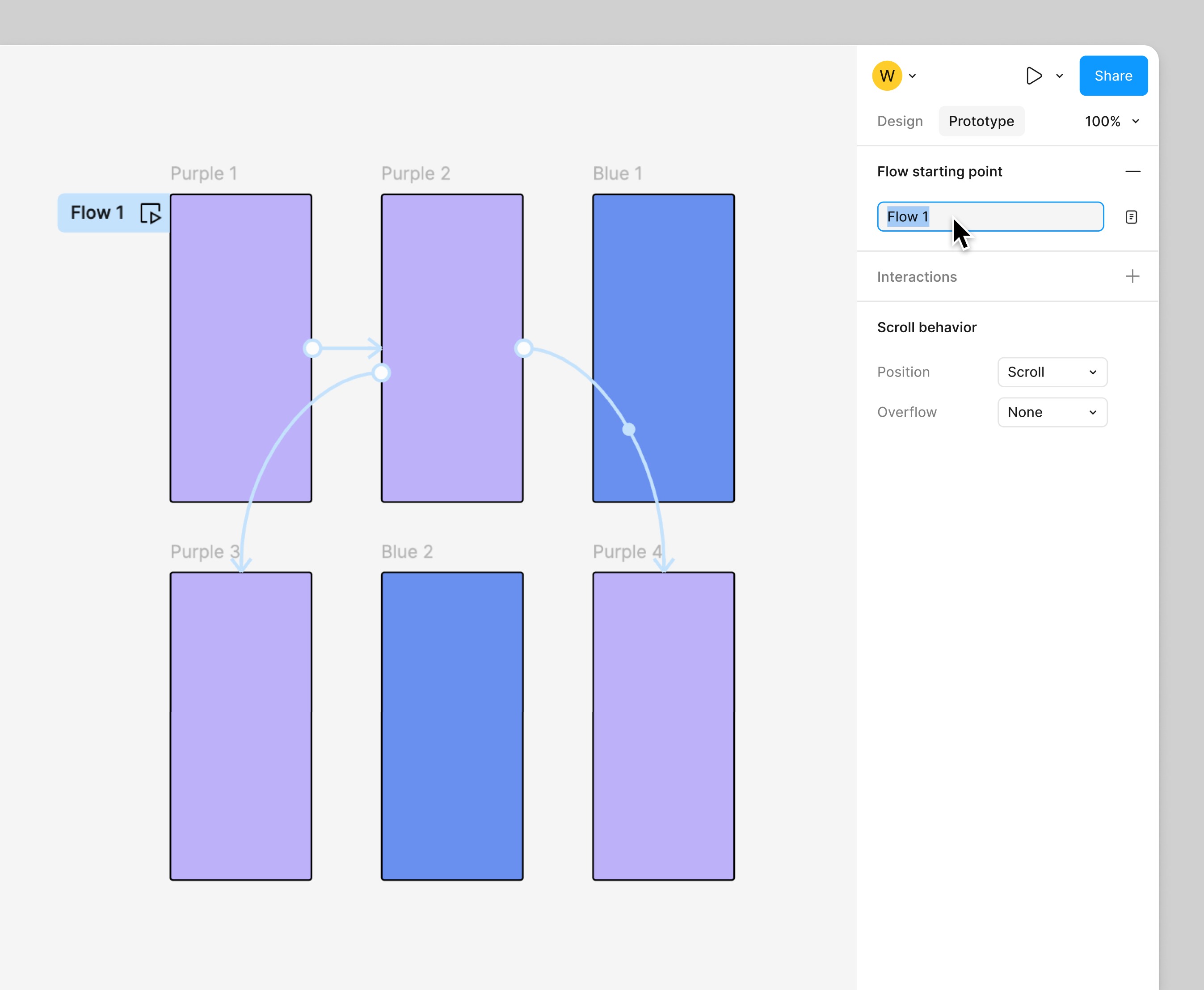

Edit flow name
Once you've created a flow, Figma will name it Flow 1 by default, with additional flows being Flow 2, Flow 3, and so forth. You can rename a flow at any time.
To rename a flow:
- From the Flow starting point section, select the flow name field.
- Enter in a new flow name.
Once renamed, the flow name is displayed in the frame's blue starting point icon and the left sidebar in presentation view.
Tip: You can also rename a flow by double-clicking the flow starting point name directly on the canvas.
